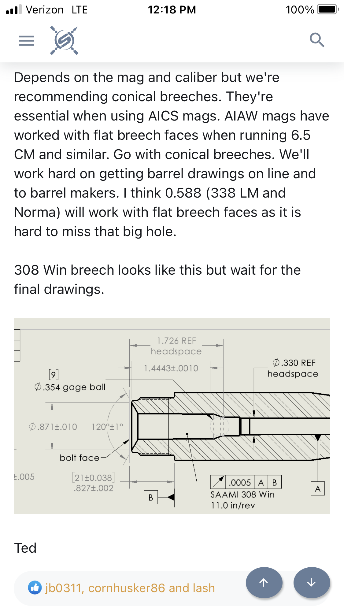

I really like conical breeches.
Not to derail, but the BR guys mostly use conical because it really helps that PPC round to go quickly into the chamber without a hiccup.
I bought a Kauger action last year to build a 6-BR and it feeds like greased goose shit on glass. In fact, it works very well with 5 round P-mags.
I highly recommend conical.
Did I mention I like them too?
Impatiently waiting on a Long Action...
Thanks for that. Conical breeches are definitely awesome for smooth feeding but not always necessary if the bullet tip finds the hole. The Coup has a 6 o'clock lug that effectively strips the cartridge from the mag. That lug needs to pass through a 6 o'clock slot in the receiver. The bullet tips of small cartridges will not get high enough to find the chamber and require the conical breech. The 300 Norma and 338 Lapua Mags find the hole and can be run with a flat breech. The pics below tell the tale, sort of.

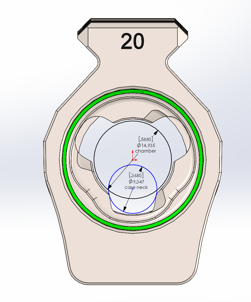

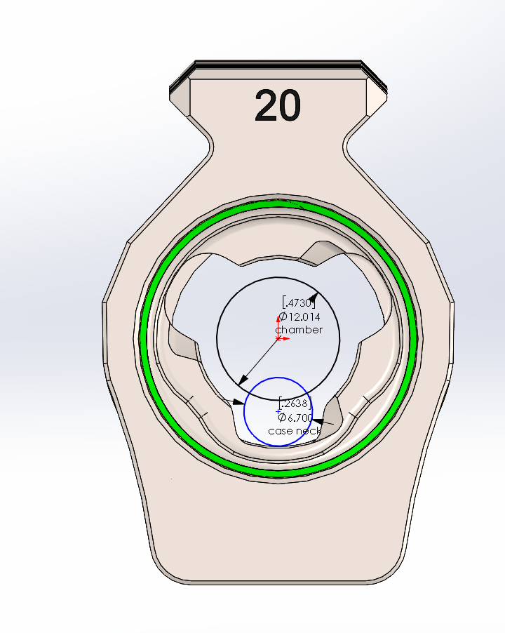

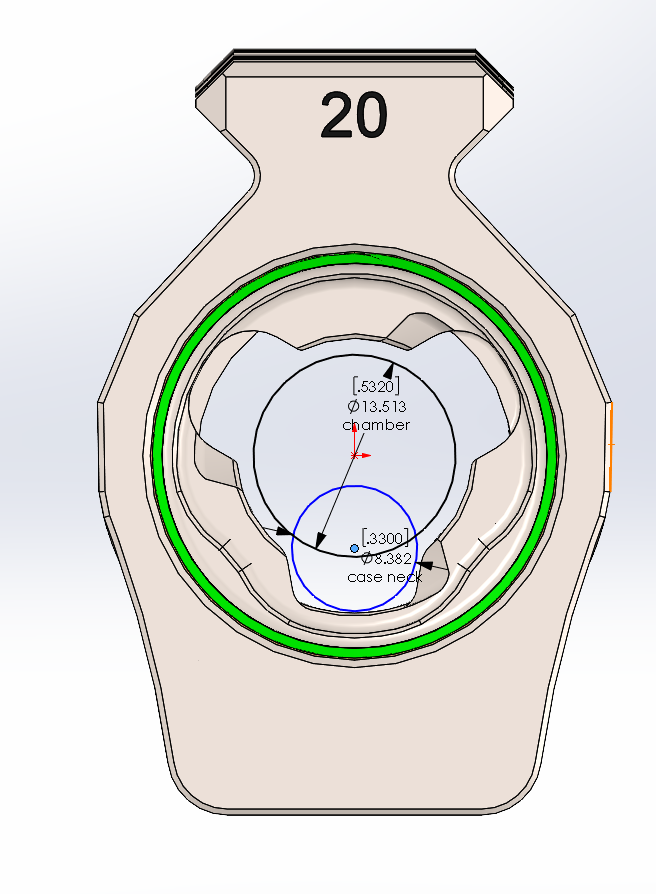

Yep, that cartridge centerline on the smaller cartridge needs help.
The magnum centerline is already above the bottom of the chamber.
223s, Grendel, 6-ARC and BR variants really can use all the help they can get to make sure the bullet tip is pointing in the right direction to prevent it from running into the flat back side of the barrel.

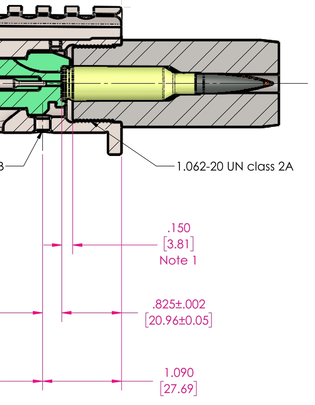

I don't think having them coned will be as simple as you think. Headspace is close to same, 0.825 vs 0.827, however the flat breech is 0.675 long from barrel shoulder and the beginning of the coned breech looks much closer to the bolt nose on the new action.
I assumed have to set the barrel back to do it

I welcome criticism, in fact I want it because it drives design, but please keep it accurate. No Nucleus was ever prone to binding. It is true that there was lots of clearance between the bolt and the receiver, but that clearance never caused binding and it was there by design to tolerate filthy conditions. Binding is only caused by tightly coupled opposing forces and the distance between these forces does not appreciably decrease by an increase of one or two degrees in bolt yaw or pitch with respect to the receiver.
It is also true that some people thought that the bolt lift on the Nucleus was heavy.
It is also true that some didn't. In fact, many Nucleus customers have been running these for years with lighter springs that they purchased from us.
The word sloppy has a negative connotation for people who know little or nothing about engineering. There are times when sloppy, or more appropriately clearance, is good and times when it's bad. In regards to bolt actions, sloppy is generally good, again because it does not contribute to binding while tolerating contaminants. The only good thing about tight (opposite of sloppy) is that it can be used by an unscrupulous sales guy to peddle an action having nothing substantive to offer leaving. That's actually a bad thing and it leaves the poor customer none the wiser. We don't and won't do that.
As of now, the Coup De Grâce has 0.2mm (.008 in) between the bolt and receiver. It is tighter than the Nucleus but it also functions differently as it does not have bolt lugs that engage the receiver to prevent rotation (roll) when the bolt is retracted. Rotation is prevented by the bolt stop and the ejector engaging a slot cut along the length of the bolt. Mitigating the tendency to bind relies more heavily on surface finish and coatings than it does in Nucleus and Archimedes. But this is a solvable problem as demonstrated by Accuracy International and Weatherby.
