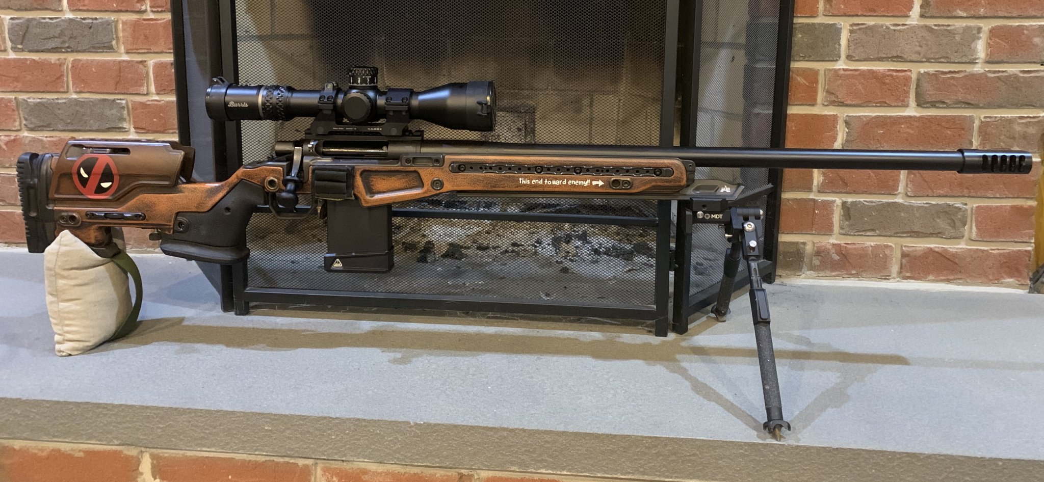

I just finished this today from the BF sale & for those asking Nuke Gen 2 feeds 223 great. Barrel is Short Action Customs with a flat Breach face.
Modified an Accurate mag to hold 12, feeds flawless. The Nuke has a feed ramp that sends the small 223 rounds where they need to go.
