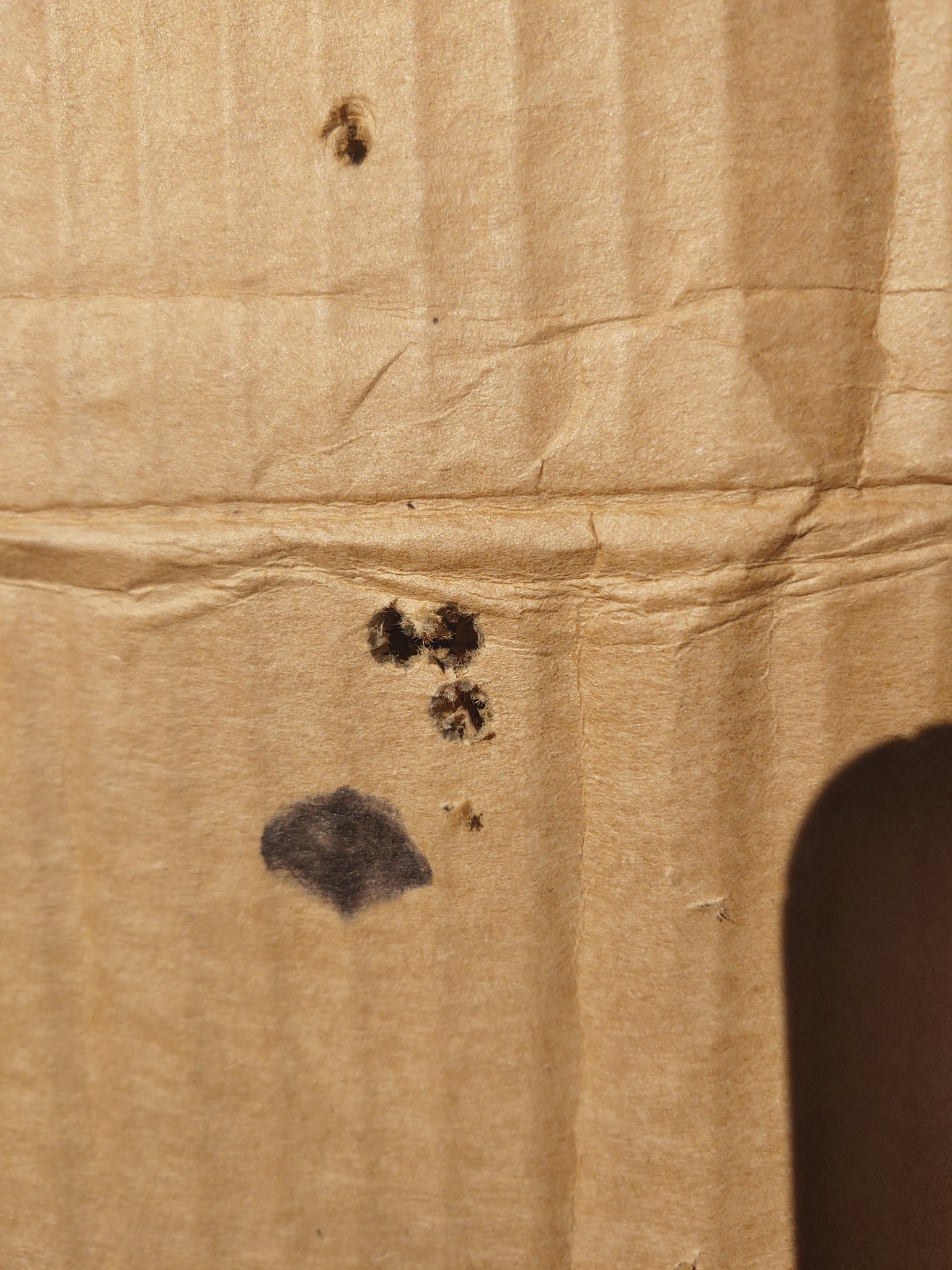

@Bakwa she shoots. First 3 shots at 60 yards with 77gr Noslers and 23.4gr of 8208, and the rest were similar. Didn't measure the group but looks like 5/16" to me. Plenty far enough under MOA for what I want this rifle to do. No problem with the 400yd 8" plate with a 6x optic.

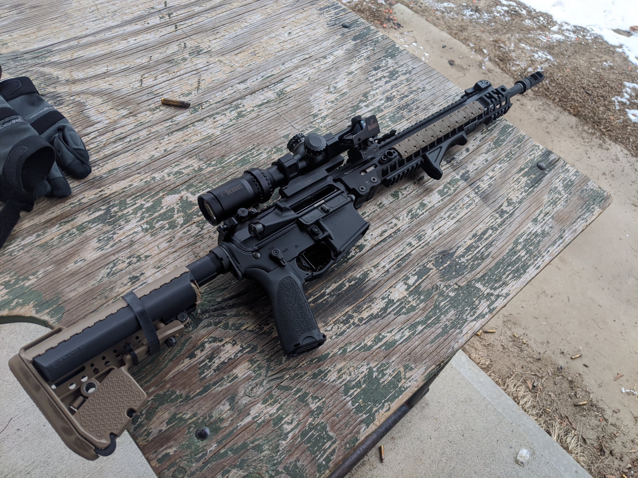

Another short session with a high quality experience behind the 18"CORE. Ran another 100 rnds of 77 grain Razor Core 5.56 through it doing positional drills and transitions. Action feels like it's getting smoother as I go. Recoil impulse is sweet, and follow-up shots are very fast. Pleasure to shoot.
MSTN built with my VLTOR MUR A1 upper :
18"CORE
JP Enhanced Bolt
Milspec carrier
VLTOR A5 /H2
Surefire SOCOM Brake
Geissele SDC 2 stage
