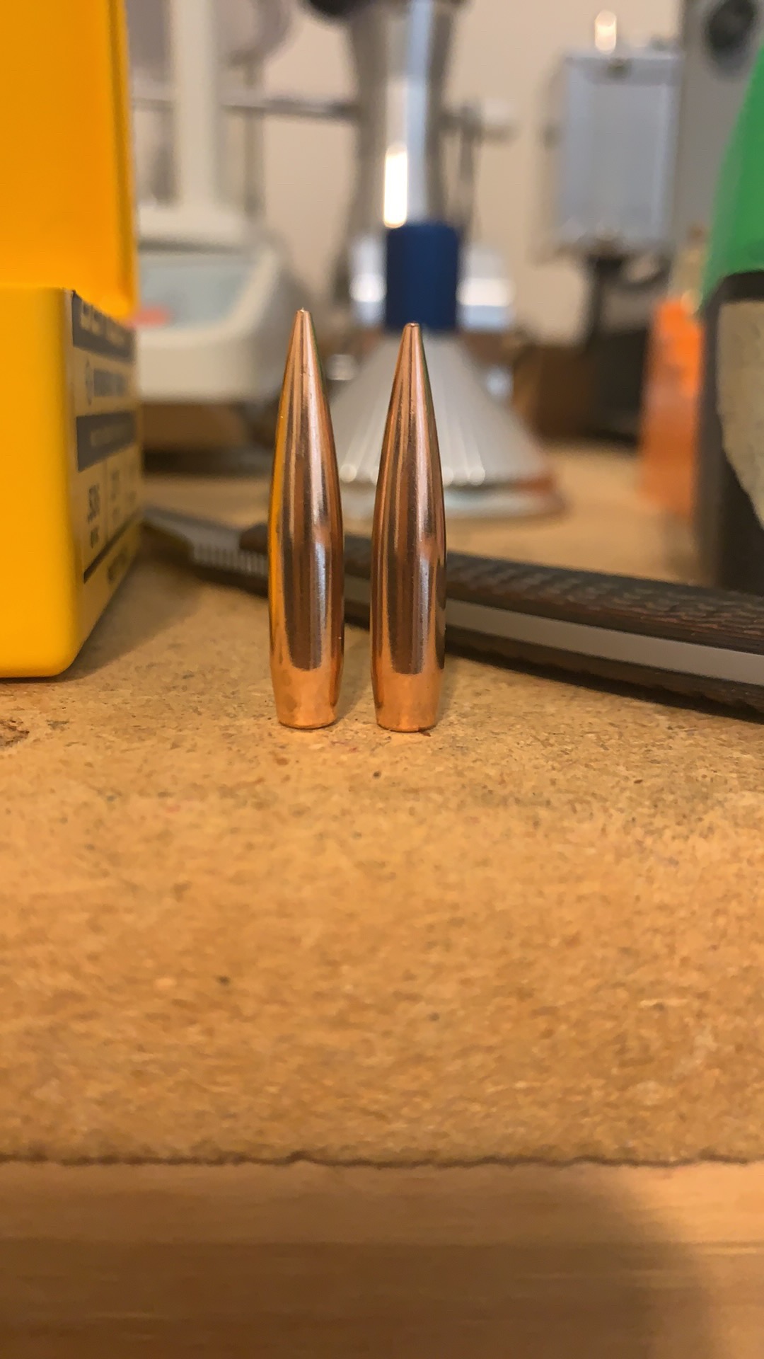

I was just curious to ask you guys what you notice on lot changes amongst bullet manufactures. I have found that as long as I seat the new lot at the same o-give distance to the lands, I really don't see a change in SD/ES or 100yd groupings. This is my experience with Hornady and Berger so far...
What is your experience?
a buddy of mine had a lot of 105 hybrids that were 0.040" longer than his previous lot.
he didn't see any difference in performance until he got out to 900+ yards. the vertical spread was significantly different at distance. enough to miss.
i think he ended up tweaking his BC for that lot
In receiving a different lot of 175 gr SMK's, I found there to be a difference of .035 in the bearing surface length (most of that difference was in base to ojive) and did an experiment to see what difference it might make. I found that there was a significant difference is seating depth, which affected average velocity and also due to that difference showed up on paper as a small shift in POI at 100 yds.
