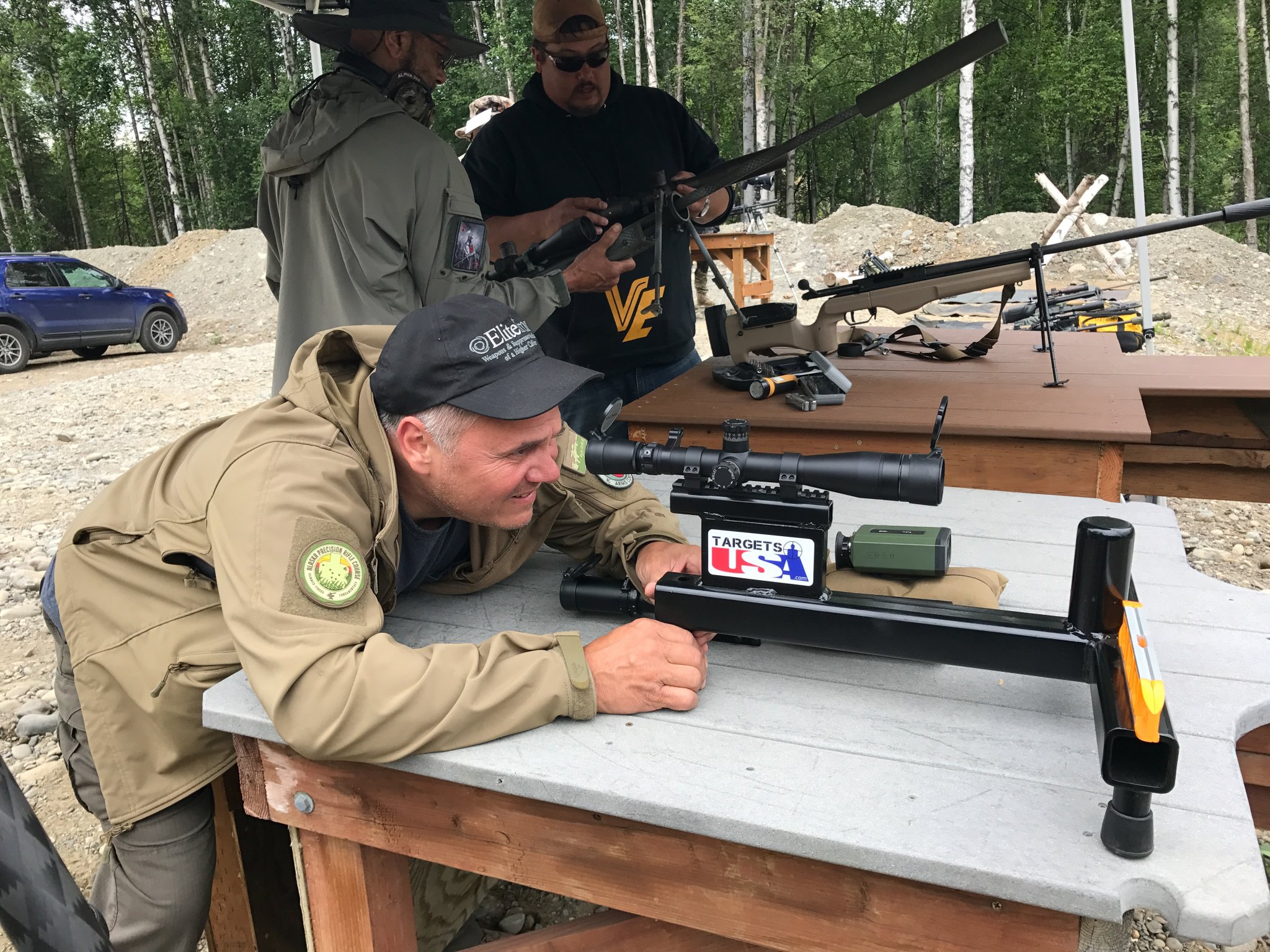

We tested them and most track SMOA why we made the tool, Leupold is one of the biggest offenders

No Leupold adjustments are designed in 0.250" @ 100yds per click.

edited to note the last ones we checked were the LRP model and it was adjusting in SMOA
7104735
I don't recall but I believe this MK 4 was SMOA As well, but it was older
