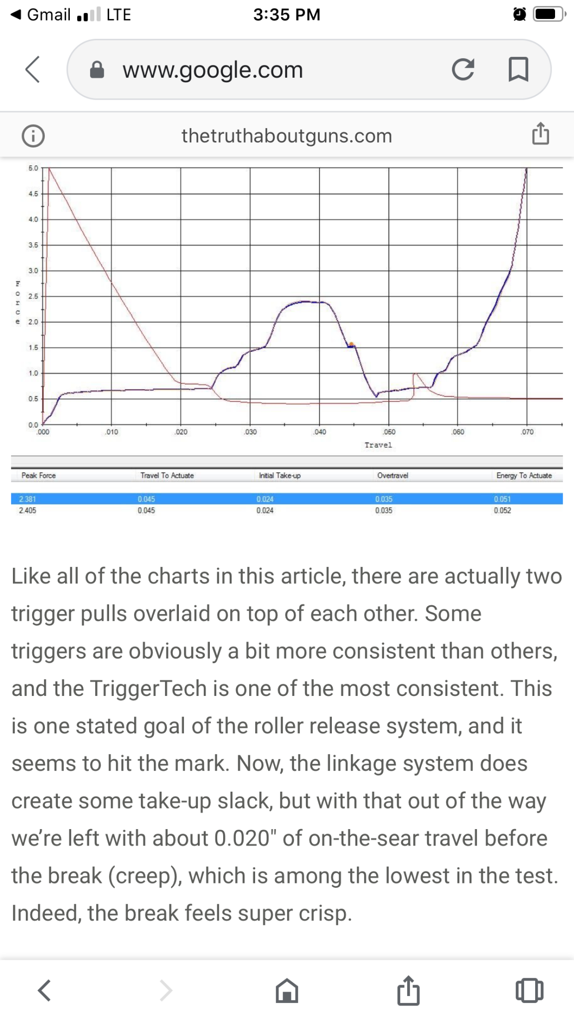

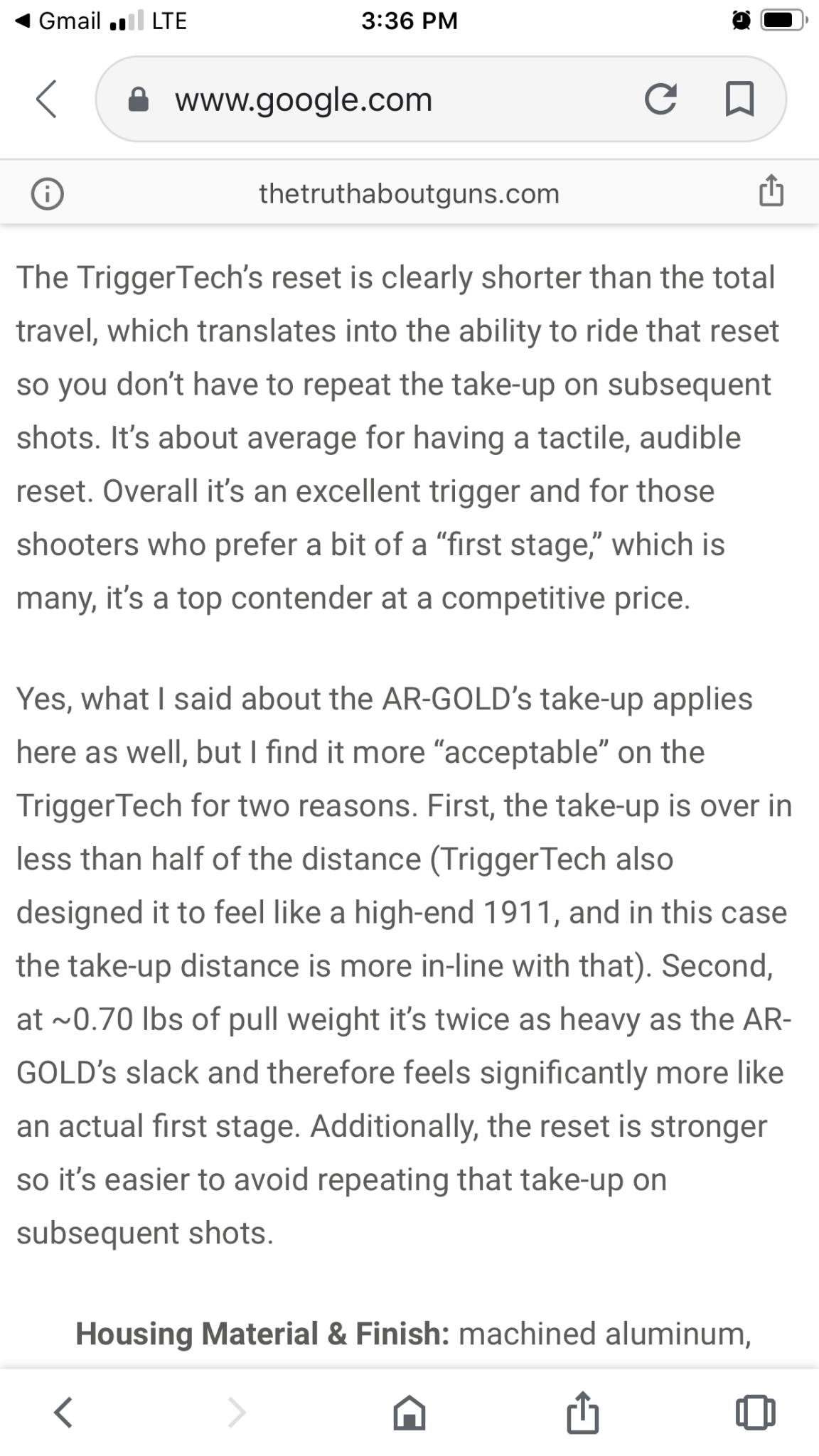

I was just relaying what I had read, ha ha. Actually some of the people who praised the LaRue downright hated Mark, which seemed pretty high praise for his trigger. I thought it odd that it could be anywhere comparable to a Geislle trigger, I tried about 12 various brands in the trigger display test lowers and I chose the ELF but can’t remember what all brands were in the display setup.. Have you looked into the Elftmann brand. I think them very high quality very precision parts? They have a secondary safety that prevents the hammer from falling due to a dropped firearm etc... user adjustable trigger pull. Clean crisp break, no creep, solid reset. Check out “the truth about guns blog, trigger test. They used actual equipment to make a graph of what many brands did. Creep, break, over travel, reset distances, then a subjective user review as well. It was pretty informative, but they tested only single stage models.
Here is the graph and details of the trigger tech from said review.
