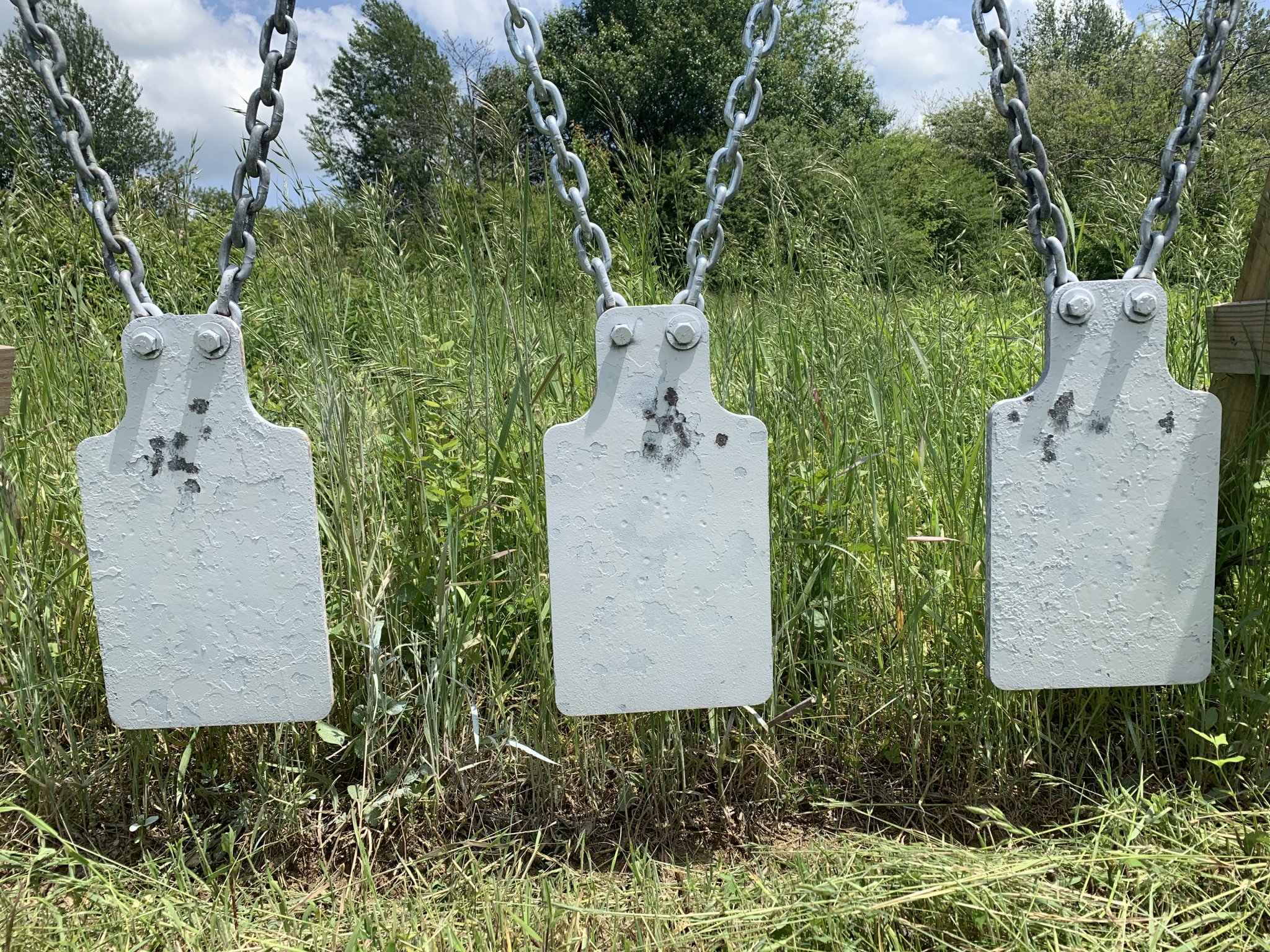

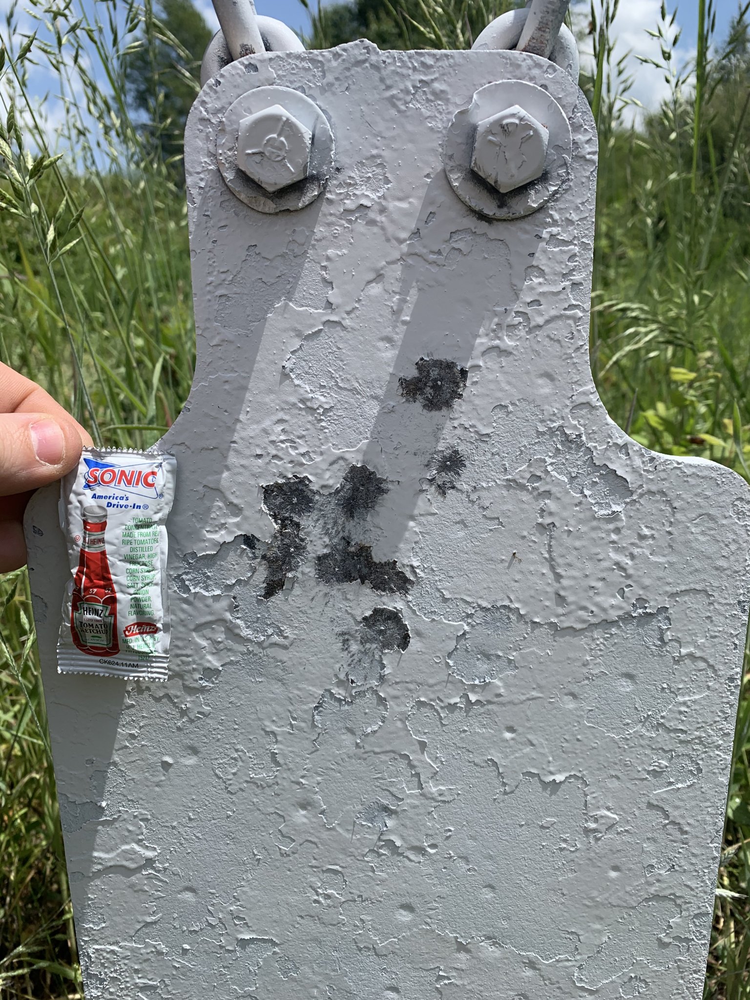

Shot some 200yd groups today with R50 and a steady 3mph breeze. Got a different lot and it did pretty well. Call it minute of ketchup packet lol

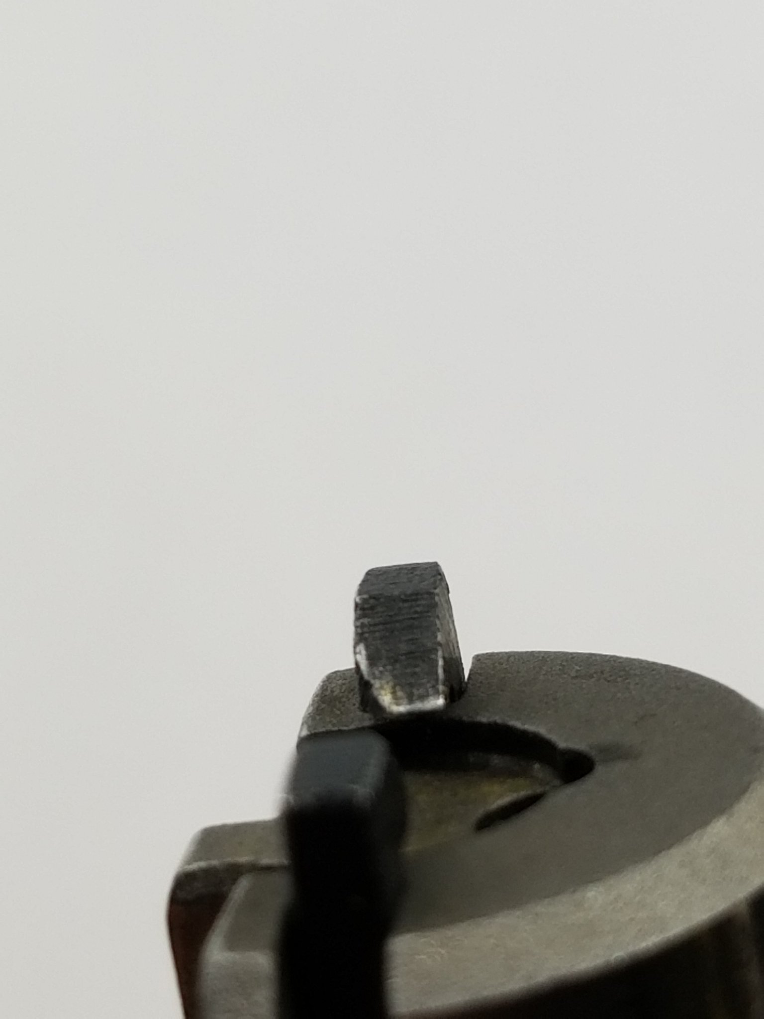

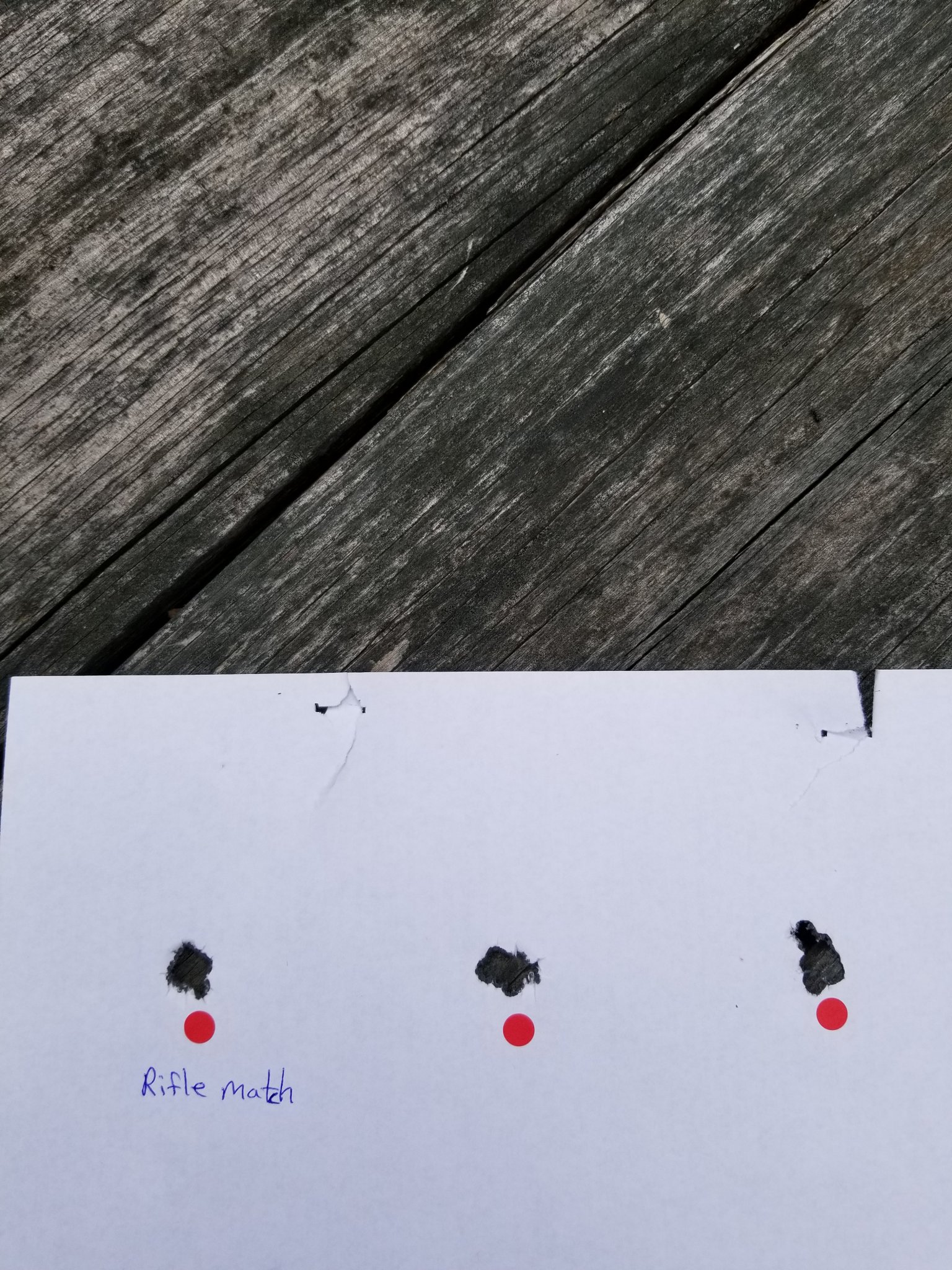

I was able to get mine out today and shoot a little. It was only about 30 yds. but that's all I got for now.
Started with some cci sv to get me zero and then shot a few 10 shot groups.
I also shot some rws subsonic hp and eley subsonic hp. All of them shot pretty consistently. My only problem was I was getting failure to ejects with just the sk. I think my extractor is worn or damaged so I ordered a new one. Hopefully that will be a simple fix.
