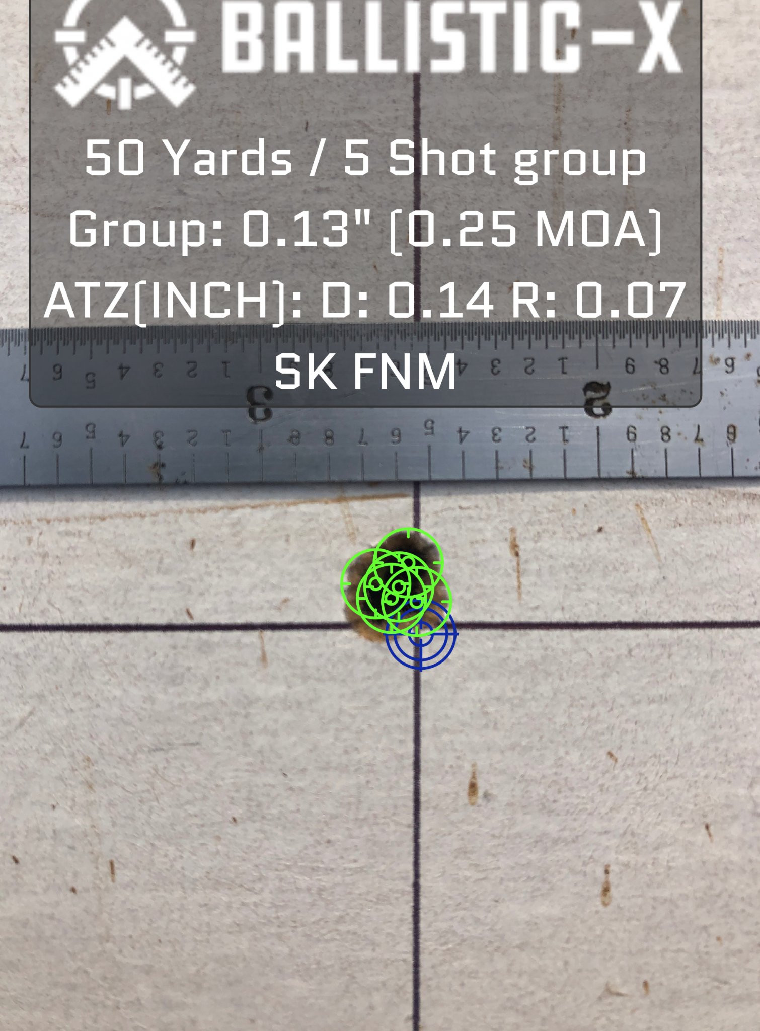

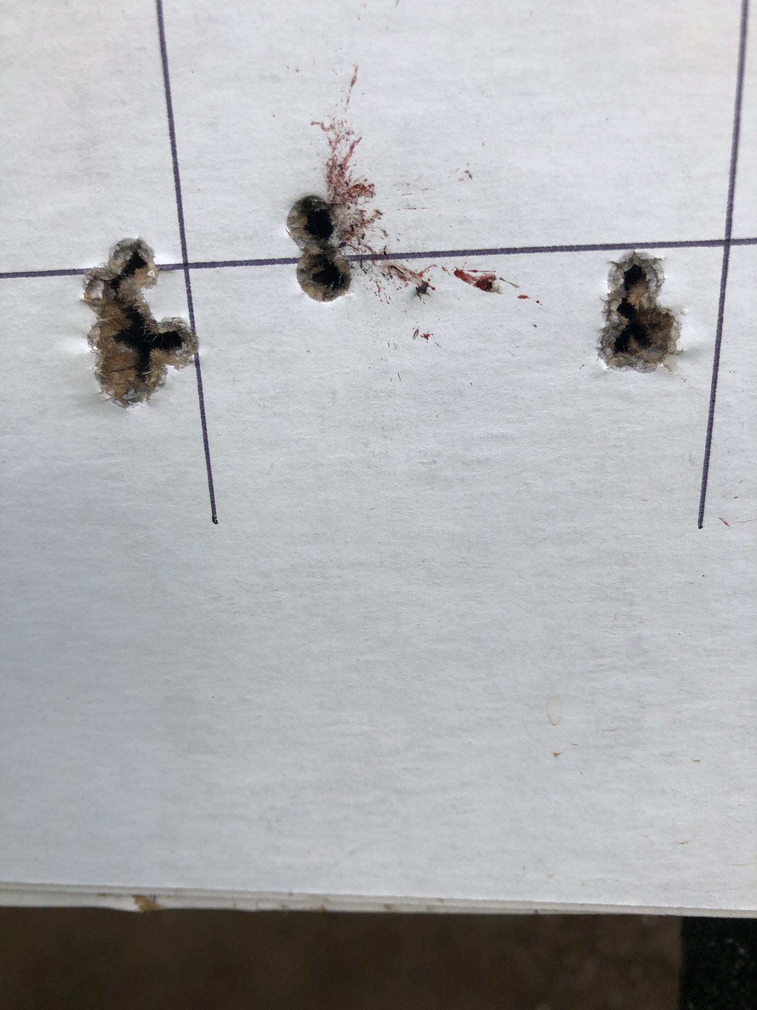

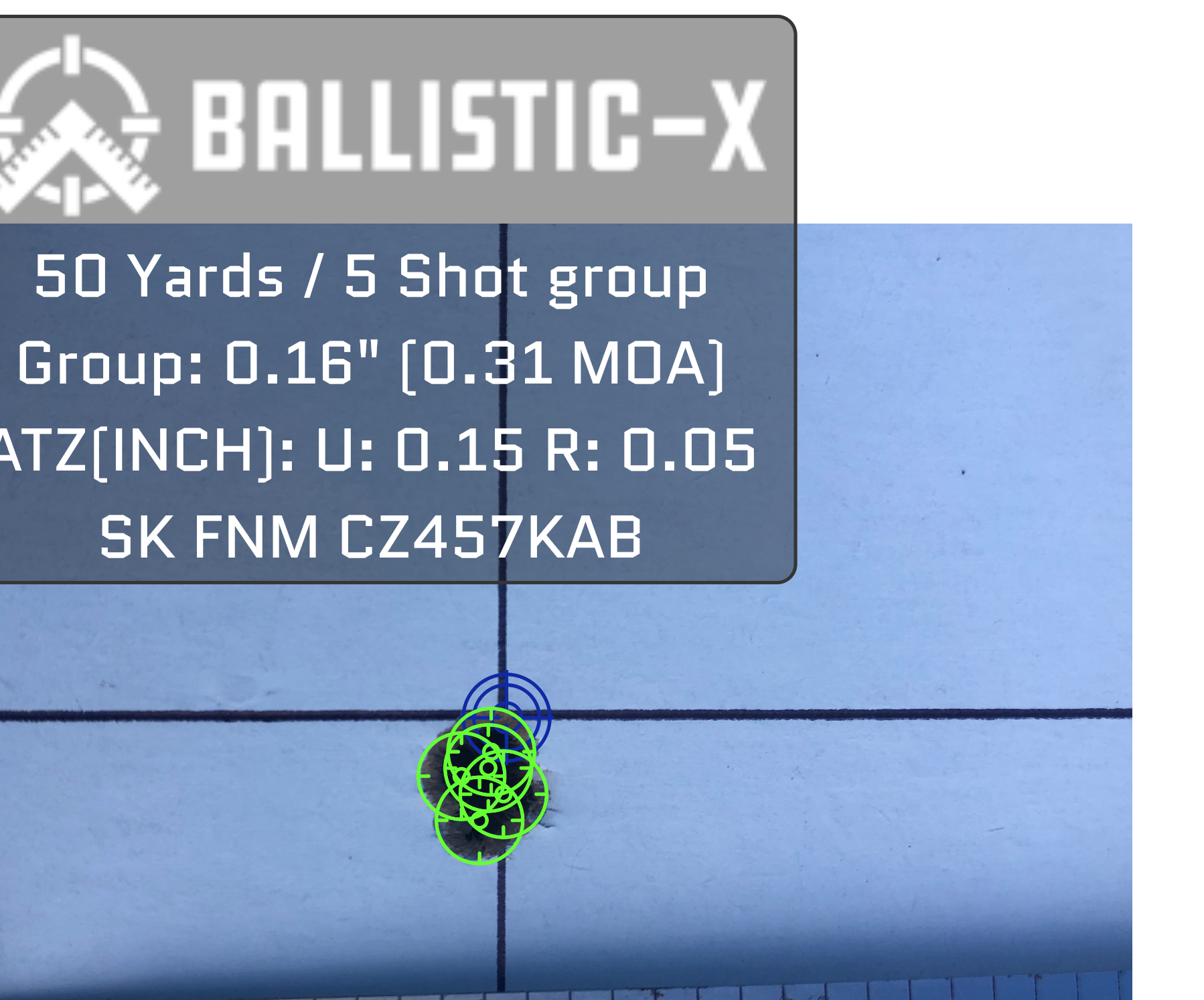

Got mine together and out on the range this weekend SK Flatnose match is shooting good
Here’s a couple of groups
10 rnds on the left and 5 on the right of SK flat nose basic with a cpl of “flyers” in between

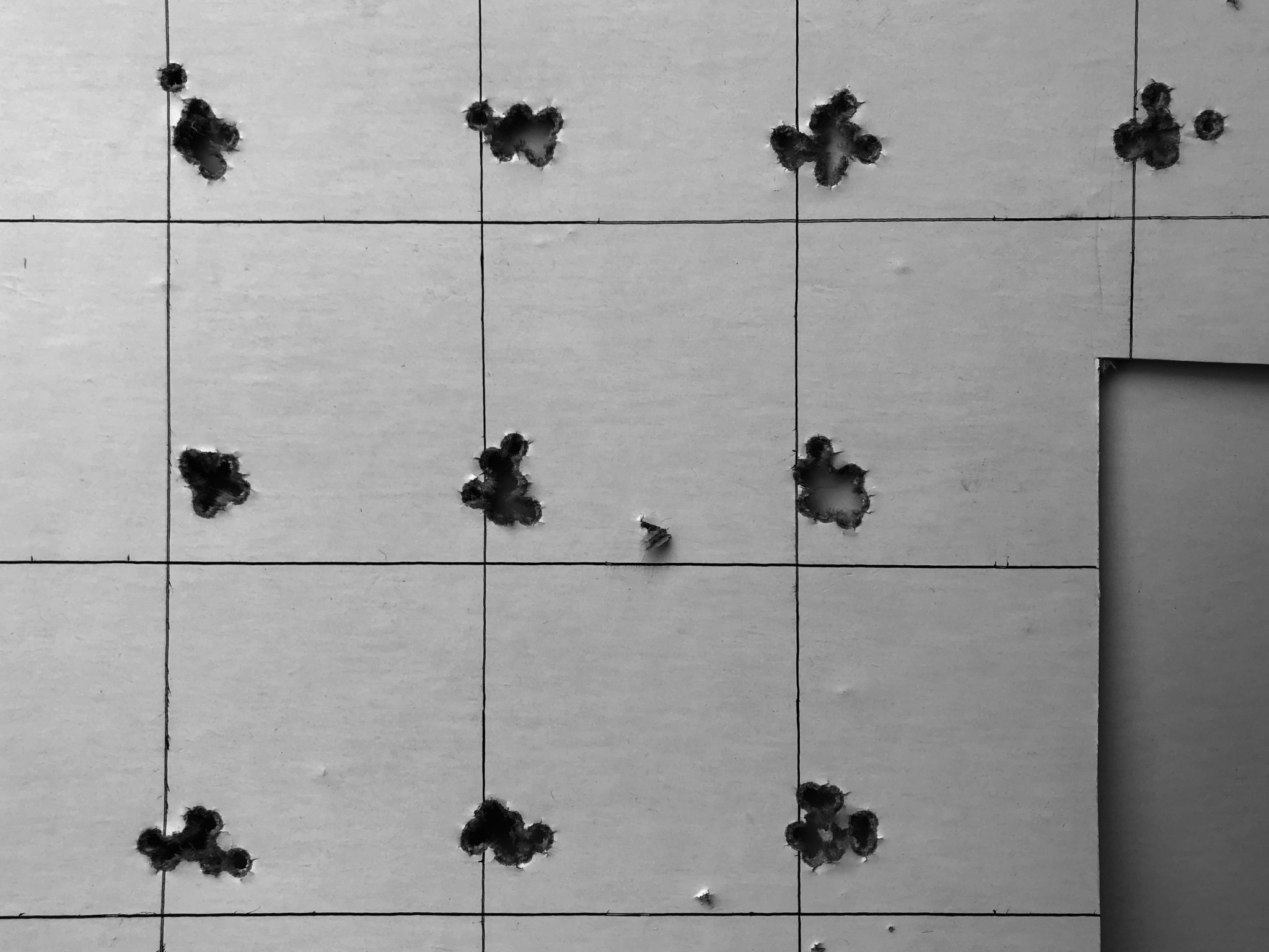

First of all, thanks @padom for making this GB happened. After getting my rifle back i wanted to try it out but did not get a chance to due to corona situation. Finally got to shoot it the other day at 100 yds and holy sht, i feels like cheating. The ammo i used was Sk standard. I am pretty sure most if not all my 5 shots group at 100 yd was sub 1" with many go for half. I'll include picture when i get a chance too. Thinking about going back out there with Center-X to see if i can get even better group. Just want to thanks padom for making this happen and see the potential of a 22lr cartridges.
