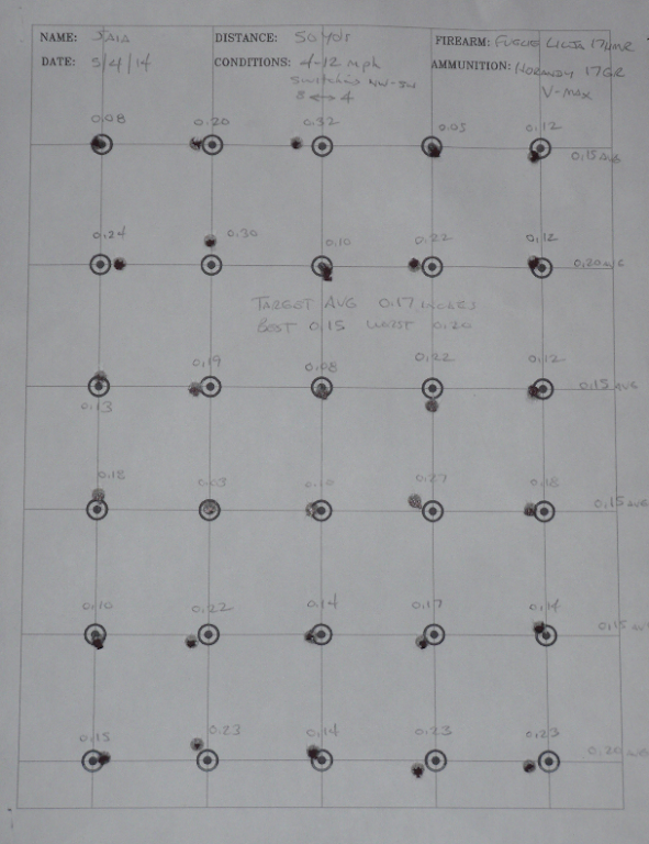

Clear and sunny this morning, with a breeze switching back and forth from my 4 to 8 o'clock.
Made it rough to judge wind as the ribbon kept swinging back and forth, too.
The elevator worked well.
Round head of the carriage bolt kept the wheel clear of the bench.
On the bench with the Lilja 17 hmr locked in the block
After 20 rounds of warm up, the first target of the morning
Followed by an unasked for critique of what I was doing wrong, by the bench rest gallery.
Then a second target attempted. They must have offered some valid points.
The distance from poa to poi got appreciably smaller.
Each trip with the fuglie has shown improved target averages.
Anything that produces continuing positive results is a good thing.
When I caught a lull in the breeze, rounds hit where the crosshairs were.
