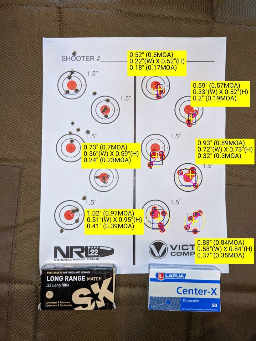

I met this person who shot this and can verify.
This is my last outing, when I was ammo testing

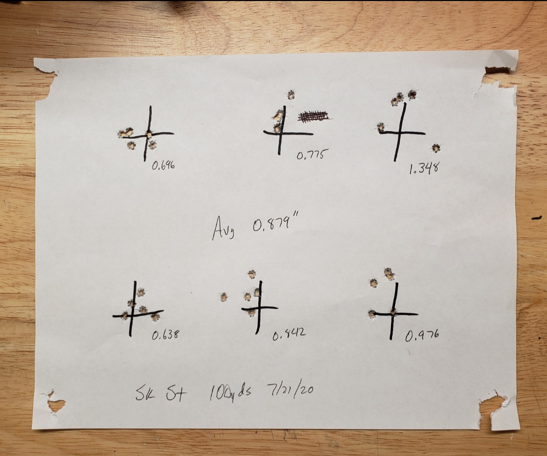

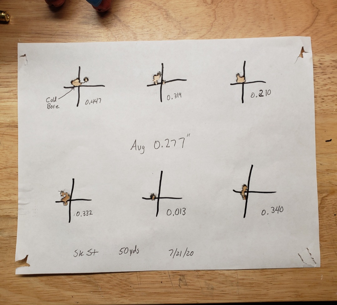

Quick update: I ground out all of the bedding under the barrel, removed the headspace shims and switched to a Bartlein Barrel (glued in). This is the largest improvement so far. 50yd avg 0.277", 100yd avg 0.879"

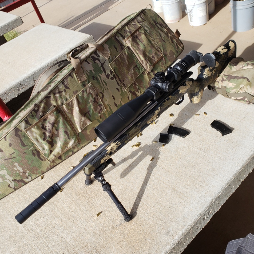

Have you tried for groups without the can. My rifles shoots more accurately without my TBAC TD22 can
This one shoots about the same with/without the Oculus. Not the case for the YHM Mite I had on it before.
