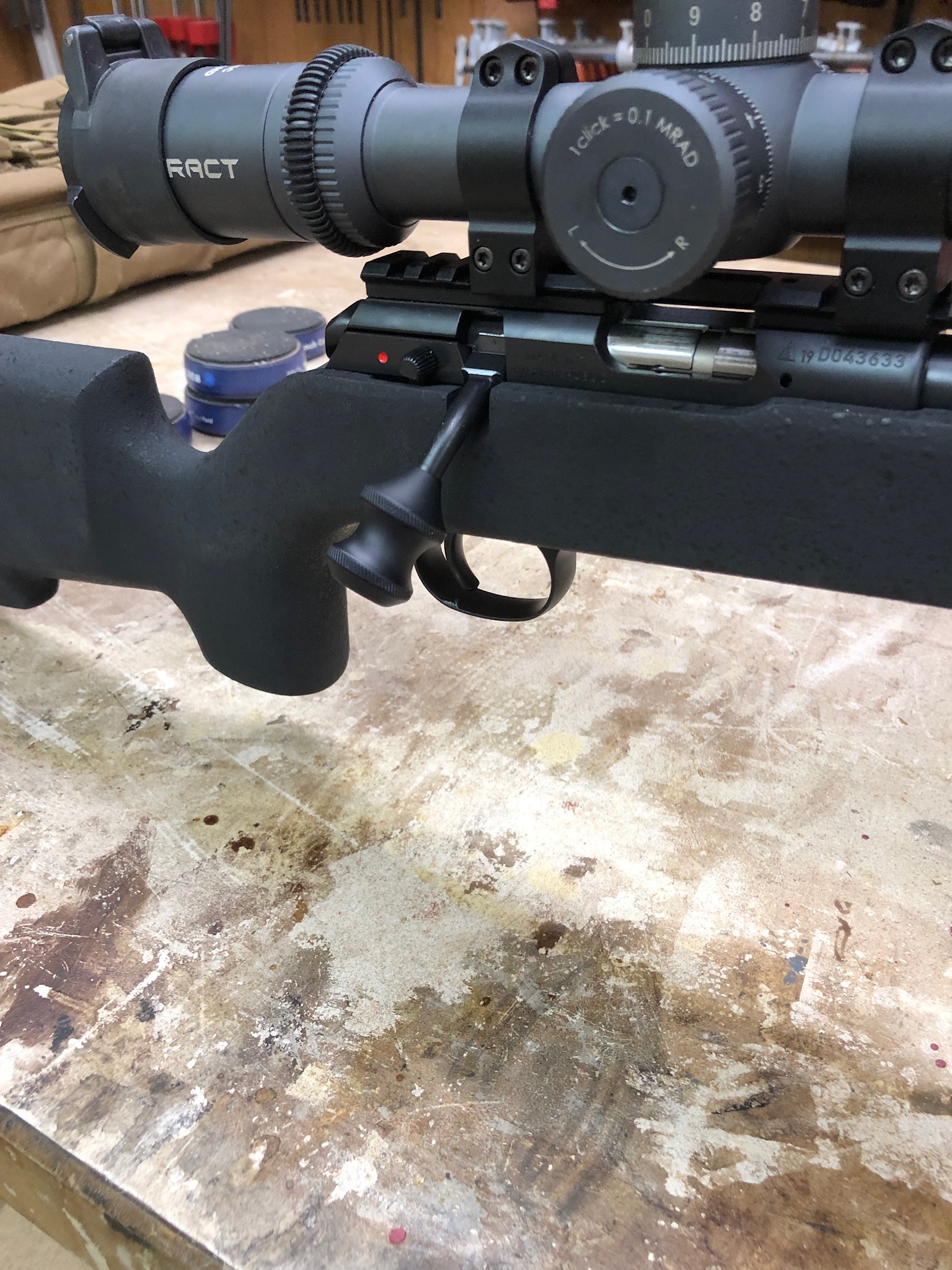

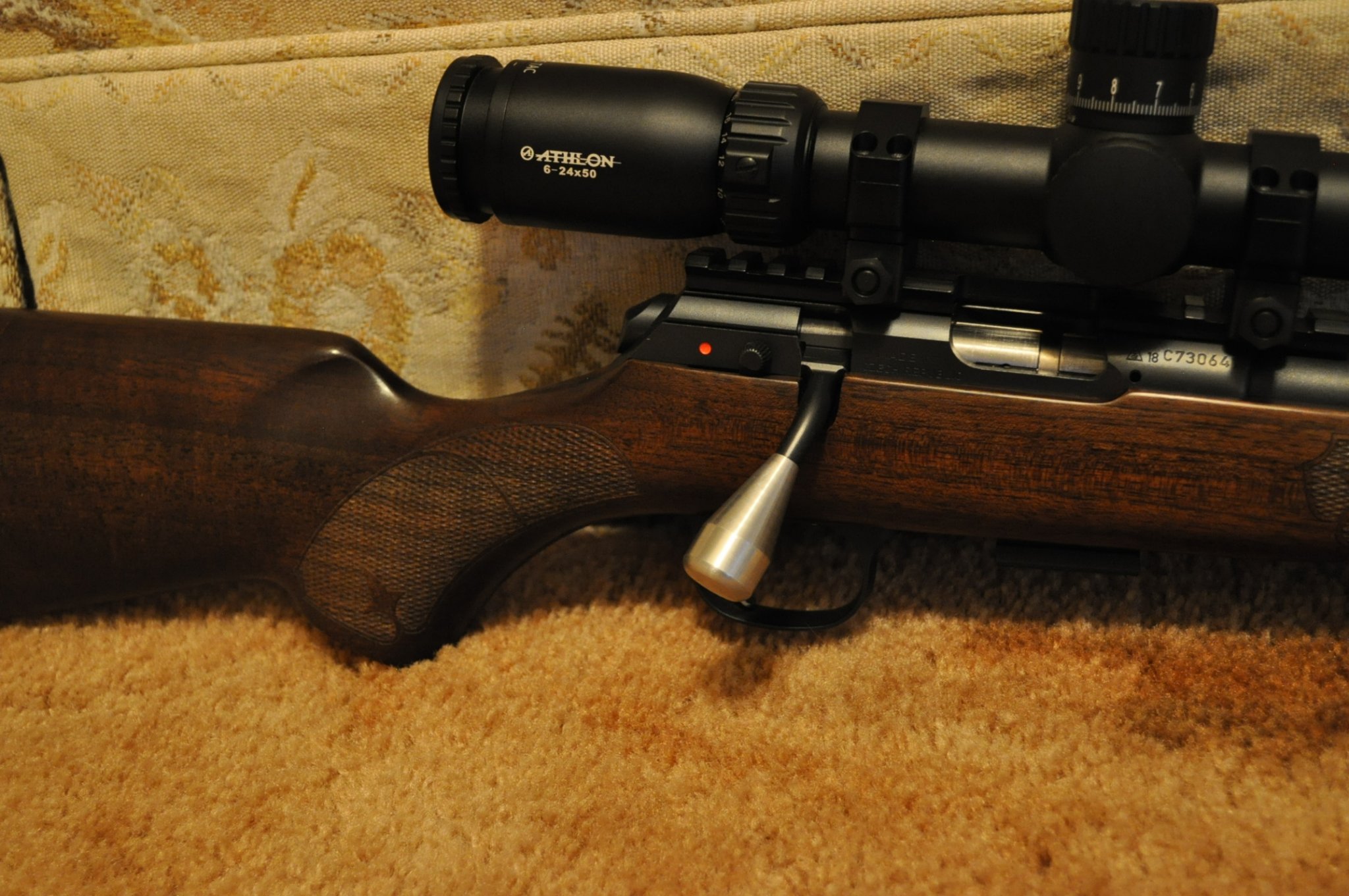

The last time I shot this rifle along side a V-22 sporter, the effort required to open the bolt was obviously higher than that of the V-22. So yesterday, I chucked-up a piece of 3/4" 6061 rod & turned an extended bolt knob. I'll wait until I've got another job requiring graphite black CeraKote to paint the new knob & then use either loc tite or J-B Weld on the threads, but for now, it's a big improvement in easing the cycling of the bolt, yet isn't so large as to completely ruin the appearance of this nice sporter.

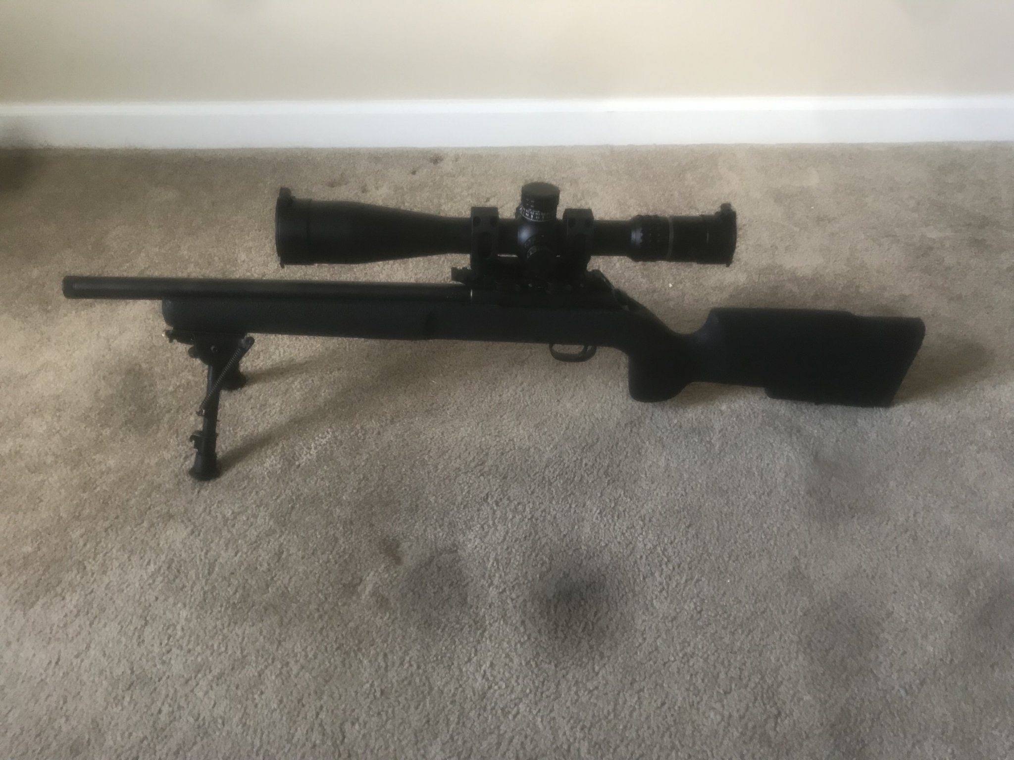

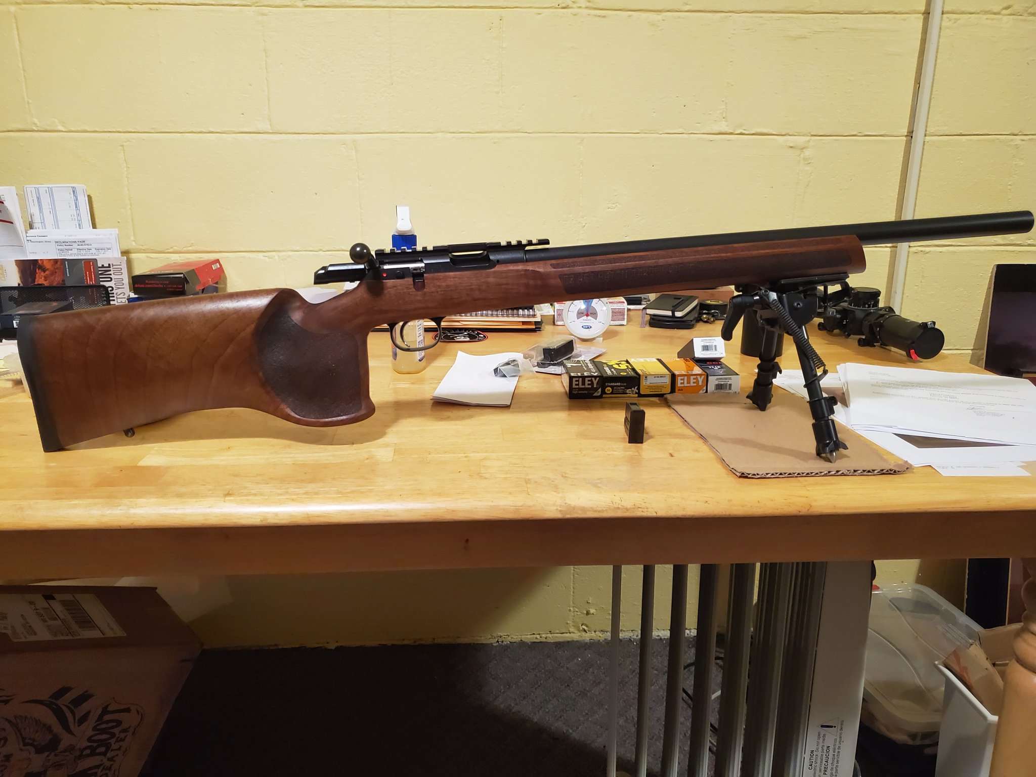

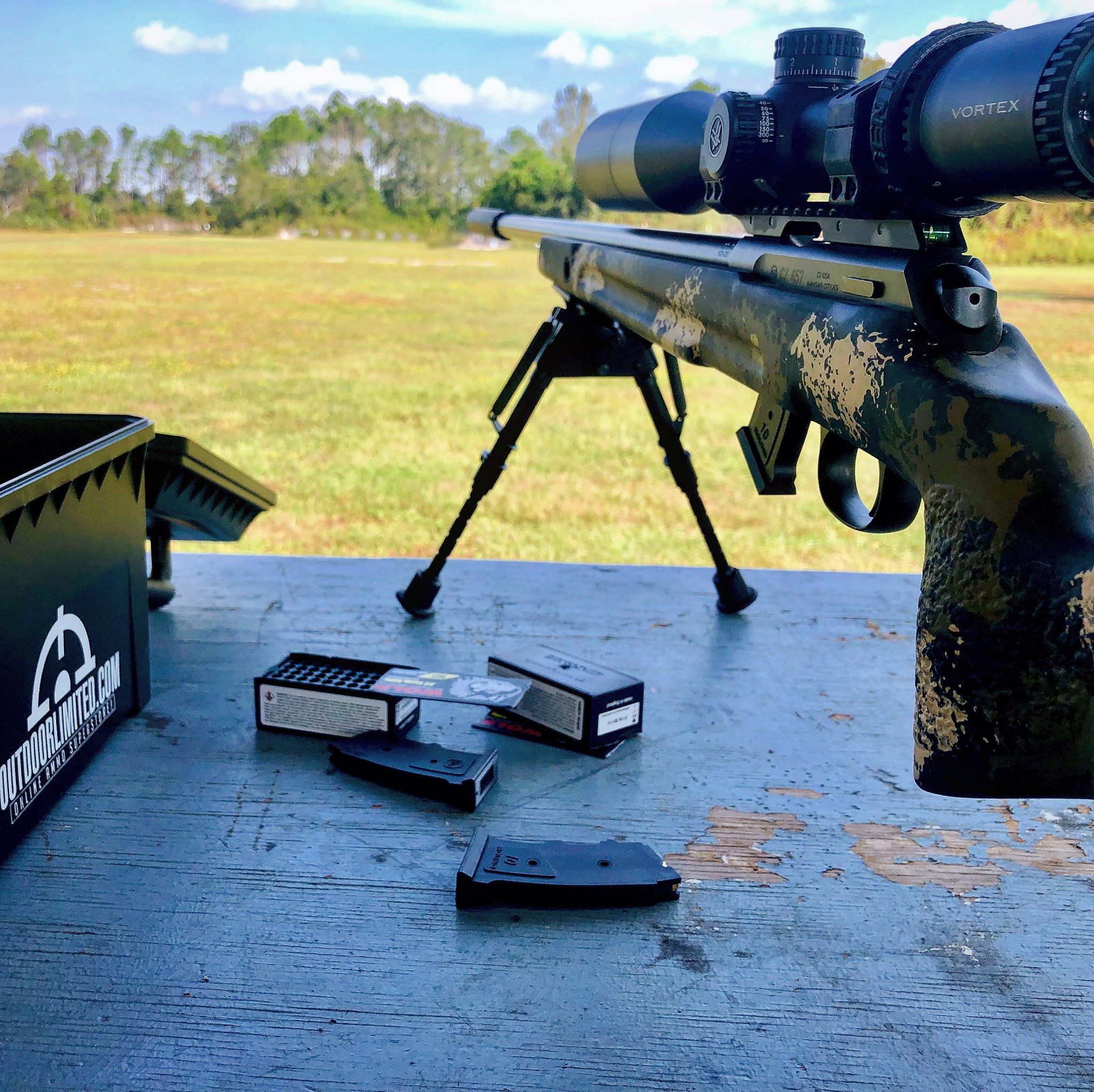

I purchased the 457 PV a few days ago. At this point, it appears to favor SK Standard Plus. The scope is an older "coin click" Leupold 3-9x33 EFR. A solid compact rig that has enough weight for me to hold steady and a shorter barrel for maneuverability in the squirrel woods.

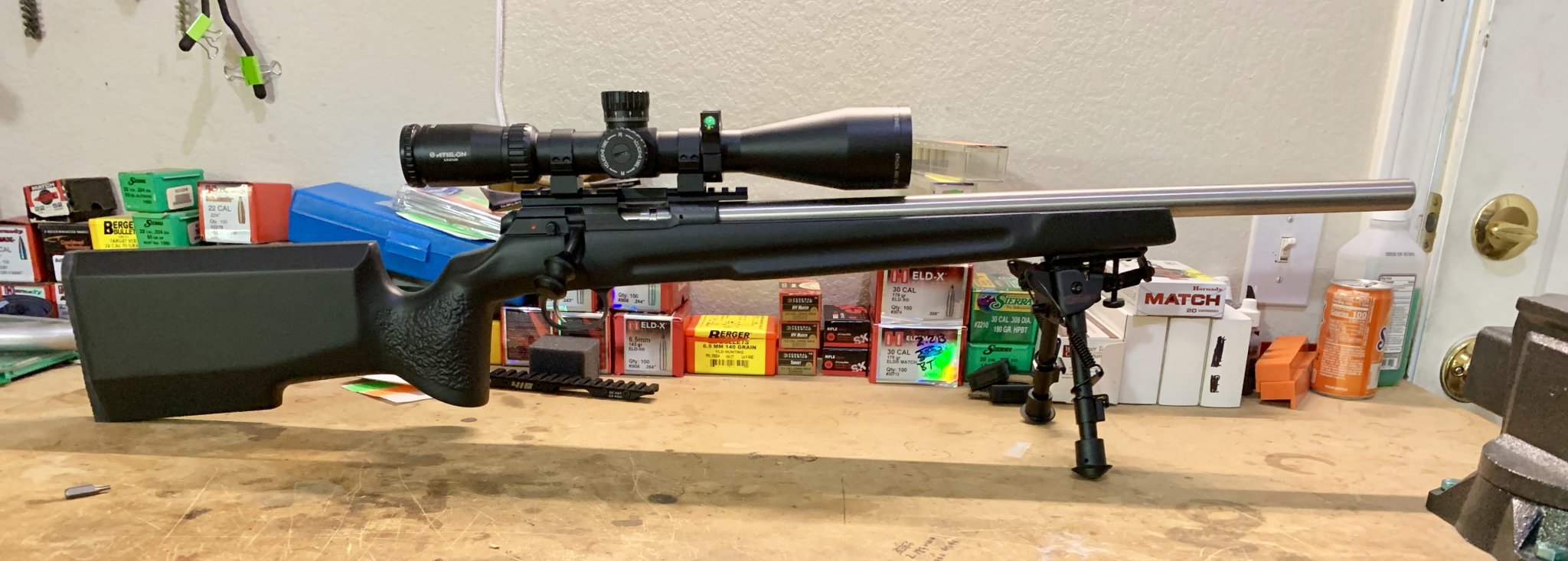

My 457 will be here on Monday. My plan is to either put a Lilja or Bartlein barrel on it. I got the Pro Varmint so I’m still thinking about the stock I want but will probably shoot it for awhile in the Boyd’s stock after bedding it. I hope you can put up some accuracy reports on that new barrel after you get to the range. Did you install it yourself or have a smith do it? I figure I could do it myself but may be able to squeeze a little more accuracy out of it if I have a smith fit it without using shims and get proper head spacing. Also, did you bed it? I know in the Manners it isn’t absolutely necessary but have seen reports that it does improve accuracy.
Reactions: 1911Operator
I installed the barrel using their shims and the stock is not bedded but came with pillars installed. I actually probably won’t bed the stock unless I just really see a need to.
It very well may not need it. I have a few rifles in chassis that shoot so well I don’t want to mess with them. I do have a few others that I bedded. The increase in accuracy with these is noticeable but was not a huge improvement. I think I’m going to get a Bartlein barrel from Craddock precision. Hopefully once I do that and put in a chassis (probably an MPA) I can get close to Vudoo accuracy. What length barrel did you put one your rifle? It looks good in the Manners. You struck the perfect balance between the stubby 16” and the overly long 24” barrel. If you have time I would love to see an accuracy report after you get it to the range.
Right now it’s length is their standard 21” that you order from them. Haven’t decided if I’m leaving it at this length or going to cut it back to 18.5” . I’ll see how it shoots first but I’ll be having the barrel and action cerakoted in Sig dark grey here pretty soon. My factory barrel shot some pretty good groups . My best Snipershide 6x5 challenge is in the .2’s but that barrel never really liked any of the really good ammo like Center X and such. It shot SK Standard and Rifle Match really good but both of those would start falling apart after 200 yards. I’m hoping with the lilja I can find something with a bit better extreme spread for shooting out past 300 yards.

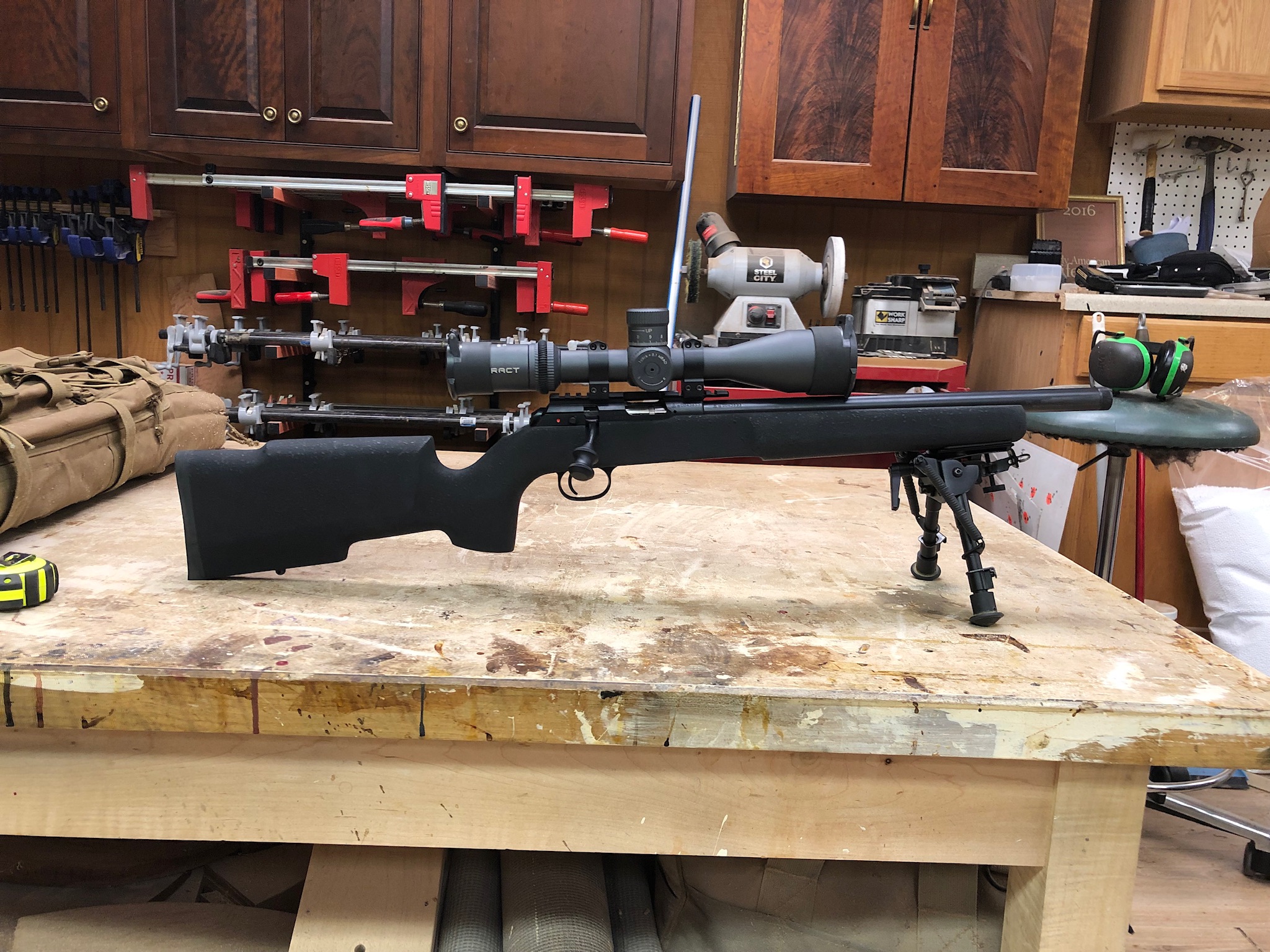

I will be picking my 457 up in about an hour and have the DIP 25 moa rail. I have a set of the XLR precision scope rings. The ones I have are 34mm medium height. I’m pretty sure they will be a good fit. I will let you know later this evening. The scope is a Bushnell DMRii.

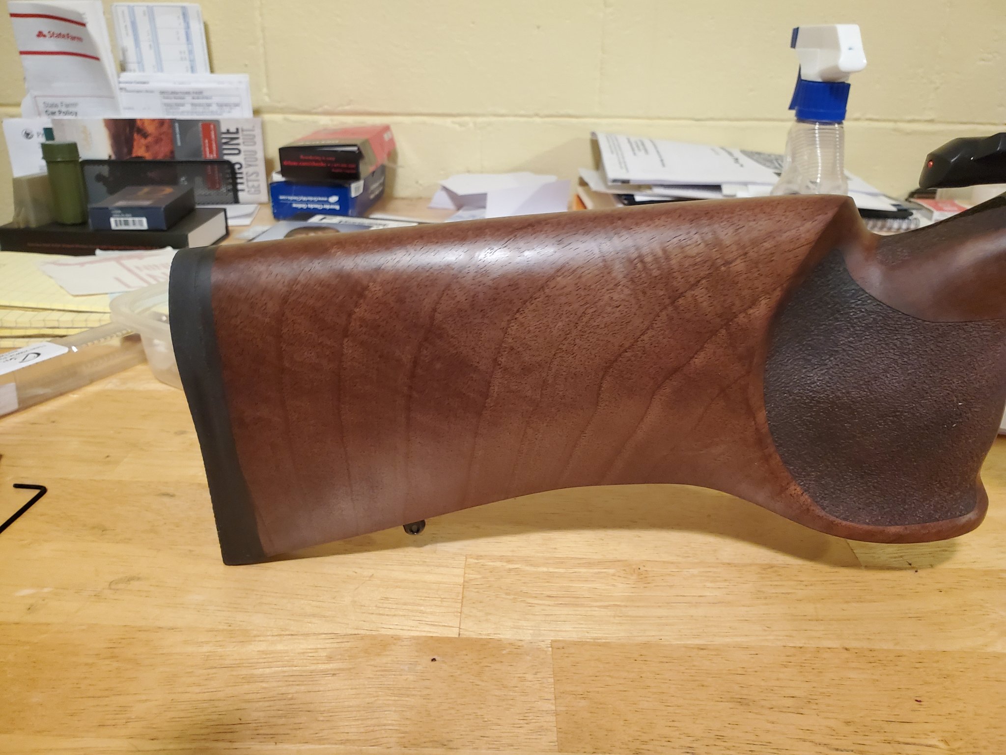

A shooting buddy had a 457 American at our match Saturday. I thought the aesthetics were very nice and the wood on his was outstanding for a "rack-grade" rifle. It has nice figure and well executed checkering. Also, the little extra sculpting on the action, proper safety (ala R700 type) and rich bluing pleased the eyes. The proof, as with any 22LR, was in the pudding. That damn thing is a shooter for sure!

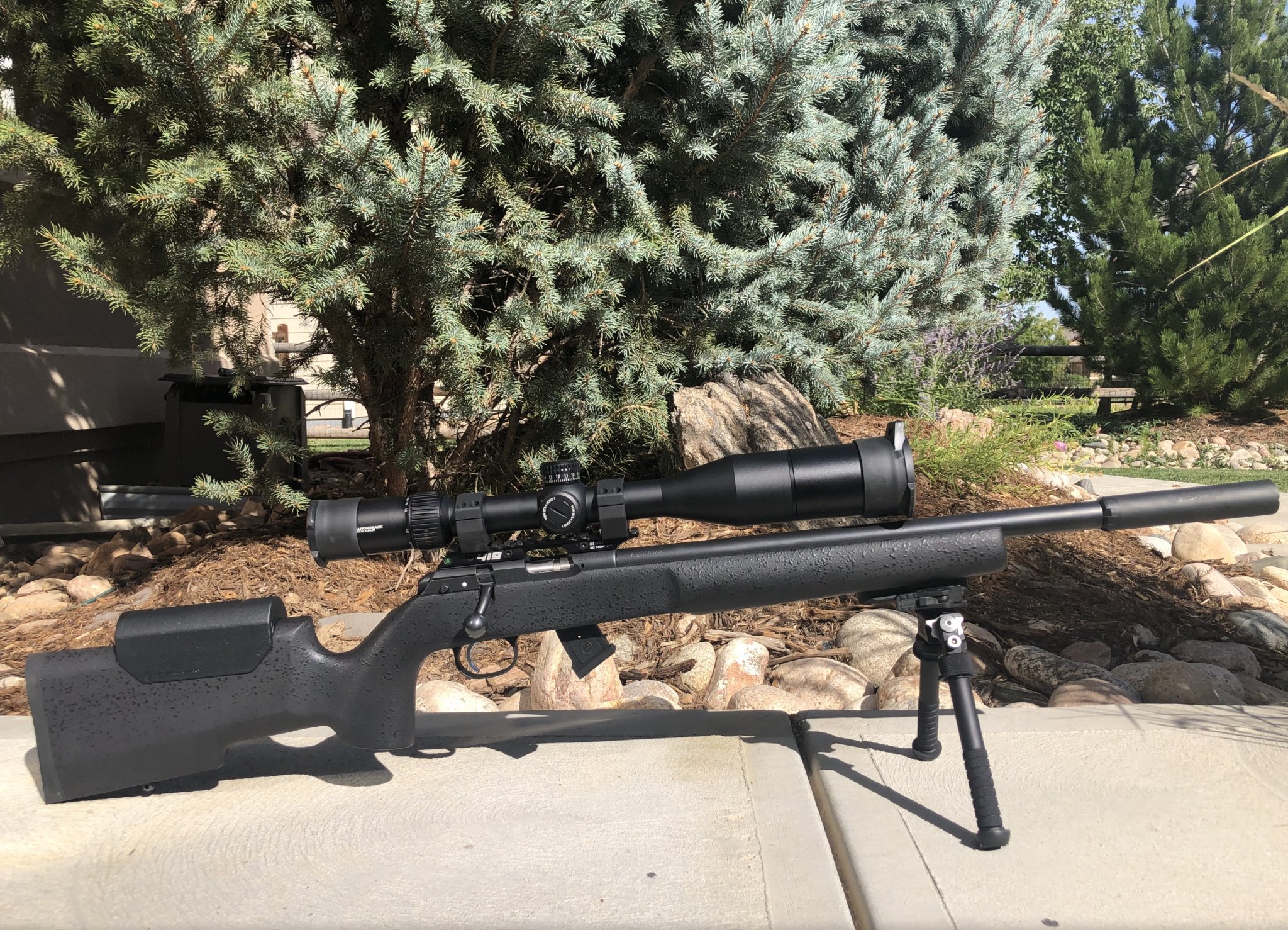

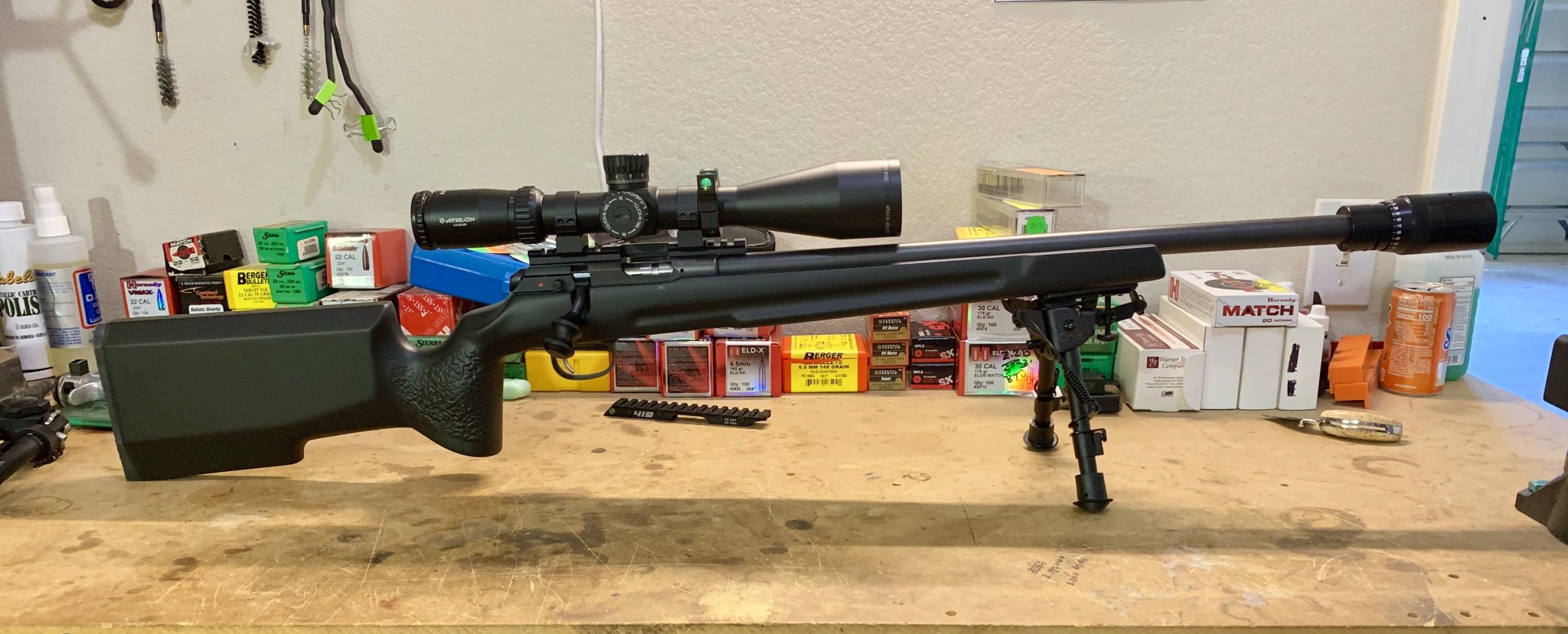

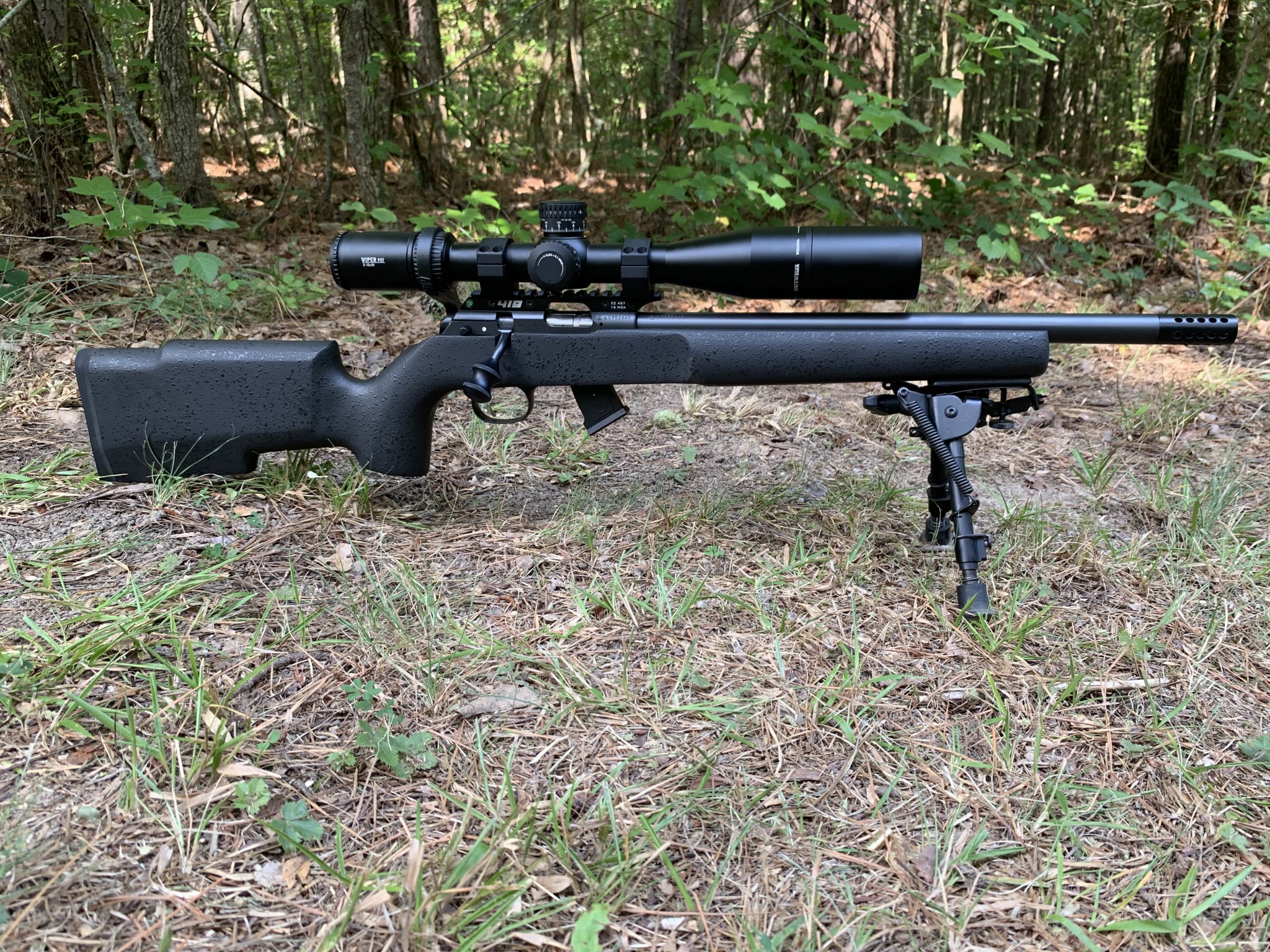

CZ457 Pro Varmint
Area 419 30 MOA Base
Vortex Precision Matched Rings
Vortex Diamondback Tactical 6-24-50
Silencerco Sparrow Suppressor
Victor Company Titan Stackable Cheek Rest

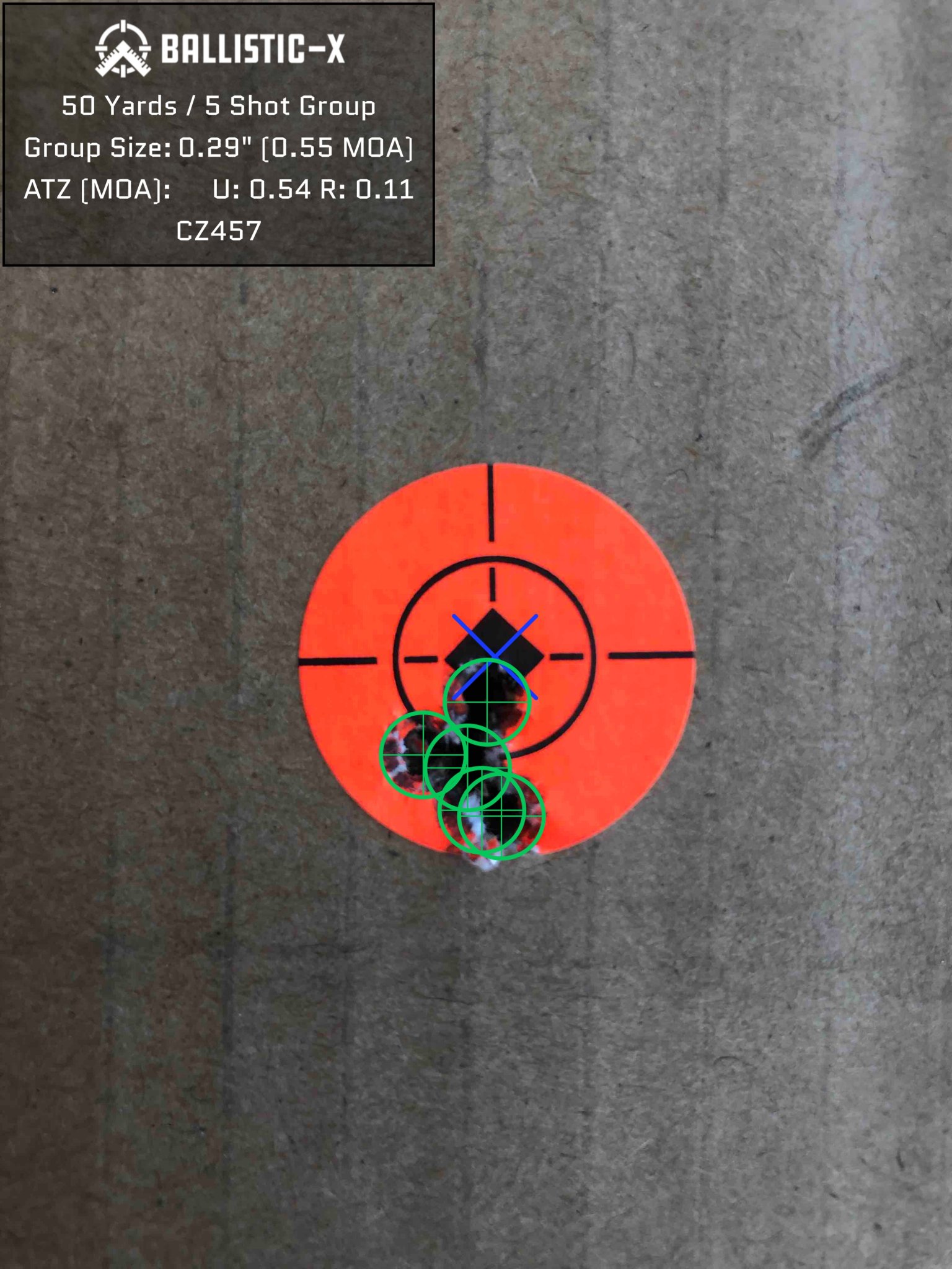

Shoots close to .5 MOA groups at 50 yards with CCI Standard Velocity and have enough elevation dial in the scope to reach out close to 300 yards, but that's at 5000 ft elevation. Been shooting clay pigeons out at that distance. Too much fun!

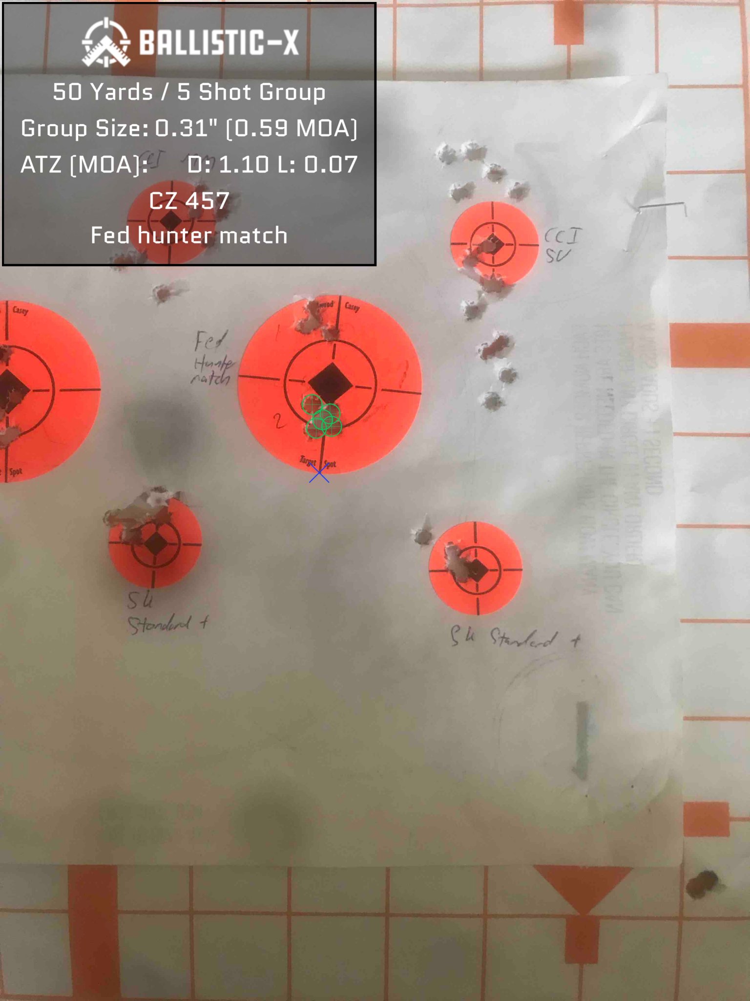

Just got my varmint pro last week. Put an are 419 base and burris XTR II on there. CCI SV shoots well enough but it seems to like federal hunter match and SK standard plus. Shot two groups with SK
but part of the second got torn off. I'll have to go back and shoot some more groups with the SK.

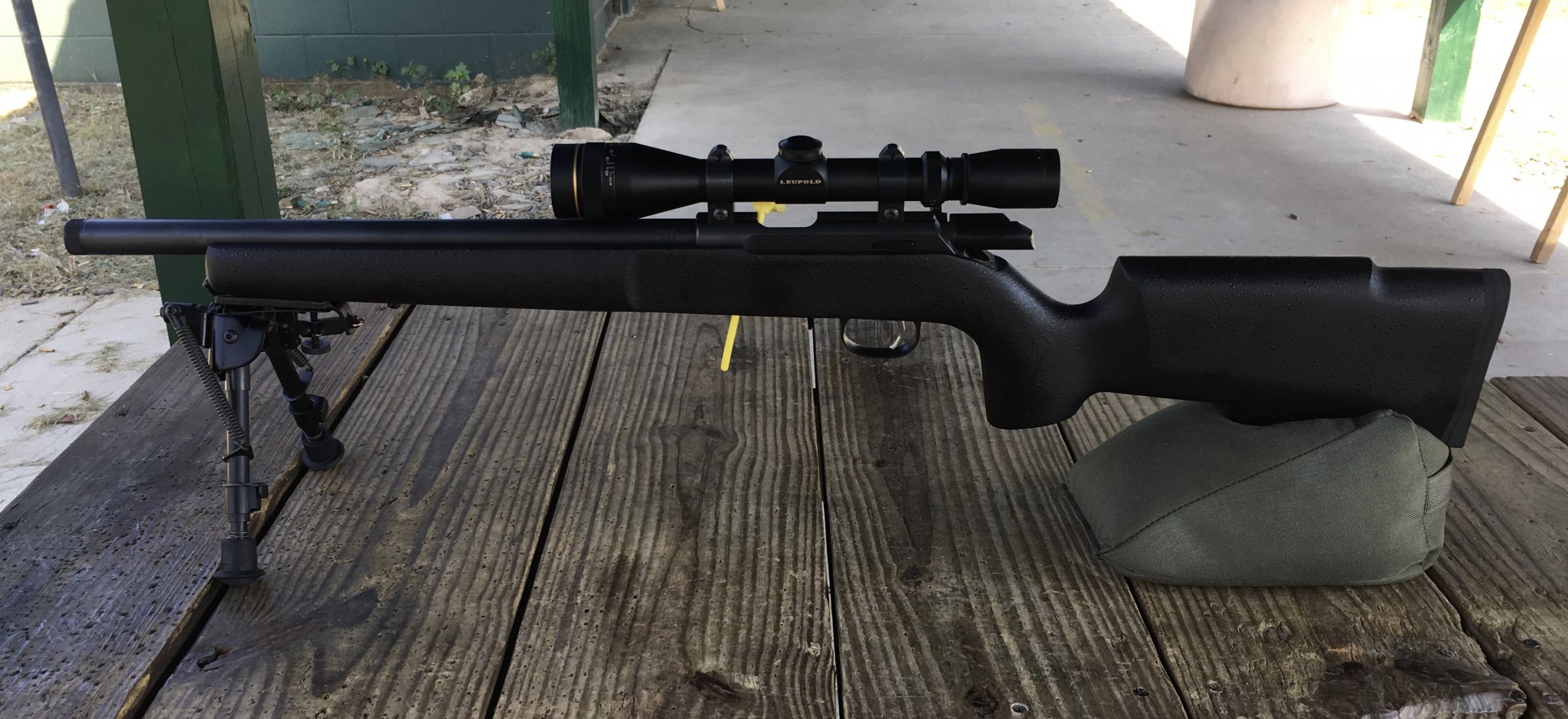

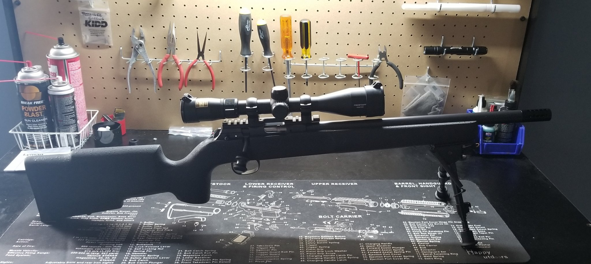

I took my Pro Varmit out today for the first time.. just mounted up a Nikon 3-9×40 that I had on hand..have an Athlon Midas Tac 6-24x50 that will be going on after I get the rings later this week.. I shot 175 rounds of CCI sv and seemed good..some real good groups and then some opened up a bit.. Switched to SK Rifle Match and shot 50 rounds of it.. groups under a 1/2".. at 50 yards..very pleased with how this rifle performed..just took the bolt out and polished it a little to get the roughness out of it..haven't touched the trigger yet..

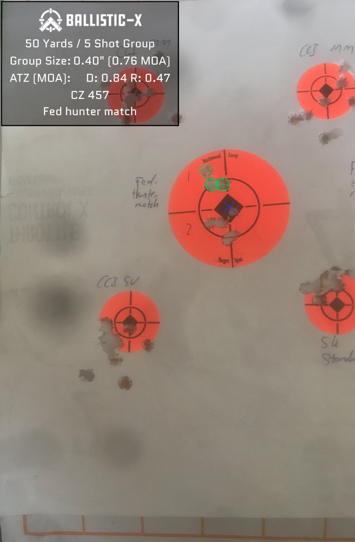

I took my new Pro Varmint out last Friday. I tried a little bit of everything through it it shot the CCI SV pretty decent. It also shot all the different Elay ammo decent but nothing to get to excited about. The SK ammo I tried it shot fantastic. I had a box of SK Pistol match special and I was simply amazed at how well it shot. Unfortunately I only had one box of the ammo. I ordered another brick and hopefully it will shoot it just as well.
