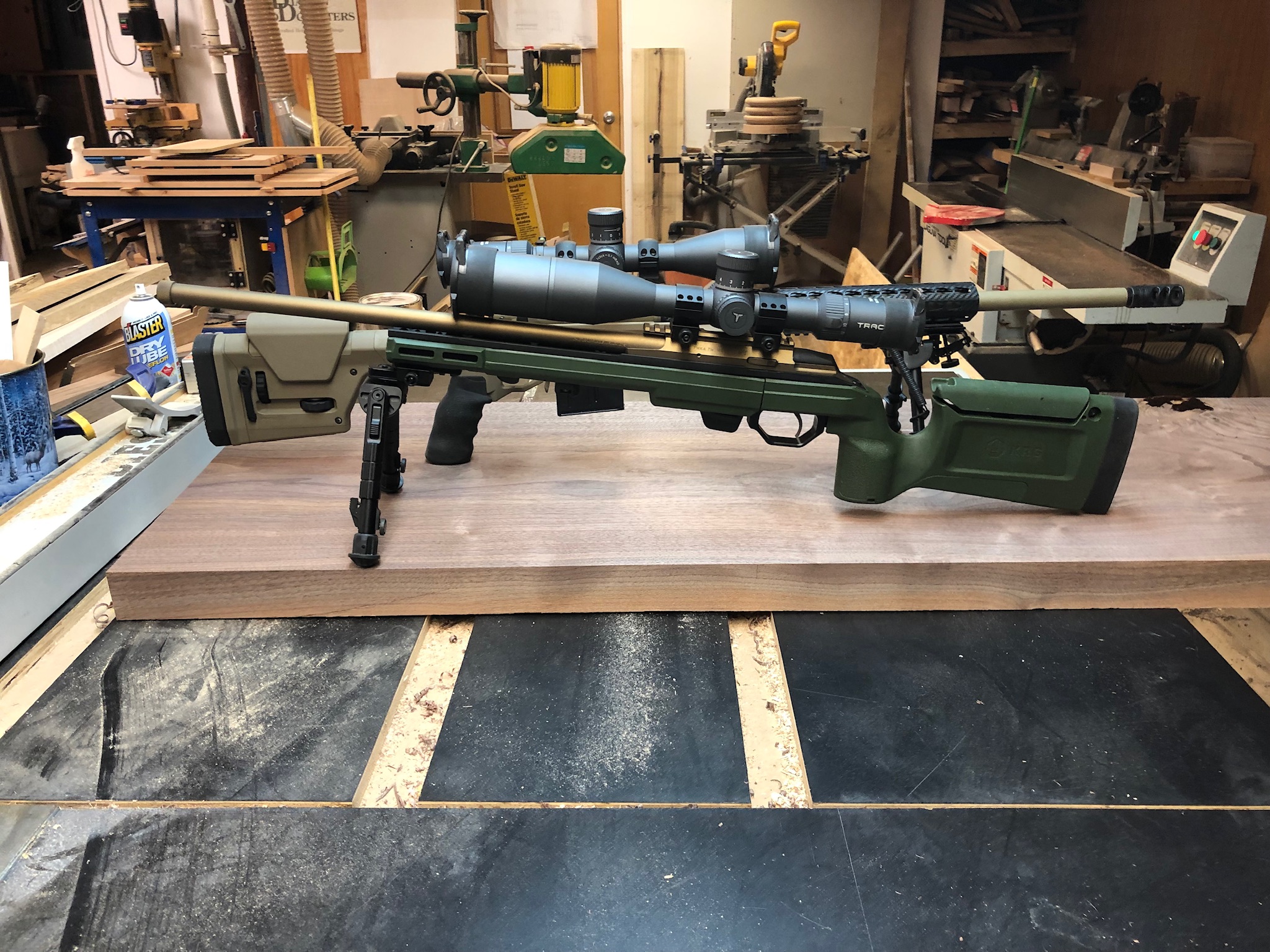

I have my Cronus on my MTR today but it is going onto the Royal. I have a Trijicon 5-50x56 on my
Vudoo and like it so much that I'm going to get another for the MTR. That is a good looking American you have.

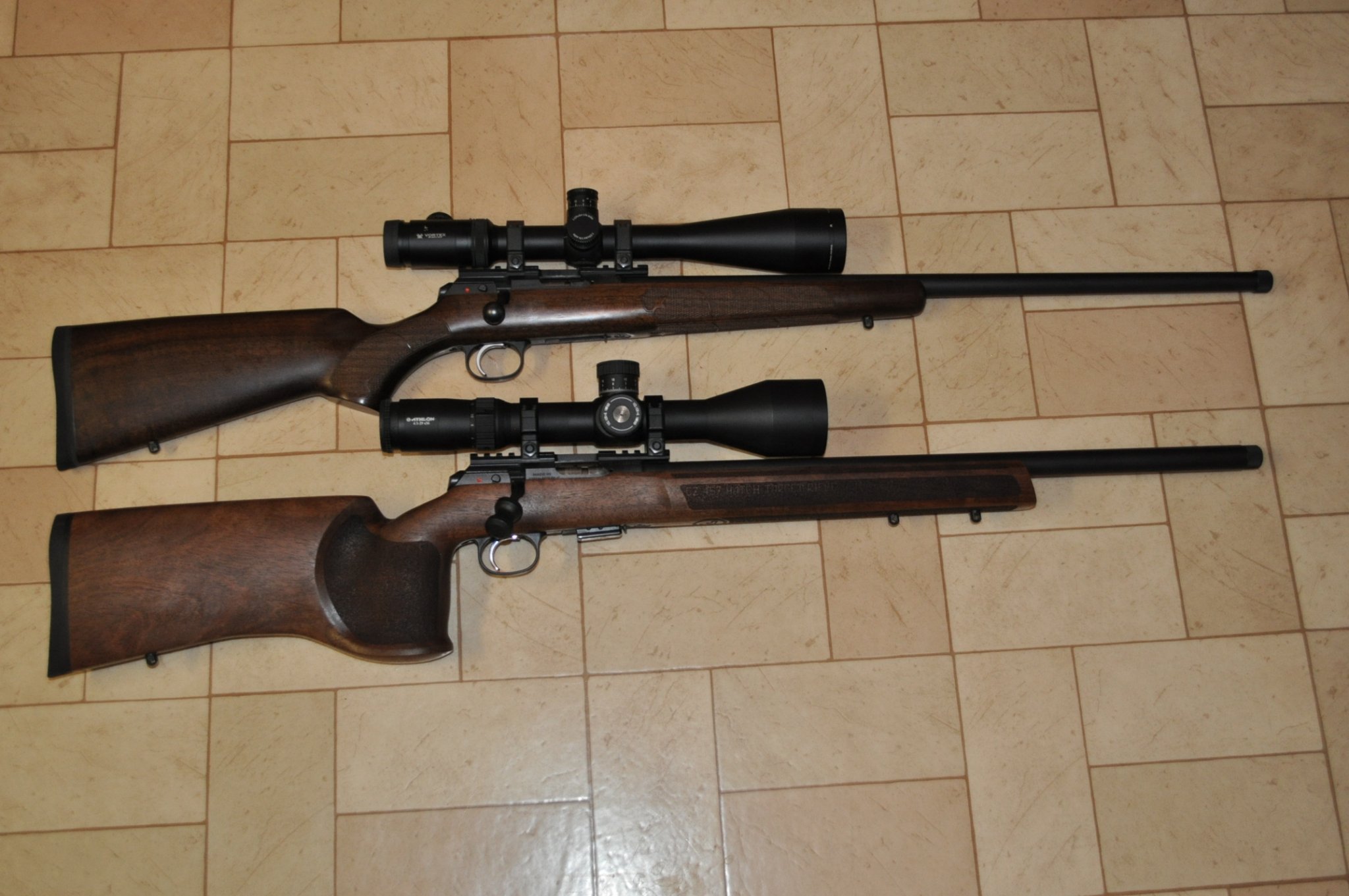

How does the Varmint compare to the MTR in terms of precision? Does the MTR group much better? If I'm building a precision rifle rig, would the MTR suffice and just throw it into a new chassis, or would I be better served getting a cheap VZ 457, and getting an aftermarket barrel? You mention your MTR shooting on par with your V22. I'd like something that would shoot on par with a V22 and not cost $1750 :)
To start, I really love my V22. It has a lot of things to like about her besides just accuracy. As far as my V22 cost, the action was 1750.00 and the MDT chassis, rear stock, weights was another 1600.00. Then I bought 20 mags. (660.00) So my cost has ballooned up to over 4000.00. My CZ 457 MTR plus rail and bolt was 850.00 plus six mags for her (210.00). I feed them both SK rifle match (red box) and they both love it. My CZ is stock except for a trigger spring kit and bolt knob and I see no need to replace the bbl. and I have never looked for a chassis. All that said, I guess it just depends on how much money you have for toy's. I can say that I like my MTR better than my two Annie's but not because of an accuracy issue. I feel the MTR is a great buy. I have run my Trijicon 5-50x56 (1800.00) on both guns and they shoot the same for me.

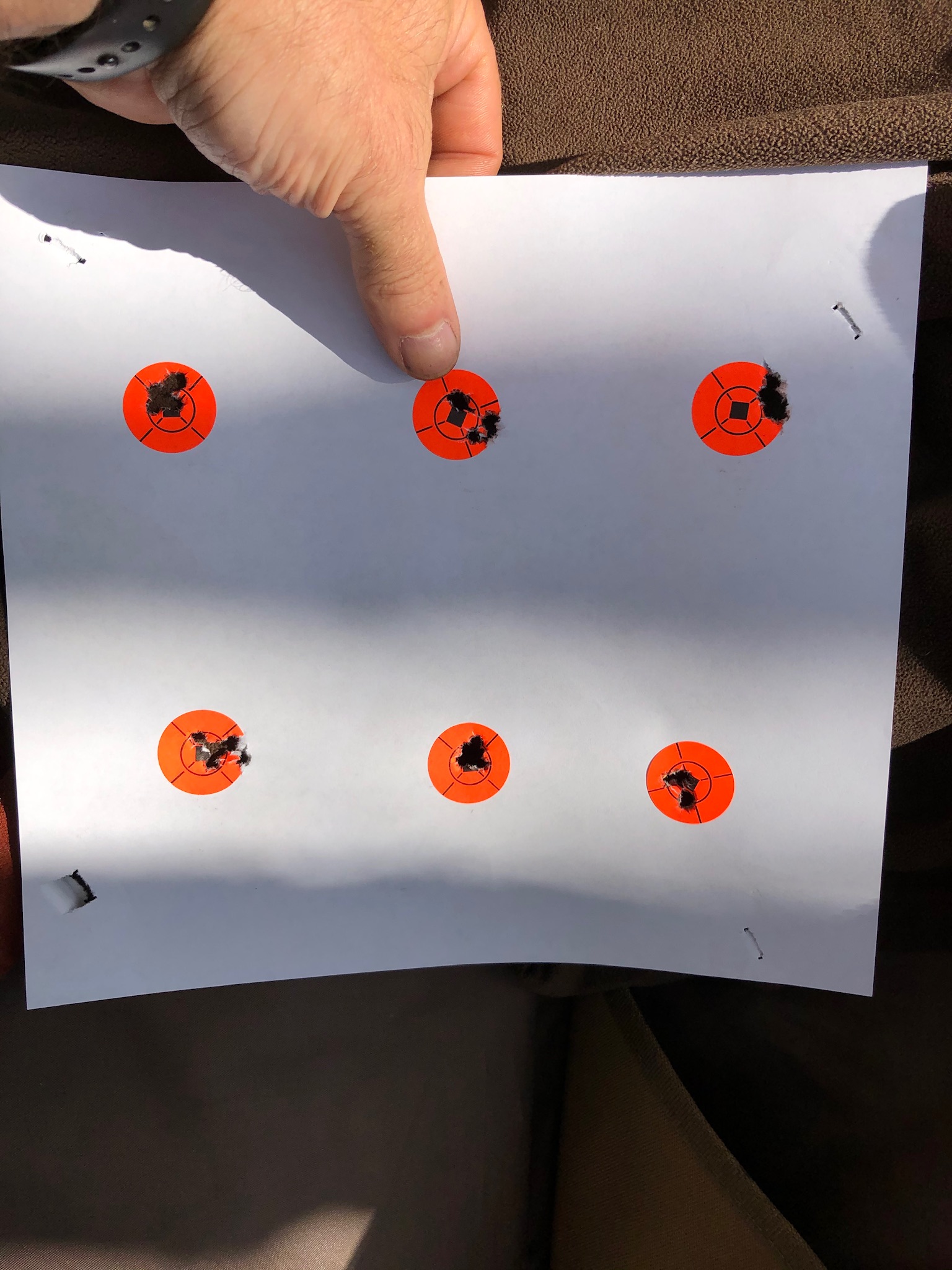

I finally got out to the range and shot a few groups with my CZ. I will be the first to admit I’m not a group shooter and I’m sure the rifle can actually do better. These are shot with the old Wolf Match Target that was made by lapua. I’m guessing it’s about the same as the SK+. The group with my thumb by it was my cold bore shot. The bottom left group the wind picked up making it string from left to right. Everything else looks pretty decent though for a bone stock rifle.
BTW these are all 5 shot groups at 50 yards.
About the same. I’m sure they will both shoot better than me. I’m just not a group shooter. I may have spent 15 seconds shooting each of those groups so it’s not like I was being particularly precise with my shooting. The entire 6x5 was shot in probably 1 1/2 minutes with mag changes. I just don’t have the patience to set and shoot groups.
They look damn good to me..... I too hate shooting paper, it is just a necessary evil to me. What kind of CZ was that? If my new Royal with the 20.5" bbl. shoots that well, I will be happy as can be. As it is, I love my MTR.

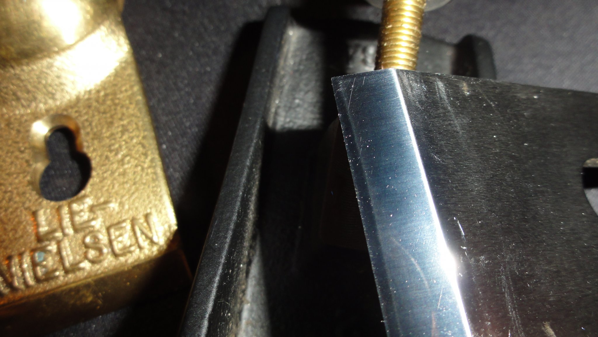

Good looking guns..... and tools as well. Before I became ill, I had some Lie-Nielsen hand tools. I lapped off the irons just the way I do my trigger sears so they were razor sharp and a joy to use. They were expensive but I was able to sell them on e-bay for what I bought them for. Buy quality and you won't have regrets.

I have quite a few Lie Nielsen tools too. Mine don’t look quite a pretty as yours though. Mine have had almost daily use for 10 years so there is a little wear on mine.

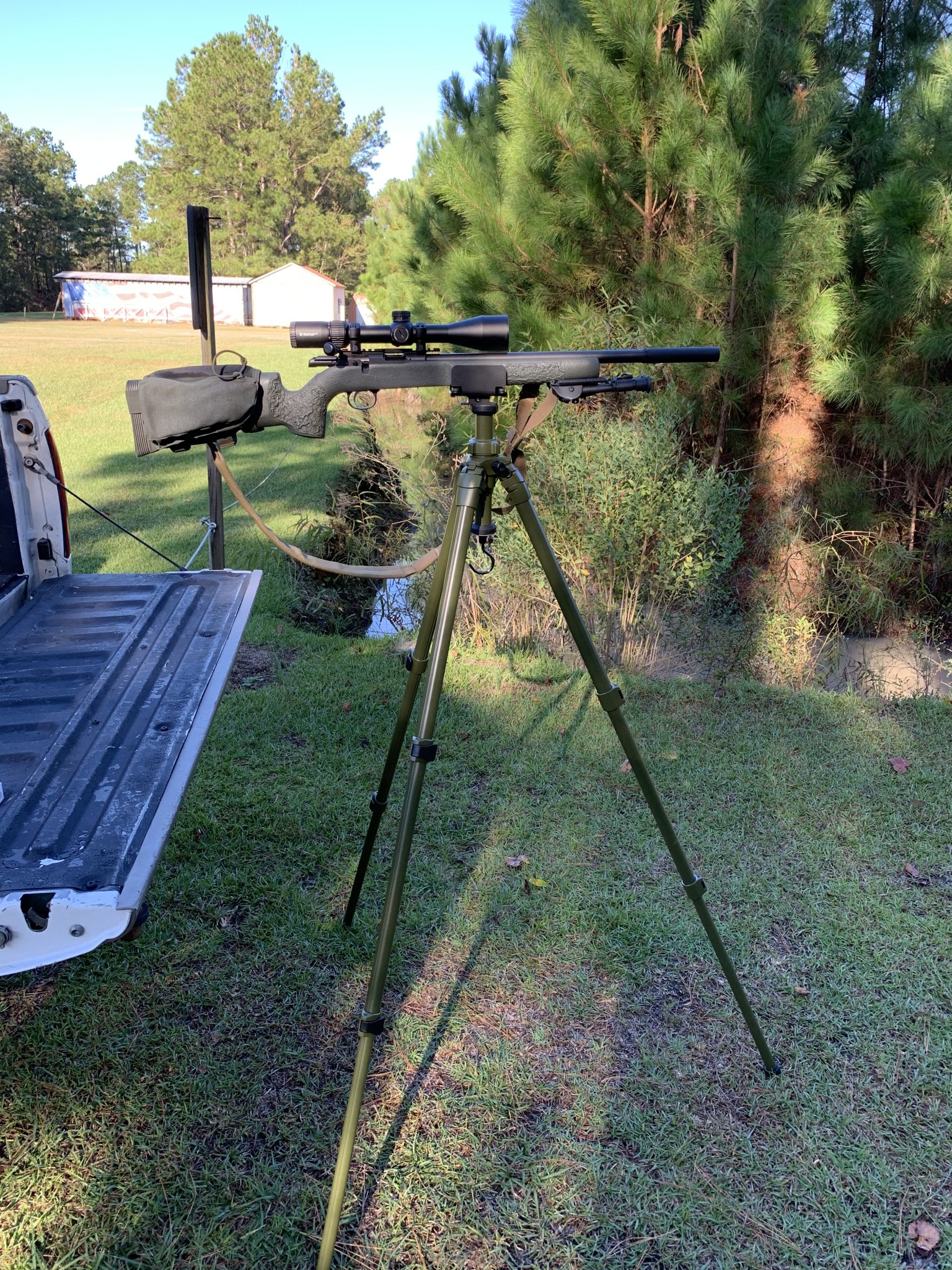

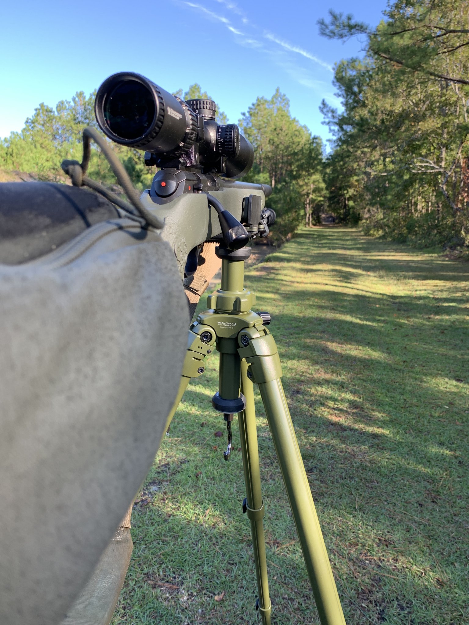

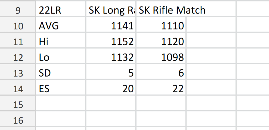

Was thinking about doing my first NRL22 type match next weekend and I just got a new scope, so I went to the range today to get things dialed in. Only have access to 100yards so I also brought the Chrono with me to see if I might be able to get enough data to get close at distances up to 300.
I have the MTR which is all factory except for a bedded stock and the factory barrel that I had threaded. I almost always shoot it suppressed. The gun tends to like the SK Rifle Match the best and I also tried out some SK Long Range ammo as well.
After getting sighted in at 50, the Rifle Match seemed to be just as accurate as the Long Range at 100 yards. The Long Range was a little faster than the Rifle Match and MAYBE slightly less accurate. It was hard to tell to be honest. Also, the fact that it started raining and the wind was picking up and gusting from all over didn't help. The rain started coming down pretty hard, so I called it a day after these two 15 shot groups at 100.. Not bad at around an inch, the majority being within 3/4".
The Long Range ended up being exactly a 1.5Mil holdover from with a 50 yard zero, which is nice. The Rifle Match, being a little slower, was around 1.6 mil hold over. You can see this in the targets. I was just holding 1.5 Mill on the reticle.
The Chrono information is on 15 shot strings, with a silencerco sparrow on it.
On a side note, I'm extremely happy with this gun. I don't know how it could get any more accurate. It is a little ammo picky and it definitely has gotten more accurate with time. I'm probably around 1.5K rounds at this point and it's a dream to shoot.

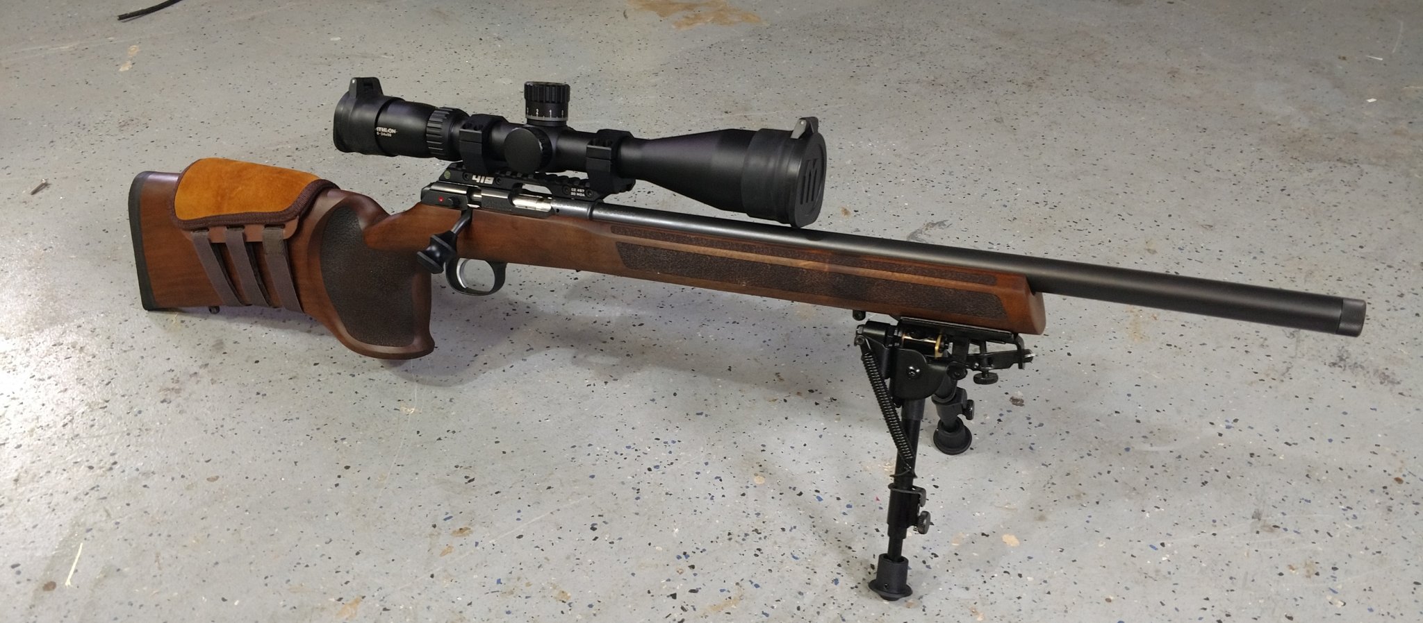

So i just ordered a 457 MTR, but I am trying to get everything in for it before it arrives.
How necessary are the say YoDave springs on these guns?

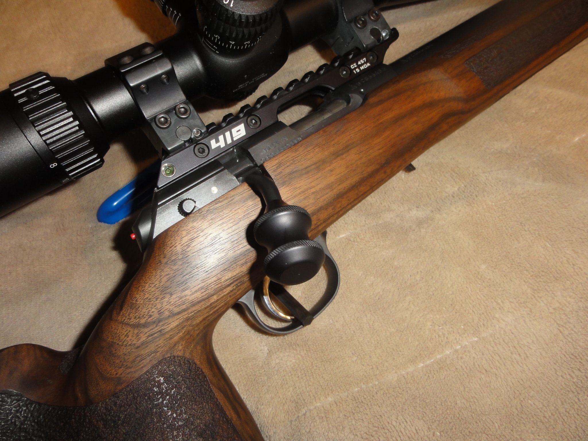

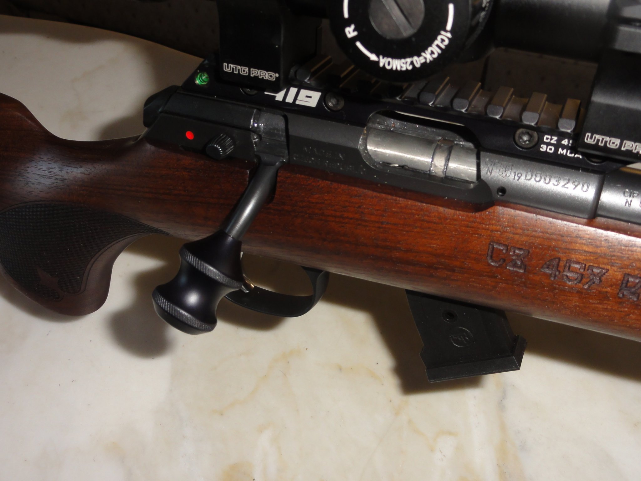

I would absolutely recommend the AREA 419 bolt knob as a must have item. I also went with the Area 419 rail but there is also a Bscar rail that is about 35.00$ I like very fine triggers, so I also suggest the Yo-Dave block and spring kit. My CZ MTR is set to 9 oz. and the CZ Royal I just got Thursday should have it's spring kit installed no later than Tuesday. The trigger pin is a BEAR to deal with but if you decide to do it, I would be happy to share what I did to make the job an easy one. With a little work, you can get a really great trigger. You can see from the sketch below that the new spring goes in line with screw labeled #53. All it does is reduce the felt trigger pull. It does not do anything to reduce the sear engagement or anything that may make the trigger dangerous. I have a safe margin of sear engagement but still a very lite trigger pull. DIP makes an extended magazine release. It is about 2mm longer than the stock unit and is made from aluminum and not plastic like the factory release. In short I would say.... buy the parts and you will enjoy your gun way more. I will post some pics of my new CZ 457 Royal on Sunday PM.

I have the 419 bolt knob/30 moa rail which I highly recommend. I also have the yo Dave spring kit that I haven't installed yet, because the trigger really is nice. You can tune the trigger down to a pretty low pull weight before starting to get slam fires. I'd say just above a pound or so, like others have mentioned. I'd shoot it before ordering the spring.
I also like having the extended mag release, as it is pretty small and hard to get to. The gun always get a lot of attention at the range for its looks, then people see how well it shoots...

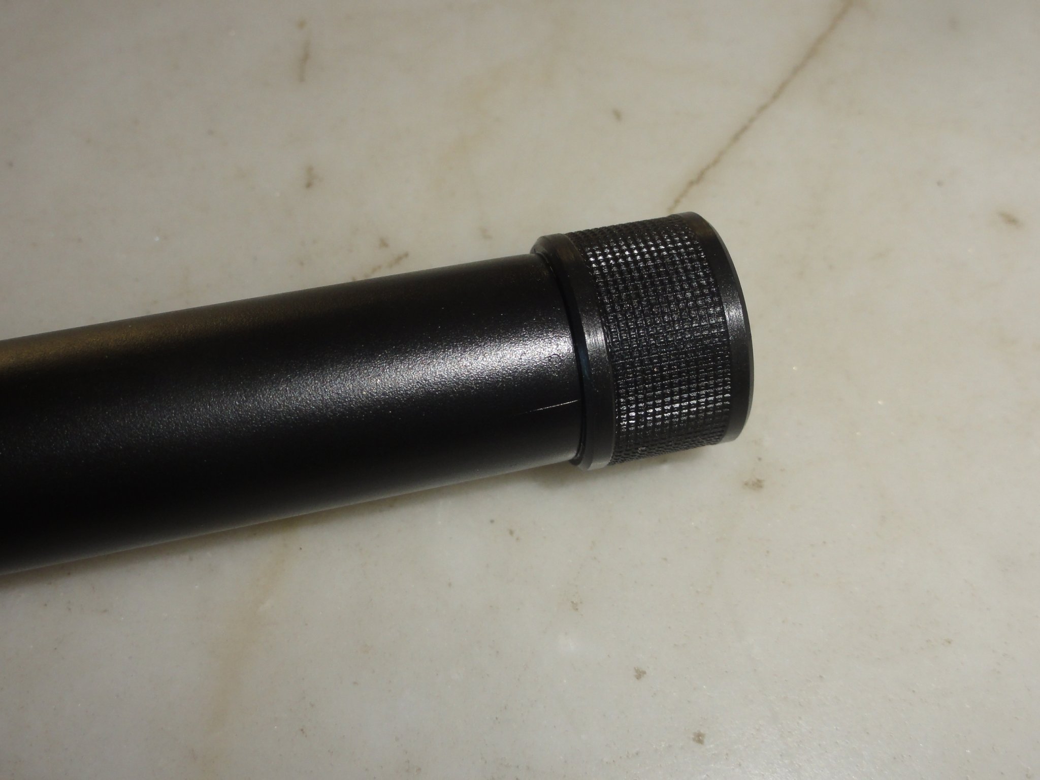

The barrel is the factory barrel, just threaded by local gunsmith. I'm using a thread protector off a Savage Mark II that is my around the house beater and pest eliminator. It fits almost perfectly on it.
The one thing I will say about the 419 base is that it elevated the scope quite a bit. I found the seekins low rings (the lowest ones they sell) put the scope as low as possible. It puts the magnification ring on the scope a couple thousands above the rail. Still have to use a cheek pad to get lined up perfectly on the scope.

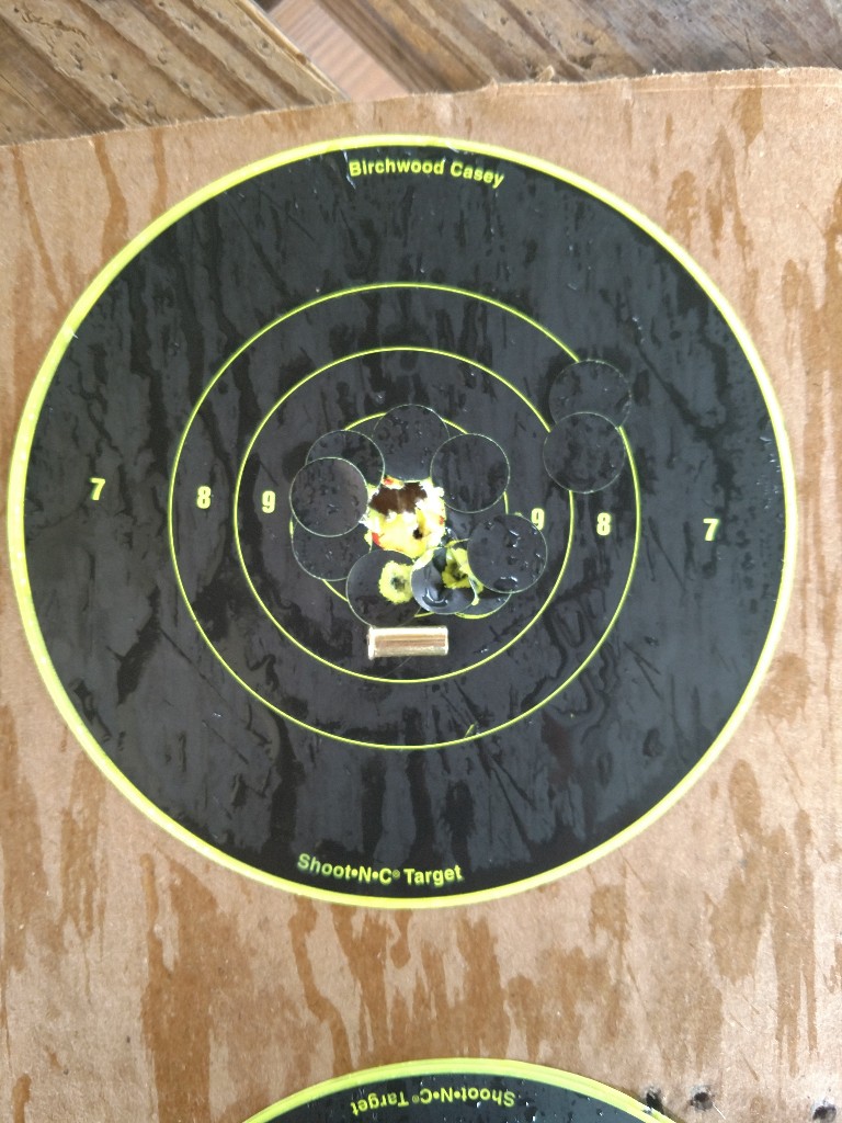

Took my buddies brand new cz 457 out today.
Nothing but issues extracting, cci standard, cci subsonic...
What could be the issue?
Seemed to be really tight chamber as well...

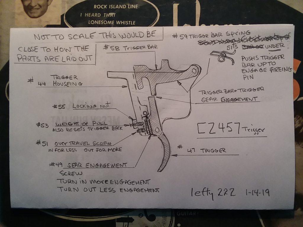

CZ 457 trigger spring.
For those of you wondering, the stock spring is .148 OD x .35 long and has a wire diameter of .028"
If you go to McMaster-Carr and do a search for 9657K612, ( .148 x .375long x .018 wire diameter ) you will find the spring that is for sale from Yo-Dave.
If you want a softer spring you can use 9657K611 ( .148 x.375 long x .014 wire diameter. ) It has a spring rate of one half of the K612. They both cost 5.33$ per dozen.
Please lets keep in mind that I target shoot and don't throw my guns around. I do however believe in a good amount of sear engagement.

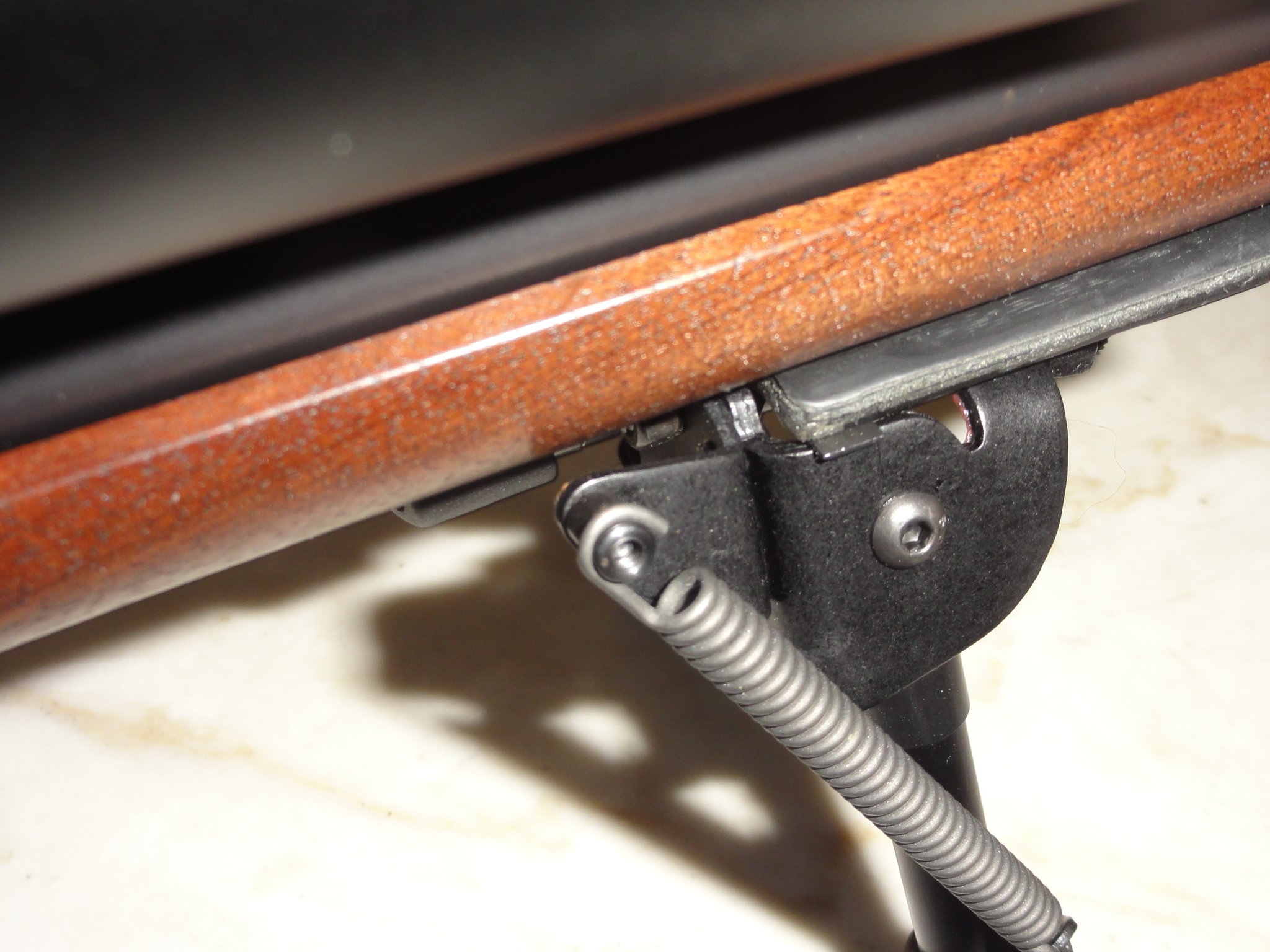

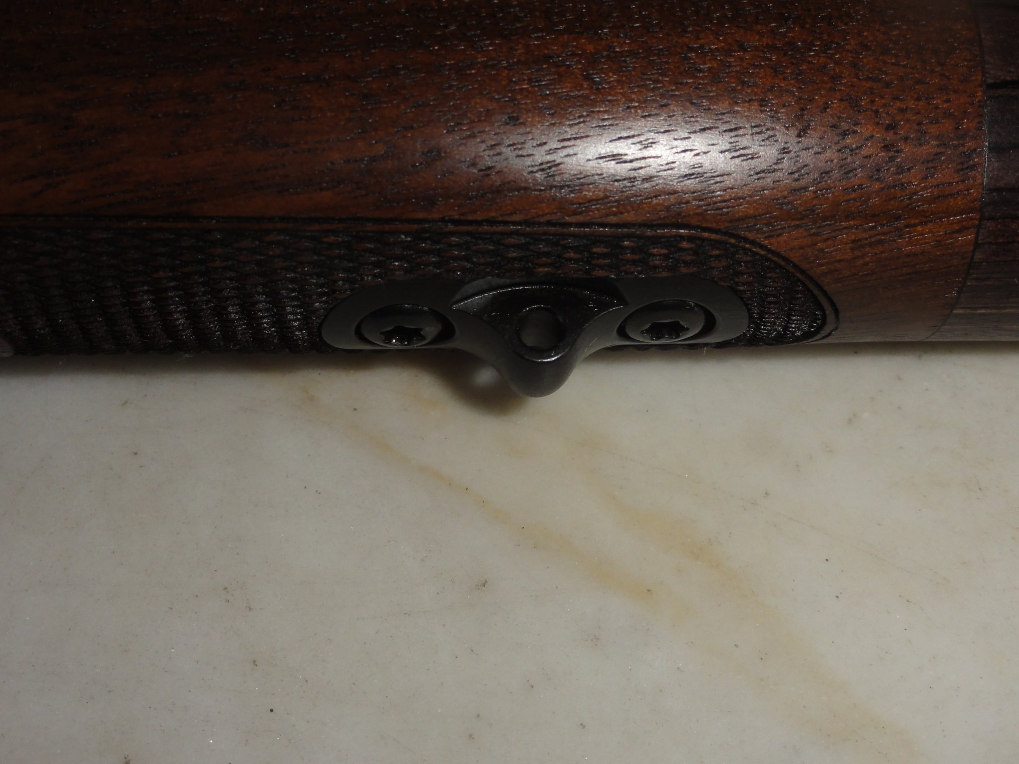

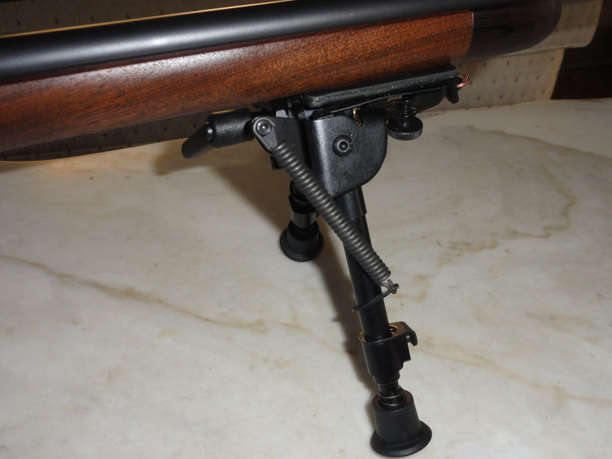

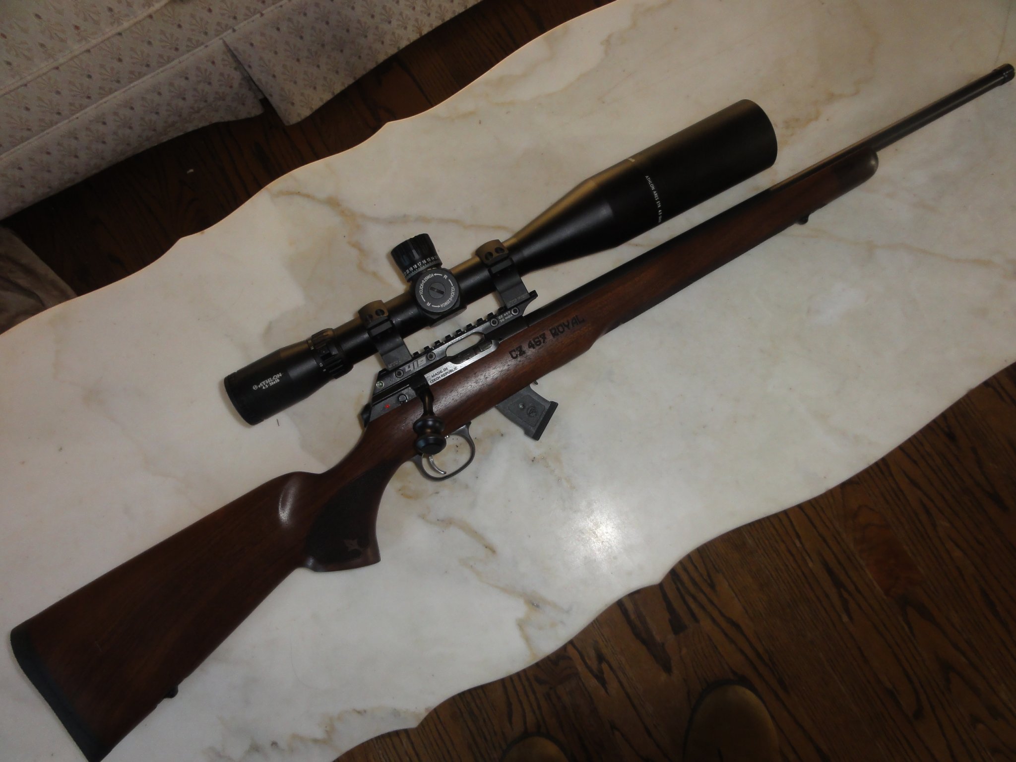

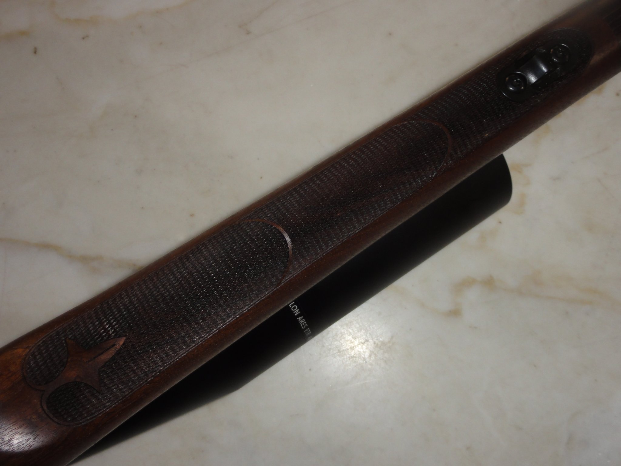

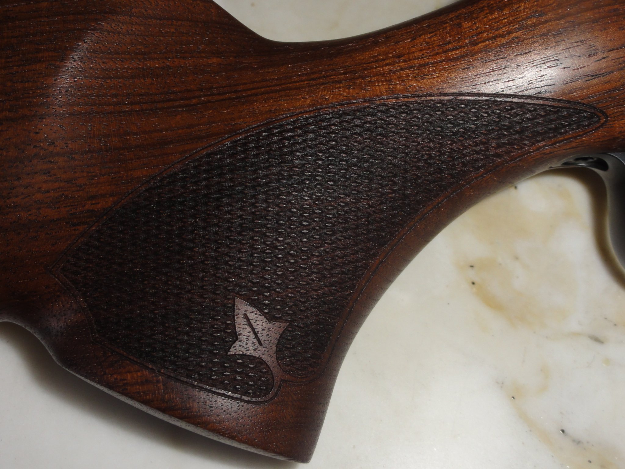

So I got my new CZ 457 Royal a few days ago and this is my first impression. For better over all photos, see the sales ligature.
The first thing that I noticed is how svelte the rifle is. Mine has a 20.5"bbl. even though the ligature says it comes in 16" & 22".
The next thing I saw was the very attractive machined sling swivels. My concern was that they would not attach to a bi-pod and I did not want to be stuck using a bag. Third was the bbl. thread protector. It is bigger than the bbl. I would have preferred it to be flush. The bbl. is also threaded in 1/2-20 and not 1/2-28 like all of my other guns. the diameter of the bbl. at the muzzle is .55". The Royal is not advertised as having a Match chamber but that does not seem to cause any issues.
even with the fancy sling swivels, a Harris bi-pod clamps up and wont interfere with the wood stock even at it's maximum tilt as shown in photo no. seven.
She was about 850.00 so given a choice between the Royal and the MTR, I would get the MTR.

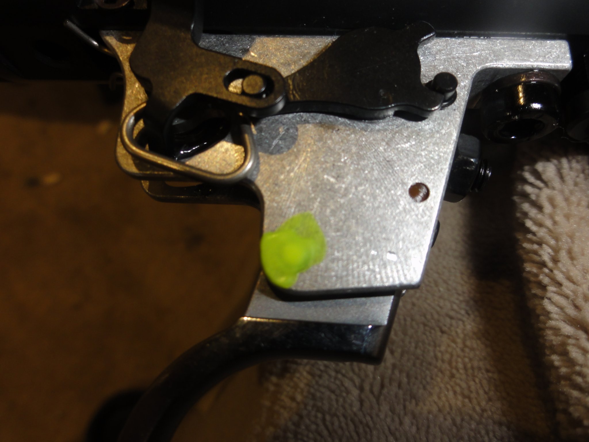

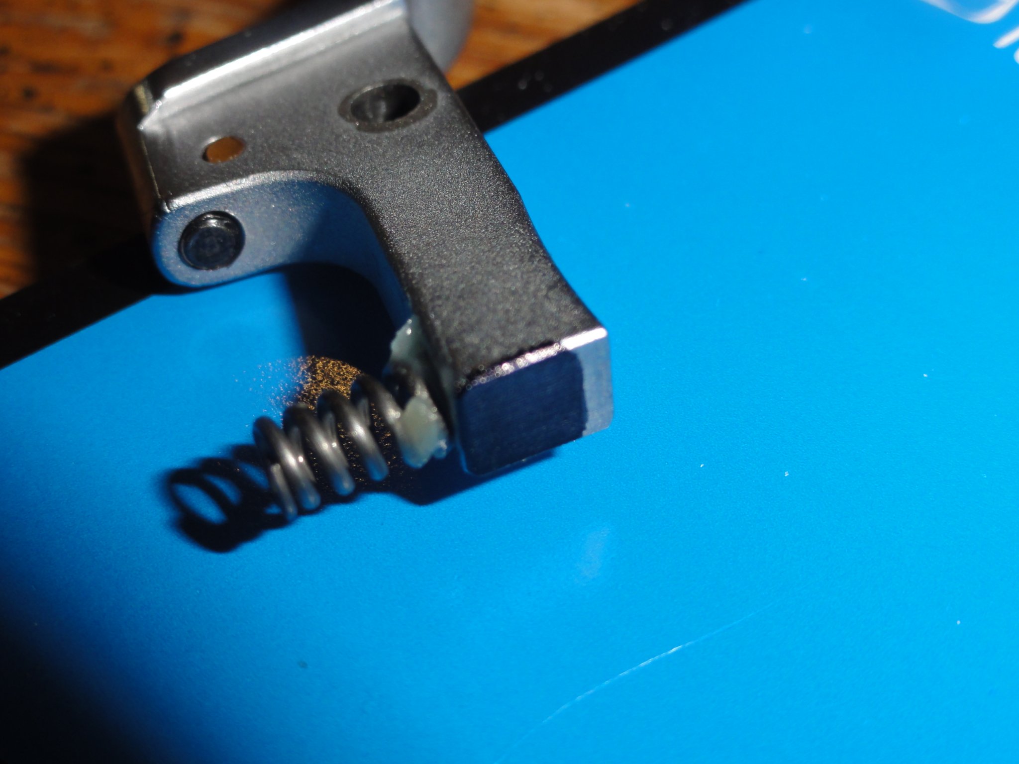

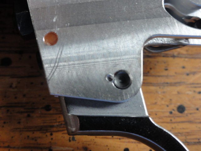

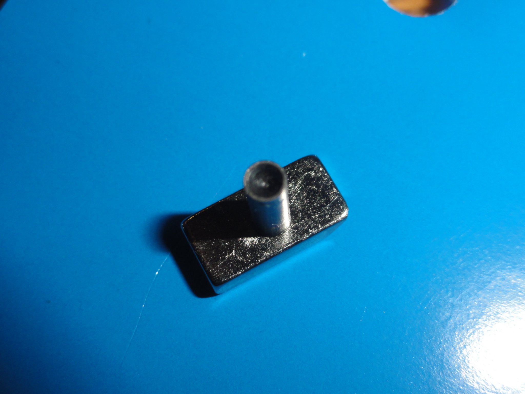

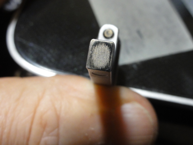

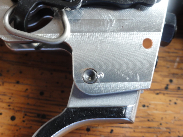

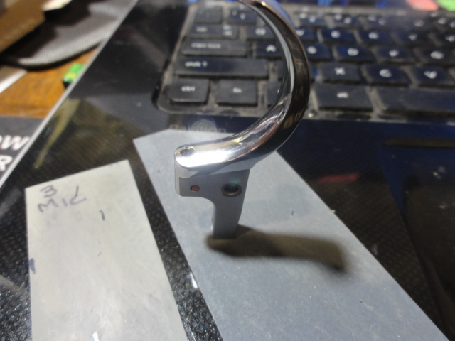

CZ 457 spring replacement.....
I just drove the pin out of my CZ Royal. It has a diameter of .1175 at the center and is a couple of thousandths larger on it's ends so it has an hourglass shape to it. It appears as though they staked the pin in place to retain it without adding cost.
To keep it simple enough for anyone to do this change out, I used the simplest of tools. I chucked up the pin in my drill and reduced the diameter just a hair with some 400 wet / dry sand paper. You don't need any kind of measuring tools to do this.
As soon as the pin glides through the trigger blade, your done. less than 10 minutes.
I affixed some 3 and 9 micron lapping film onto a flat surface as shown in photo 3. Also in photo 3 you can see that the trigger will stand on the sear surface all on it's own. All you need do is to use lite to medium pressure on the sear surface to lap off the very slight irregularities. Photo 4 shows that the factory sear surface has a hollow on it. The sear surface is nearly a quarter inch square and will stay that way if you take your time. It will take over an hour.
For reassembly, there is a spring pocket in the trigger blade, If you have any type of heavy grease, ( today I used silicon plumbing grease from Lowes. ) you can put it in the pocket to retain the new spring while you put the blade back in place. You can use any kind of grease because it is not being used as a lubricant but as an assembly aid. Before you put the blade back in place, put some lube on the trigger sear. I use MOS2 ( Moly ) Your smaller pin will slide in with ease now. And now all you need do is test your trigger and retain the pin. For this demo, I used a prick punch to stake the pin in place. It only takes a very lite strike to create the dimple adjacent to the pin. An option is fingernail polish. You will also want to adjust your trigger and that will require that you remove the magazine well. This would be a good time to replace the plastic mag release
with an aluminum release from D.I.P.
BTW.... the last photo shows what the trigger sear should look like in an ideal world. You only need to lap the one sear surface and not the trigger bar sear.
EDIT.... Be aware of the recoil block falling out when you have the action out of the stock. You can put some heavy grease in the recoil lug pocket to keep it in place too. It's easy to have the gun on your knees and lift the stock and have the lug fall onto the carpet.
Lots of luck
Shawn

I just wrote up a quick post about what needs to be done. Here is a sketch that Lefty 222 did some months back. Item 49 is backwards. In is LESS engagement.

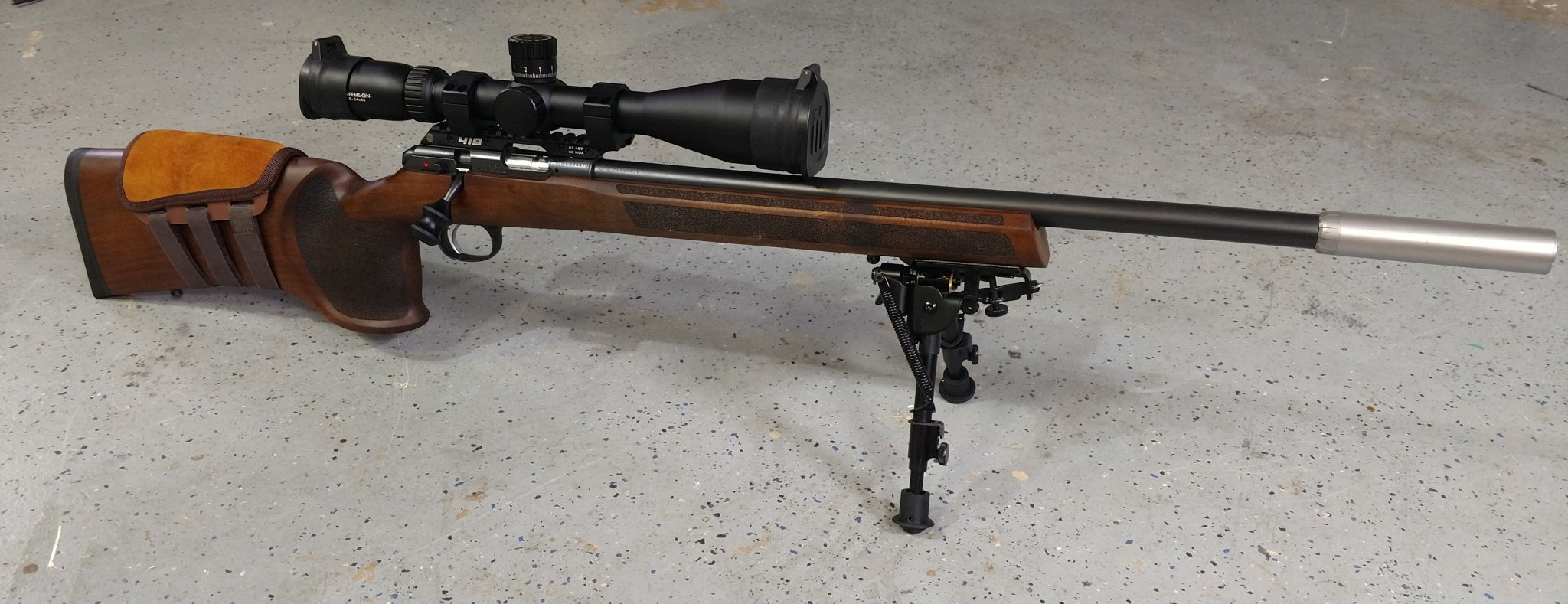

I just did a match with my MTR today and I will say that I'm probably going to either put it in a new chassis or build something new and leave this how it is.
Like mentioned before, it's a little short when shooting prone and it's too pretty to be jamming into 2x4's and railings ect... The gun performed very well and we shot out to 316 yards. Most of everything was between 50-160 yards. Very impressed by the performance compared to guns costing three times as much.
