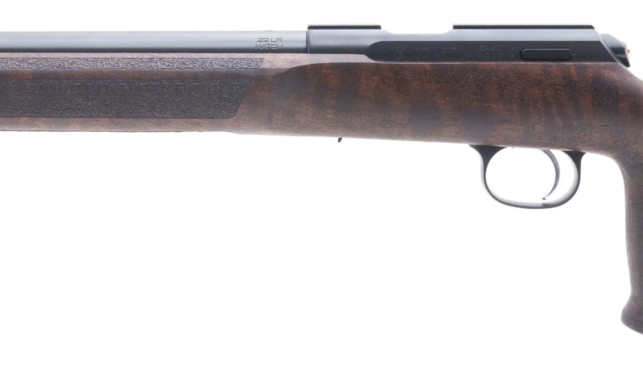

The barrel should have 22LR with the word MATCH below it on the left side.

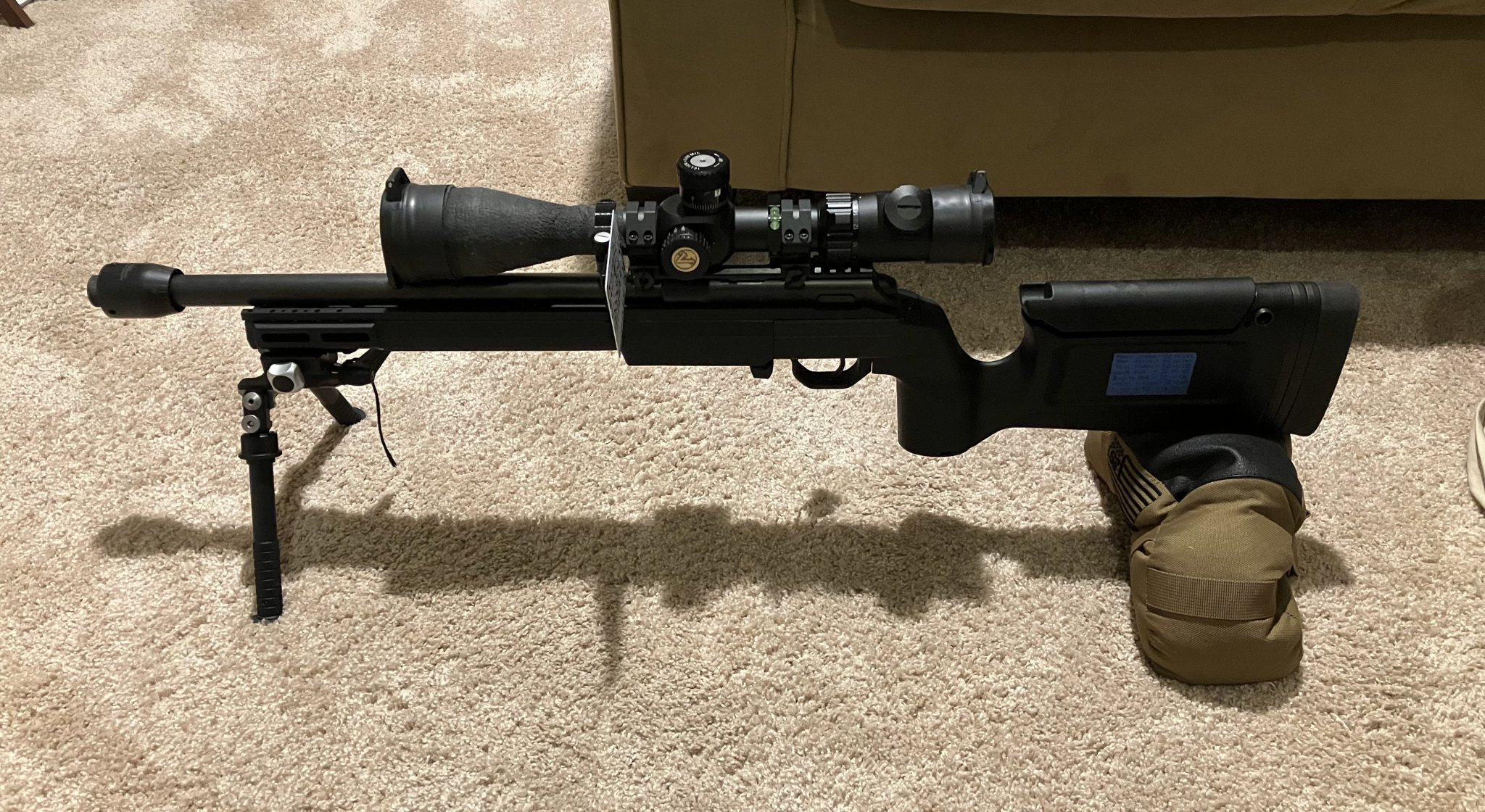

I have Bravo chassis and was fortunate to find a used KRG Arca rail, The fit is spot on, and well made. Definitely solid and as such, the attachment process is more involved. Other makes may be a simpler install, though I would follow the KRG instruction to ensure it's on there right.

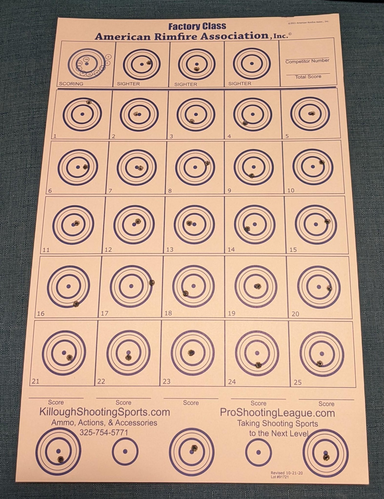

Brought some 'homemade with magic markers' KYL targets to the range today. That 1/4" dot was dancing all around my shots. Grr
I figure I'll use the timer on the lane and do an ersatz stage next time. Wanted to make sure I could hit the targets period before I made things harder. Till I got down to that 1/4" dot I was doing all right. In a real match, I had the brilliant thought that if you aimed a bit high, the target would still spin...

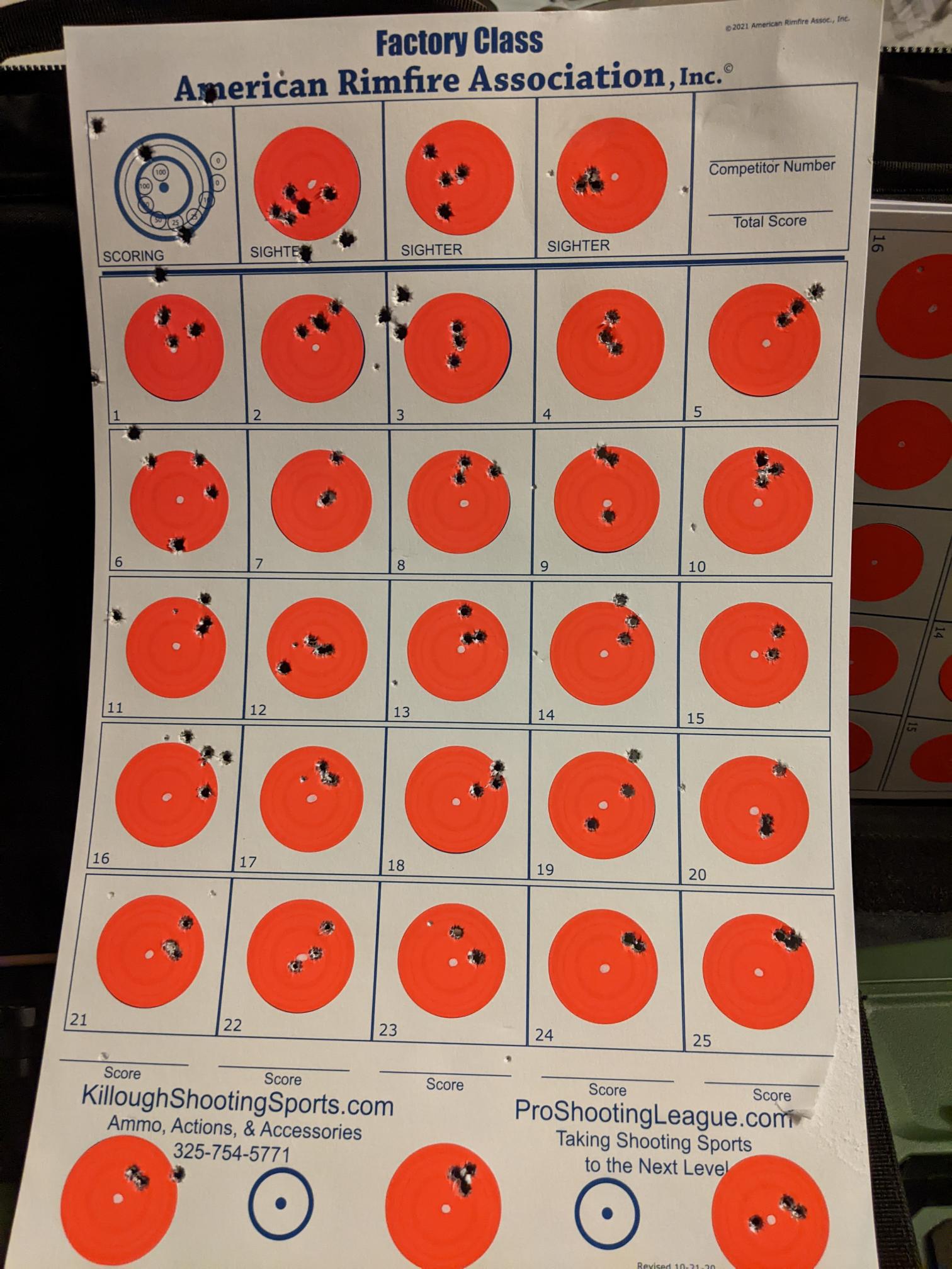

Shot my brand new 457 MTR yesterday.
So I've goon from good to quite poor. White target on left was show with my CZ 457 w/ Lilja barrel and Timney trigger in KRG Bravo chassis. SK rifle Match at 50 yrds. Timid wind, 3-4 mph. Orange target is three weeks later with same set up. I suspected a dirty bore and so got to cleaning. Soaked the carbon ring and brushed it with nylon brush. Ran Rimfire Blend through the barrel. Set the action screws to 45 Lbs. Went out was at range at Markham and got the same results as the Orang target(left it in truck) Two Ranger Officers took turns and got same results. Didn't hold for wind, just straight on target. I am at a bit of a loss at what is going on? Cleaned the bolt, though didn't disassemble it. Cleaned all the usual places. Never been dropped or banged around. I am quite frustrated, and honestly don't know what is going on on and how to correct it.
Looking for advice and suggestions, thanks in advance.

Isn't it supposed to be 65 in. Lbs on the action screws and 45 in. Lbs on the tang screw?
There is SO much varied information on the torque value. I was at 65 initial, even split. Dug a around a bit and read 45 was a sweet and correct spot. That's where they're at now. I think I missed the split values recommendation. It would be an easy fix while at the range. I tried 35 and saw no improvement.

I re-read the instructions, it's 45 for the CZ and the tang (the one that holds the butt stock on) is 45 AFTER the two action screws are tightened.

IMHO, action screw torque won't put your rounds all over the paper like that. Last time I had erratic groups like that, I trouble shot it back the sighting system. Take off everything from the scope rail up and retorque your screws as you reassemble. ( Check the length of your rail mounting screws to assure they aren't bottoming while your at it) If you have another scope, that would be step two.
Good advice from WeeHooker. Action screw torque setting have very little effect on accuracy only vertical shot placement. I would also look at scope and associated parts.

After taking a good look at this......I would go buy some lots of ammo and retest. I've had a lot of CX that was that bad and I checked everything, switched to Eley Match and it was much better. It just could be that barrel and ammo lot don't mix.

Before I remove the scope, rings and base I will shoot a box of each of these. It's the variety on hand so it will do to get a better idea and hopefully eliminate others. If any of these particular type brings the groups back together, I think it maybe ammo related. I's a slow process as I only have one day a month to take a range trip.

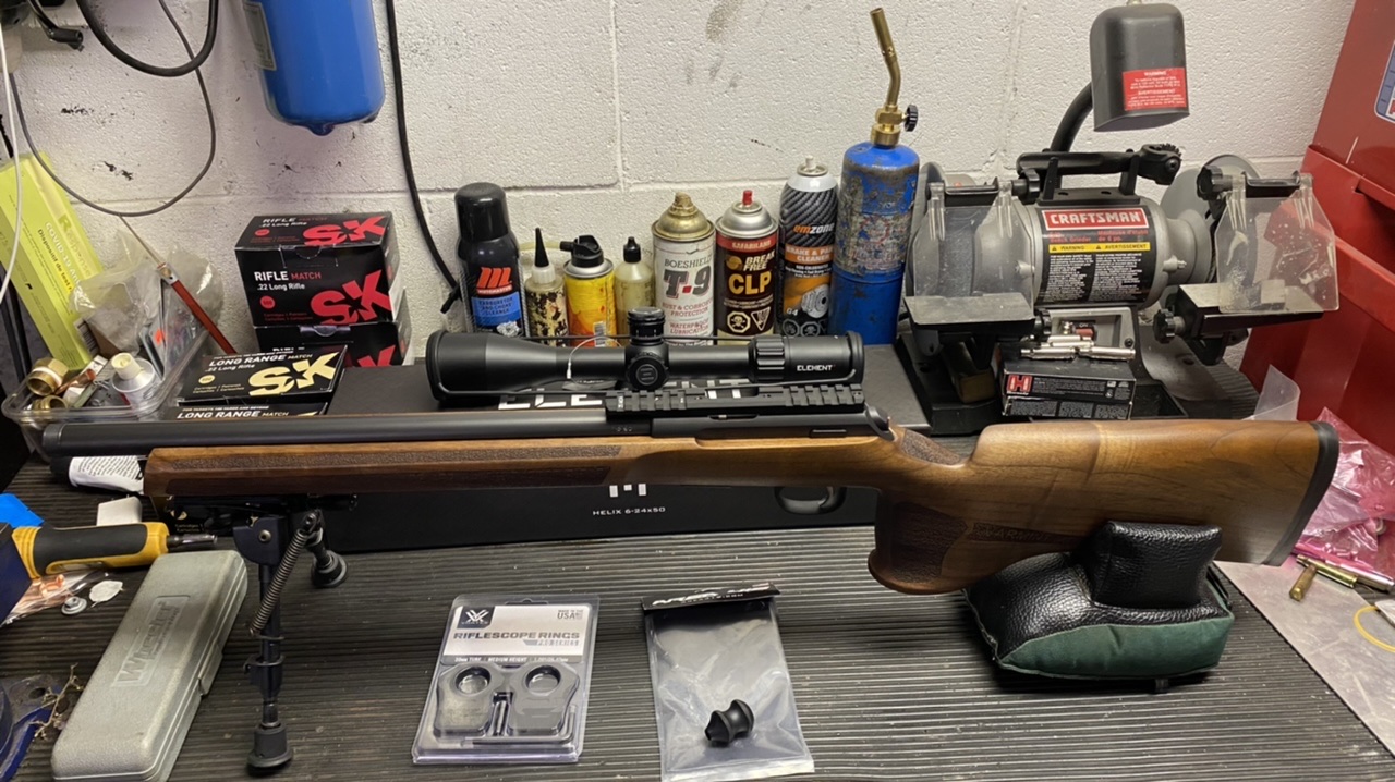

CZ 457 - Area 419 Rail 30 MOA - Vortex Viper PST Gen II 5-25x50 and Vortex Low (0.87”) Rings - AM I GOOD?​
Pick up the CZ 457 tomorrow and have the rings and scope on hand. Won’t have the rail for a few days…. Anyone know if I’m going to have clearance issues?
You shouldn’t have a problem at all. If anything, you’ll find that the scope sets higher than your cell rest. The Area 419 rail sets pretty high.
I've got the 419 30moa rail on mine with the lowest 34mm burris rings and its still a tad higher than I like. I think they're at an inch. Just sold the at-one it come with and will have a chassis on it soon. Hopefully with a little more cheek adjustment.

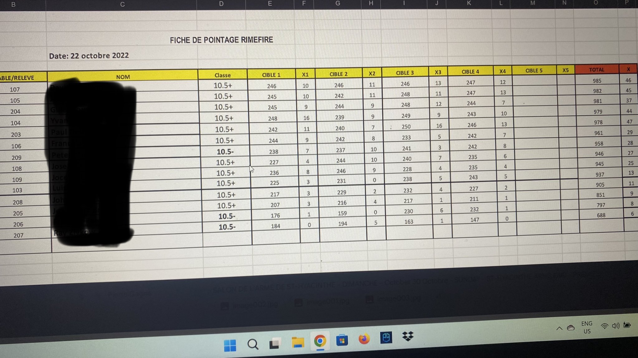

Update on my 2 week old MTR.
I was invited to shoot a 50y fun match last Saturday.
I’ve never shot a Benchrest match before let alone a rimfire Benchrest
There are 2 classes -10.5 lb and +10.5 lb
That’s rifle with everything on it except a magazine.
My MTR weighed in at 9 lbs 15.5oz bipod included.
Myself and 2 others shooting Savages were in the -10.5 lb class.
In the +10.5 there were 9 Annie’s and 2 RimX
We were 14 shooters in all.
I finished in 7th overall winning the -10.5 lb category. I finished ahead of 3 Annie’s and both RimX.

I ended up with removing all the optics kit, base rings and set aside the scope. Checked each piece and set it all back. Bore sighted as before and headed to range. Wing was pushing 5 mph with a frequents gusts that took some targets off the posts.
Shot SK rifle match and it took about 15 shots to zero at 25 yrs. Had to dial the scoped past the point I believe it should have needed to go and then come back to the zero. Think of it as a worn out hotel shower handle. You have to go past the perfect temp. and come back to it.
Set out at 50 yrs and this is the best I was able to get. Wind was a factor, though not sure how much.
Contacted Vortex and they agreed to check out the scope. It's a Venom and has shot quite well before, as did the entire setup. If it is the scope, I know they will fix it.
ps, left the selection of ammo to test at home, that's why I shot only the SK rifle match.

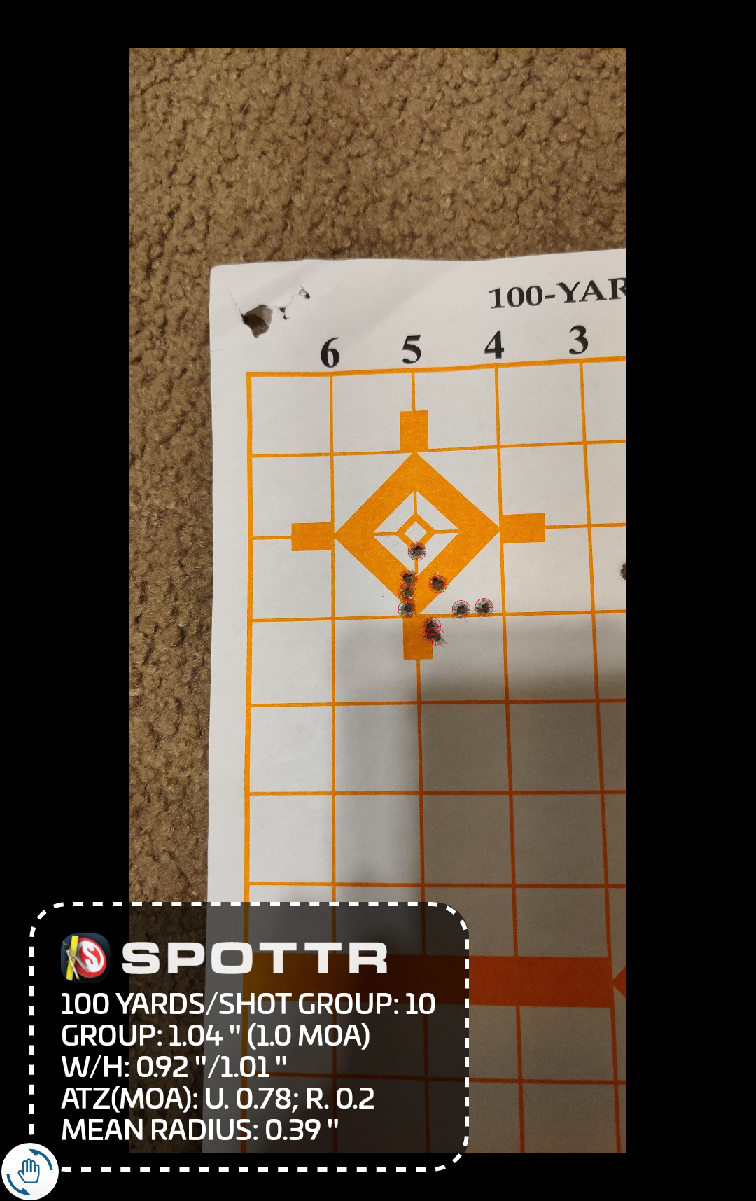

I'm very happy with my CZ 457 Pro Varmint. First time I actually measured groups(normally just plinking). Ammo is Wolf Match, but also had the same stamp as SK I was also using. I didn't measure the SK groups because it was me just drilling 20rds into a single target fairly quickly.
Only thing added is Harris bipod, Bradley cheek rest, Area 419 50MOA rail/ARC rings/Athlon Midas TAC. 50yd zero.
100yds indoor shooting kind of fast. Any other ammo suggestions?

First off, All Wolf, SK, and Eley, along with others have that same head stamp, so that means nothing other than who manufactures it.
Which SK were you using and have you tried shooting a group with it? Have you considered slowing down just a bit and making sure that each shot has the same POA and trigger pull? Just flinging them down in a hurry is fun, but rarely tells you anything about what results you can expect to achieve for accuracy and repeatability.
The SK Rifle Match is a decent mid grade ammo, but then you’ll need to step up to higher grades if you feel you need an improvement. Like Center X and the like. Then you’ll find that there are variations in lot numbers of the same ammo type.
ETA: also 1” at 100 yards for ten shots is not bad at all for .22LR.

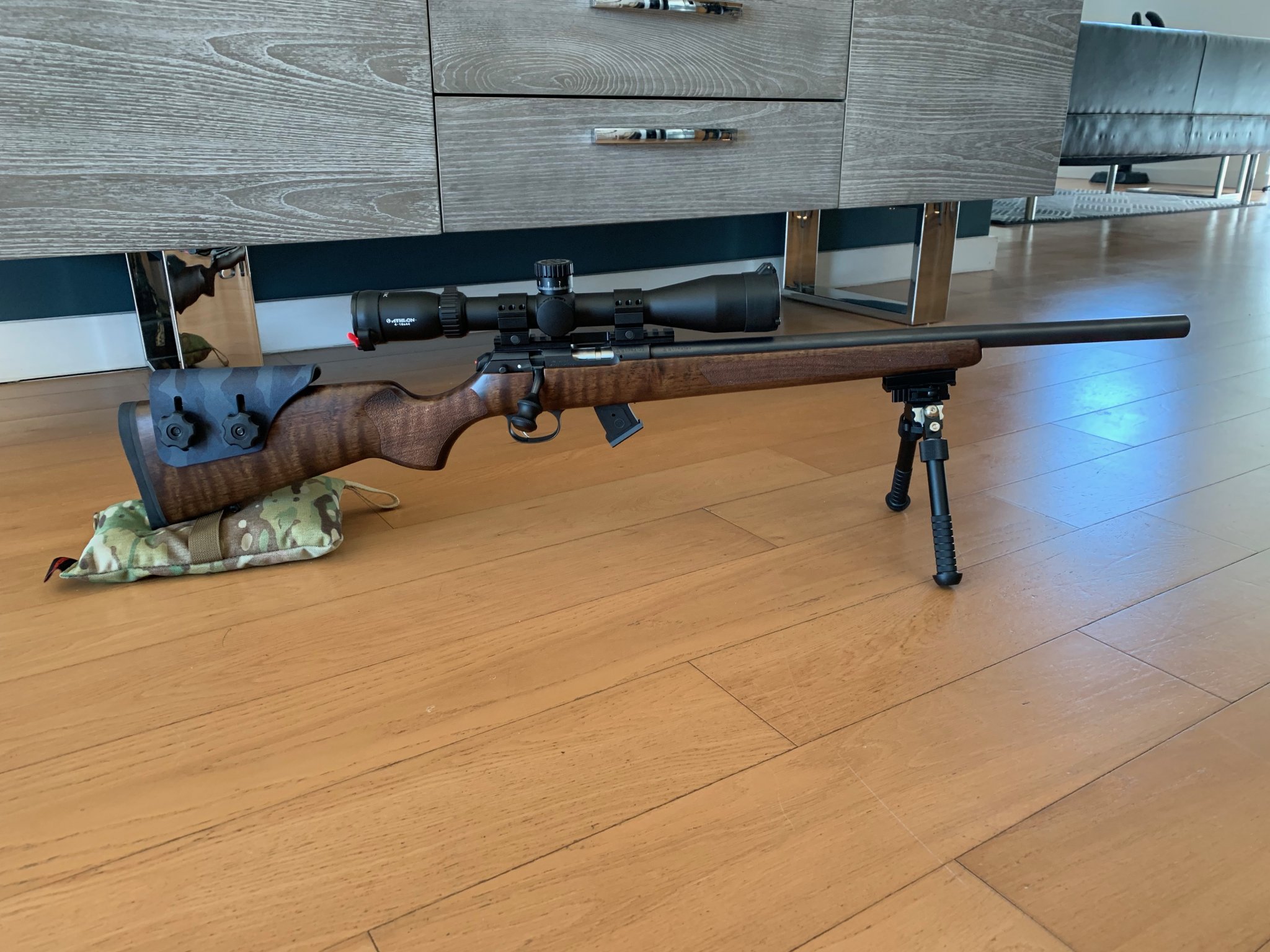

Cz457 Pro Varmint, factory barrel, KRG bravo stock, Yo Dave spring, bolt shim, BScar 20 MOA rail, Athlon Argos BTR, Weaver 30mm medium rings, Monstrum scope covers, Hub City data card holder, Area 419 bolt handle, ETS tuner, Atlas CAL. Shooting Lapua testing center tested Center X.
1. ARA factory target @ 50 yds (I realize that my stock invalidates)
2. 5 shot groups X2 @ 50yds
3. Current set-up
Loving it.

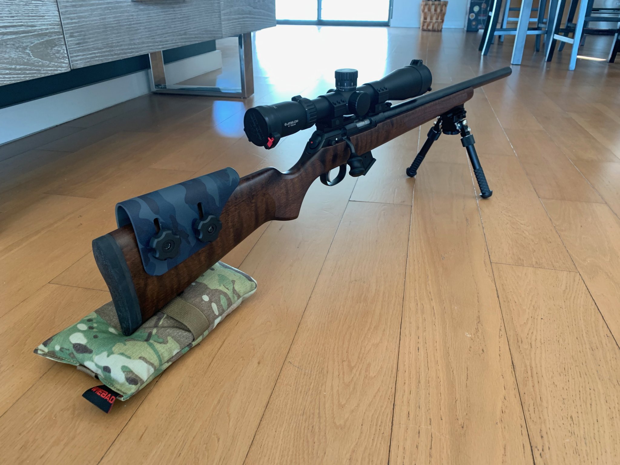

just got my 457 in the Boyd's AT-one
dropping ring height tomorrow, but may still need a little more cheek-weld elevation help

If your going to run the cheek riser ( or butt pad) out near it's limits, you'll find that the adjustment gets wobbly. You're going to want to stack some hard rubber 0-rings on the rods to stabilize them. As for adding a pad, I've been using the anarchy outdoors brand on my Bergara and CZ's. Quality is good but they are only 1/8" thick. Last I looked, they had a cut your own generic option.

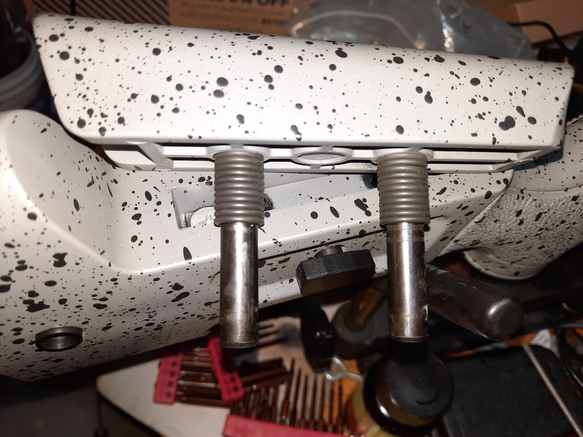

Pic of your o-ring mod?
What size?
What size?
I have not installed the O ring fix for my own At-One as I'm not a tall guy so didn't need to extend the adjustments but a little. My cheek and butt extensions are as solid as a rock. I mentioned this because slop in the At-One extensions is a common gripe among owners that set them way out. As said, it's only really "needed" if you need allot of extension and have wobble in those pieces. I do know several others that use this method on the AT-ONE on another site though. You'll want both 1/4" ID and 3/8" ID O-rings to fit the rods on the AT One. ( OD and thickness aren't real important but bigger is better.) These are available all over Ebay and /or Amazon pretty cheap. Get a bag of 50 min. You basically just stack them on until you set the proper height.
FWIW, here is a picture of the O-ring set-up on my Bergara B14R. I use it there primarily because the cheek piece needs to come out every time I pull the bolt. The O-rings, besides adding extra stability, bring the cheek riser height back to the same height every time . Works VERY well and is completely adjustable/reversible.
