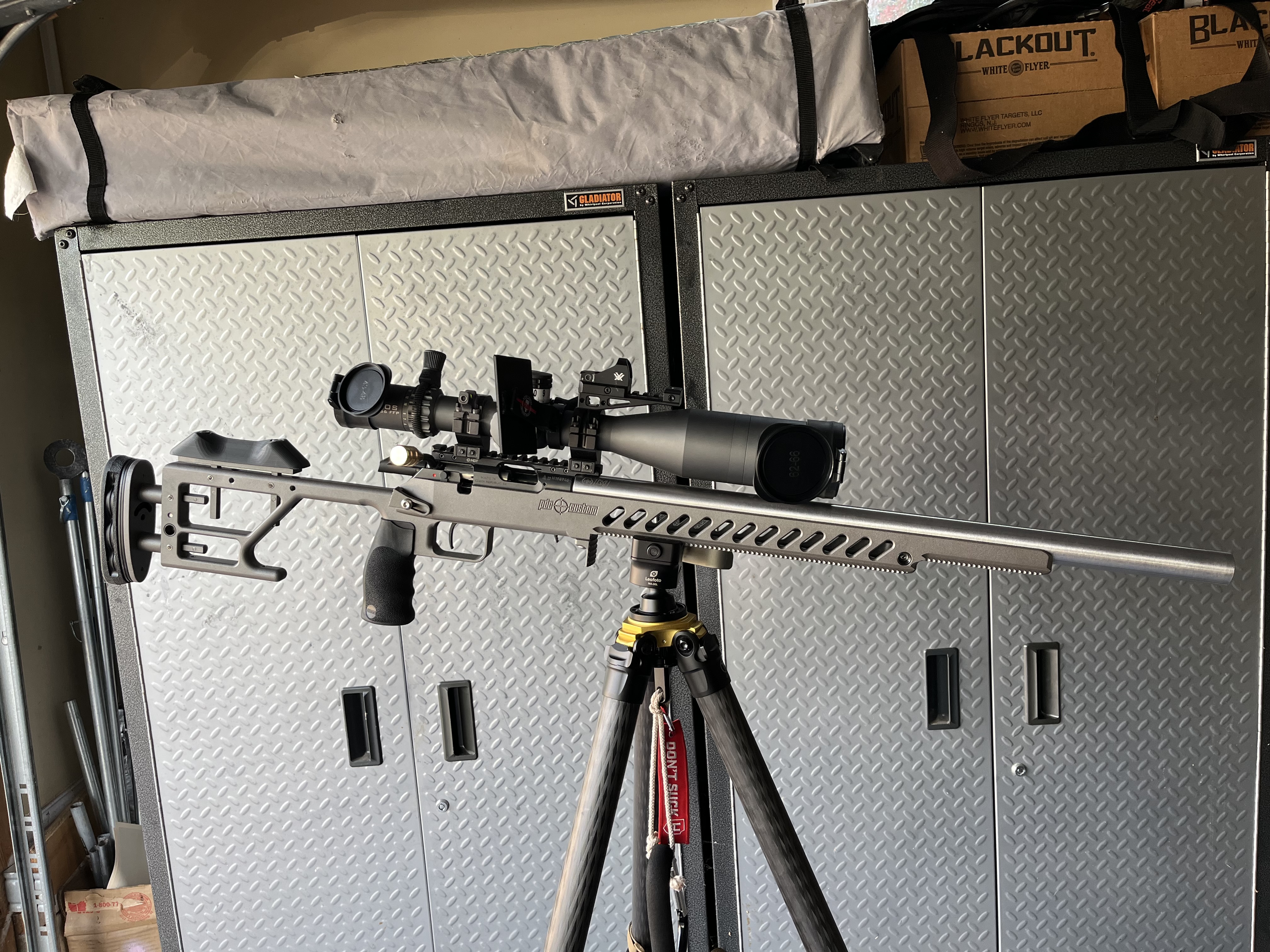

I have a 36x Sightron laying around to start with on the CZ.
Without getting into a big which scope discussion. Talk me out of a Burris XTRii 5-25.
Euro Optic has them for about $550 iirc. Not the best and a bit dated, bulky, but checks my boxes (larger than 30mm tube= more elevation, mil/mil, zero stop, <$$$, not Chinese).

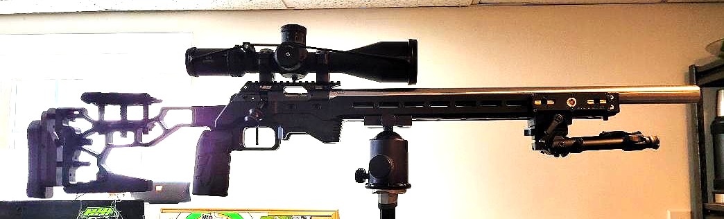

I am at 3 going on 4 months for one of his CZ457 stocks. Its in LH since MPA cant get their head out of their ass and make one in LH.
L3i bottom metal and mag well on the way before pillar bedding.

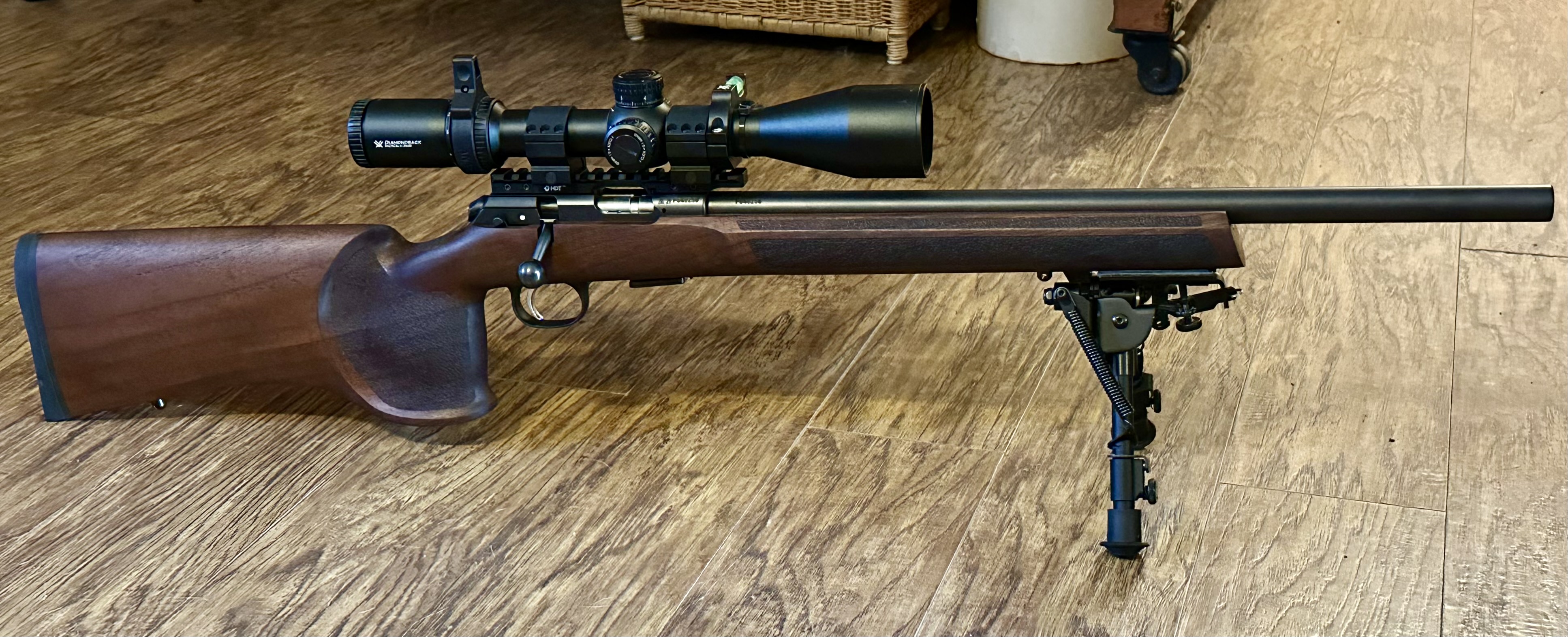

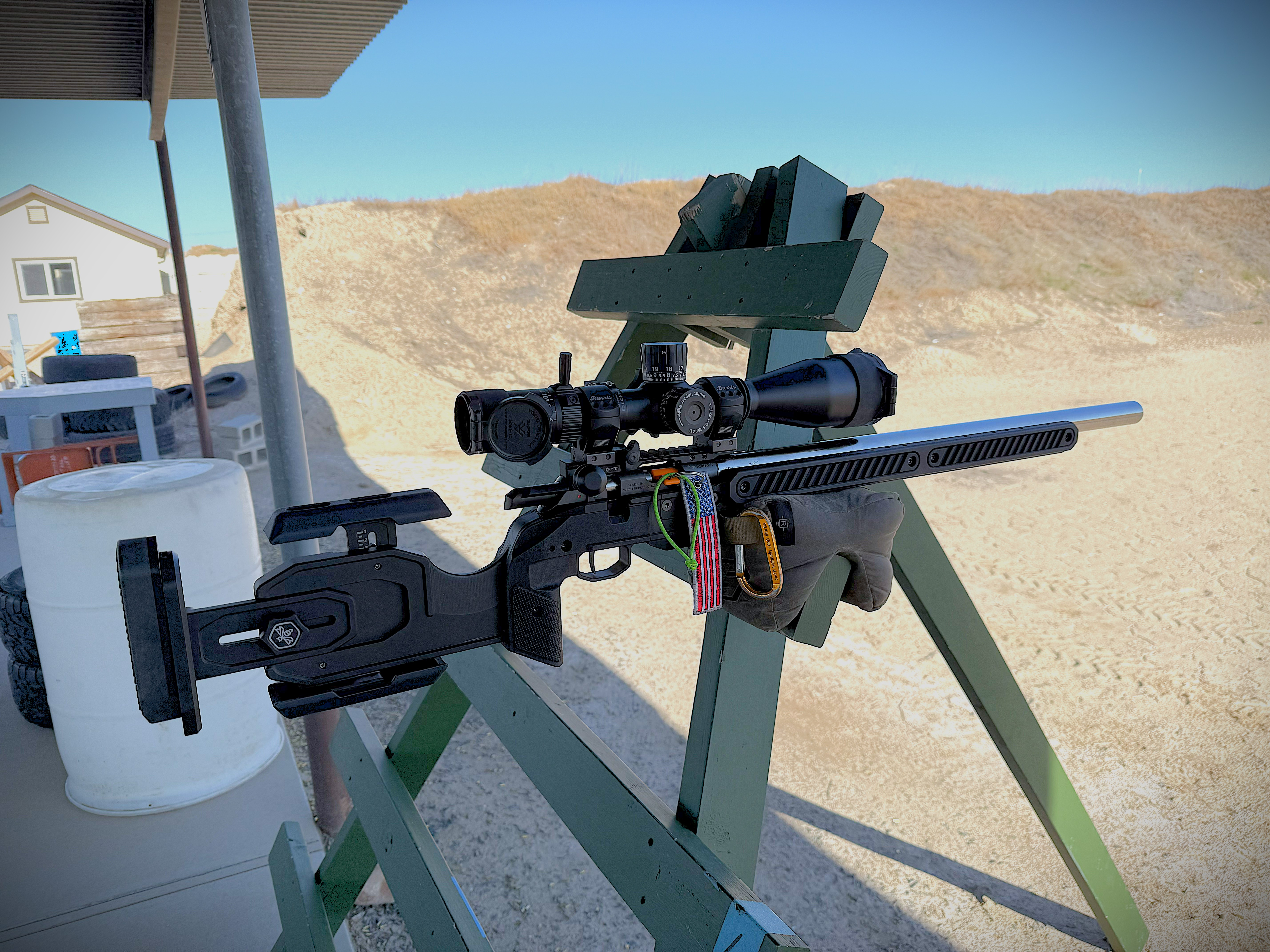

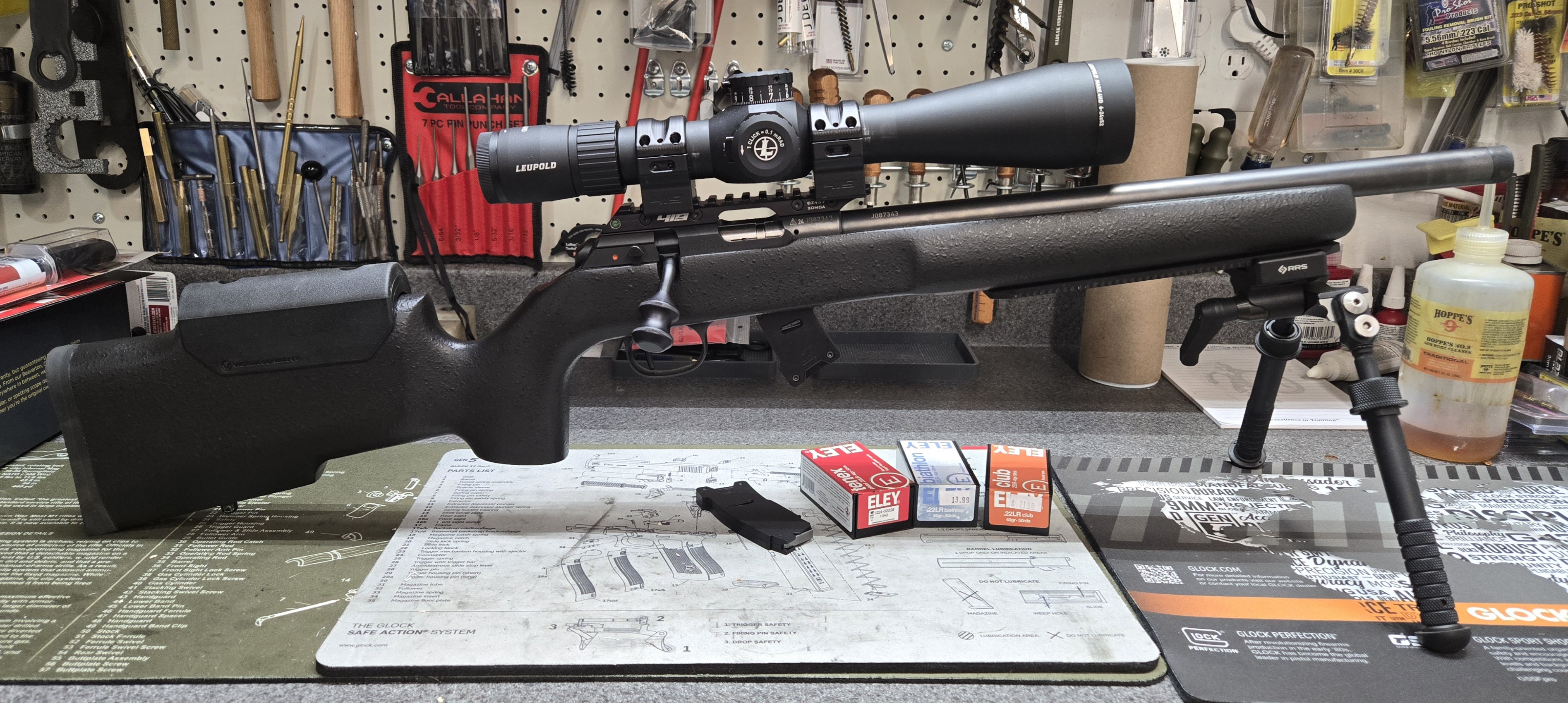

CZ must be listening. I found on the new Pro Varmit that the sling studs are not wood screw type like I expected and were attached with nylok nuts. There is plenty of relief in a router slot up front for Area 419 "T-nuts". Probably enough to add a bit of weight if one desired.
OMG the Timney is about perfect out of the box. Around 11oz. The rear CZ attachment pin is now retained by a (teeny weenie) e-clip. All the fuss I read about the rear pin being super tight is a thing of the past on this example. It only took about 10 minutes to find the e-clip once it launched. It didn't go far but was hiding under a clamp support on my gun vise. I don't think I've ever seen pliers small enough for that little booger. Actual trigger installation took no time at all, truly drop in.
CZ bolt knob came off easily with a pair of channel locks protected by a shop towel.
Area 419 Med (28mm) might be a touch higher than needed with the Area 419 30moa rail. Lows would have worked with a Mark4 HD 6-24x52. I think I'll need a 3rd spacer for the Victor Co. Cheek Riser. Cheek riser will need to be removed for bolt removal. I got the brass stock inserts just in case this was necessary. The scope is a touch farther forward than I would like. A skosh longer LOP wouldn't hurt.

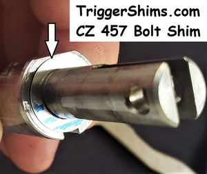

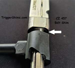

Depending on your ammo selection and headspace measurement, bolt shims were cheap and effective way to improve accuracy in my Pro Varmint.
Pillar bedding was +/- since mine liked lighter action torque settings so i'd only recommend if the bolt shims and lighter trigger weight doesn't help.

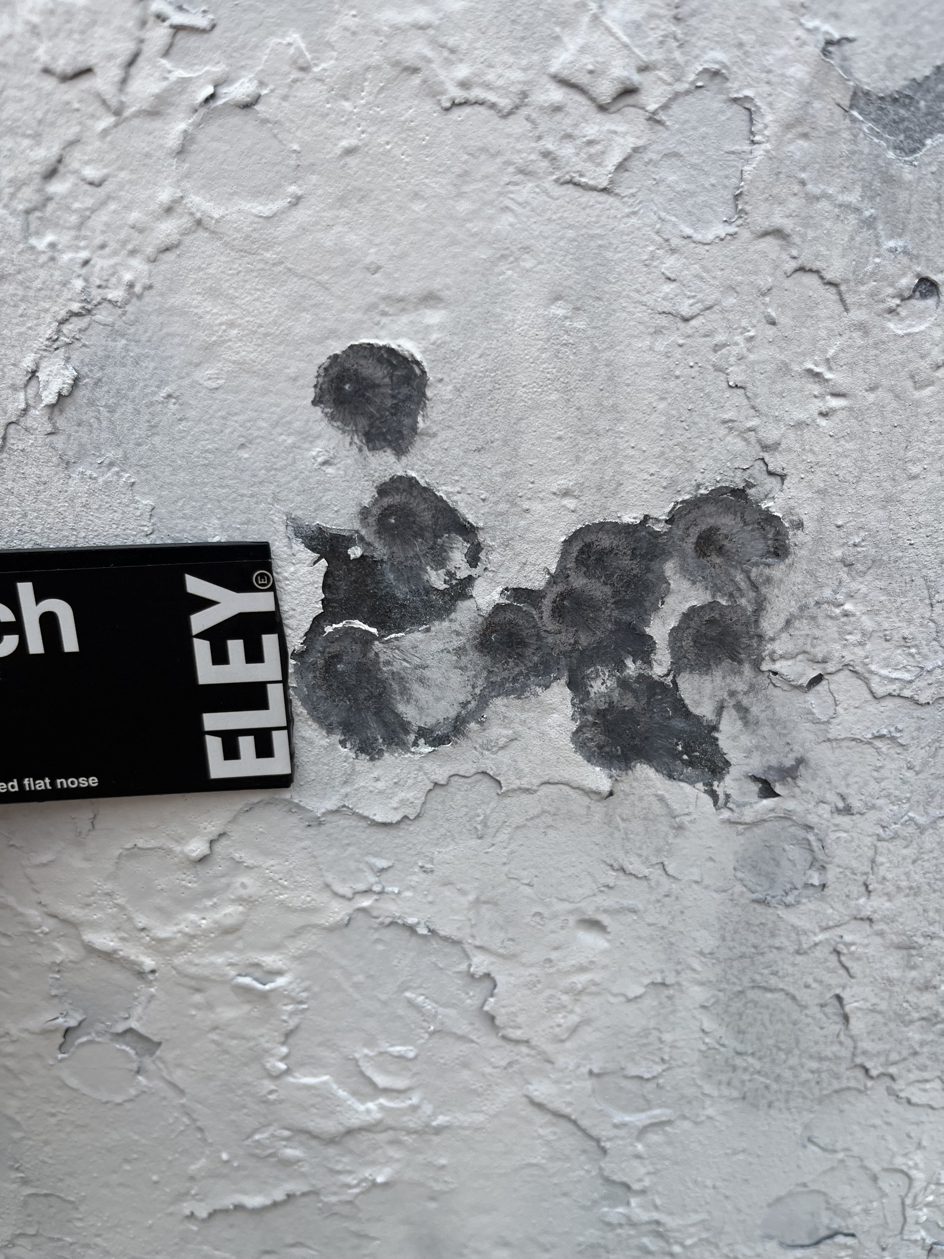

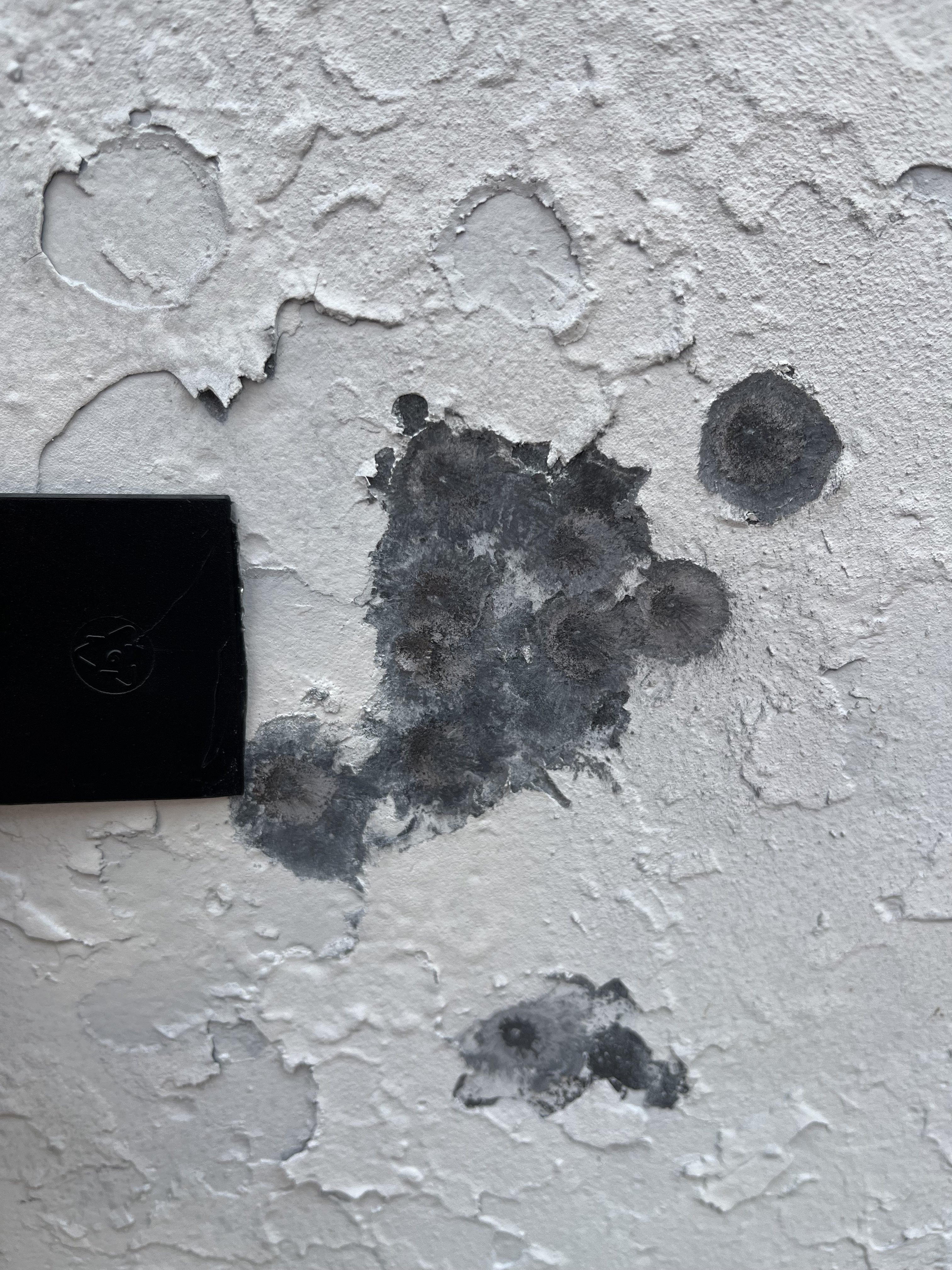

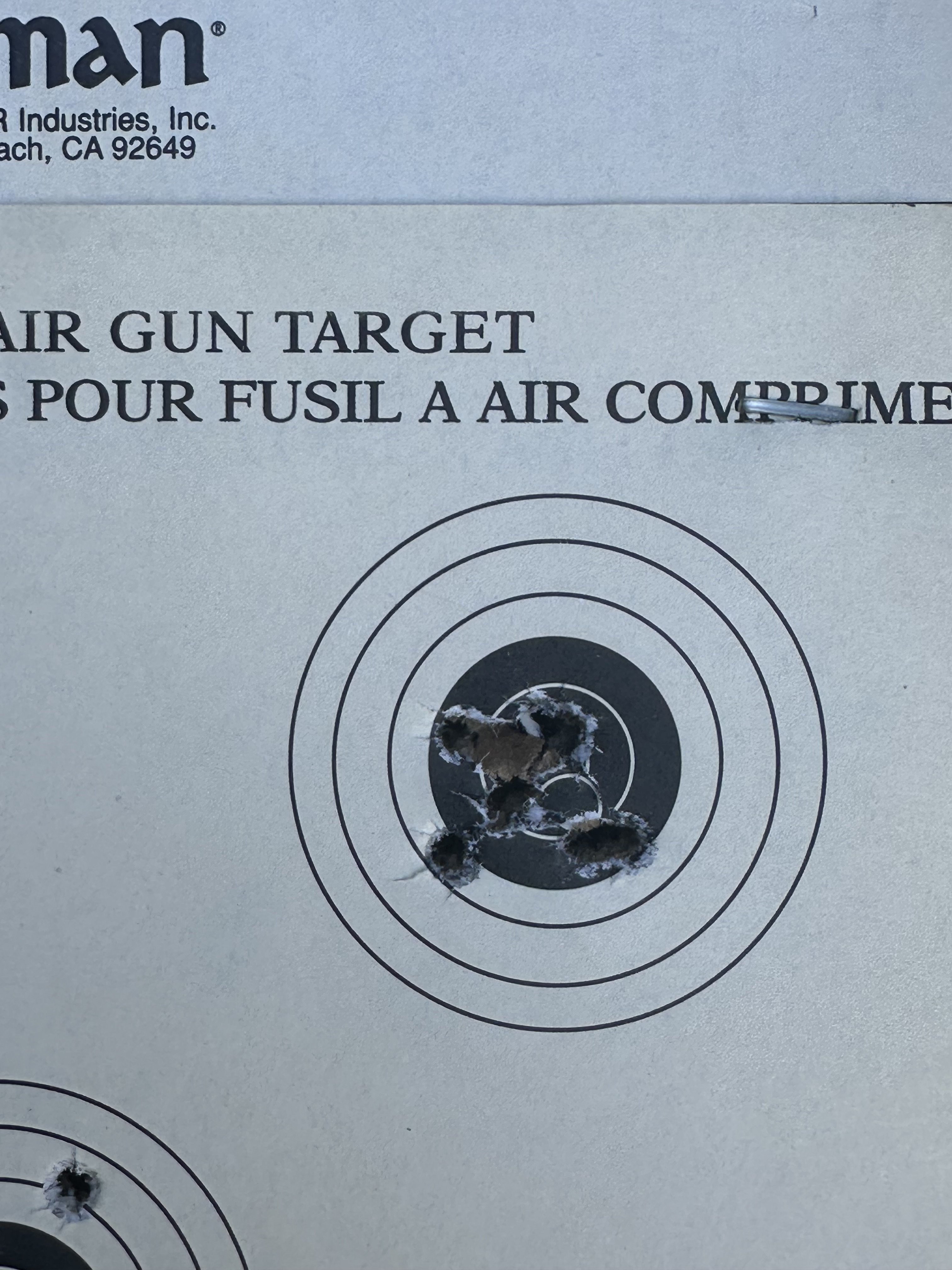

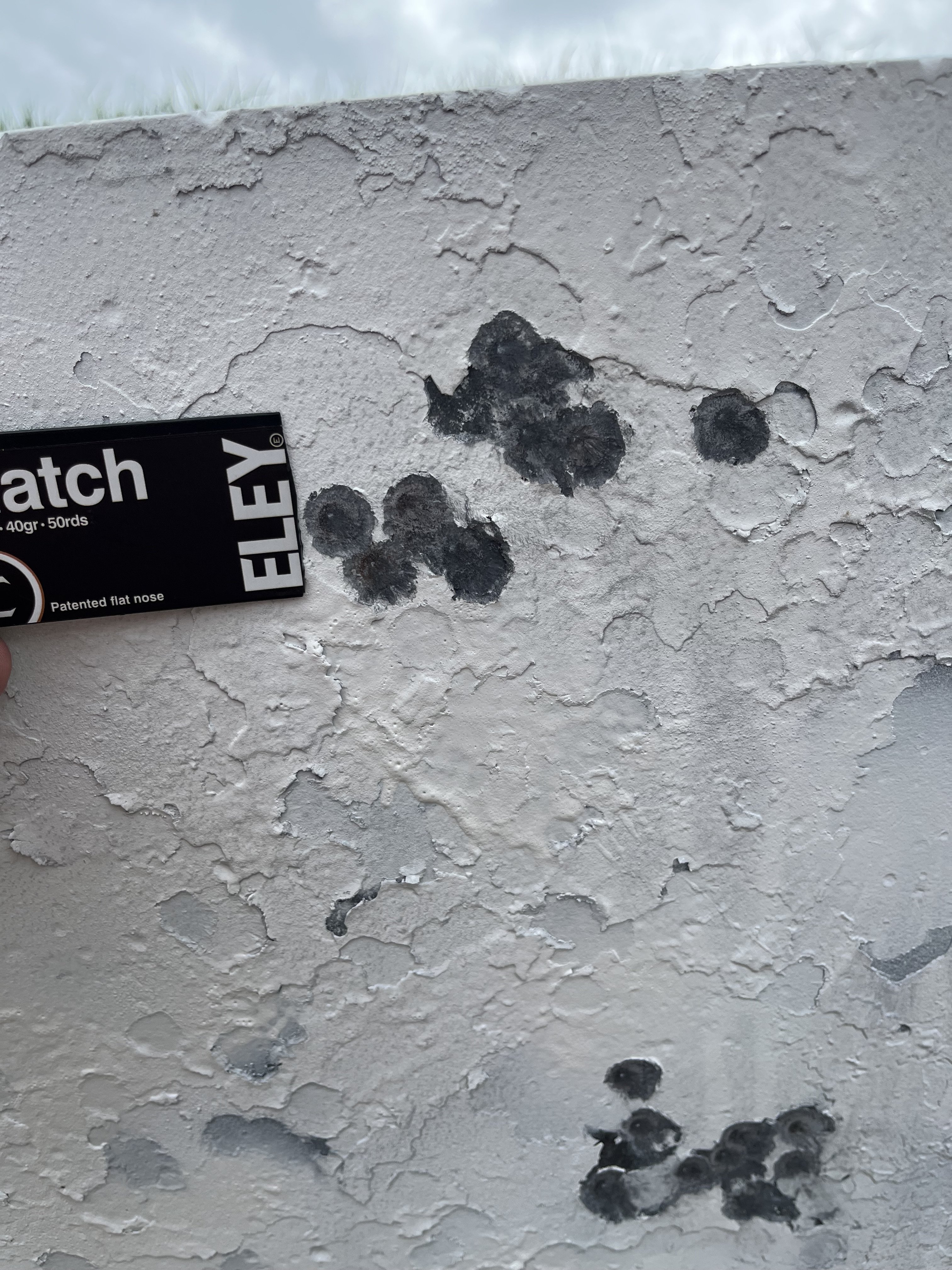

Tested out some different ammo today. Best groups came from Federal Auto Match making one hole at 50 yards. Then shot it at a 4” plate I have at 200 yards. I’m not adding or changing anything except a cheek riser and an arca rail and change the scope out. Gonna use it as a base class rifle in NRL22. Might lower the trigger pull a little but the stock trigger is pretty good as it sits now.
Both groups were shot at 50 yards with federal auto match. One 5 and one 10 shot group. The 10 shot group opened up some but that’s mostly me I think.

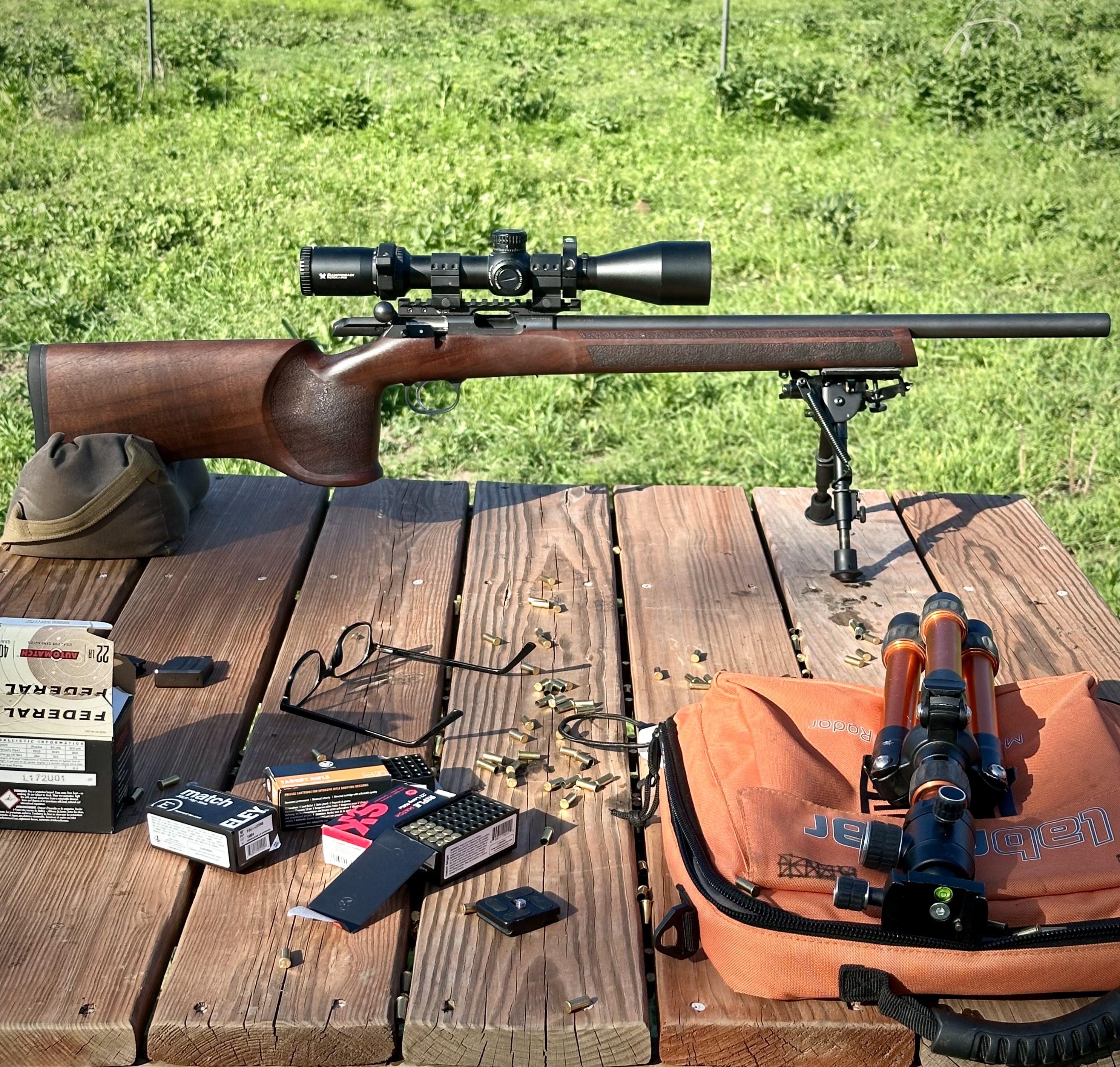

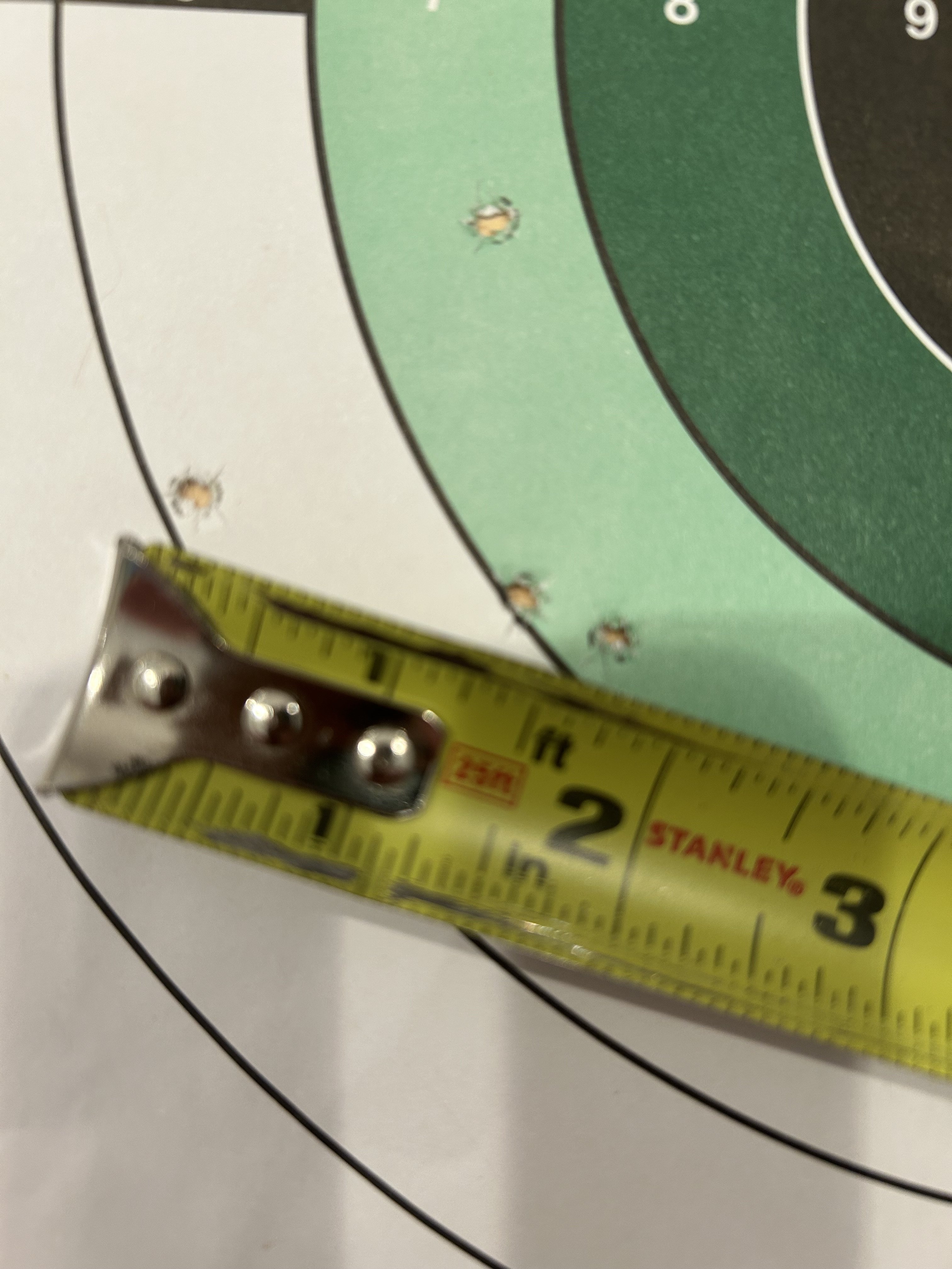

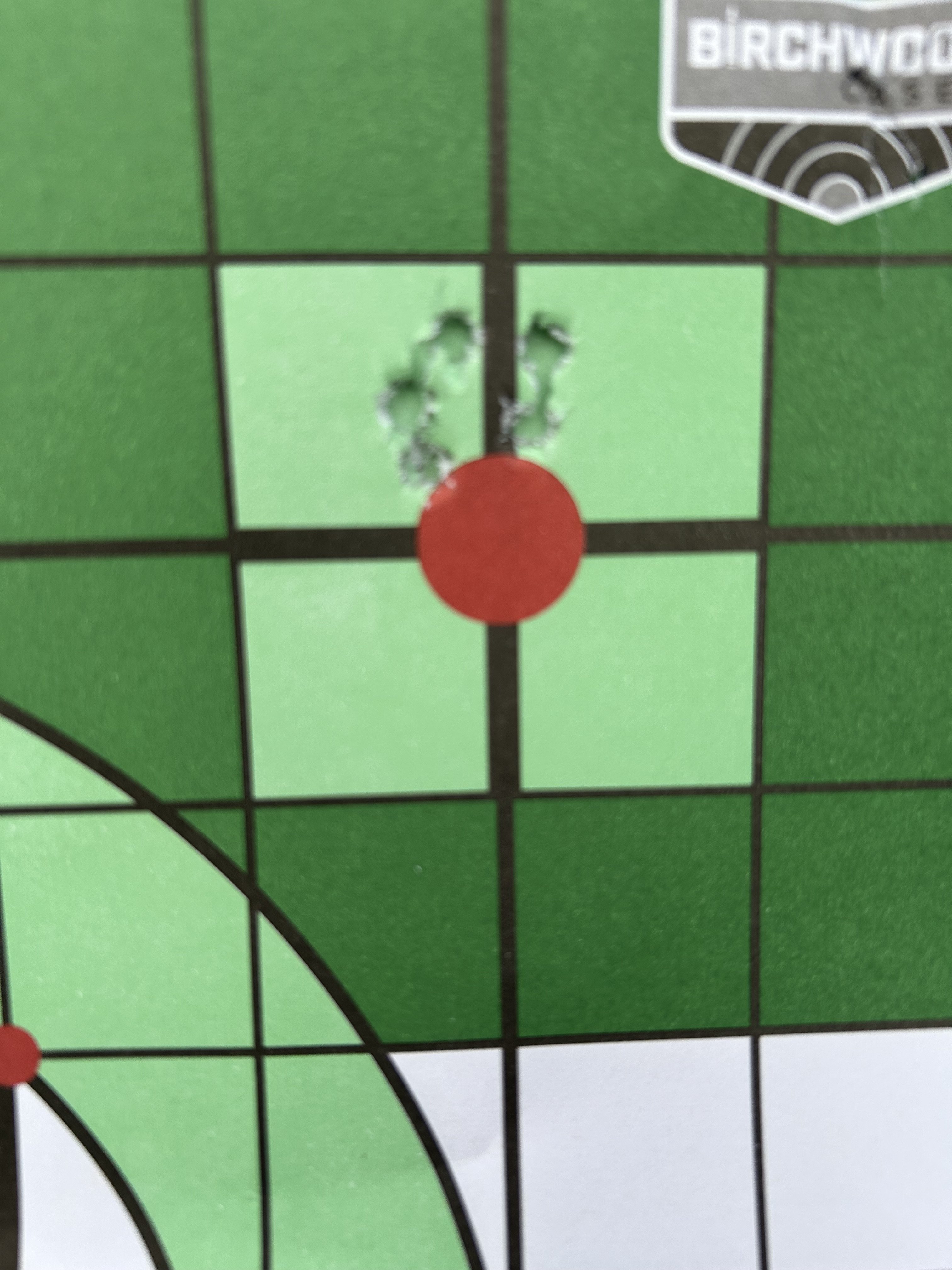

I had shared this in the L3I barrel thread, but thought appropriate to share here. 50 yard groups are almost boring. These are 10 round groups at 215 yards with a couple of lots of ammo I had (none were specifically tested for this rifle).
I have a second CZ457 action sitting in my safe that is brand new, waiting on a second L3I barrel. I plan to document the first shots out of it just to show how incredible these rifles can be. The gun was delivered in about a week, and the barrel is expected in the next 1-2 weeks.
For these groups, there was a 3-5mph breeze coming from 10:30 or so. I held the exact same hold on each shot, so vertical is what I was looking for here. Again, 215 yards with a prefit barrel shooting with a bipod and rear bag.

Also shared in that thread some chrono data. 29 shots with an SD of 4.2. Yeah - hard to argue with the results with this setup. The L3I team has it figured out!
That's a crazy low SD, hope you managed to buy a bunch of that lot of ammo.
CZ457 + L3i barrel is definitely hard to beat for value for money.
