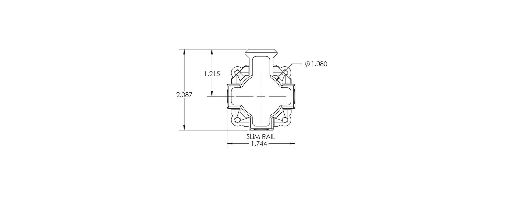

This is from the website
Once I’m home I can post actual dimensions

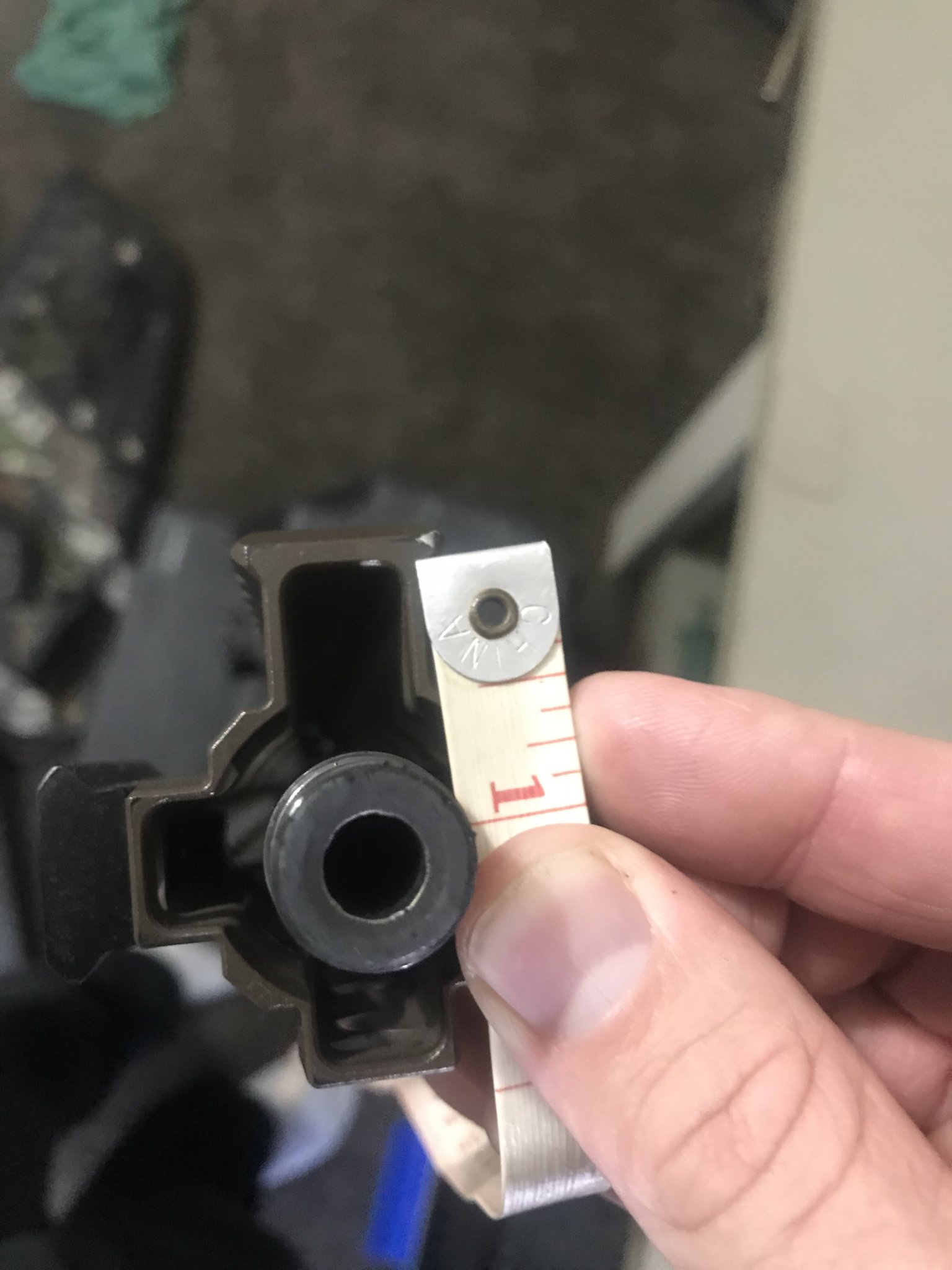

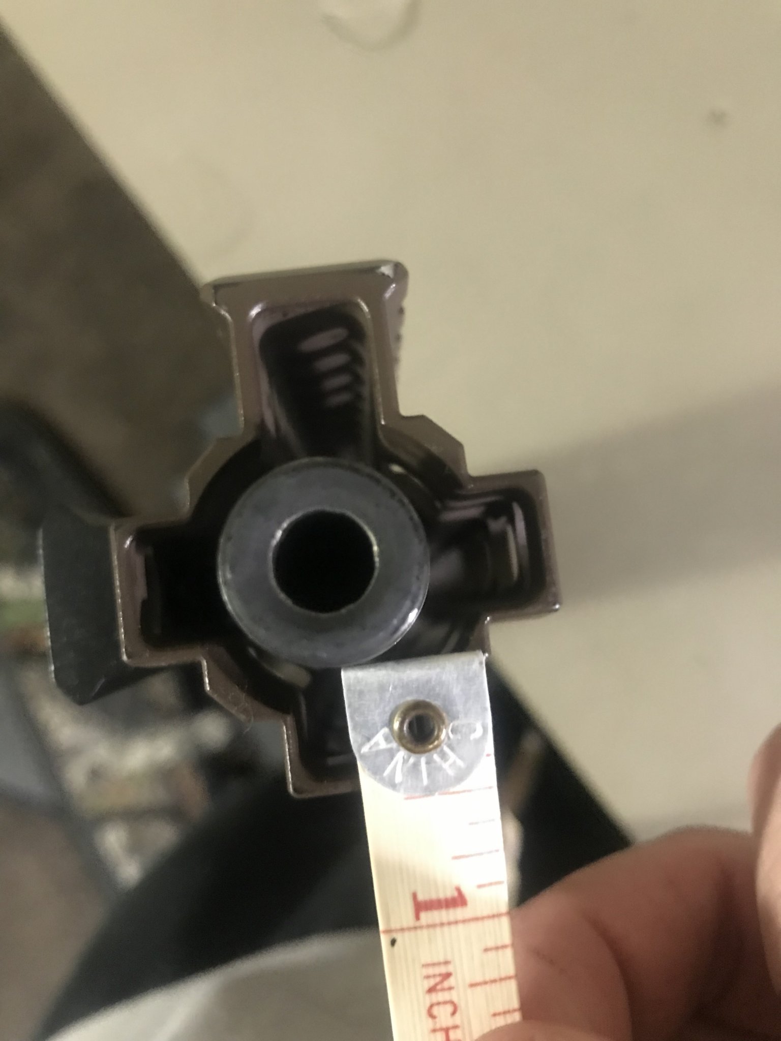

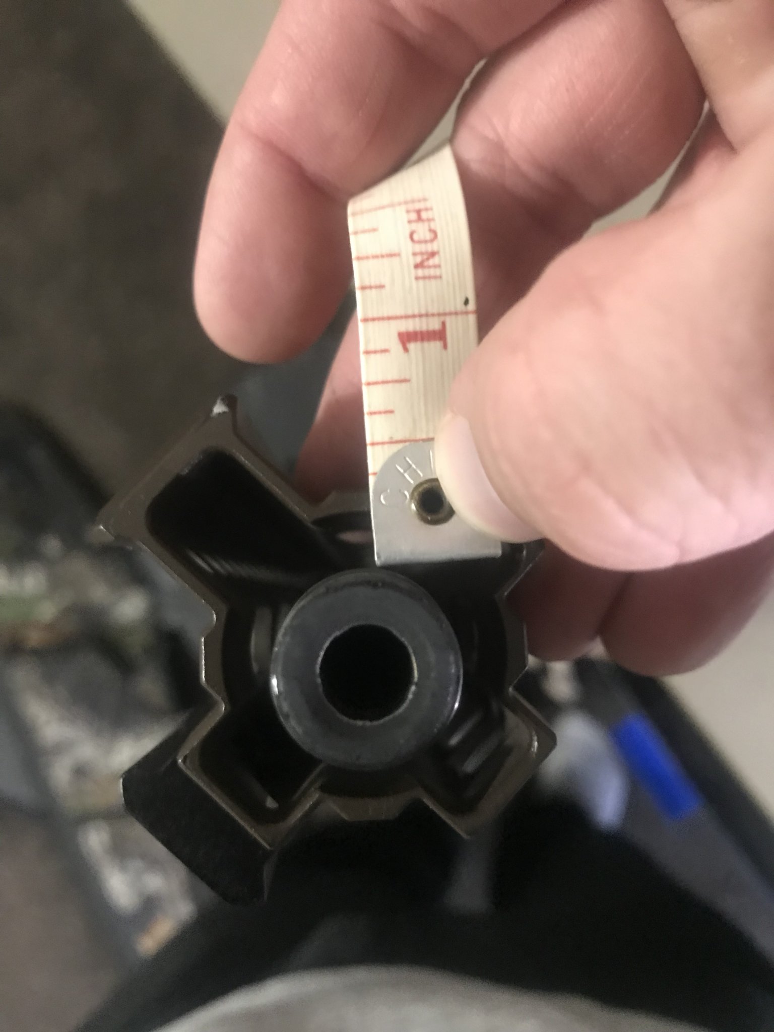

Don't try a Master of Arms titanium adj gas block. I just took my hand guard off and tried to put it on a build waiting on a suppressor (Recessed can in hand guard). If it was set screw, and not clamp on, it would have been fine I think. I may be curious about this one as well in about 1-2 months.
I personally may just try a heavier buffer and slightly heavier spring first though. Comes with an H, and already have an H2 and H3 with a white/blue Sprinco spring sitting in packaging in the spare parts draw.
Here are some pictures.
You can see very little space from barely to handguard

That's probably your best bet. Other option is a whole new nut and hand gaurd to fit your preferred block. I personally happen to like the slim profile though.
Let us know how the H3 goes. I'll probably pick up the JP SCS with weights and springs.
