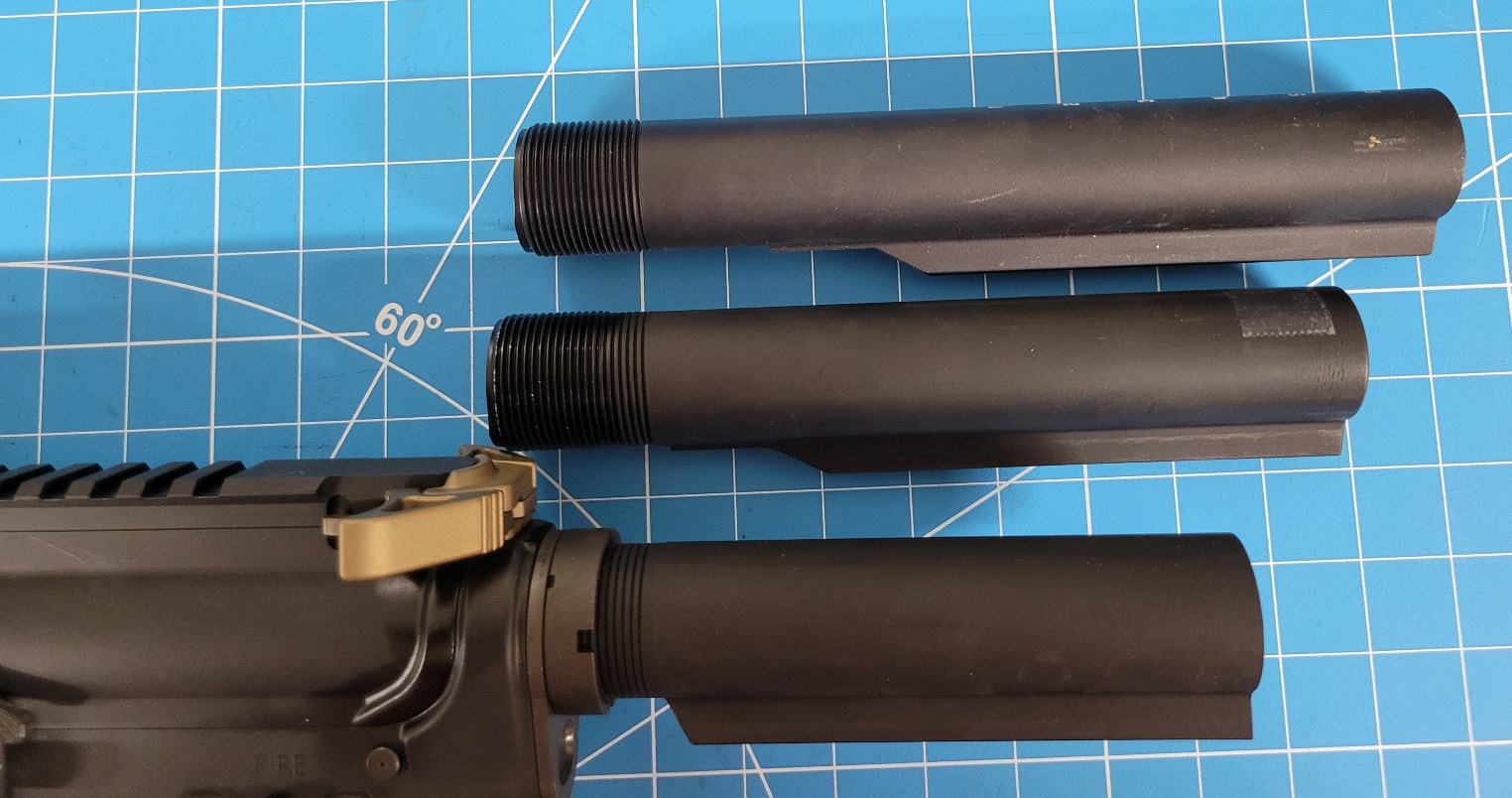

So basically dialing in your adjustable gas block in to relieve the extra pressure against the standard carbine buffer setup; would be the same as a fixed gas block using a a5 heavier buffer setup. So no need for both. Correct me if I miswrote that 👍
More or less. And the A5 doesn't give you anything but added length and weight. Use a regular buffer and turn the gas down.
That logic makes sense. Having the A5 setup on hand if I go non adjustable gas block; Then dial the action momentum down with the riflespeed gas block while using the regular buffer system to get the same result.
The weights shifting in the standard buffer during recoil, compared to the A5 would be so micro I doubt a humans sensitivity would be able to feel that difference.
Do you believe an important factor could be the rifle length springs return being less harsh than the return of the bolt on a standard spring, resulting in less wear?
Or is the entirety of this so close to the same it's completely irrelevant.

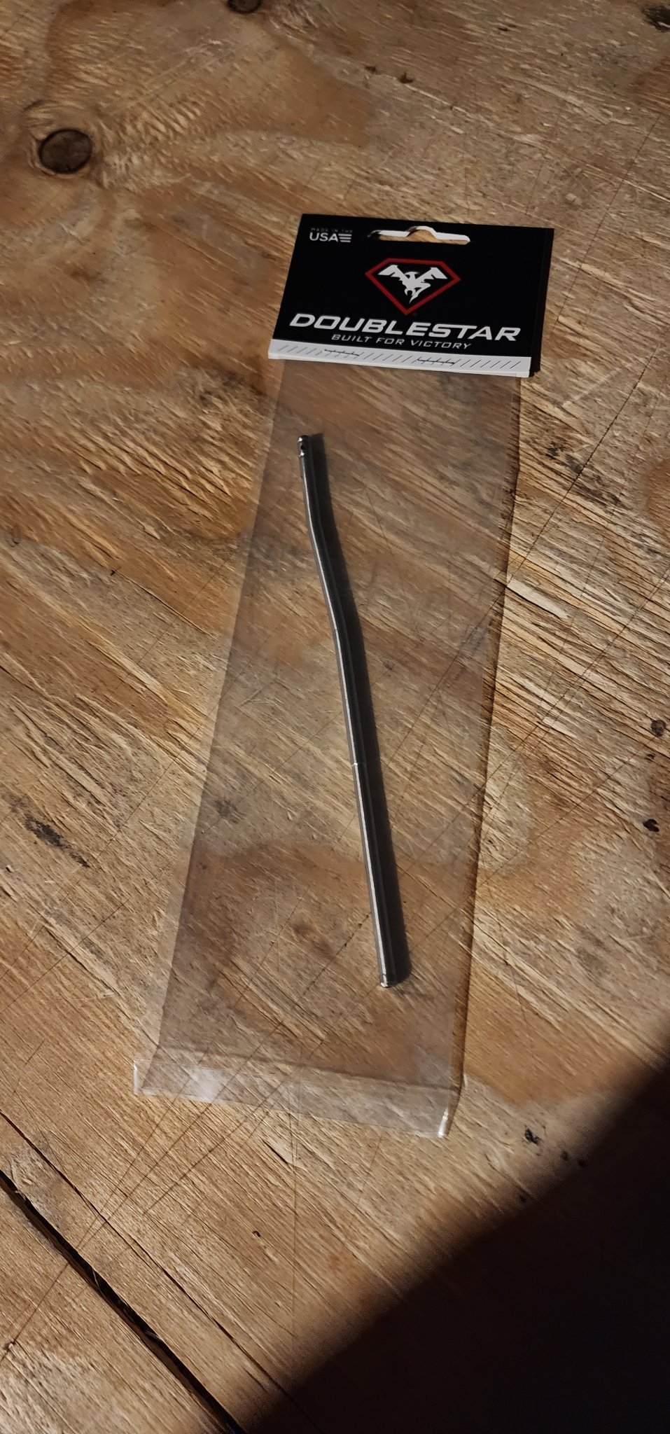

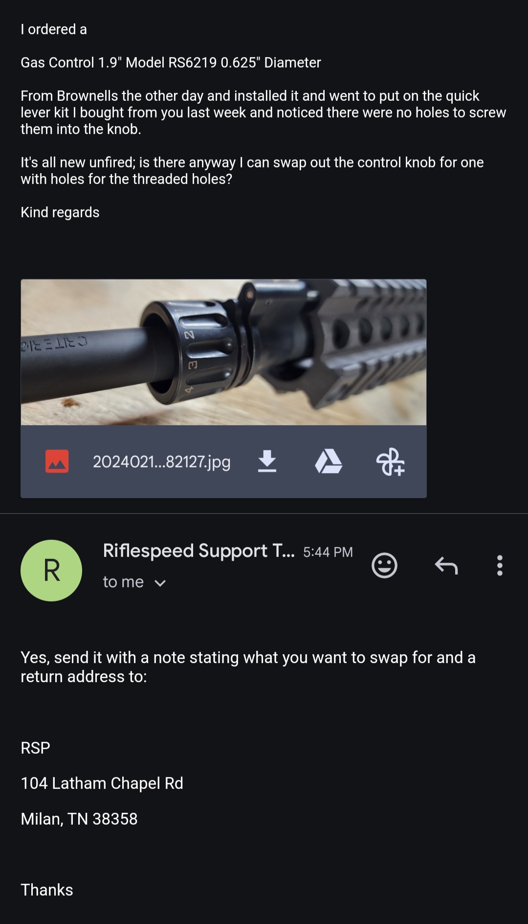

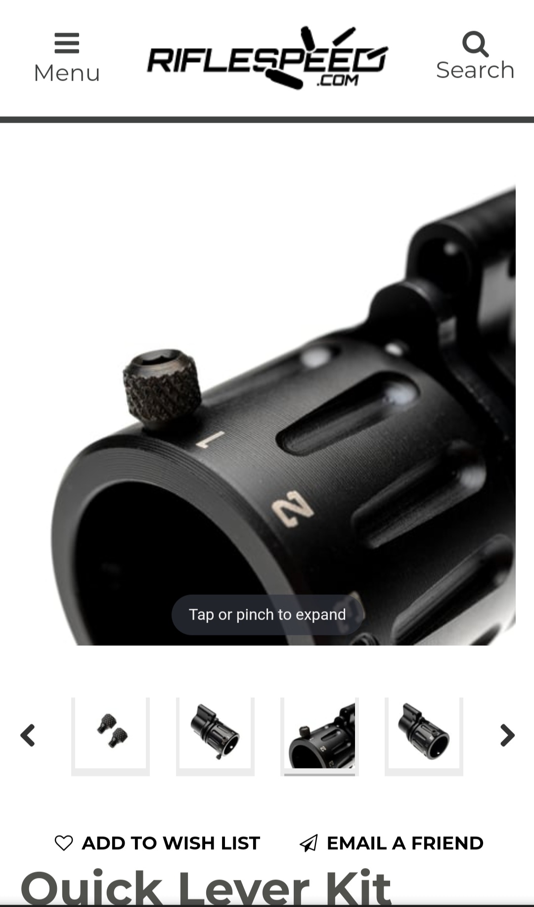

Something funny happend; Riflespeed Box from Brownells came today. I felt how light the box was an instant "oh no"; recieved this random $10 gas tube instead. 🤣
All fixed now with expedited shipping, I intentionally order from them due to their expedient shipping and excellent customer service but It's Valentine's not April fools haha
I'm the proud owner of one cute lil gas tube that I do not need. I guess I can use it as a $10 metal straw
Glad they were able to help. I bought the slightly longer one too just to fill the gap a little between it and my OTB.

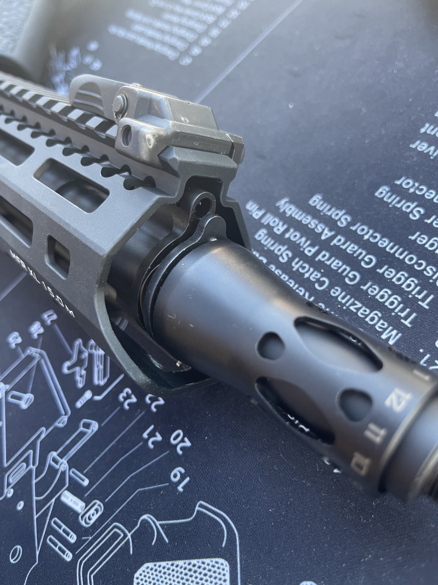

These gas blocks are a little tight for alot of MLOK handguards unless you pick up the MI suppressor handguards or the Aero Enhanced MLOK.
Quads are typically 1.3 ID but you don't have to worry about MLOK screws running into things.

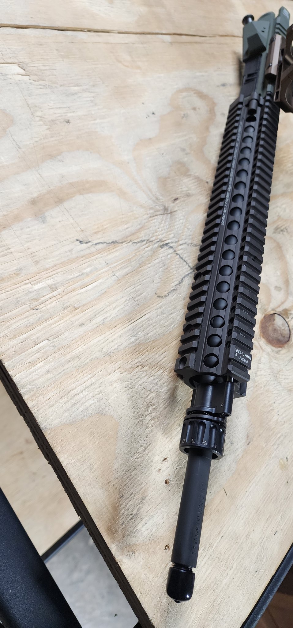

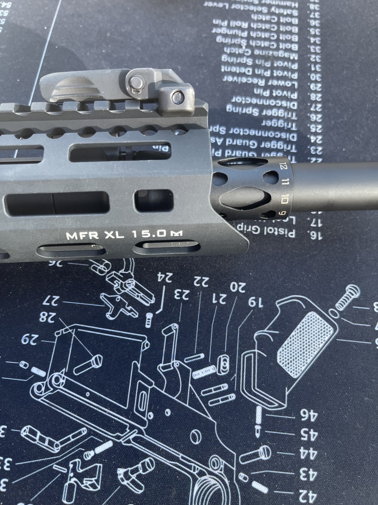

Yeah if this Ris II was any longer I'd have to get it machined to fit the riflespeed.
Looks great; Do you have a pic of your rifle with the longer knob? Is this an 18" barrel you have?
I do but it's just something I threw together to see if I even like it. Yes, 18" barrel.

Nice! I like how the OTB shroud of the flash hider makes everything blend together between the muzzle device and the gas block

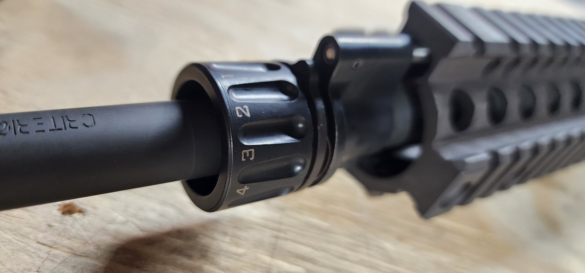

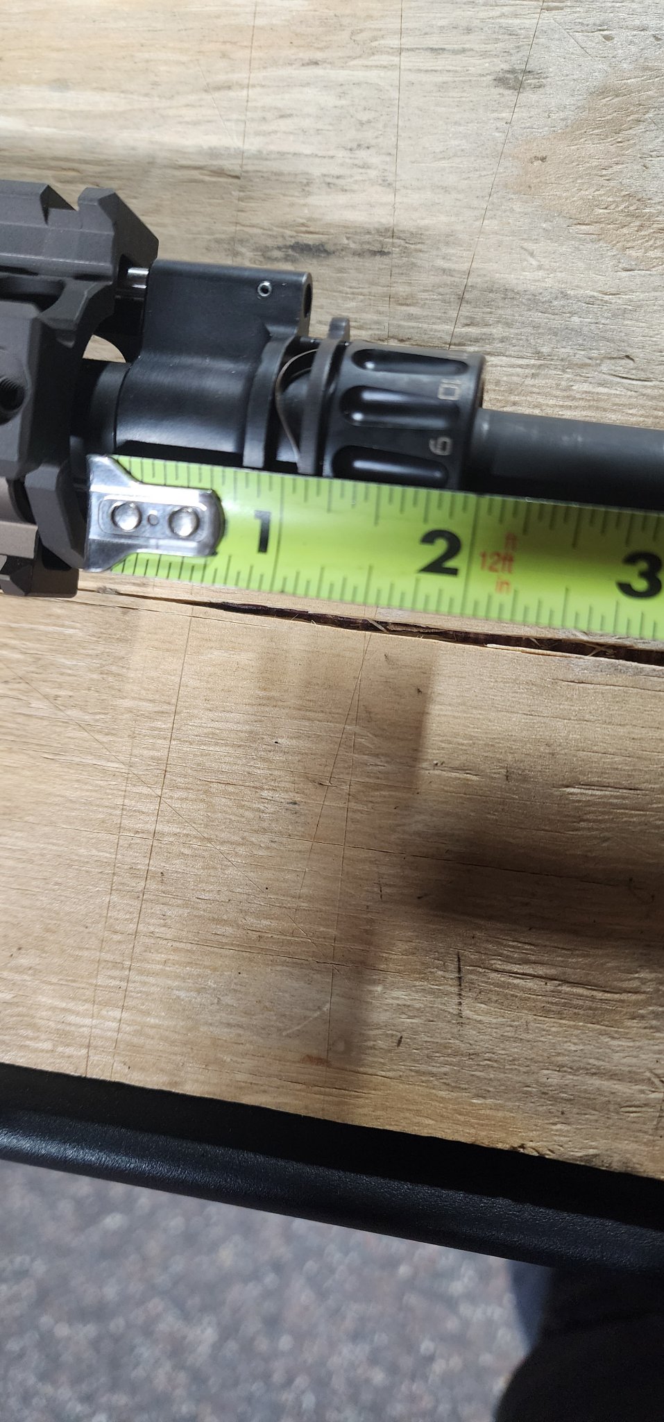

FWIW, Im just trying to understand their model length naming convention..your RS6219, is the 1.9" length the total length inclusive of the gas block, or just the adjustment dial?
Looks like the total length is 1.9" with the dial on #12. Just a tiny bit shorter with the dial turned to #1
I haven't used mine, someone else will have to answer that question.
For me, the only thing the A5 makes sense for is on large frame AR-10s so you can use standard carbine size buffers, instead of the tiny little LR-308/AP4 DPMS carbine buffers that don’t allow much mass.
I found the little mini/PDW RETs for the AR-15 with the tiny buffers and stiff springs to work surprisingly-well, especially on 6.5 Grendel shorties. The first one I tried felt like this is how it’s supposed to be. Super-smooth, cyclic rate was perfect, ejection was right in the window, action behaved wonderfully.
New to the forum looks like you have a DD MK12 hand guard? I went with a MFR XL 15.0 to cover the riflesspeed gas block on my DD Mk12 top of the gas block to the bottom inside of the rail gives you 0.123” of clearance will post pics still trying to figure out this forum stuff I’m not computer savvy.

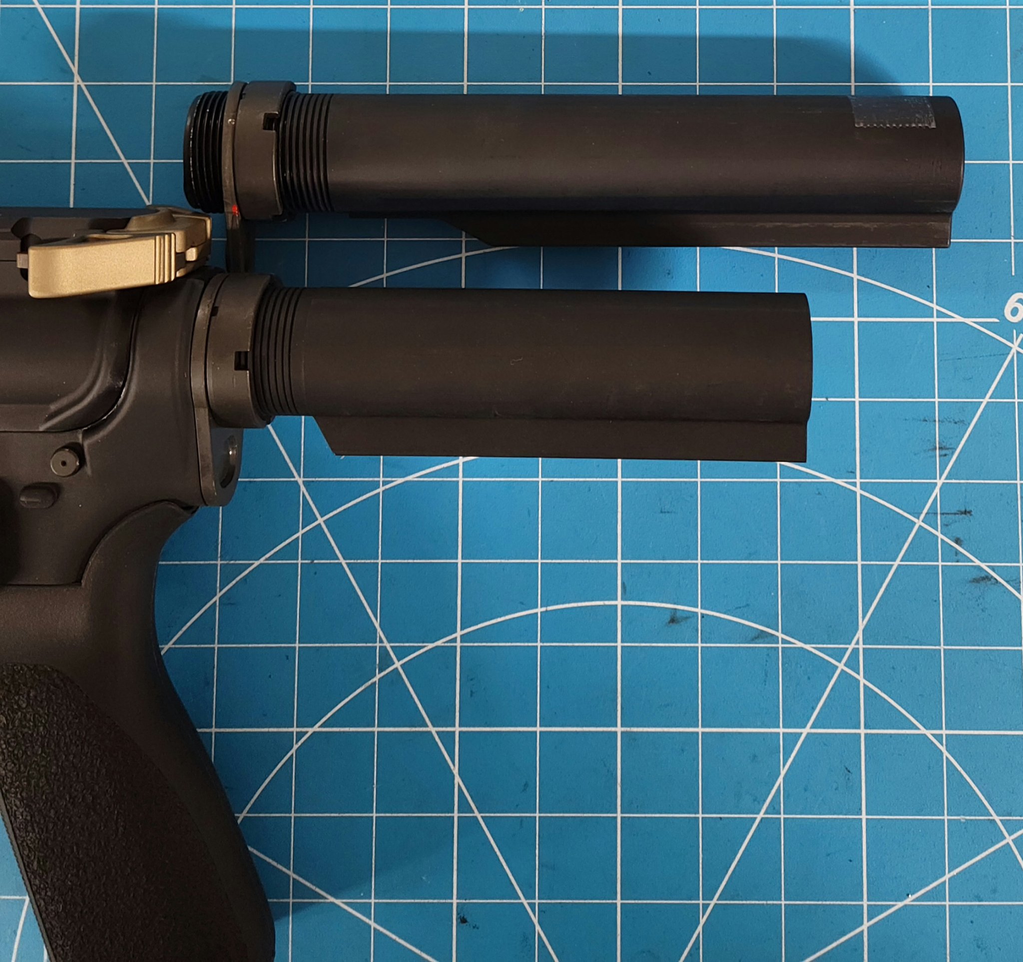

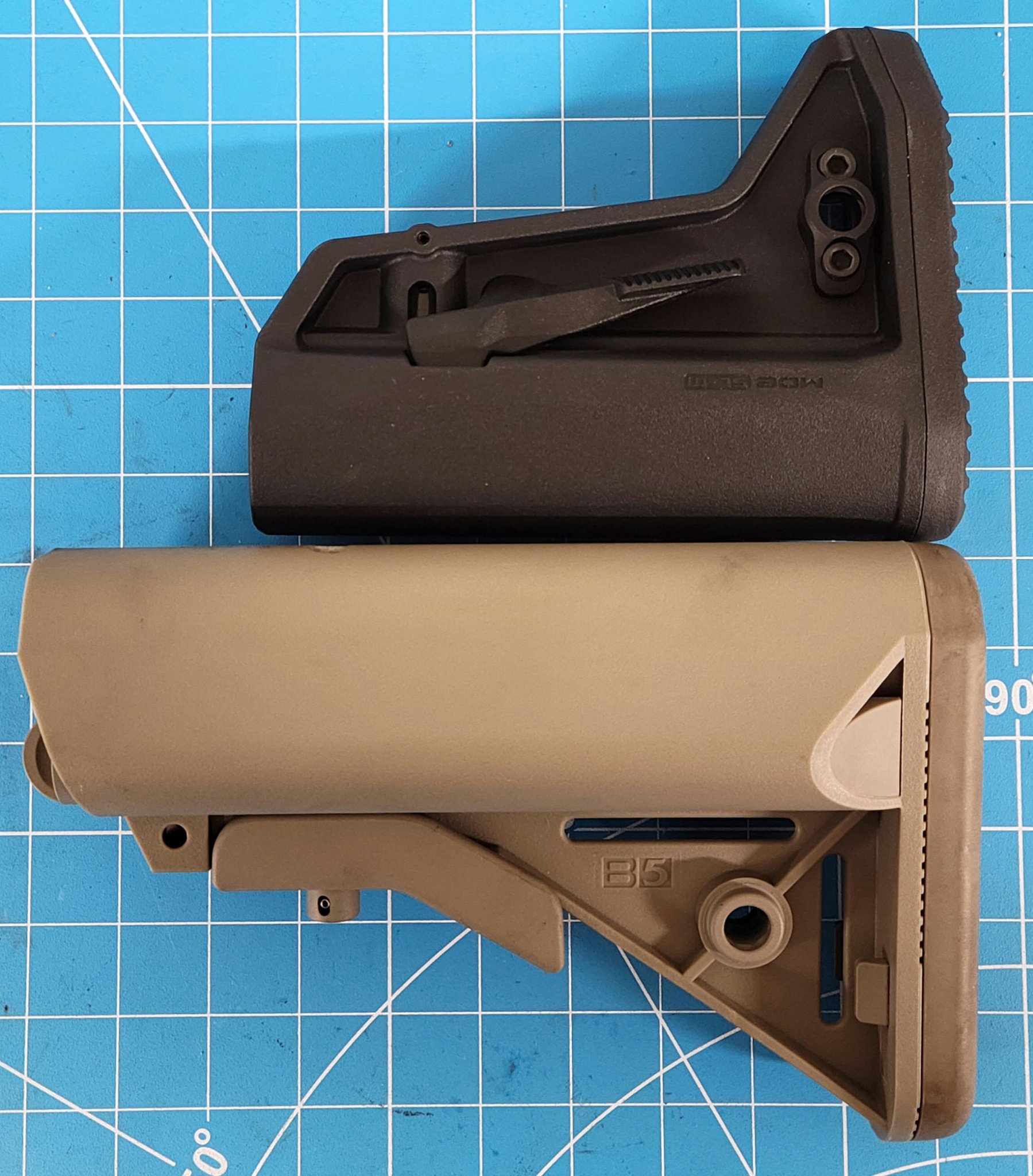

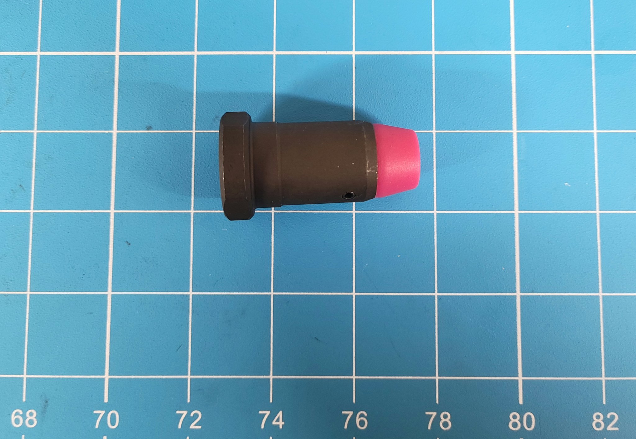

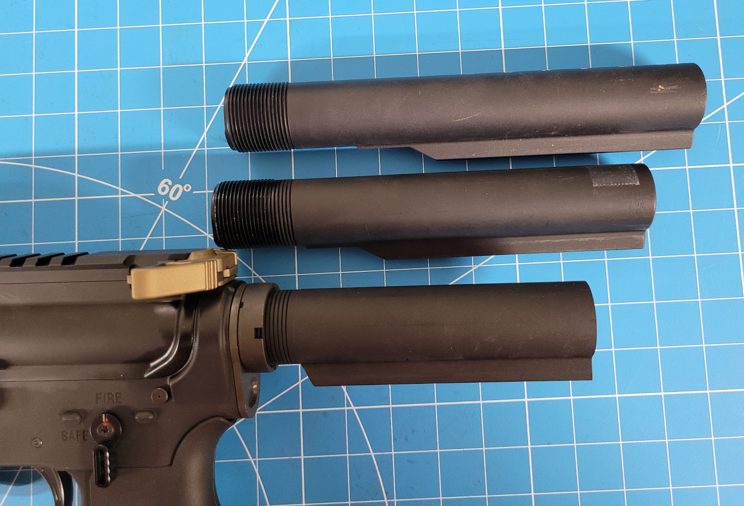

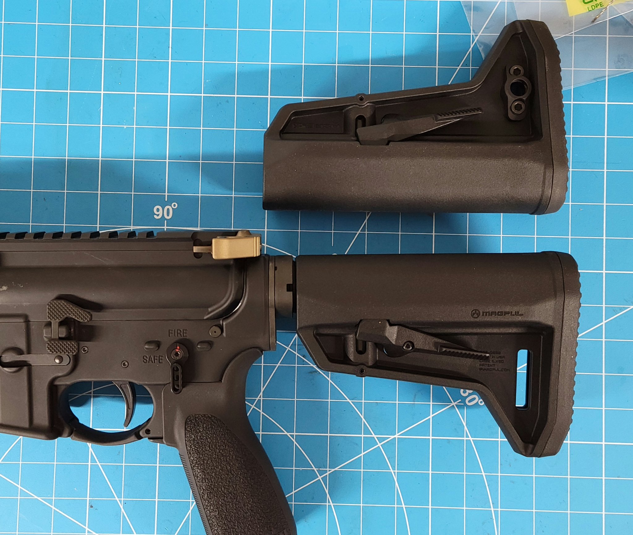

Pictures for those that don't know what you're talking about.
That is super cool. What setup is that specifically? I'm interested especially if y'all are saying it works so well.
I have a Centurion CM4 Complete 11.5 CHF FBI w/ FSB coming in today.
The buffer and tube are from KAK. The buffer is 3.3oz and uses a heavy flat wire spring. LWRC makes the UCIW which is similar and what the Magpul SL-M was designed for. All standard AR15 BCG's have the same stroke length, regardless of buffer and buffer tube length. You asked about adjustable gas blocks and buffers, you're balancing one with the other. You don't need heavy buffers when you balance the gas with the buffer weight and spring rate. The gun will shoot better, within reason, with less reciprocating mass.
The rifle in the pictures is an 11.5" mid length gas with the KAK 3.3oz mini buffer. The rifle functions with light .223 and M193 at -10F using a .063" gas port and Turbo K silencer. I worked up the configuration using gas ports from .052" up to .070". I also compared the barrel port configuration with H1 and H2 with SprinCo Blue and Red springs and Vltor A5 H. I've done the same setup methodology in a variety of other barrel lengths and cartridges.
I understand what your saying; Great Info! Thanks for sharing. Im definitely going to check this out.
