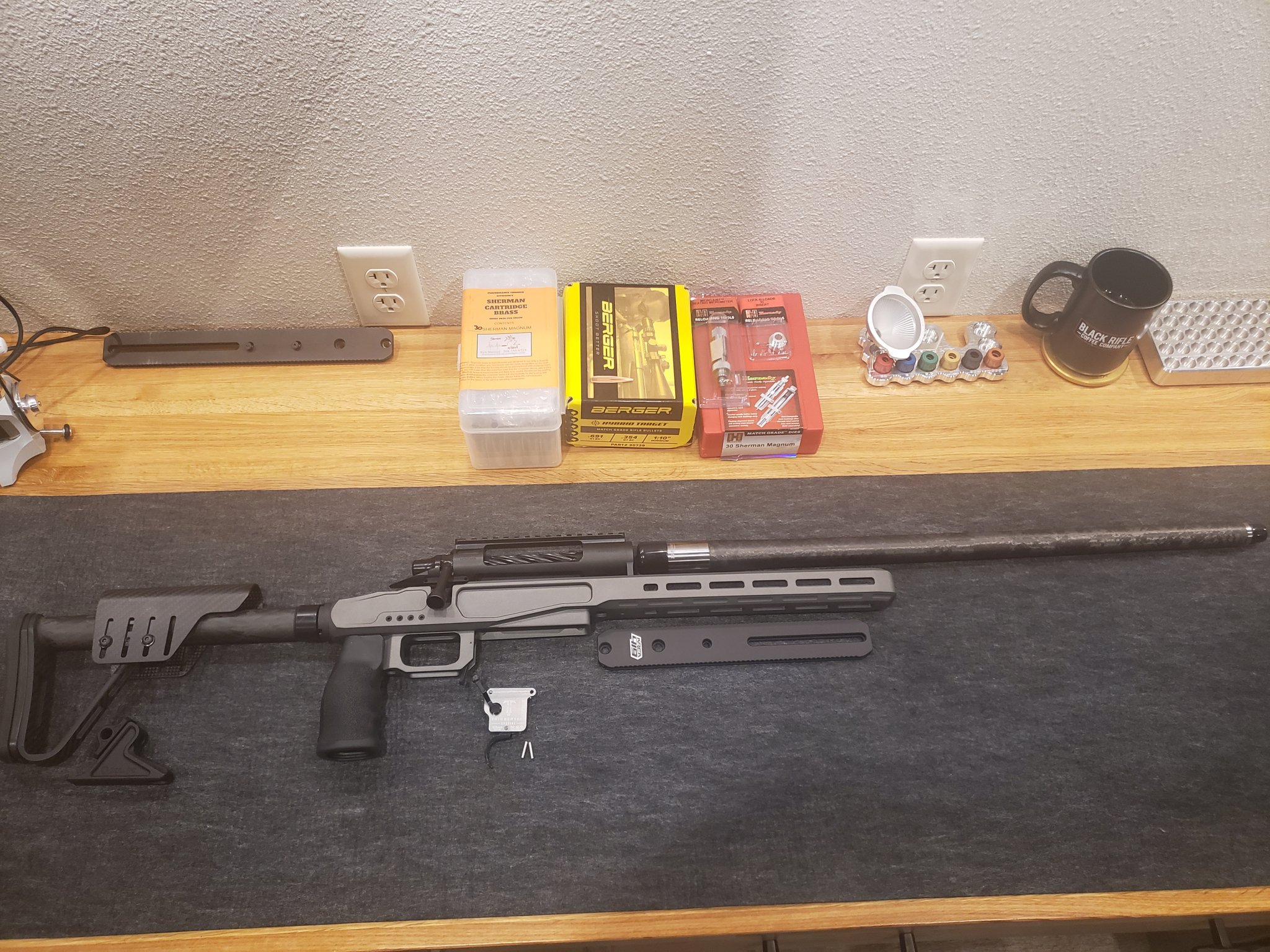

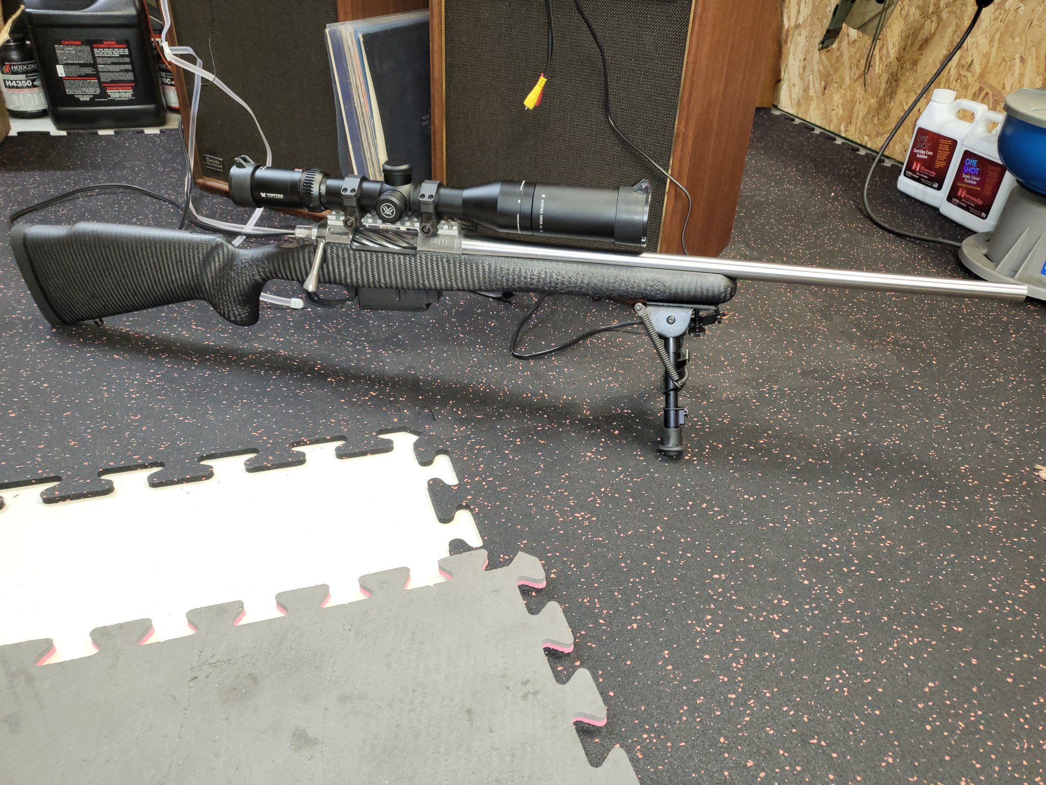

7SAUM on XM in progress. More to come...

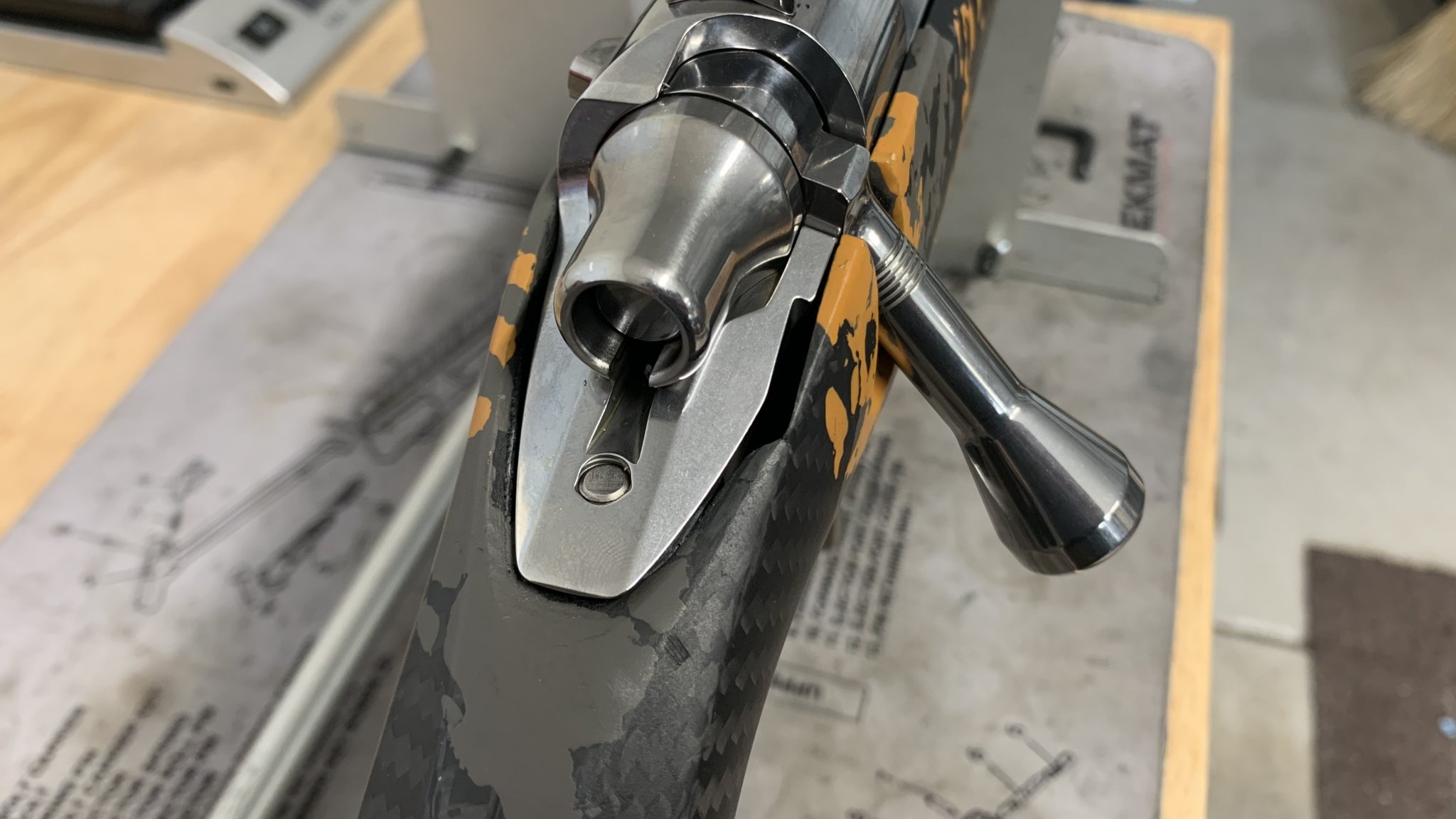

I have about 100 rounds through mine so far. I don't see much of a difference between other Definace actions I have used. I was a little nervous about the small bolt know but its been a mute issue thus far.

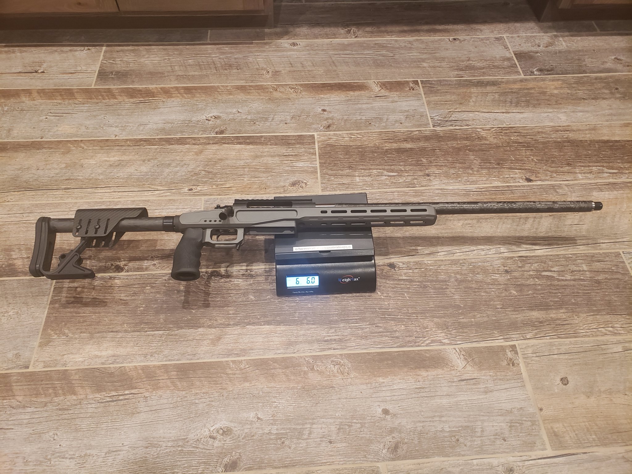

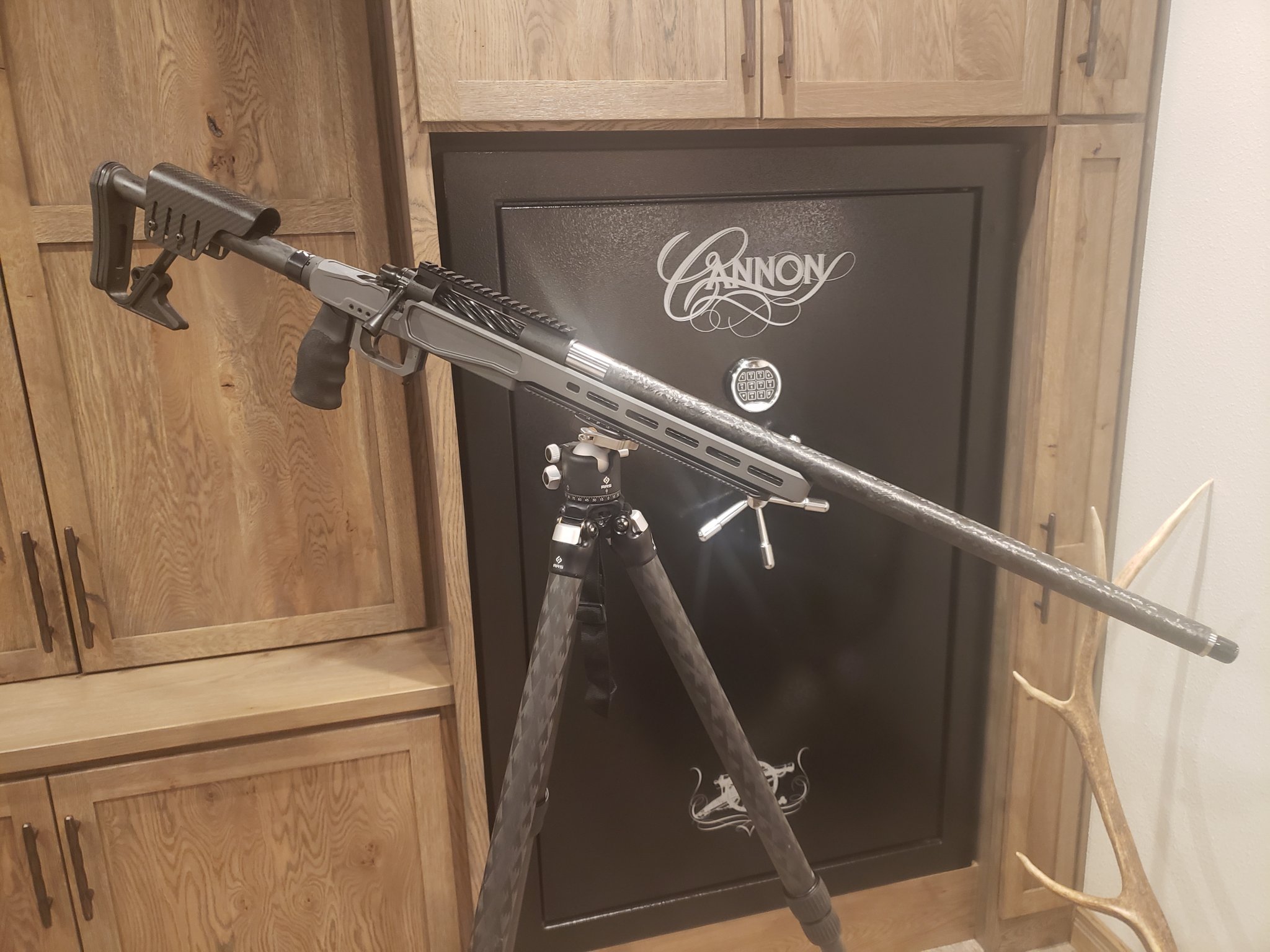

Got 2 anTI
One is on an MPA ultralite with a 300blk 12.5” Bartlein rem mag sporter barrel. 6.75 lbs with a Razor LHT HD 3-15.
The other one will be matched to a Manners Ultra Classic with a 19” Benchmark featherweight 204 Ruger with an Accupoint 3-9 mildot. Should be under 6lbs easily, just waiting for my smith to finish the bedding job.
Love them both. Probably will get a couple of prefit barrels, maybe a a 224 throated for those 88 eldms (22 creed?) and maybe a 6.5 prc. It’s way easier to move around a 6lbs gun than my 15 lbs DTA.

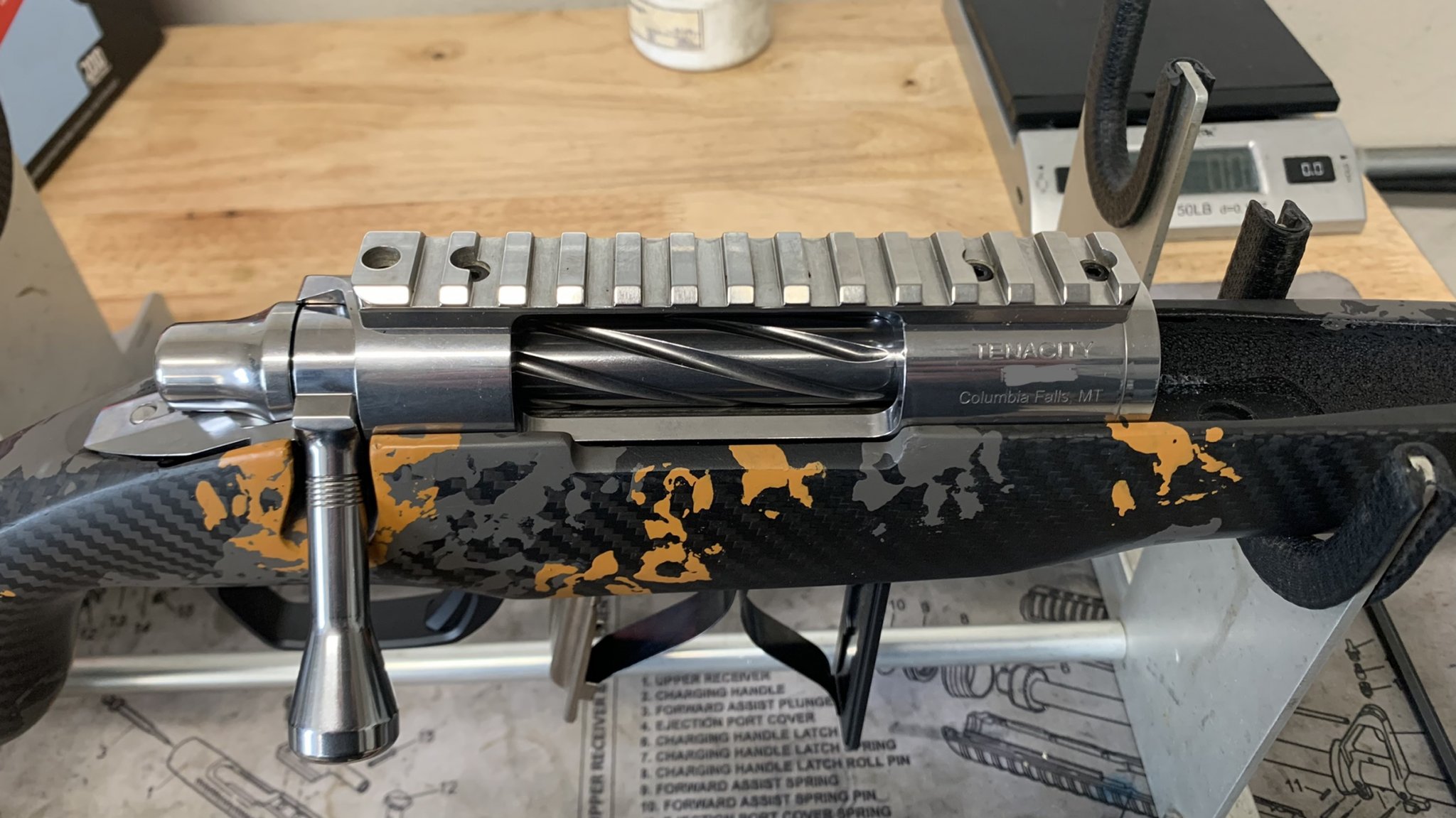

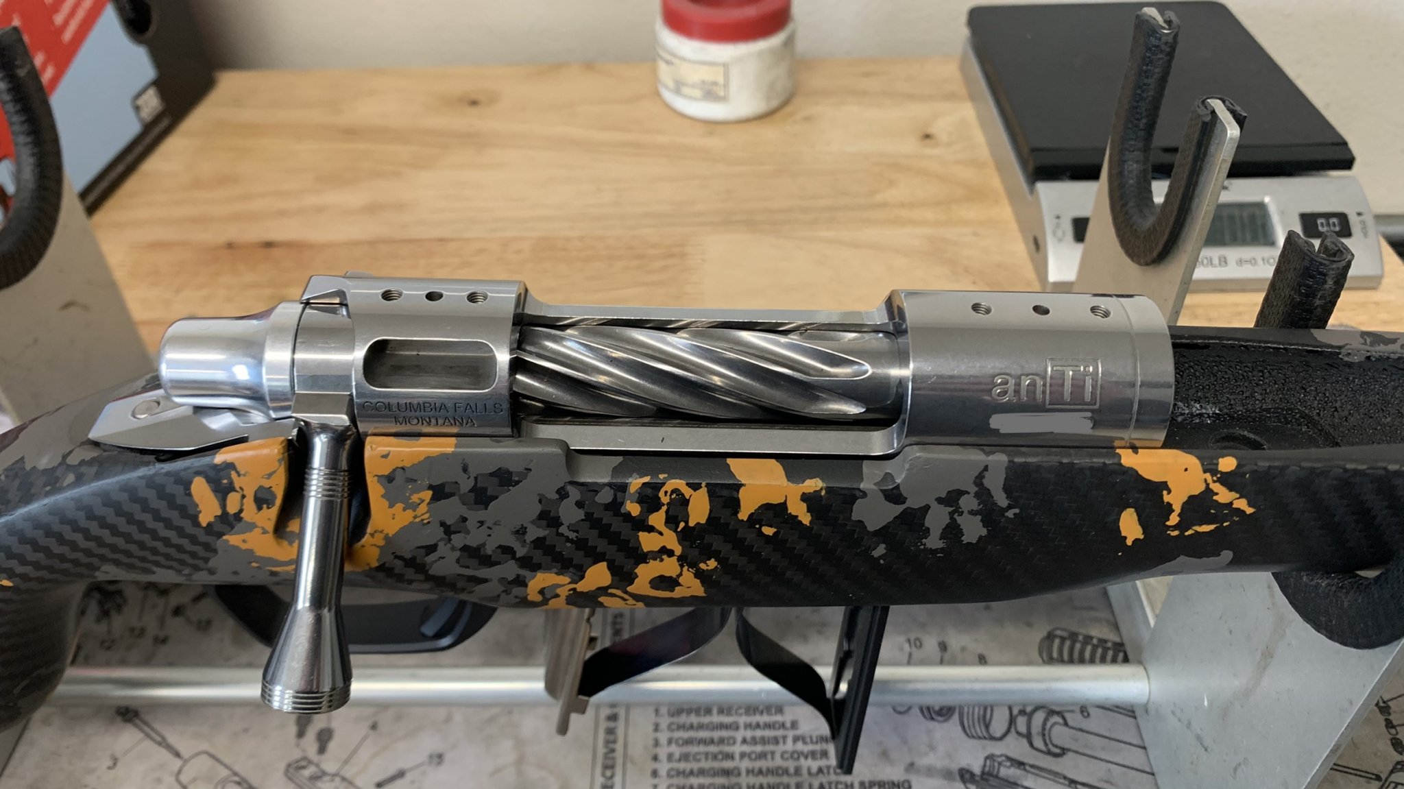

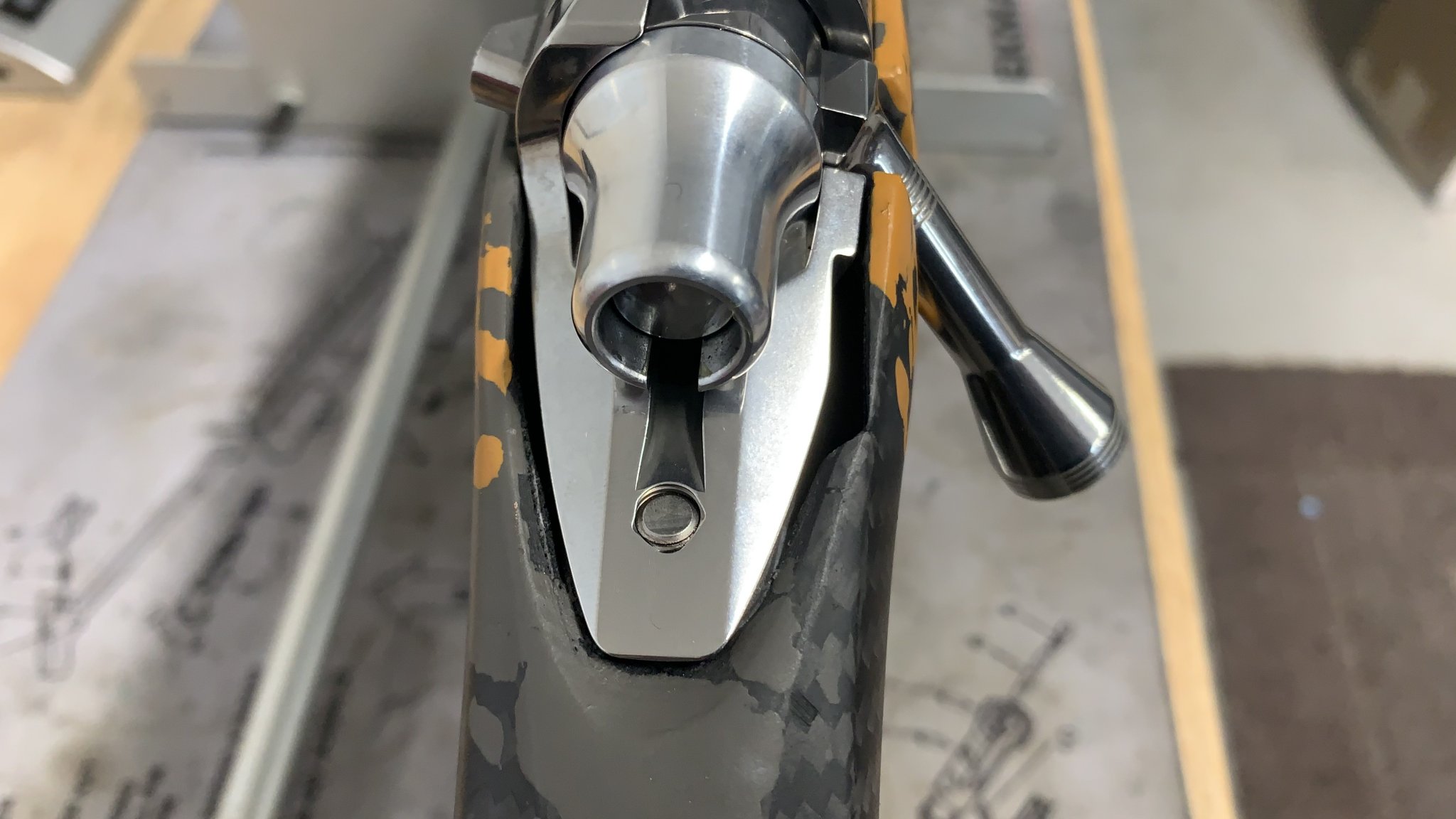

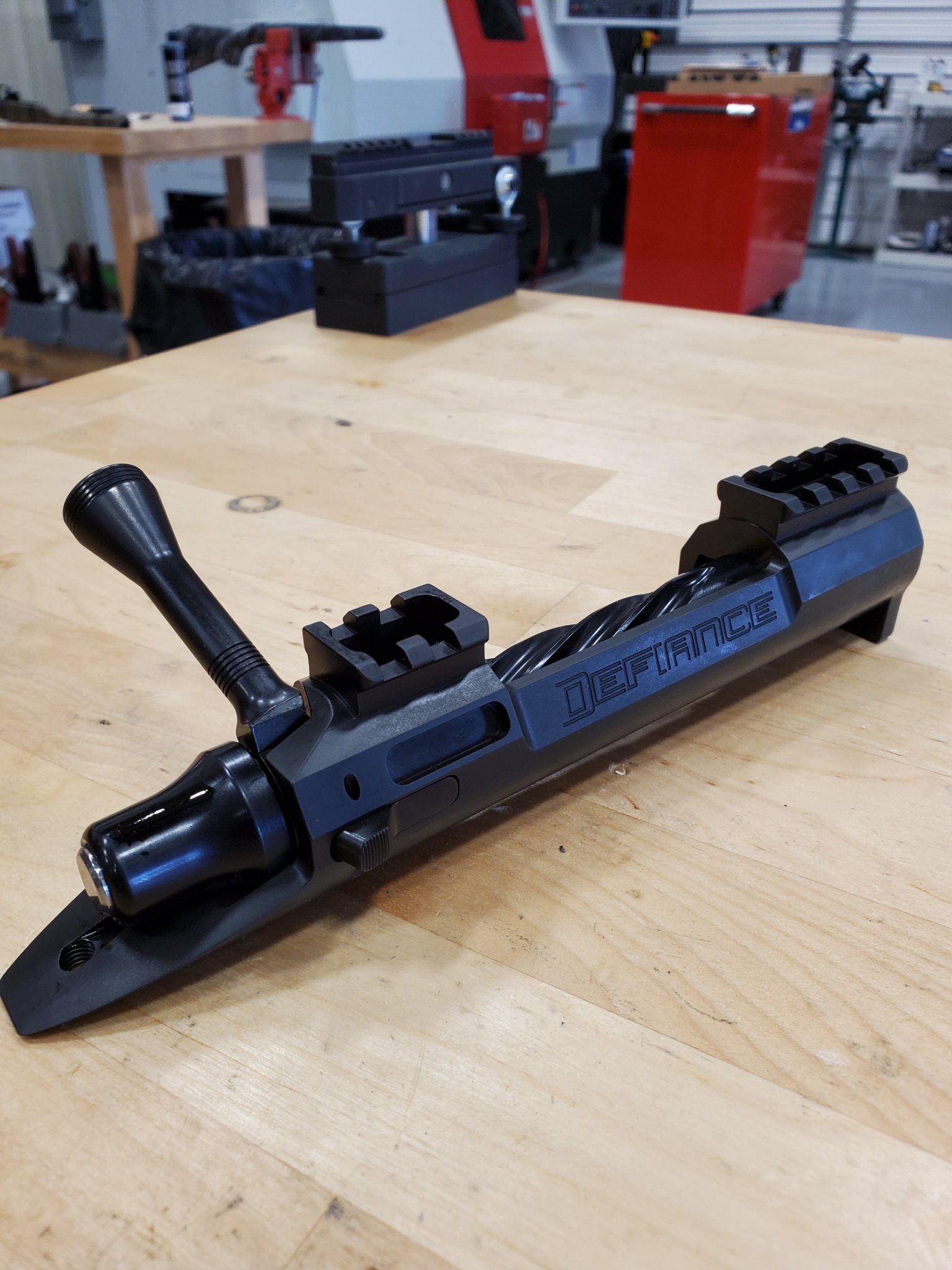

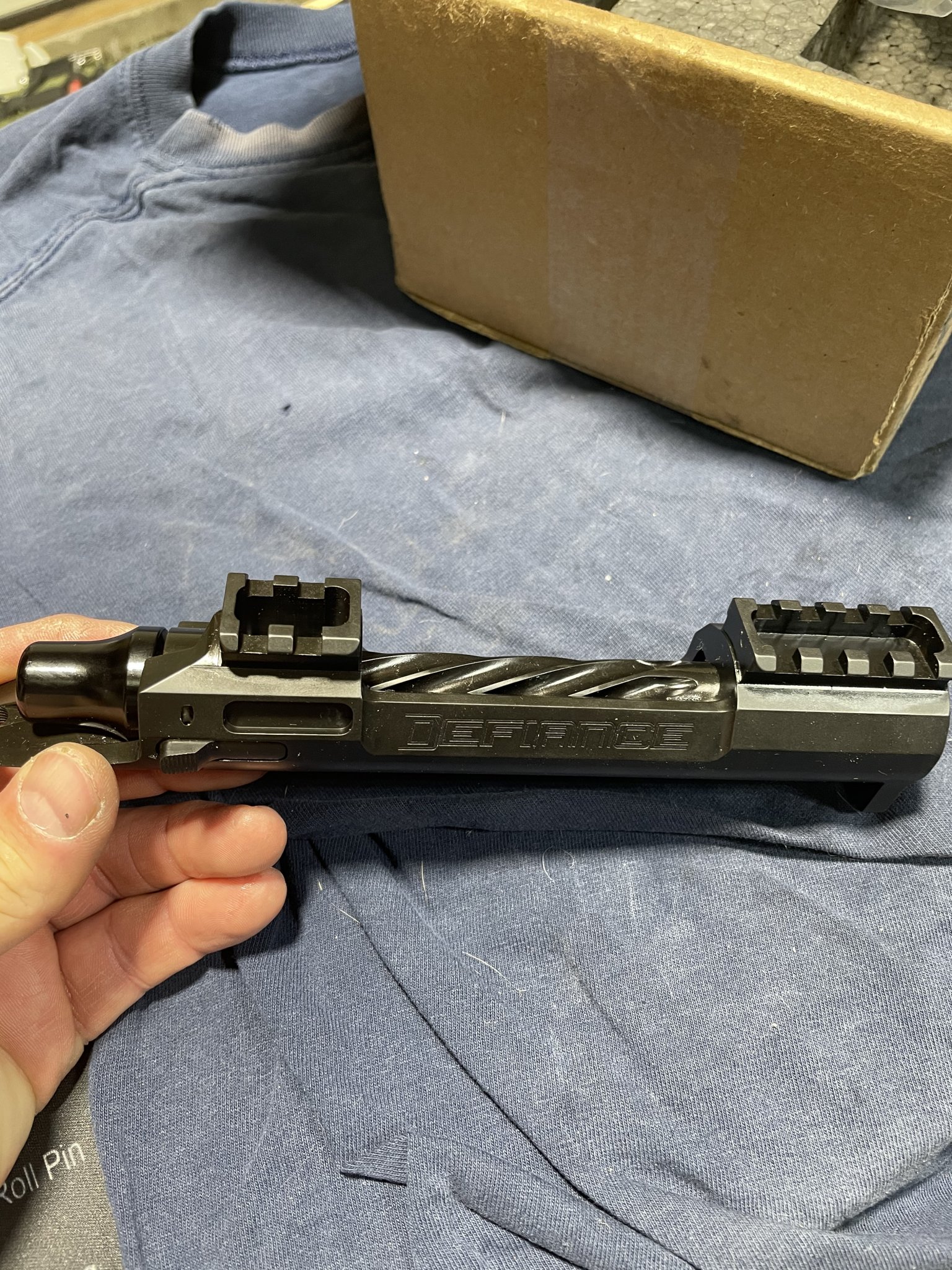

Not exactly what you asked but I had the components out so I took some pics.
This ClymR is inletted for a short remington. It doesn't match either defiance, but using the stock lines for reference you can see similarities between the tenacity and Anti. The bolt handles are the main differences.

What's the ejection port measurement on the stock? I'm hoping my Remington SA inlet doesn't fit like that with my Anti-X.
Is there a difference between a Remington SA inlet and a Remington SA Clone inlet?
Depends on how close of a clone. As you can see demonstrated above there certainly can be.
Swept vs straight bolt handle, port length and location, side bolt release, presentation height, tang etc.
The bottom metal hole, trigger location, action screw holes and recoil lug should line up, aka, the stuff the action actually sits on top of.
Reactions: S3th
Most are clones. The ports are different from one clone to the next but they are still 700 clones. The clones are typically larger than a 700.
I don't know anything about an AnTi port length.
On the Rebel there used to be an option for port length. You could get it with a Remington or a Defiance length port. There was about .400" difference in them.
