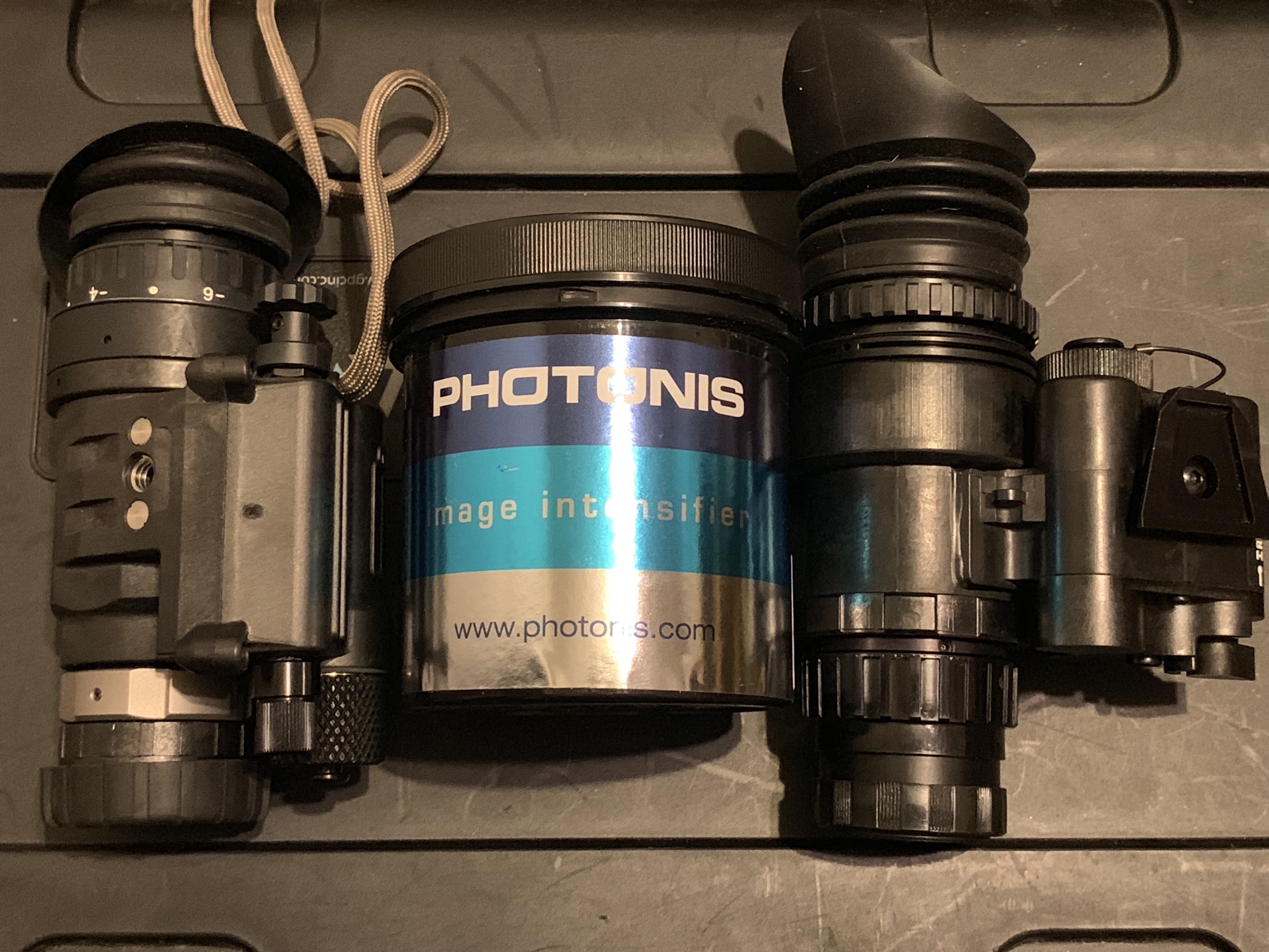

I just received a new full spec Intens 4G this week. It has alittle higher gain than the echo tubes I own and I can see alittle brightness difference in real dark areas. That said not a huge difference echo to Intens . I mainly ordered the full spec Intens because I wanted a really clean spot/spec screen.
Trust me it’s very clean like looking through glass clear :) I’ve been very happy with Photonis screen cosmetics so far. I would rather have a few zone 3 tiny specs (my echo tubes have a couple tiny specs) if anything and still have that ultra clear glass window like image
It seems like so many of the Harris and L3 tubes I’ve bought last few years have that annoying screen shading from ultra tiny specs/particles even the filmless mil-spec 18/20UW’s. Yes it’s normally not visible outdoors, however it seems to dull the image sharpness some to me. I haven’t seen this as much in Photonis tubes personally.
Straight up truth the L3 filmless tubes produce alittle brigher image darker than starlight level rural area nights. Filmless WP’s are fantastic performers overall even in a high light environment it’s just hard to beat L3 filmless overall. If it’s mega dark outside like no moon,no stars plus heavy cloud cover I normally grab a L3 filmless system and head out. Starlight/starlight partly cloudy I’ll grab the 4G OR FLIMLESS both do a great job in these conditions.
Personally I bought the Photonis tubes I have for better than average screen cosmetics and pricing/value. They are great performing tubes match up very well to a lot of thin filmed gen 3 tubes on very,very dark nights with alittle better high ligh performance.
If you have the extra cash and will own “one” NV system I would just buy the L3 filmless duals unless you have a special need for high light environments, are real picky about screen cosmetics at value pricing or you already have filmless tubes and would like something different technology wise. I have several NV systems so can afford to specialize my gear for the task at hand.
If money was no object and I had only one NV system I would pick a 22UA L3 WP filmless tubed system. Great performance and image clarity but value pricing goes out the window LOL
