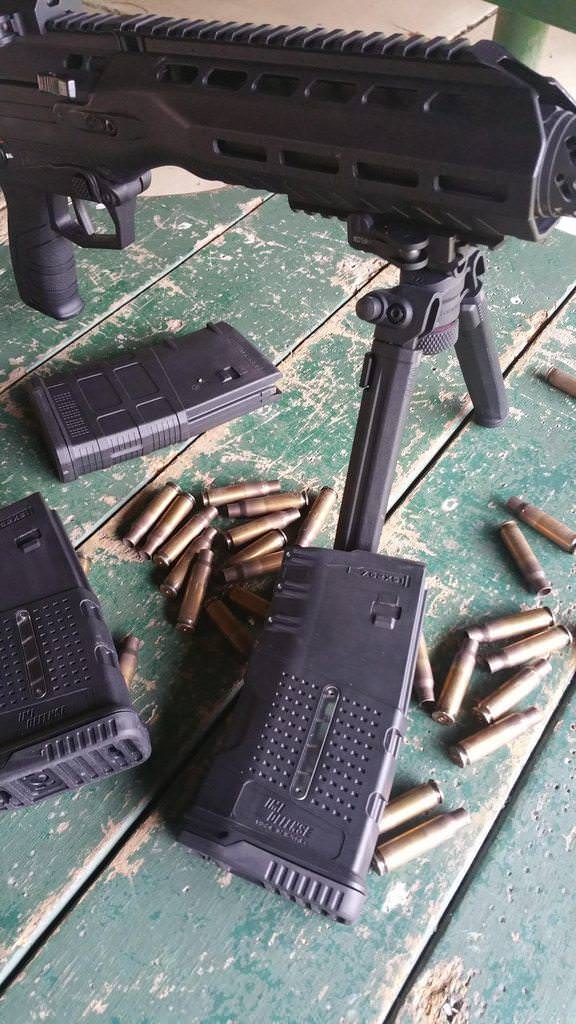

Reviving this older thread to let everyone know my FDE Mantis handguard with integrated bipod was just delivered. While I was hesitant to order it at first based on price, seeing it in person changed my mind. It is a very nice piece of gear. I had a Harris bipod mounted on mine and this is so much nicer. Feels great to hold the rifle, and of course the bipod is always available when you need it. Very happy so far - now I have to get it out to the range and see how it works.
Is there MLOK on the bottom? Do you think if you put a short ARCA rail on the bottom that it would interfere with the bipod at all? Does it feel more rigid than the plastic handguard it normally comes with? I've been thinking about getting this handguard
It has the same 3 slots that the original hand guard has. It does feel more rigid, since it is metal vs. plastic
On the ARCA rail - Mantis is nice and flat with about 1.2" of room to mount something. The RRS Arca rail I have is for picatinny and seems to be 1.4" wide and not very tall, so can't give you a definitive yes. The legs swing out so it depends on the Arca Rail attachment you have. I could see one working but it would have to be a little tapered at the mounting point, to allow the leg of the mantis to swing out.
