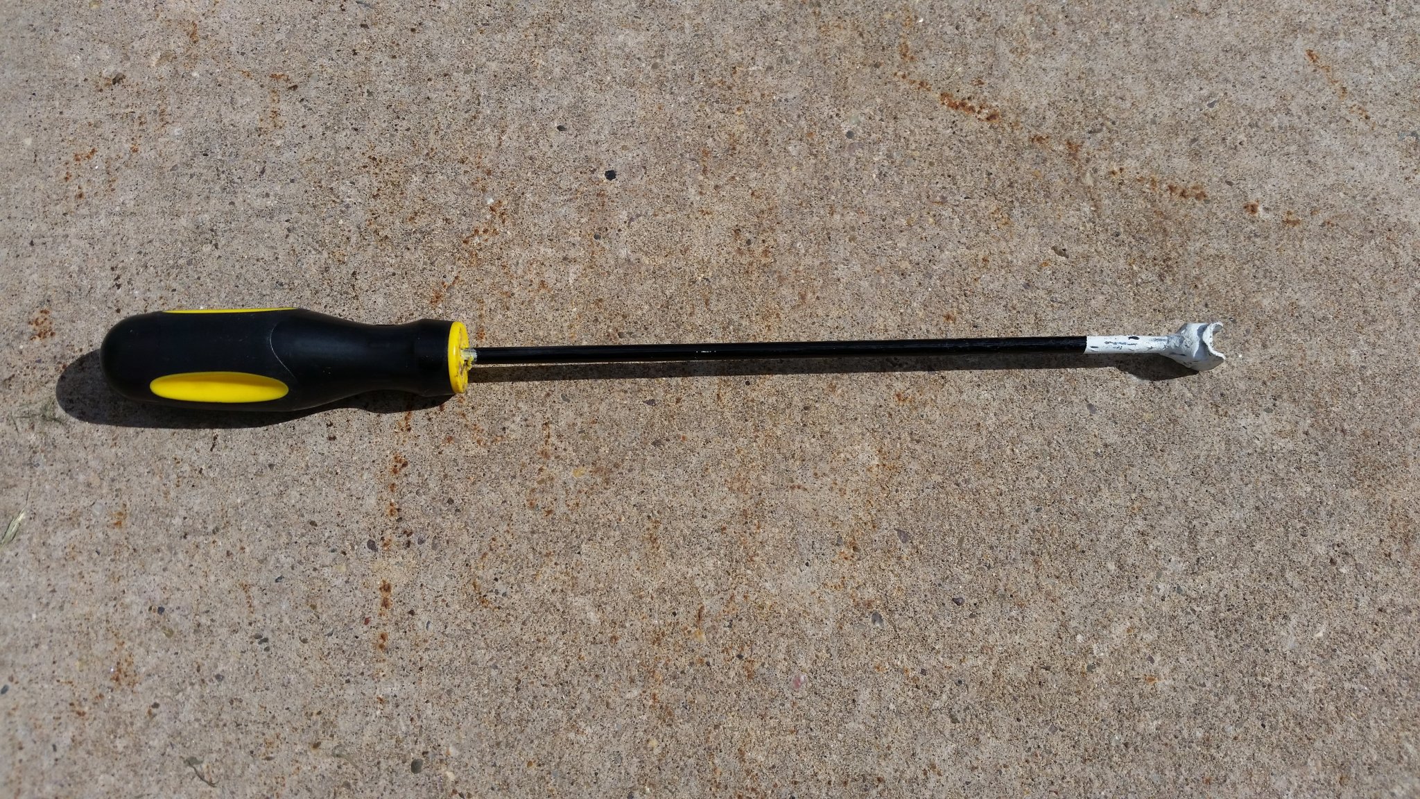

To get around removing the hand guard I just built a little wrench like for a sprinkler valve. Works great I can adjust port with hand guard on.
