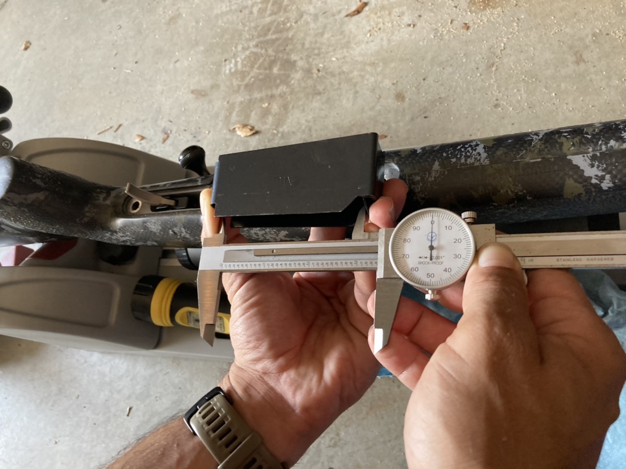

I was honestly surprised that it wouldn’t accommodate my .30-06 hand loads. We’re talking a max COL somewhere around 3.45 to reach the lands, but the mag won’t accept anywhere near that and still feed. I figure something like 3.41 to 3.42 is where I want to be, but I’m not gonna single load a (primarily) hunting gun. I don’t know if that’s a “tweak it so it feeds” or a “get a new box” issue. Guess I need to get out my calipers and measure the box as a start.

Got home today. Should have done this earlier. Inexplicably, Winchester equipped a supposedly long action with a 3.4 inch internal box mag. Absolutely daft. Worse still, without being machined out, the action won’t tolerate a longer box.
This would be a good platform for the .284 or the Shermans… it’s essentially a medium action. Wonder how hard it is to open the bolt face to magnum diameter…
The WSM case would be a perfect fit, actually. You could load to around 3.2 or 3.3 COL and keep the bullets out of the powder and the ogive out of the neck with no problem while still having plenty of space for smooth feeding. The x55 family would also be a great choice for this action length.
There's probably a way to get more room in there, just not sure what it is yet. Honestly, if I thought the barrel knox had the meat required, I'd be tempted to have a bit off the back and recut the chamber for .308 Win and be done with it. Might be cool to run that completely unconstrained by mag length.

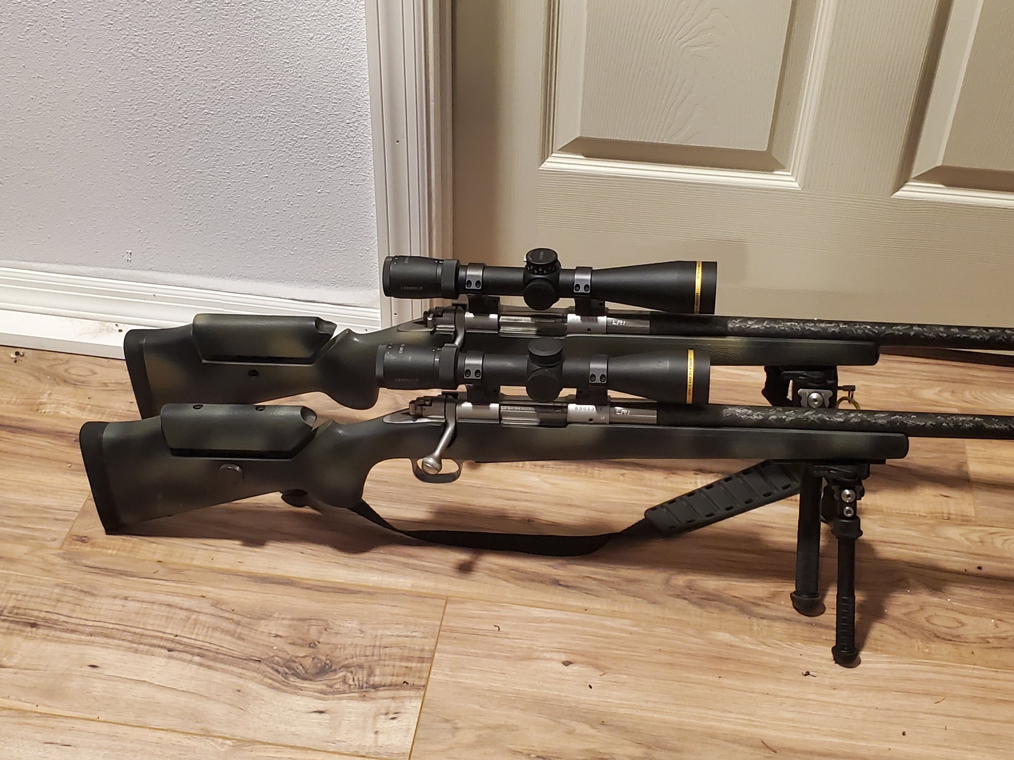

I'm not sure what your plans are but LRI built 2 Win M70's for me. I would highly recommend then. I will also use then if I decide to build another.
Mine are a matching pair of hunting rifles in 300wsm and 6.5CM. Proof carbon barrels and McMillan Edge stocks.
