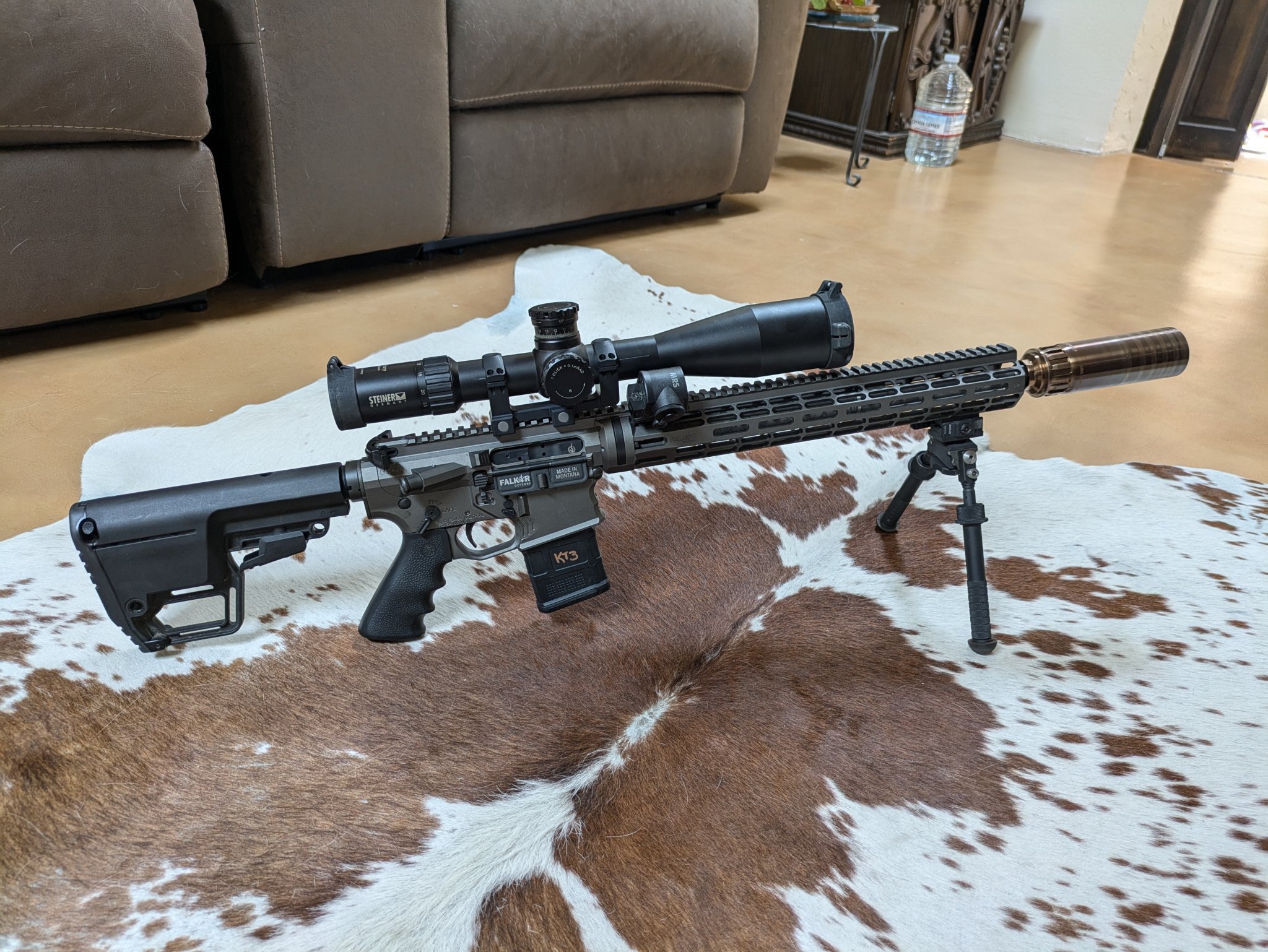

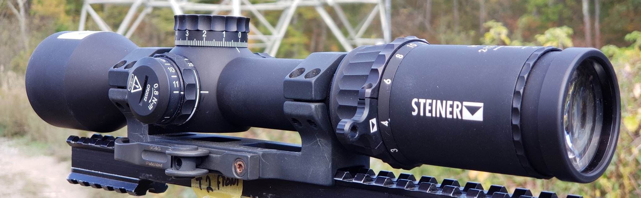

This Steiner looks like it could be the perfect scope for my SPR build. Functional, light, perfect zoom range, functional reticle.
Right now the rifle has a Steiner M5 that I stole from my wife's 6BRA, its a pig on this rifle :ROFLMAO: I'm thinking the 2-12 H6 could be a perfect fit.
I know Steiner flies under the radar here on SH, and their reputation took a bit of a hit with the teething issues of the T series, but I've always been pretty impressed with Steiner. This M5 is an underrated scope. I expect good things from the H6, looking forward to seeing more reviews.

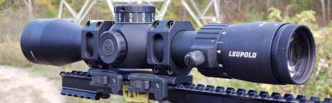

I finally got the chance to take the H6Xi and MkéHD out to extended range today.thensolar panels are around 500, 750, 1k yards. The power towers in the distance are right around 2k yards. Mid 60*f, intermittent clouds and windy. I got everything as good as could be.

The first pic of each is at 2x and 2.5x right?
Leupy looks decent. Steiner looks lame at 2x.
Not trying to be a dick, honest question: what is the appeal of a scope in this mag range with a reticle too thin to take a shot at 2x?
You could just get a 3-12 or 4-12 scope and have something much lighter or cheaper, and equally functional.
If its for a big FOV so you can find the target at 2x, and then dial up to take the shot.... With a higher mag scope you can just acquire the target with both eyes open.
If the differing images in your eyes bothers you, then close your off eye to make final corrections before pulling the trigger. This is dramatically faster than taking a hand off to work the mag ring.
The illumination is not turned on, see post # 322
Serious question to which I do not know the answer, does the Leupold he is using have an illuminated reticle?
I think the extended posts in the Steiner at 2x is a good call. I would imagine it helps bracket quick shots. There looks to be a lot more CA and shallow depth of field on the Steiner. Would you say that’s accurate?
Edit: also every image of the Steiner also looks soft and more out of focus in the bottom 3rd of the sight picture. That is rather surprising.
