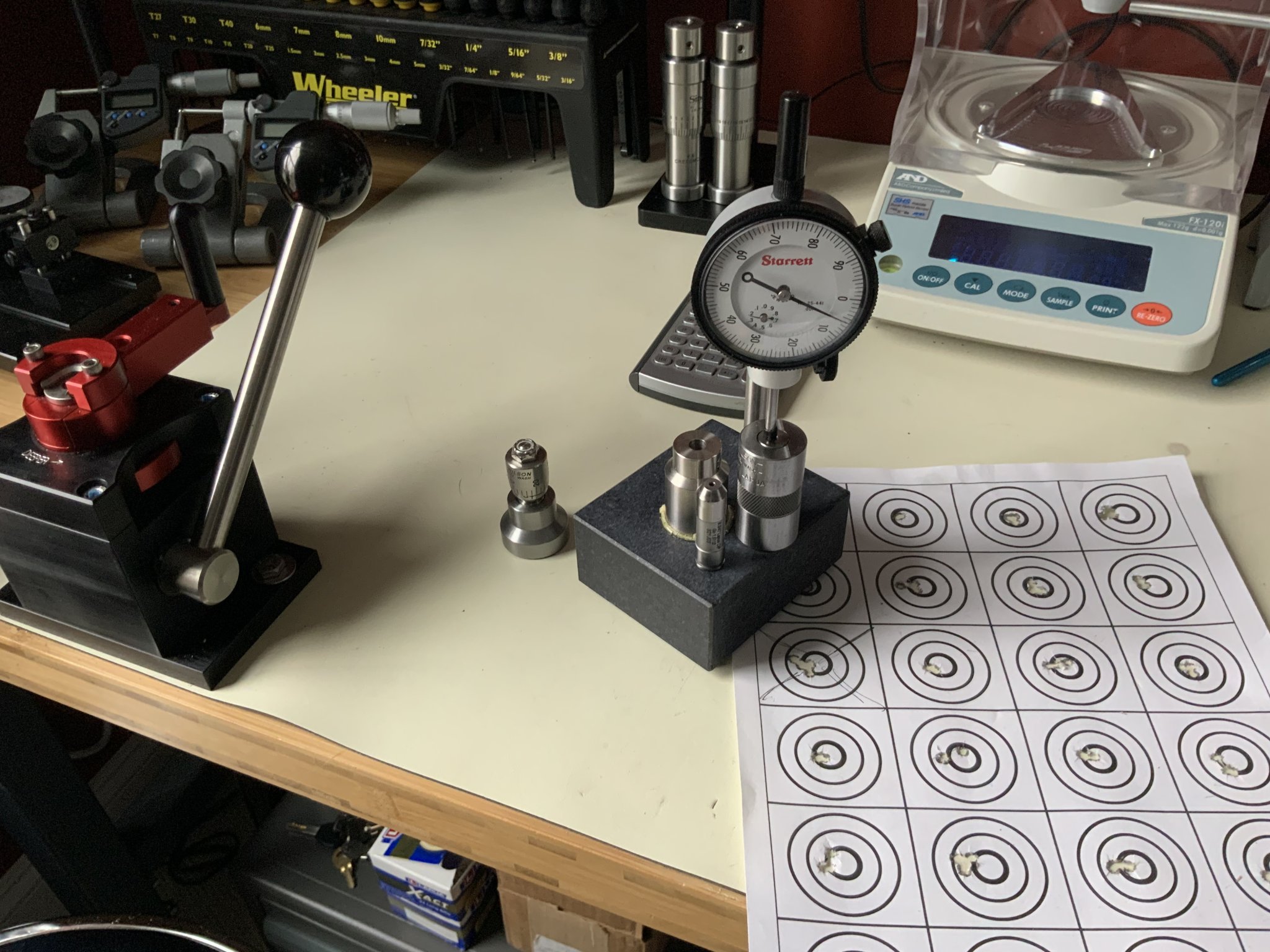

Whats the mechanism for the shoulder? Hard to see from the pic. It looks like my old bullet sorting stand and my Redding Instant Indicator had a baby. I think if I could get my SAC neck shoulder bushing to properly square up in the Instant Indicator, instead of the provided sleeve, it would probably measure to the .0005 properly.
Reactions: ICU22250
The case is flipped upside down... the shoulder is held on the bottom.
That totally works!!! I get .006 between the go and no go gauge. I think Im going to take this stand and drill a hole to perfectly hold the gauge in place. Ordering a flat contact point to make it a little more sturdy too.
Although cant wait to see you turn the PrimeWhere into a headspace comparator soon enough.
