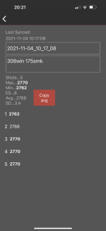

To make a precision round on the 1050 vs single stage, what really matters?
1. Sizing - Can't see that a single stage would do better, but I could be very wrong
2. Swaging - Would be off press for a single stage, so can't see a difference here.
3. Primer insertion - Can't see that a single stage would do better, but maybe controlling the insertion depth may be better.
4. Powder Drop - Here I can see where monitoring powder by the grain will give you a better SD and extreme spread.
5. Powder Check - No effect
6. Seating - With a micrometer seating die, I can't see a single stage would do all that much better.
7. Crimp - Not needed with rifle dies.

I didn’t read the whole thing. But I reload precision 308win on a Dillon 650. Get yourself a free floating whidden toolhead, it really makes a difference. I throw varget with the Dillon powder dispenser and don’t have a problem. I use Redding dies and really like them. You will want a case feeder.
For 556, I can do 300-400 in an hour, depending on if everything is running right.
