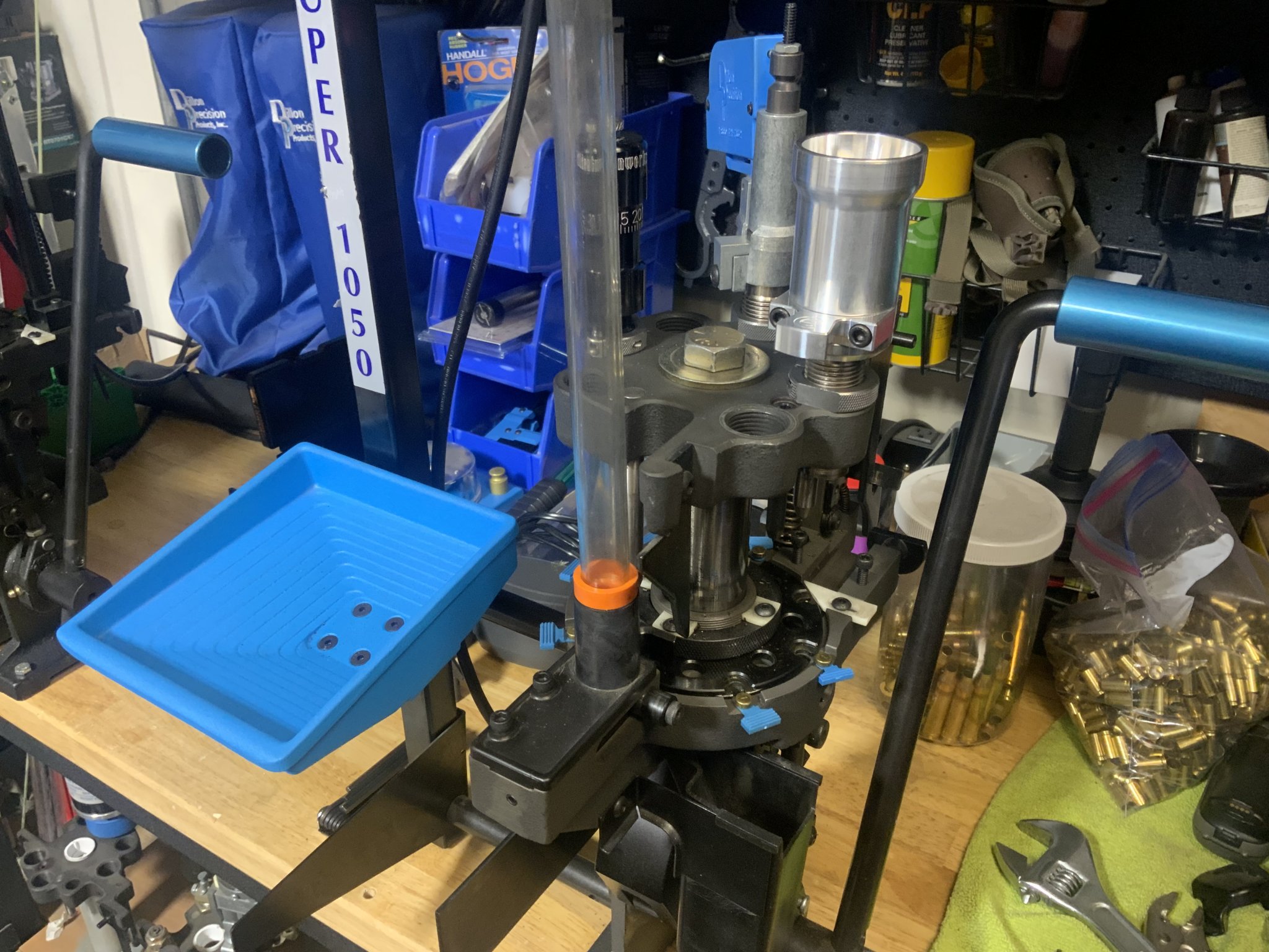

While I was away, my FW Arms Prime Time was delivered. Man this thing is really nice and very well made. So much better than that rickety factory cam plate and assembly arm setup.
Also gives the necessary clearance to use a hold down die in the Threaded station above the primer station on a CNC toolhead. I'm use the Mighty Armory hold down die.
I just pulled my Dillon toolhead and swapped everything over to the CNC toolhead and installed the prime time. Super smooth and super easy to clear a jamb or empty primer tube. Highly recommend.
I'll get a video up shortly
Finally got the CNC toolhead installed, all the dies re-installed and tuned. MA hold down die over priming station. Also installing my Immortobot new sensor brackets that also came while I was away so I can get my case and bullet sensors installed.
I got the extra tall DramWorx hopper for my powder throw and the Immortobot sensor for that as well. Gotta get that installed next.
She's running sssooo smooth right now.

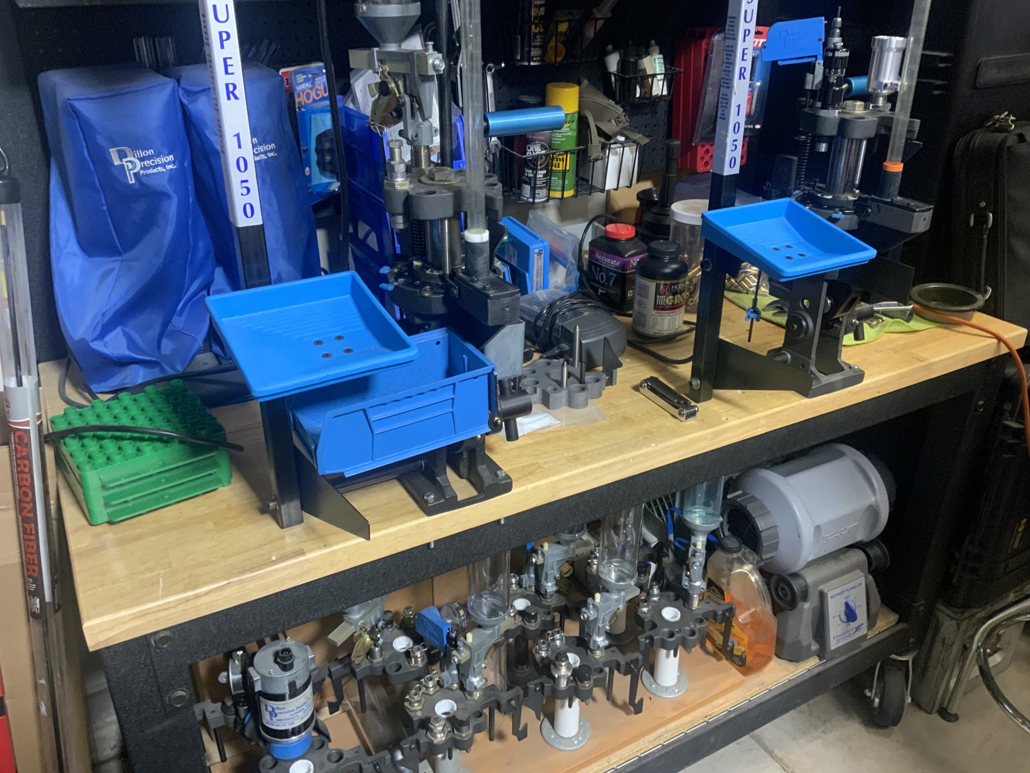

Pretty darn good deal here for a fully setup and ready to go in 9mm Super 1050 with the new Variable Speed Casefeeder for $1950.00... Thing looks barely used and virtually no wear.
I'm running a CP2000 and a 750, both under Autodrives.
I also run a rollsizer for the 9mm stuff. Makes the "glock bulge" a thing of the past.
Roll size first, then process brass (by the bucket load), then load on the 750.
I've also been helping a guy set up his brass processing business machines. He went with the full blown Industrial rollsizer route. That thing will suck a case feeder dry if run too fast.

Only reason was because a killer deal fell into my lap for 2x1050's, both with case feeders and MBF, multiple conversions in 5.56, 9mm, 10mm and 45acp and Ammobot/Immortobot and lots of sensors, dies, toolheads, etc. $3500 for everything.
I full planned to buy a 1100/Mark7 and then this fell in my lap. Couldn't be happier.

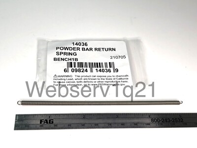

Just make sure, if your using a rubber band or old style spring, that you completely remove the return rod and zip tie the 2 return arms together on the powder thrower.
You cannot use both the return rod/safety system and a rubber band or spring.
Reactions: Gustav7
Why is that?
Because it won't work with both and will damage the powder thrower.. by design, the double arm gets pulled down in motion of the handle pull.. but when you put a spring or rubber band on their WITH the return rod on their, the spring makes the powder bar closes all the way before the return rod pulls both return arms down...causing one of the Bars to jam into the powder thrower cast housing and pop/rip it down.. Will damage your powder thrower for sure over time..
This is per Dillon as I had this problem and called them. Problem gone now. Most automated guys take the return rod off and zip tie the 2 brass colored return bars together with a spring.... you can only do 1 or the other..
See my video with this issue. You'll see the powder return bar close 2/3rd of the way, then snap/pop closed the last 1/3rd of the way. Thats the double brass plates jamming into the thrower cast housing because spring closed it too fast and then the rod rips it down that last 1/3rd of the way.
I prefer the new style that goes clunk clunk clunk. Its doesent sound or feel smooth, but the charge weights are more consistent than my "springed" measures. All of them have been tuned and polished to include dram-works hoppers. With a fine grained powder like Titegroup, getting then charges within a tenth or less of each other is normal. I assume the constant clunking keeps the powder settled better.
In fact, I just got two upgrade packs for my old Dillon throwers. So old the hoppers were glued in and I have to drill holes for new hoppers. Guessing they were from my oldest 1050 I bought in the mid 90s.
I also prefer the return rod and new style thrower mechanism for 9mm/Titegroup. That's what my 1050/Ammobot is setup for right now. Drops dead nuts consistent.
But I prefer the spring and no rod on my other 1050 loading 5.56.... with WC844/846 with the new style rod setup I get a little bit of powder dropping on my shellplate after the bar closes on every round. Makes a mess of the shellplate and makes cleaning required much sooner.
With the spring, zero powder falls onto the shellplate...
