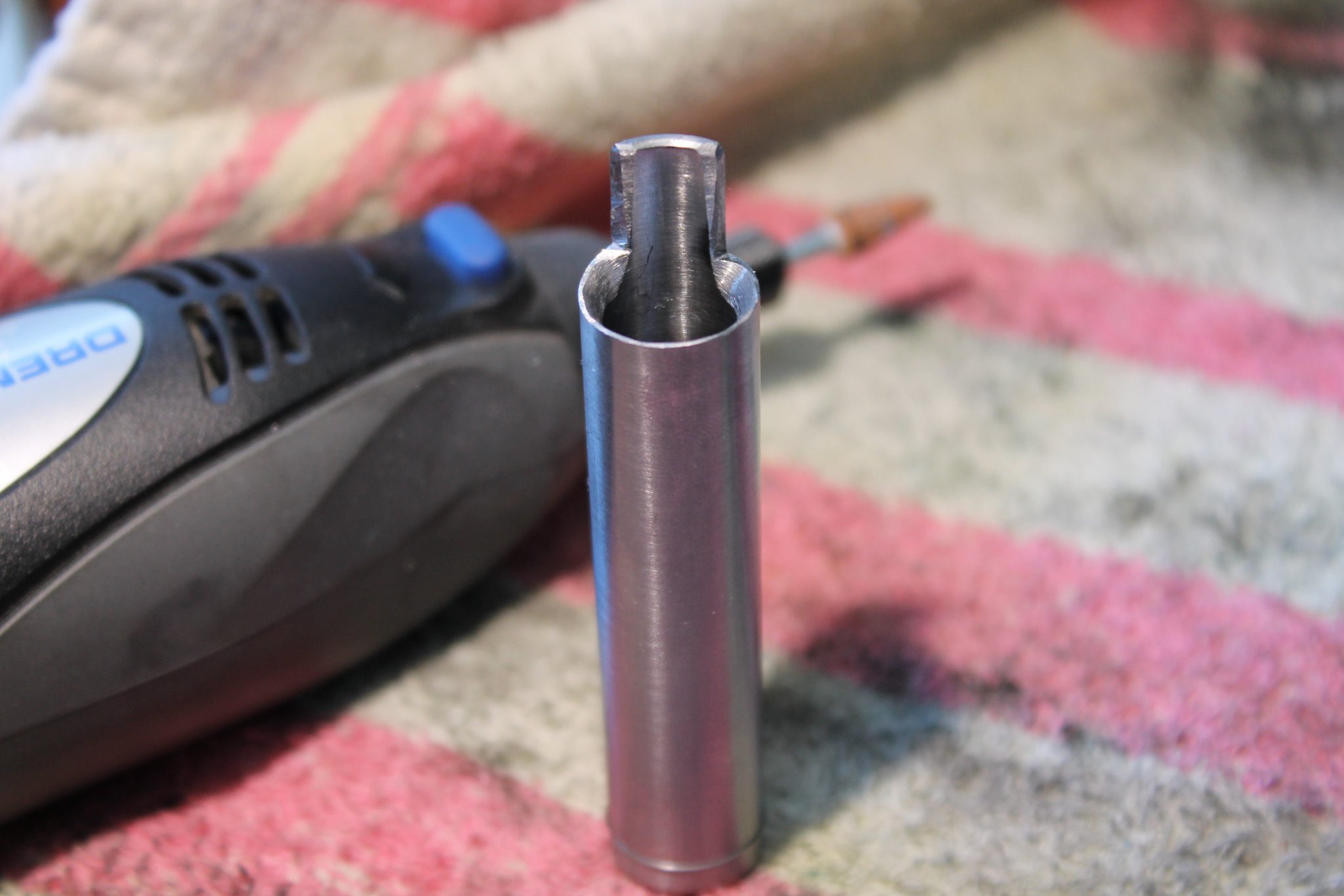

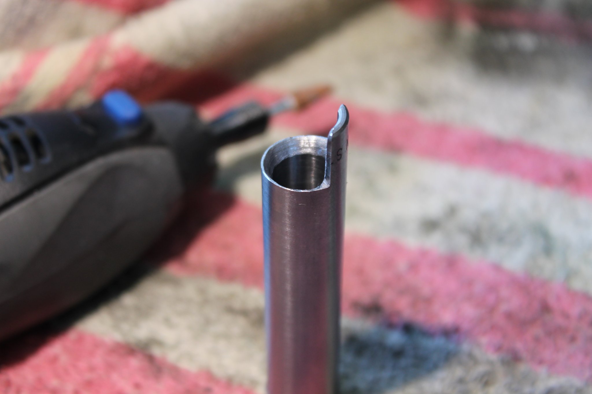

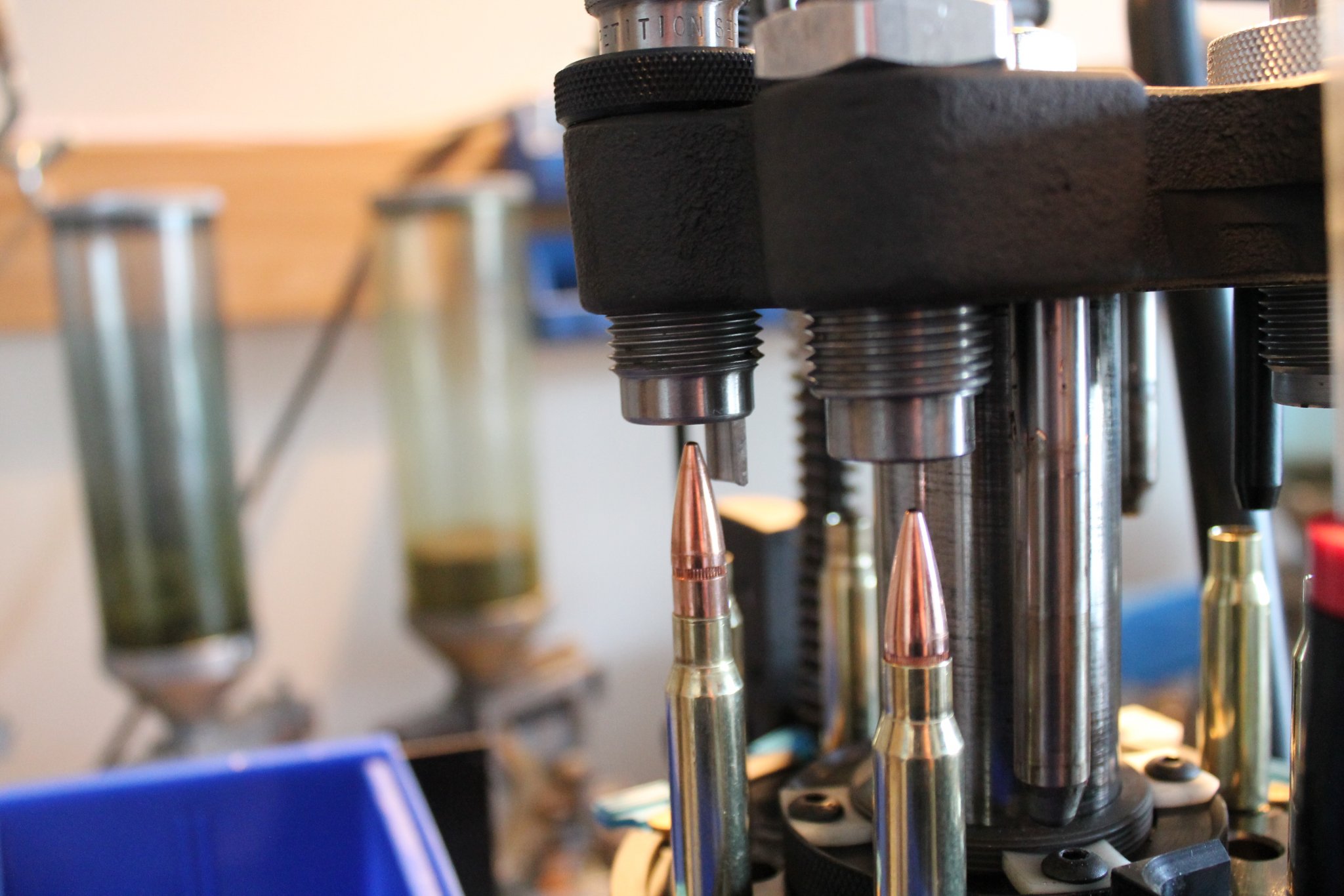

I had similar issues on my Super 1050 trying to use sliding sleeve match dies.
Not enough "workspace" for .308 or 30-06. I even tried machining down the sleeve length.
Only match die of that design I can run is .223 but I think the S1050 has more "workspace" than its later iterations.
Interested if someone found a workaround.
I butchered my Redding comp seating die sleeve to make it work on my 1050 loading 308.
