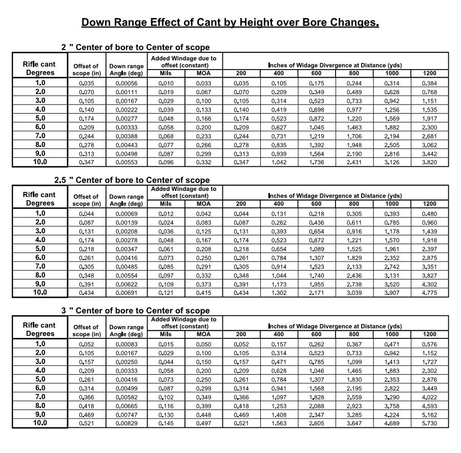

What’s the difference in between .5” (going from a 1” ring to 1.5”) over bore at 300 and 500yds. With some realistic cant variations?
I'll throw some calculus at this later to "Run the Math" rather than "Run the rifle"... outside is scary

Am I reading correctly, 10 degrees of cant at 400yds would move the POI 1.042 and 1.302”?
Call it a 1/4” difference at 400yds with .5” extra height at a 10 deg cant?
Yep. 1/4" difference due to the ring height change.
You'll still need to add the cant due to dialing up and rolling your scope over to get the total cant effect. If you dial up 2 mils and role over 10 degrees is .34 mills of windage added--> 4.448" windage, + 1.302 for a total of 5.791" total.

So, you’d have to be severely canted at 10 degrees.
And, the difference from a 2” bore and 2.5” bore to center isn’t substantial enough to be of any issue.
Meaning, if the cant was enough to miss with a 1.5” set off rings, it was already enough to miss with a 1” set of rings.

LoL, you know what I read from that chart???
@lowlight told everyone, you don't need a damn bubble level!
Im taking my bubble level off when I get home and turning it into jewlery!!

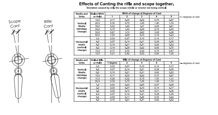

Hold on now. That chart is showing only the change from 2" to 2.5" rings. You still have to the add in the actual cant effect of dialing your scope.
Rolling over 3 degrees while shooting 600yds (2.5 mils up) will add a .1mil of windage or shooting 1000yds (8 mils up) could ad .4 mils windage.

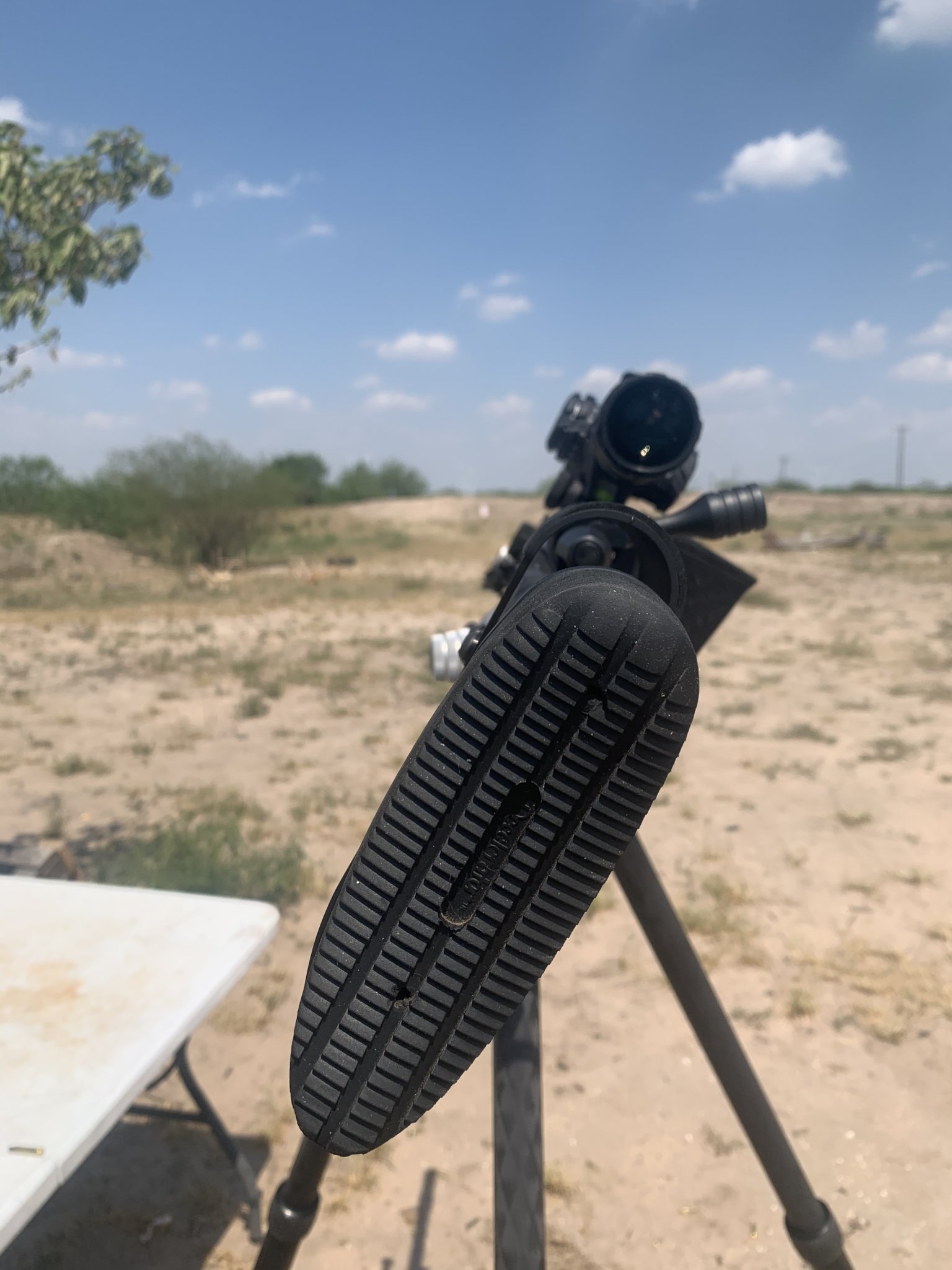

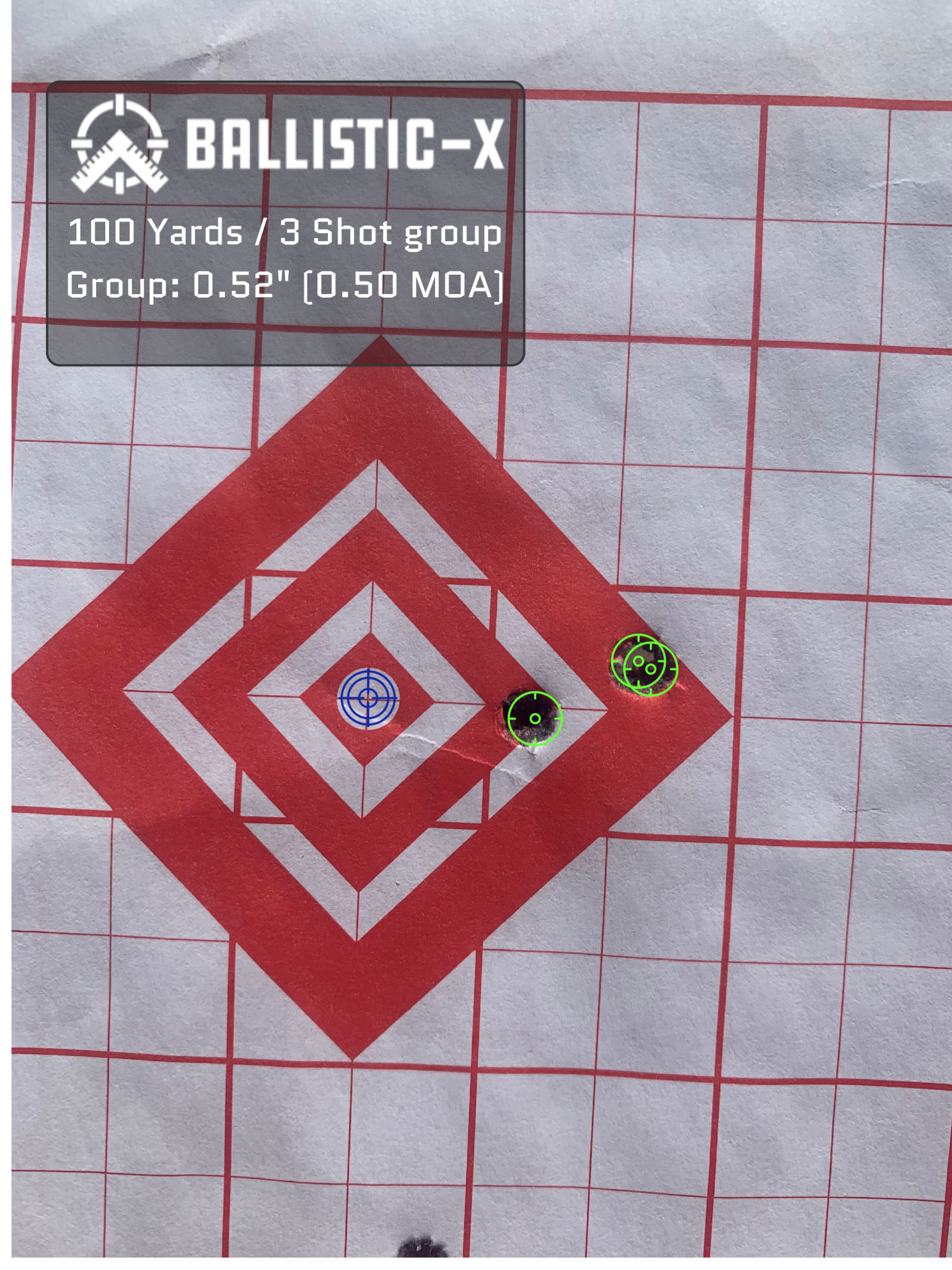

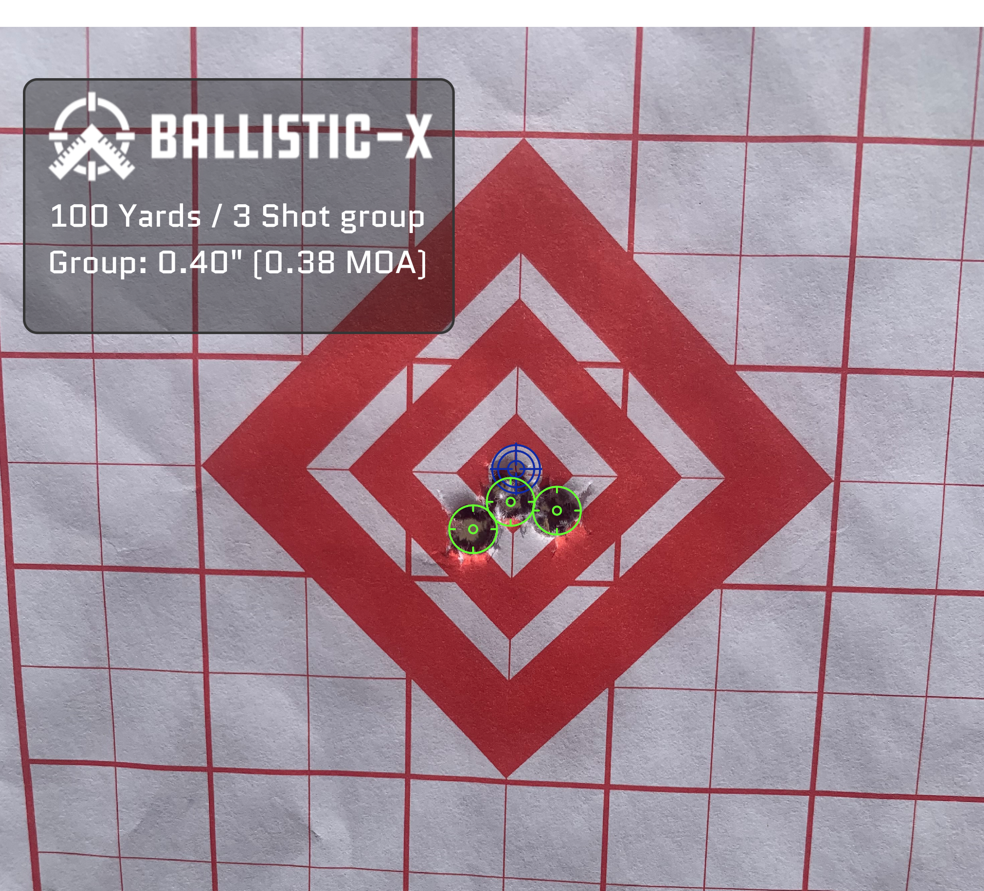

I don’t have one on my 260 anymore, it’s not needed for the ranges I’m generally shooting now with it.

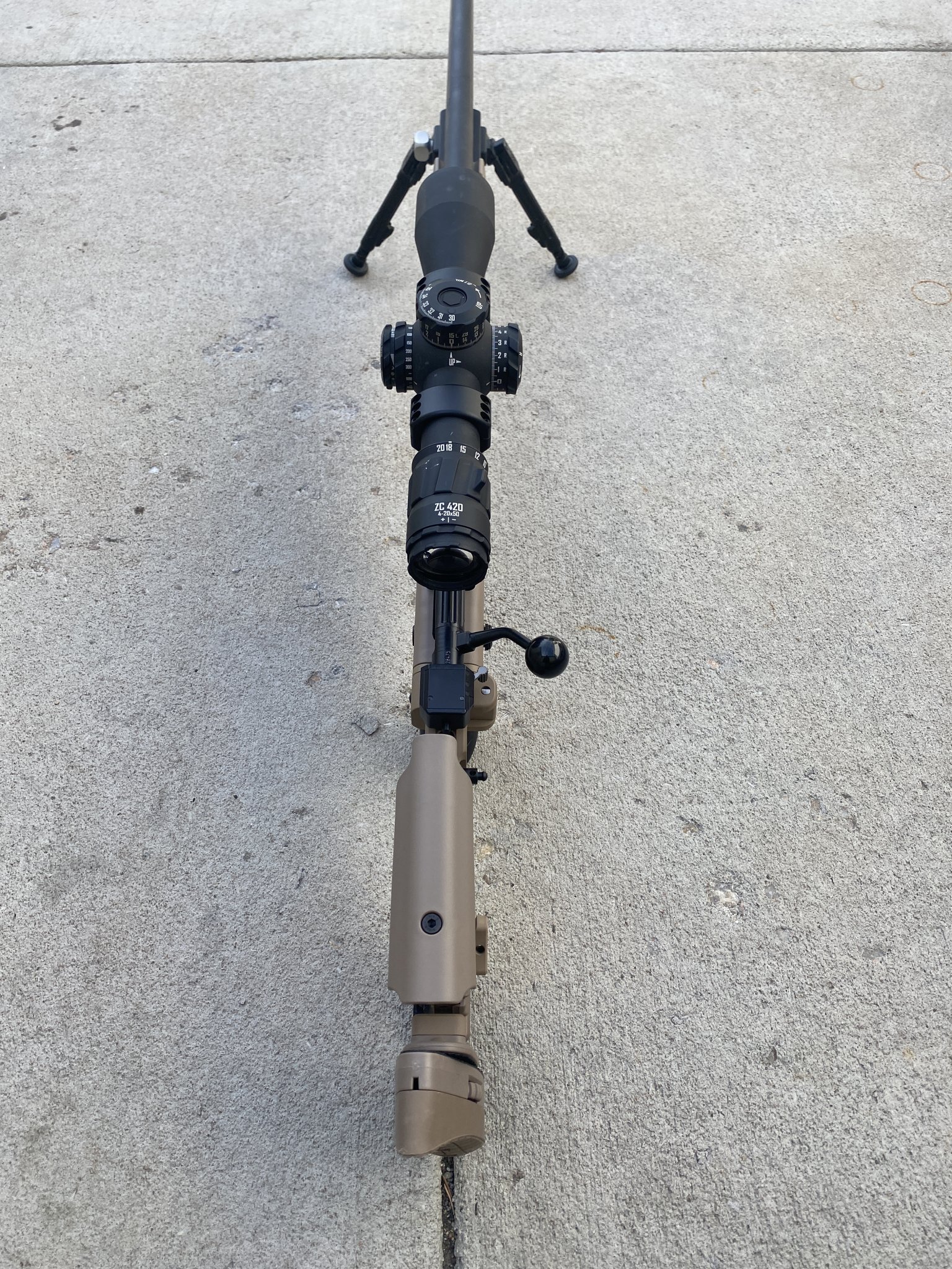

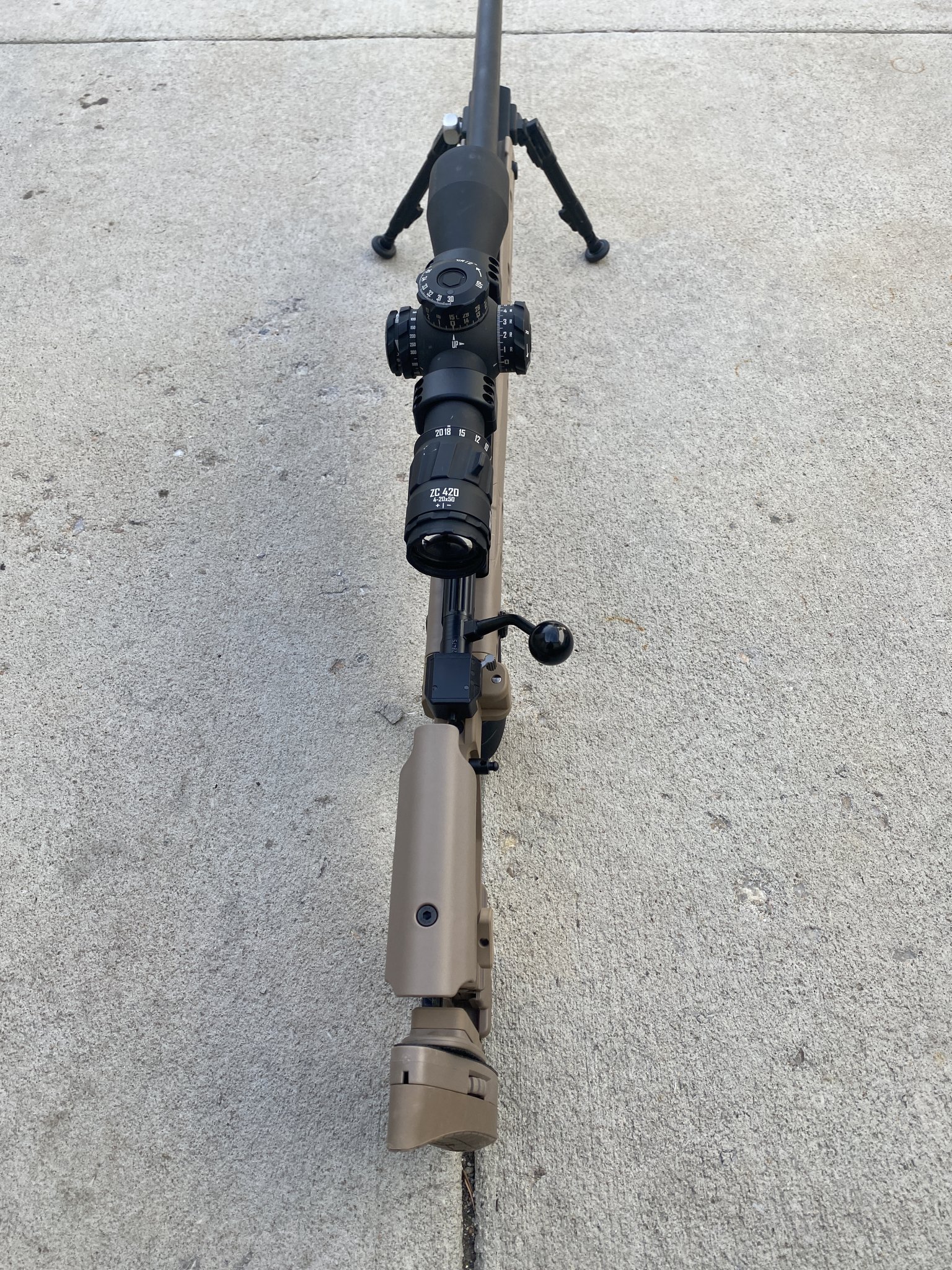

Just cause it’s 105 outside and I had nothing better to do than practice in the sun. To give an example how little cant messes with you at closer distance. This is a 1.5” mount. I need to measure, but a minimum of 2.5” over bore.
This is 100 yds standing locked into a tripod. So there’s a little wobble to account for.
1st pic, “cold bore” (hate that term, but whatever, first shots of the day). No cant
2nd pic is from behind the rifle at almost a 30-45deg cant. This is a huge amount of cant. It also played hell with my recoil management.
3rd pic is the shots from that cant. It took that much to put my POI about a minute to the right.
I used an extreme amount of cant to illustrate how
Little of an excuse this is at short range.

I'm lost here. Explain, please?
He said he considered the 1moa shift in my live fire examples a lot of shift.
What I showed is how much cant was needed to move the POI about 1 minute. It’s a metric shit ton of cant that Stevie wonder would notice and not take a shot or at least aim a little left if forced to shoot the rifle with that much cant.

Here is a great example
Is this rifle crooked or straight ?
Do we have to fix a cant?
How about his one
Now before I even address the rifle I can tighten the bipod and call it good,
I put the cant in the Butt plate to satisfy my brain. I can feel it now, if this rifle is rolled the butt plate will make me feel it.
