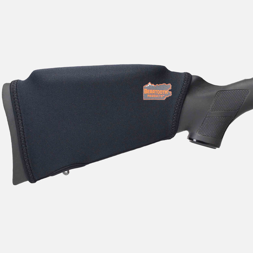

What cheek rest stock pad is that?
Looks like a Beartooth to me:
