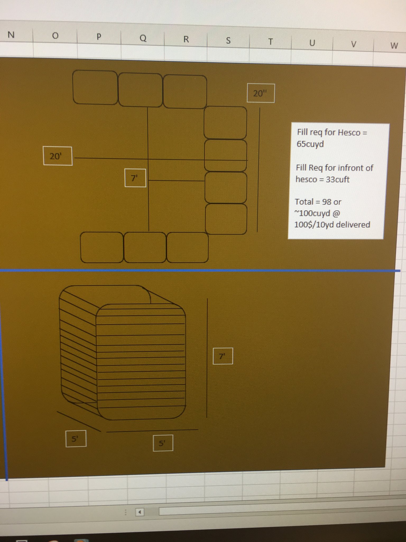

Drew up a sketch of what I’m thinking for my berm. Wanting to get 10 - 7H x5w x 5l HESCOs. Stack them four deep in the back and three on each side. Will pile up dirt ~7’ out in front of the back wall that will go side to side and planning on trying to pile it as far up as possible. This will give me ~ 20’ of horizontal target space that will have ~10’ boxed in for spalling that will be 7’ high all around. Thoughts??

HESCO will work very well. Looking many moons down the road, will your impacts nick and eventually split the metal portions you are shooting at causing the dirt contents to spill toward you??.
You could do HESCO with dirt piled up on the impact side as well with a few railroad ties along the front as a short retainer.... And ifyou want height..... Place poles in the HESCO's to stack tires which you would fill with gravel/dirt.
Overkill?? That's subjective ?

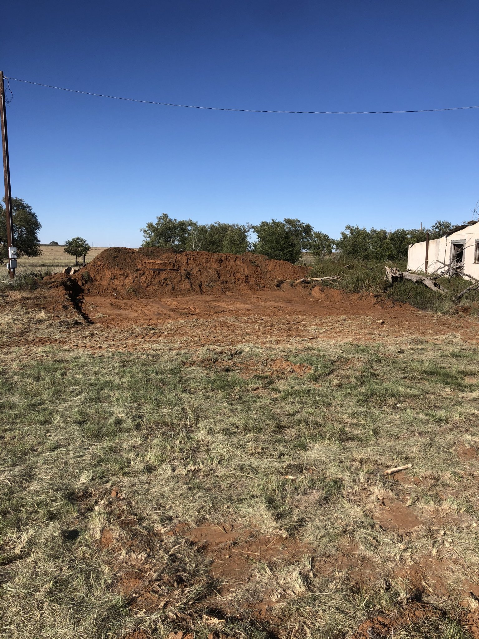

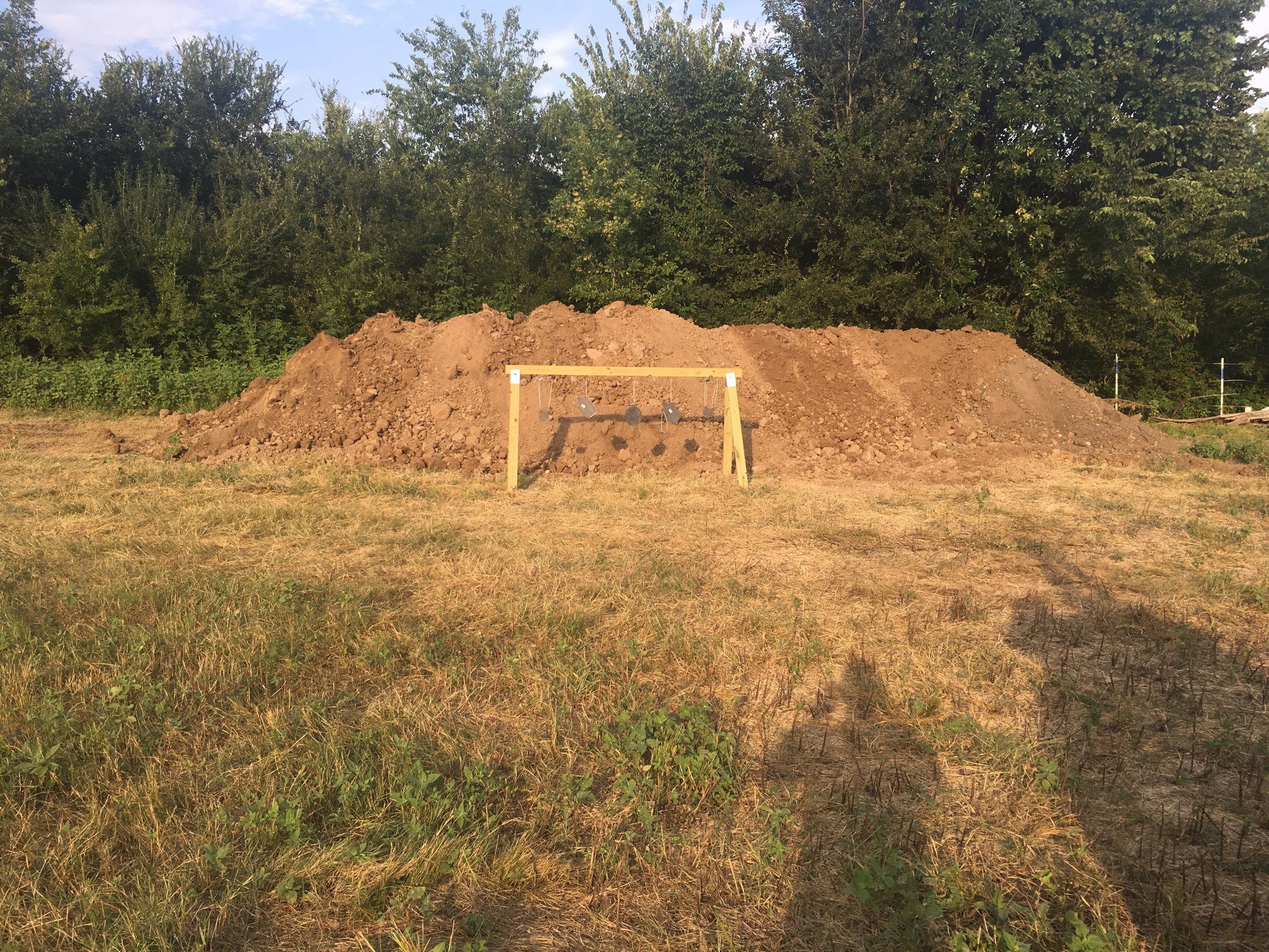

Construction is under way. 90cuyds of dirt isn’t going to go as far as I though...
7115967
Reactions: camocorvette
Did some more shaping today, I’d like to bring the right side in a bit and raise the over all height. Not sure I can manage with my tractor and FEL. So that may have to wait. Also still need to seed it. Waiting for a little rain first.
What did you find for pricing on Hesco?
Couldn’t find anything definitive on the HESCOs. I sent an inquiry to the company but they never got back to me. Best I could tell just via research, it would be around 800 per box. Which would have put them out of reasonable price range for my project anyway.
