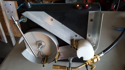

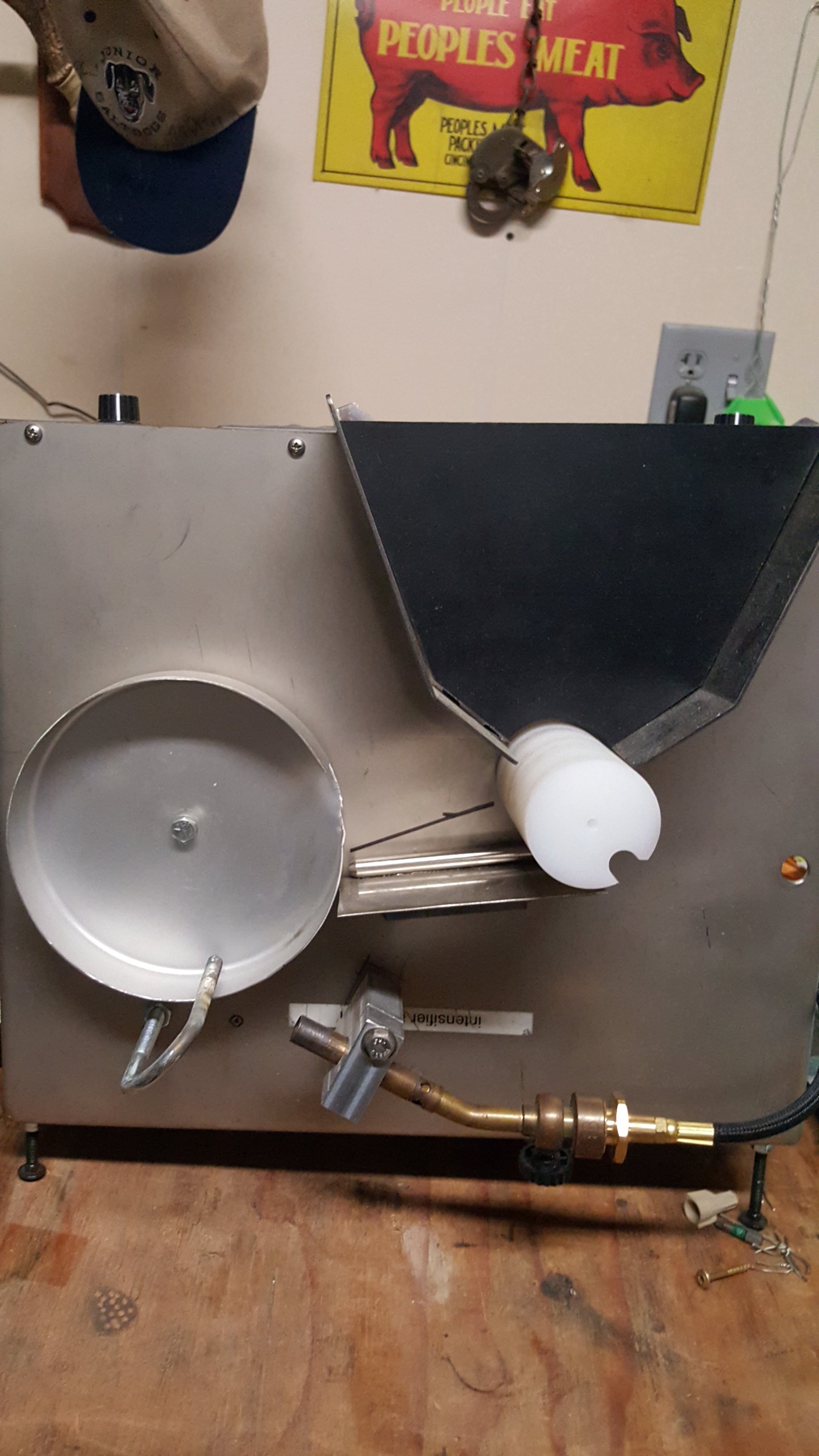

I built one of these about a year and a half ago. Best $50 I've ever spent. I went with the automatic case feeder and it needs some tinkering every now and again to get it to work, but it makes life a hell of a lot easier.

I have almost all the parts except I can't figure out what he uses as the notched cylinder piece which feeds the brass one at a time down to the "on deck" ramp. Anyone have some thoughts they can share?
I used a piece of 2.5 inch UHMW. I then took a .500" ball nosed end mill and ran it lengthwise to create a large groove just big enough for a piece of brass. It works great for cases with a .473" bolt face. I have yet to try any 6.8 SPC or .223 cases.
