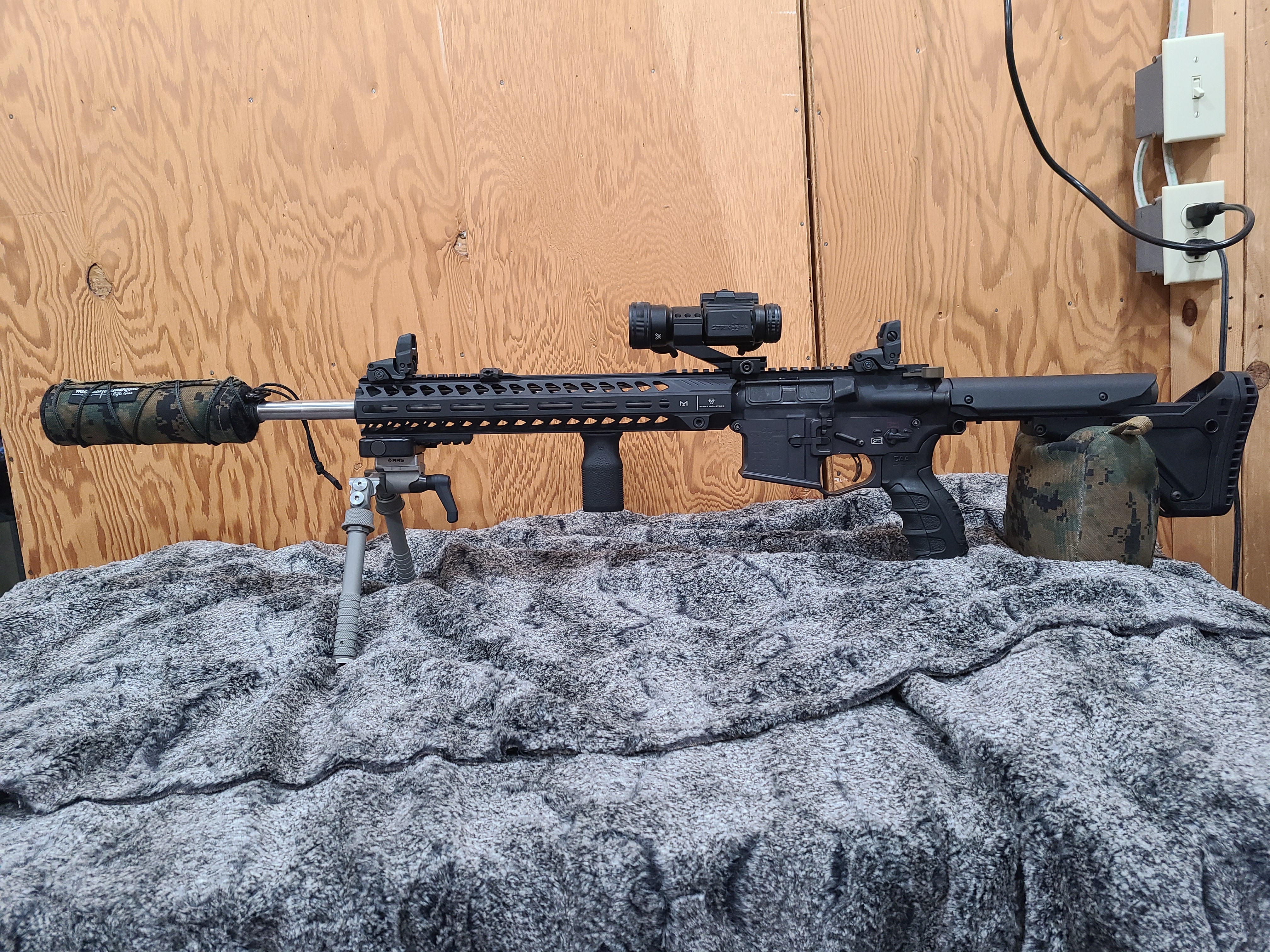

    I have my ar. Originally built 2010ish and been changing parts out to update it over time. Quad rail is now a strike mlok, comp switched for thunderbeast flash hider to ultra 7 Gen 1. Leupold mark ar 3-9 switched to vortex strike fire to nothing currently but going 2.5-15 direction.
    Latest Pic. Vert grip gone, pic rail gone replaced by mdt arca rail this week, strike fire off on something else.
    Currently has a 3lb timney competition single stage. Bought it without knowing much. Looking at going more 2 stage cause it would be nice to be able to touch the trigger and know I'm on without it going off.
    What do you all use on your more precision type rigs?
    Have done some searching in this forum but haven't seen much about some of the options. Triggertech duty vs competitive, timney targa short vs long, or any of the others.

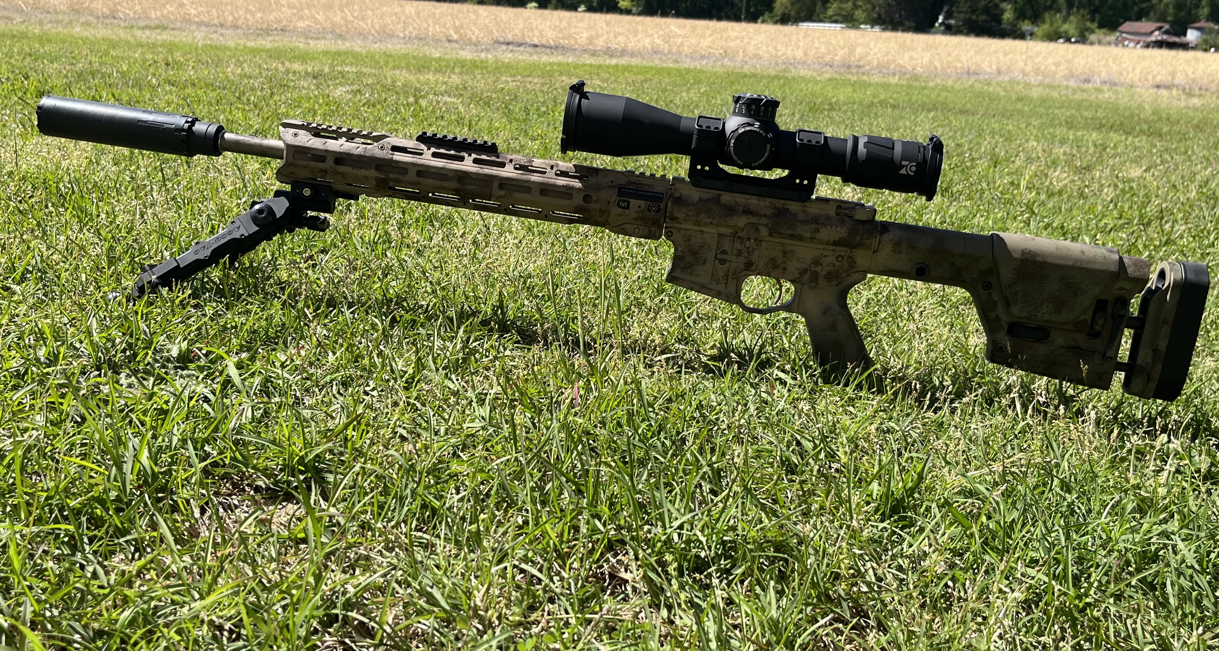

    I have a gun eerily similar to yours. It has one of the old school triggertech frictionless two stages set to 3.5 pounds in it. It has served the gun well as it developed into what it is now. She is an oinker, but shoots well
    -Triggertech 3.5# two stage
    -Mega upper and lower
    -Strike Industries Gridlock HG
    -Superlative Arms adjustable GB
    -18 inch bartlein 1-7:7 twist with Seekins bolt headspaced using a WOA competition length barrel extension.
    -Gen 3 PRS, standar A2 buffer and Tubb flatwire spring
    -ZCO 420 in Badger Max mount

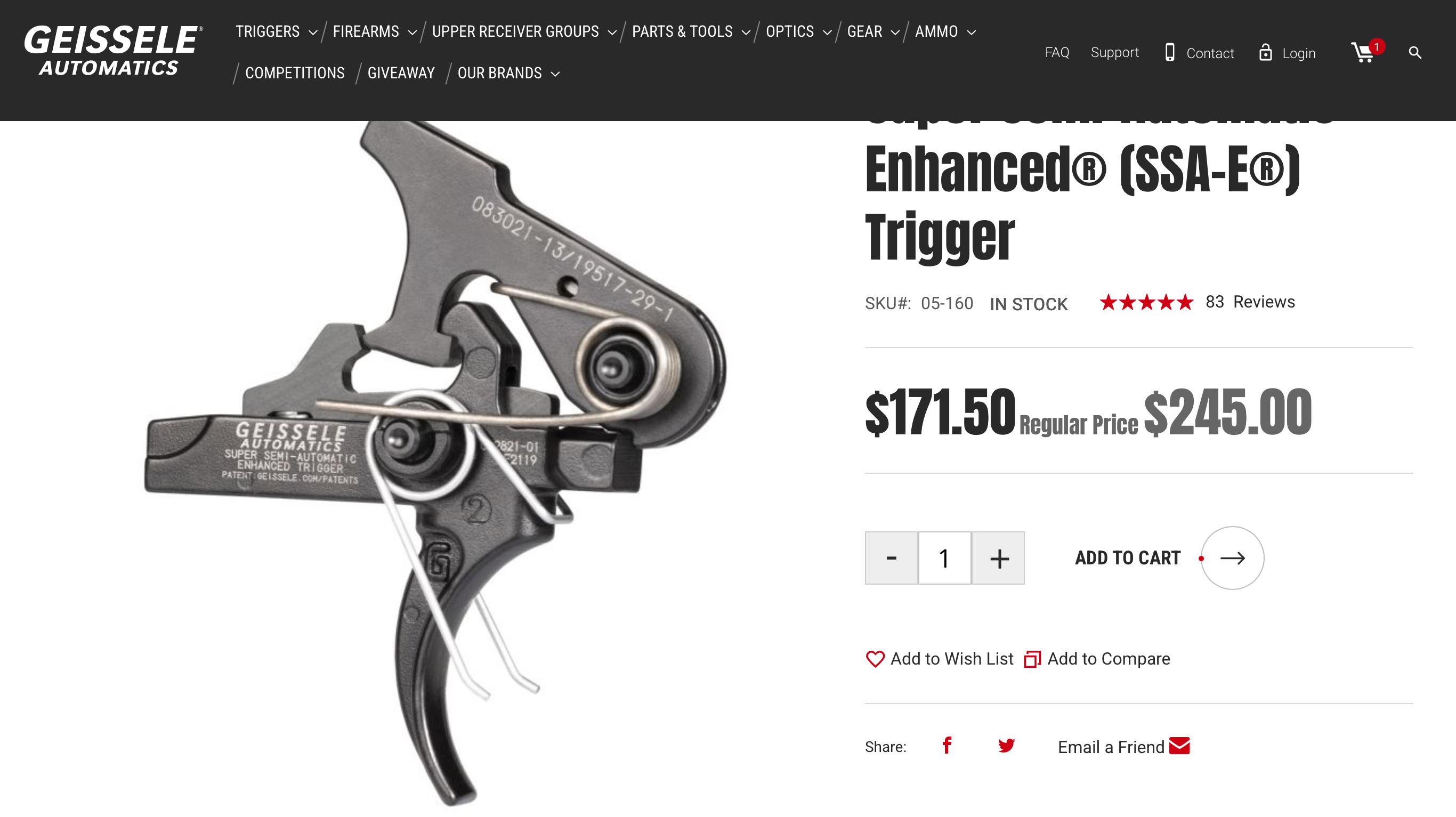

    Just came in to say that all of my AR's wear SSA-E's or something that feels the same. I want to be able to break precise shots or hammer fast shots just as confidently with any of my AR's.
    Consistency is key.
    This is also why all of my main use guns are Glocks with stock triggers. If I'm going to use it for real life stuff, then I want to be familiar with them all the same.
    TT does make nice triggers though.
