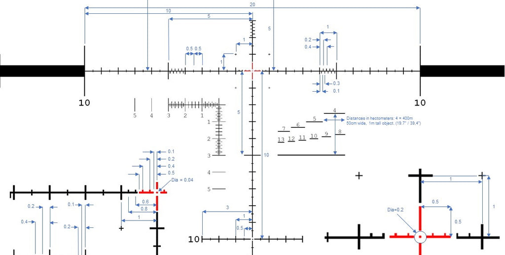

Personally...I really want to see the multi line thickness.Only a mixture of line thicknesses will make this reticle different from those currently offered.
Or, if it is a singular line thickness, something between .05 and .09 MRAD as everything below and above has already been done.
-Stan

My thoughts on a reticle:
So, my basic thoughts are:
1) Start with the Minox LR reticle. Despite it being an uncommon optic, I think they may have triangulated, cleaned, and polished the general thinking on all purpose mil reticles to the highest degree on that reticle.
2) Simple .2 mil graduations everywhere, No switching.
3) People seem to like floating dots and it is never a good idea to deviate from trend too much.
4) Triangular outer crosshairs is a nice touch and helps enhance the reticle functionality when dialed down in power.
5) Make sure your Christmas tree is very sparse or drop it all together. Honestly, I have always wanted somebody to do just full mil graduations here but the sparse .2mil ones on the Minox LR were well done. Don’t underestimate how much busy tree sections can interfere with your ability to see splash. There is a reason for the trend backwords to dropping the tree section altogether. I really like my tree free MPCT 1.
6) Nothing at all above the centerline. I have wanted someone to do this for a long time. I think it will end up great for seeing trace on the lighter stuff match shooters use and I have never used any of those graduations for anything anyway.
7) I think putting lines depicting a 90 degree 10mph crosswind for something common and sort of in the middle like say a 135gr 6.5cm amongst the Christmas tree might make a nice visual aid and reminder. I think it might be worth the space.
8) When you do illumination, always illuminate the whole crosshairs.
9) Yes, you do need to label at least every 2 mils on the main crosshair. It is sooooo much faster for the shooter. Honestly, I prefer every mil.
Also, If you guys want a reticle design off the beaten path for an alternate choice, I do have some concepts for that as well. I would certainly recommend you have at least one reticle that is right in the middle of the market though. Innovation is better as a side bet than something I would put all my chips on. Even an idea that is demonstrably better than the current norm is rarely successful at dislodging inertia and group think.

Your right, the LR is pretty similar to the TOR which is darn near identical to the MilXT.I just don't know if the Minox LR is different enough than the TOR to justify the switch. Both are good, but pretty similar.
2) Can you elaborate. I don't hate it, but I personally still prefer to have the 1/2 mil floating dots like the TOR and MilXT
3) I think most have accepted that, but the size is up for discussion still. I maintain .03 for an optic that goes over 30x
4) easy to add or adpot
6) I'm ok with nothing at all above the center line, but it seems most people have voiced at least 2 mil over. (i would be ok with 1 mil and very minimal information)
7) I could see that, but how many stadia down would you want it? Surely not crazy like the Tremor. My dasher looks like it would .5 mil at 400 yds and my creed would be like .4 mil at 400 yds. so they are almost the same...but its such a small amount, I wouldn't need it on my reticle.
8) elaborate again, do you mean the entire cross hair like both hor and vert stadia or the entire reticle completely??
9) I like every 2, but I don't need the first one.
I don't have any issue with the TOR at all, but if you've got some outside the box ideas, I would absolutely be down to see, hear or read about them.
I think you're right, one of the most outside the box ideas I've ever heard of and absolutely have never considered. However, I feel like it's more of a military concept. Everything is dependant on objects of know size, which animals and targets ARE, but they aren't singularly relatable.Lastly, the out of the box idea. I have pitched it to a few scope makers before and it was actually on a patent application I did back in the day. It is a rangefinding section placed in the second focal plane. This means that the scope would have a first focal plane reticle as well as this ranging section in the second focal plane. There would be no alignment required between the two as the ranging section does not have any aiming points but it would require an extra piece of etched glass. In order to determine the range, the shooter aligns a target of a known size with the graduated section on the reticle and rotates the power ring changing the size of the target relative to the second focal plane scale until the target fits properly. The distance can then be read off of the power ring as it is calibrated for that purpose. There is no math involved because the power ring is efectivly doing the calculation for you. Depending on your erector ratio you could design for say 200-1k yards given a 7-35x scope as it has a 5x erector ratio. Some of you guys may remeber the MSK3 reticle I designed for the Optisan CX6 12 years ago had a calibrated power ring for range determination. Some will also know this sort of concept was first utilized by Jim Leatherwood in the ART, perhaps the most brilliant, out of the box, and underapreciated rifle scope design in history. This is a broader version of just the ranging half of that concept in that it is designed to be used on a variety of different sized targets instead of just one. The scale is also set on an angle so it also functions on both horizontal or vertical targets. It is actually pretty surprising how fast, easy, and accruate a power ring scale like this is at ranging a target.
2nd focal plane scale shown in lower left depicting a vertical silhouette target properly aligned and the power ring adjusted for proper fit.
The range of the target being read off the power ring.
Let me know what you think of the rangefinding concept.

I agree the vert and horiz stadia need to have the abilty to stand out. I pointed that out earliyer with the existing TOR reticle. Someone would have a VERY hard time telling me the TOR dots clutter up the image and they are hard to find trace or splash behind them.A second focal plane ranging option, combined with a first
The concepts in this thread so far that I think are neat / new / of value are as follows:
1. Vary the line thickness in the design based on what needs to stand out more than other things.
2. Vary the line visibility e.g. the crosshair is easily visible while the tree may be less visible a la S&B Grid.
3. Second focal plane ranging marks.
Make something with all of the above three, and you're breaking new ground.
-Stan
