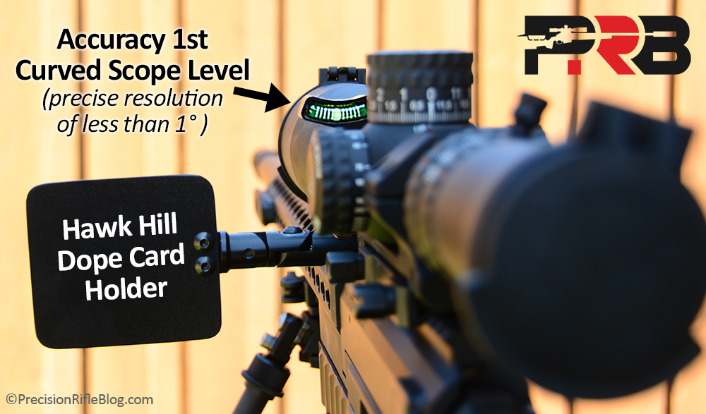

As a right handed shooter, would it be helpful to have the bubble offset on the left?
I´m just thinking, that a bubble on the mount would block my free sight to the elevation turret.
I´m having an ERATAC mount, the manufacturer offers a bubble level for it.

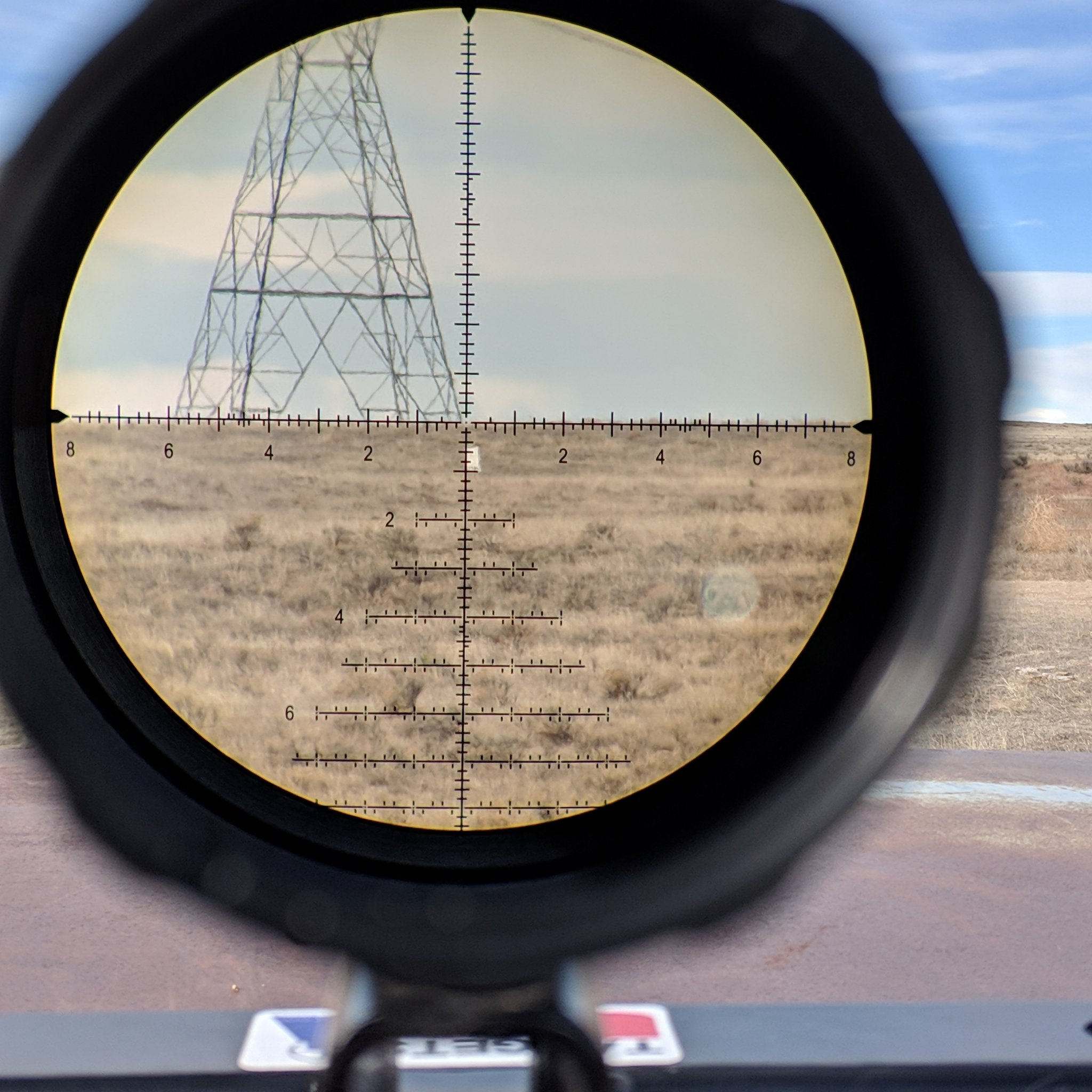

There are 3 major reasons for cant. Either the scope was mounted improperly, the rifle is canted because of the bipod, or the shooting surface is uneven and possibly all 3 in some situations. By far the most important is setting the rifle up properly from the get go. If you have done that the other 2 reasons should be easy to overcome with nothing more than fundamentals behind the rifle and using the reticle. It's really that simple.
In this photo that Frank took, which was for our viewing pleasure, the reticle has slight cant to the right. If you are centered behind the rifle properly then this is easy to see without needing a level and you can adjust and lock down the bipod until the shooting position changes. The reticle doesn't lie and if it isn't level from the start the bubble may actually make it worse. You can even out a reticle based on what your eye sees better than a level can because with a level you're now relying on what the bubble is telling you do and not the reticle.
All personal preference. I have mine in front of my elevation turret. Sure I can only see the top edge to a little past center but that's all I care about. I'd personally go with one offset to the left if you're a right hand shooter.
In this photo that Frank took, which was for our viewing pleasure, the reticle has slight cant to the right. If you are centered behind the rifle properly then this is easy to see without needing a level and you can adjust and lock down the bipod until the shooting position changes. The reticle doesn't lie and if it isn't level from the start the bubble may actually make it worse. You can even out a reticle based on what your eye sees better than a level can because with a level you're now relying on what the bubble is telling you do and not the reticle.View attachment 7052972
