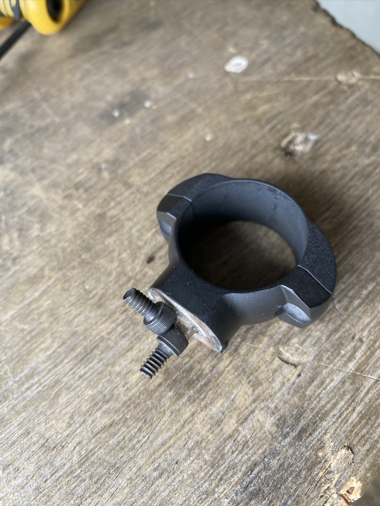

So the two tiny welds are what basically holds the rings on?
So could it be silver soldered if they came apart like that?
The pins are what provide the mount strength under a shear load. The recoil of the gun produces a shear style of load. Rifle goes backwards, scope kinda sits there until the recoil movement catches up with the scope via mount & rings. Think of it as pulling the table clothes out from under the dishes. When done fast, the dishes don’t move but pull the table cloths slowly and everything falls onto the floor. This is the opposed of that.
Once a scope is placed in the mount connecting the front and rear ring together, there is no more allowance for a single ring to be able to be twisted off. The tack welds only prevent twisting of one ring at a time when no scope is mounted in them. I’m sure they play a very minor part in preventing the rings from popping off.
I am willing to bet that the original Unertl mounts are more than just brazed on with silver solder. After all, the rings are bigger than a front sight bead or vented rib or iron sight base. John made the scopes marine proof and demonstrated this by driving a tent stake into the ground with one of his prototype scopes during the usmc trials.

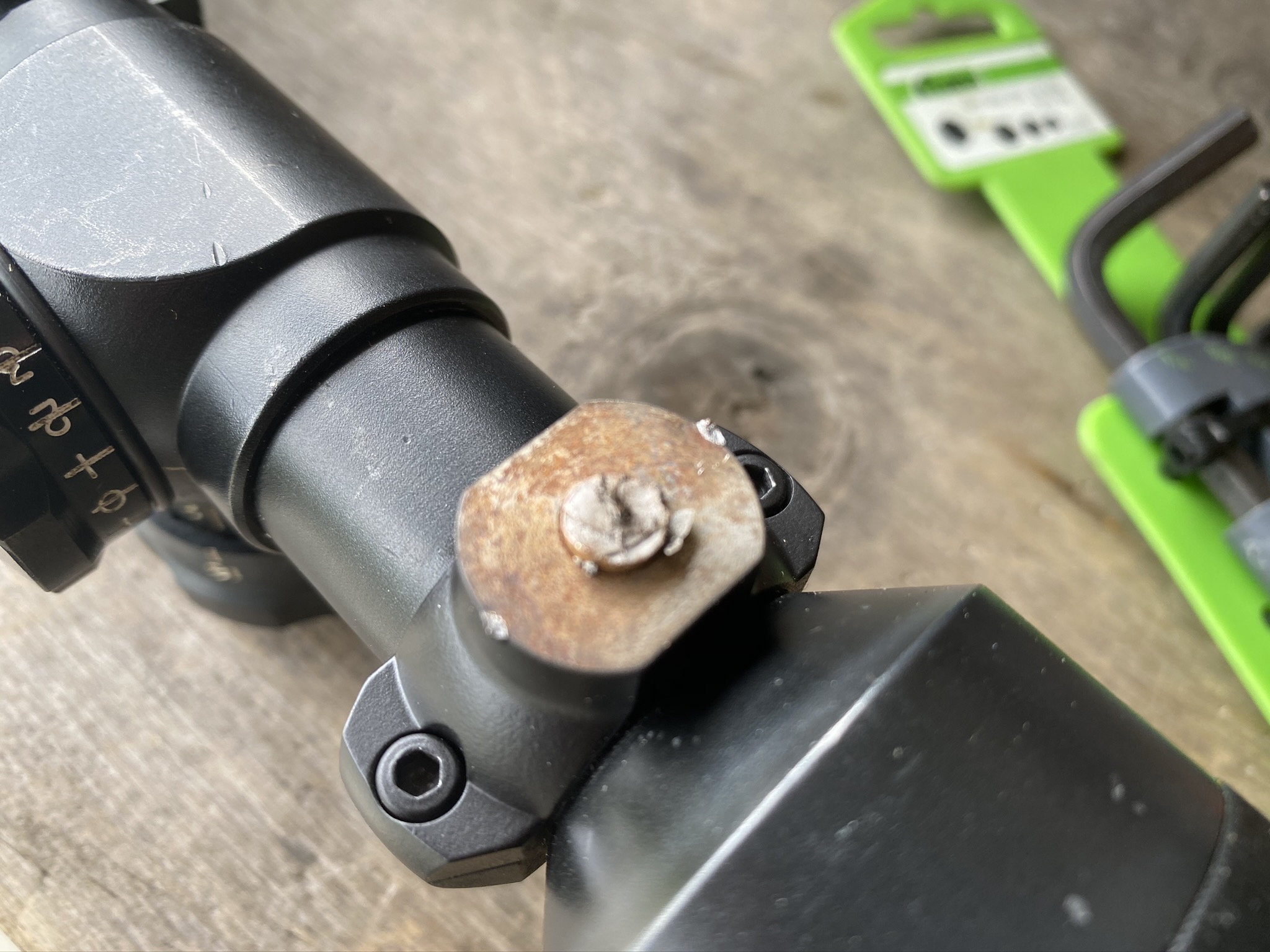

You're 100% correct! The 2 shitty welds on each side of the ring lowers is the only thing holding the mount together! (@msr_762 explains the lateral forces exerted on the steel pins above, but those dont hold the rings to the mount) It will fail eventually! When the shitty welds on the TMA mount does break, you can reweld it, but make sure everything is lined up perfectly.
Don't even bother with this though, I might do a run of repro Unertl mounts and they will have a one piece base/ring lower, so there won't be any way to break them. I'll keep you guys updated on any progress if I decide to have a batch made.
One last comment for my daily rant. The 3 of his mounts that I intentionally twisted off the rings from of the 5 I’ve handle in the last 10 years. All had a 1/4” dia by 1/4” long dowel pin centered under each ring. It serves the purpose of keeping the rings aligned and on center. It also serves to prevent the ring from shearing off (bending; not twisting). The one picture floating around of the pin sheared off; I have no clue on. Other than if that fat and short of a dowel pin were to be sheared. It would take so much force to shear it that the ring, base and hole for the pin would have looked like it was beaten with a sledgehammer. Actually, what most likely would have happened under a 6 shearing load, the pin would most likely just pulled out of the 1/8” deep hole in either the base or the ring. Just my 2¢.
Also, in regards to him using a magnets. I highly doubt this. Based on my prior paragraph but he is super sketchy and anything is possible with him. To explain why some of you are finding his mount to be magnetic. When cutting metal, your cutting speed (rpm) and feeds (feed rate) are super important. Get these wrong and you burn up end mills real quick. Drills too. As the tool dulls and wears, you now have a rubbing action happening vs a cutting action. Your end mill and drills are harder than the steel you’re cutting. Harder material wins. So, you are now rubbing instead of cutting. This is how you accidentally magnetize your part. How it actually does it is beyond my intellect but I know this can and does cause magnetization. It’s why every machine shop worth a damn has a demagnetizer.
By no means am I defending or even sticking up for him. Just sharing some knowledge. He’s still a pos and I’ll never do business with him again after this last mount from 2021.

Tbe crazy thing about the pins is that they are needed at all. All the maker needs to do is extend the ring lowers into a larger hole in the base. The ring lowers are a larger diameter than the pins and probably distributes the recoil forces better than a thin piece of steel stuck in there.
I'll have to dig it out, but I have the rod that Dan Ross used to line up the rings on his version of the Unertl mounts. I think it came with rings and a base, but nothing is brazed or soldered together, so I can take the pieces apart and see how they fit. He did what Unertl did, I just hope I have those pieces somewhere so I can post photos.
As far as I remember, the ring lowers extend into the base and it's soldered or brazed together. It actually works extremely well, but sometimes they loosen up. When this happens the 2112's would put little tiny tac welds (2 per ring base) right where the rings and the base meet. These are seriously small welds, nothing like the large sloppy ones TMA puts on his shitty mounts.

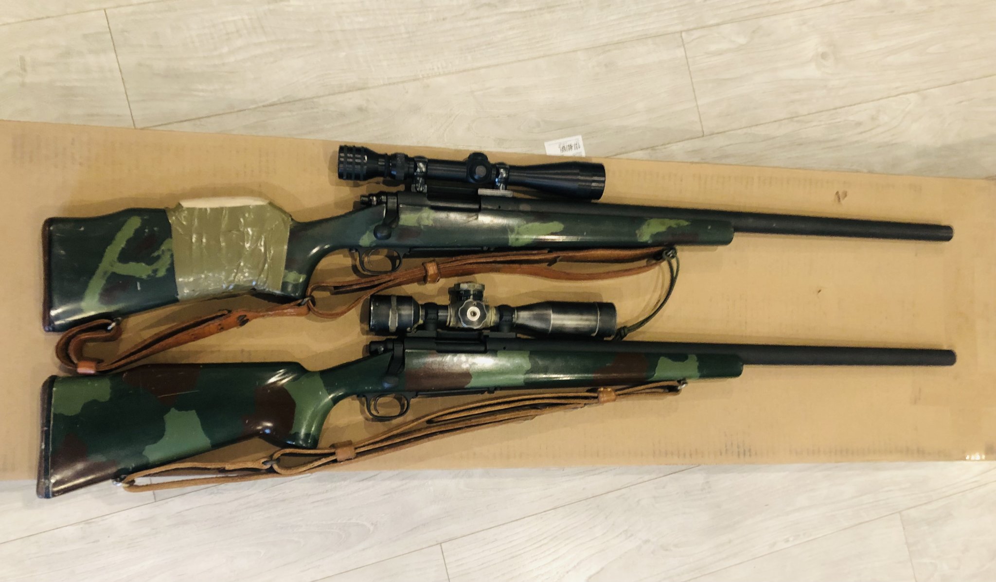

UPDATE!!!!!
The parts arrived. I couldn't believe it.
Randomly this morning the postie rocked up with my M40A1 Parts.
He came through

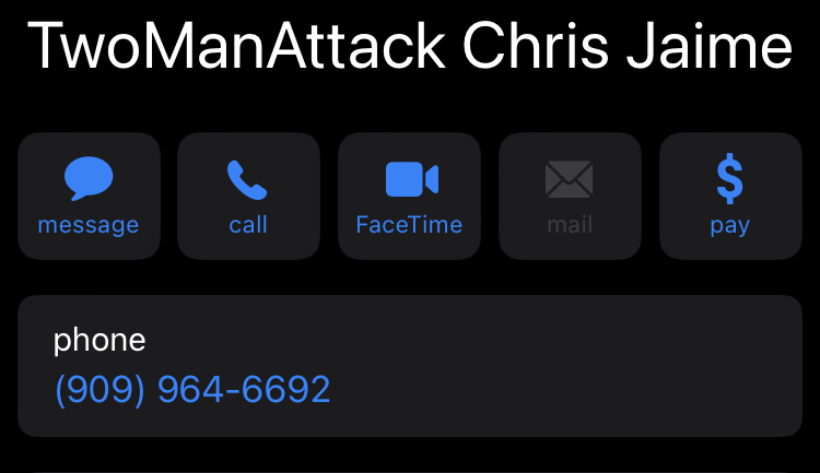

Have we (or can we) post this guys name?
I’m pretty sure his first name is Chris. I can not completely remember. I deleted his contact information.

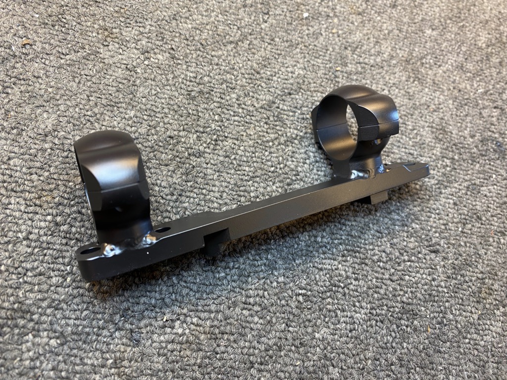

Hi, here is mine mount, for sure was magnet innside. Non ss rod. He did never reply to any emails from me. But, I did reweld , and remount on rifle, never looked back. Have shot approx 1300rnd now. Work like a champ.

for what the hogsden is charging for those mounts and claiming is 100% authentic. That mount should not have broken in the first place. You had to reweld. And looking at the size of those welds im pretty sure its now a tank.
Im glad its working for you now. Also go to the m40-m40a6 pics thread and post some photos of your rifle!
Totally agree you should not have to reweld them. Bad thing is there is not my options out there except using a different style but correct mount. Hopefully we will get someone to start making them.
I agree there arn't really any options. I think if someone was to start making them I hope I could convence them to make a few left handed, for some of us that want a bastard version from hell.

The guy has been dealing under tons of aliases, it's crazy. Usually people want to have 1 name and build a reputation around it. Take me, for example. My username is the same everywhere, forums, ebay and gunbroker. Some that uses a ton of different names usually has something to hide. Here's the names I've seen 2fag use over the years (some he claims are his son or daughter's account, but it's really just him):
Twomanattack
Twomanattach
PlumbersCrack
WalkAroundBoat
LatinaInCorvina
CruZ
TheHogsDen
I'm sure there's more, but these are the ones that come to mind. The spelling mighg be off on some, but you get the idea. He also has a very specific way of writing his product descriptions. He's the only person to use the words "pedigree/pedigreed" in his listings. Same thing with "built at the home of the deadliest snipers" or whatever bullshit. If any of you see these names and/or these words/phrases in the description, it's 2fag, so stay far away!
He also lists his location on ebay as Camp Pendleton to make it seem even more legit. He doesn't live on Camp Pendleton, it's a complete lie!
Chris Jaime

On the up side….
Top M40a1 was the one I sent to him and then sent to PWS to have fixed by an actual 2112.
Bottom M40a1 I just got back a couple days ago. This one went to GA. They did an amazing job on it.

Years ago (1997-2004)I had some made when I operated Tactical Stocks & Supplies. But they were dual dovetail clipslotted versions. I don’t think I have any left handed in the vault but will look. A chap about 2 years back bought all the inventory that I had left - a decent amount. All 4 configurations (short RH and LH as well as the double goofy long action clipslotted bases RH and LH)
I think dual dovetail may have been superior to brazing or spot welding. That would be an awesome mount even if not 100% spec.
Reactions: fourhourseast
These look bullet proof - Refreshing to see someone making m40 gear and keeping the Clone game alive!
