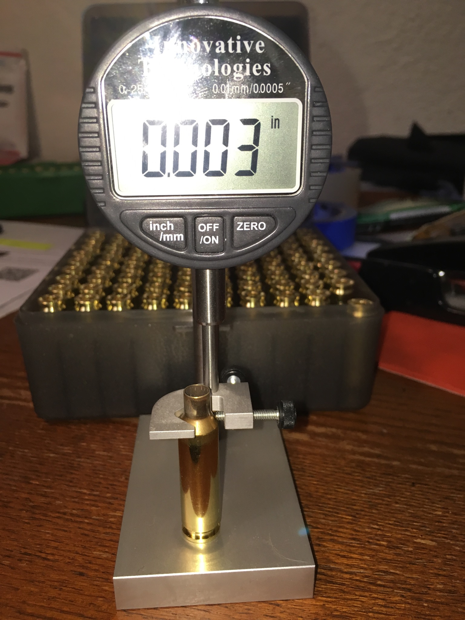

Interesting. I just did my first barrel swap (.308 to 6.5 cm) so this was new to me. I used Manson go and no-go gauges on my first attempt and was ending up w/ Hornady factory loads stretching .006” when fired. I was not happy with this so after speaking w/ Criterion who made my barrel and then JGS whom they recommended. Both agreed I was on the high side. I bought a JGS go gauge and used a piece of scotch tape (.002”) on the back of it for no-go. (This tape method had been suggested by Mr. Manson but I ignored it, in favor of a no-go gauge?).....
Now my the factory loads I was using for break-in and the new Alpha brass are growing .003 on first firing. I am pretty happy with that.
Since this was new territory for me I was using an abundance of caution. My thinking also was, that my initial firings with new alpha brass will be closer to what the fired brass will be i.e. -.001 to -.002”
Did I overthink this? I don’t really know.......?

Very nice explanation. I've been down this road before after barrel swaps, particularly with the web dimensions. Essentially it means trashing the brass unless there was a small-base die around. Even then they never quite behave correctly afterwards firing due to the weakened web.
One of the worst was in the early days of 338LM for instance when there was a CIP and SAMMI spec. It got frustrating to the point where I actually just did chamber castings in order to determine what was what. I had two 338's back then I had to lot brass for and the observed dimensions were quite different. Couldn't even remotely chamber one in the other.
