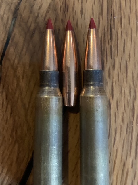

Mine is a .062 freebore wylde too and with the old lot of bullets I was 1.900 to touch when new and seated at 1.873 on the ogive.
I seated this new lot to the damn near the same spot without adjusting the seating die and the oal is ~2.416 for these new ones.
You can go a bit further with the freebore if you wanted and I dont think you would have any issues.

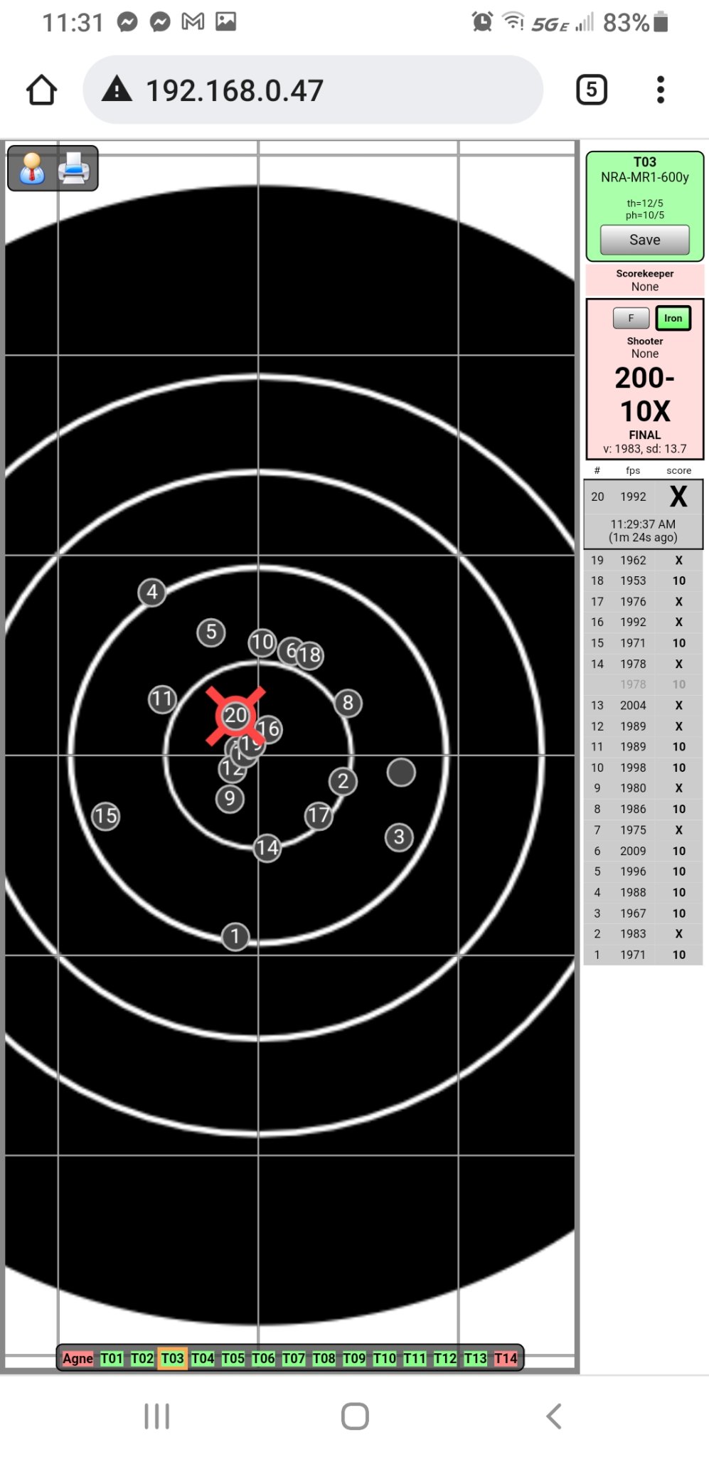

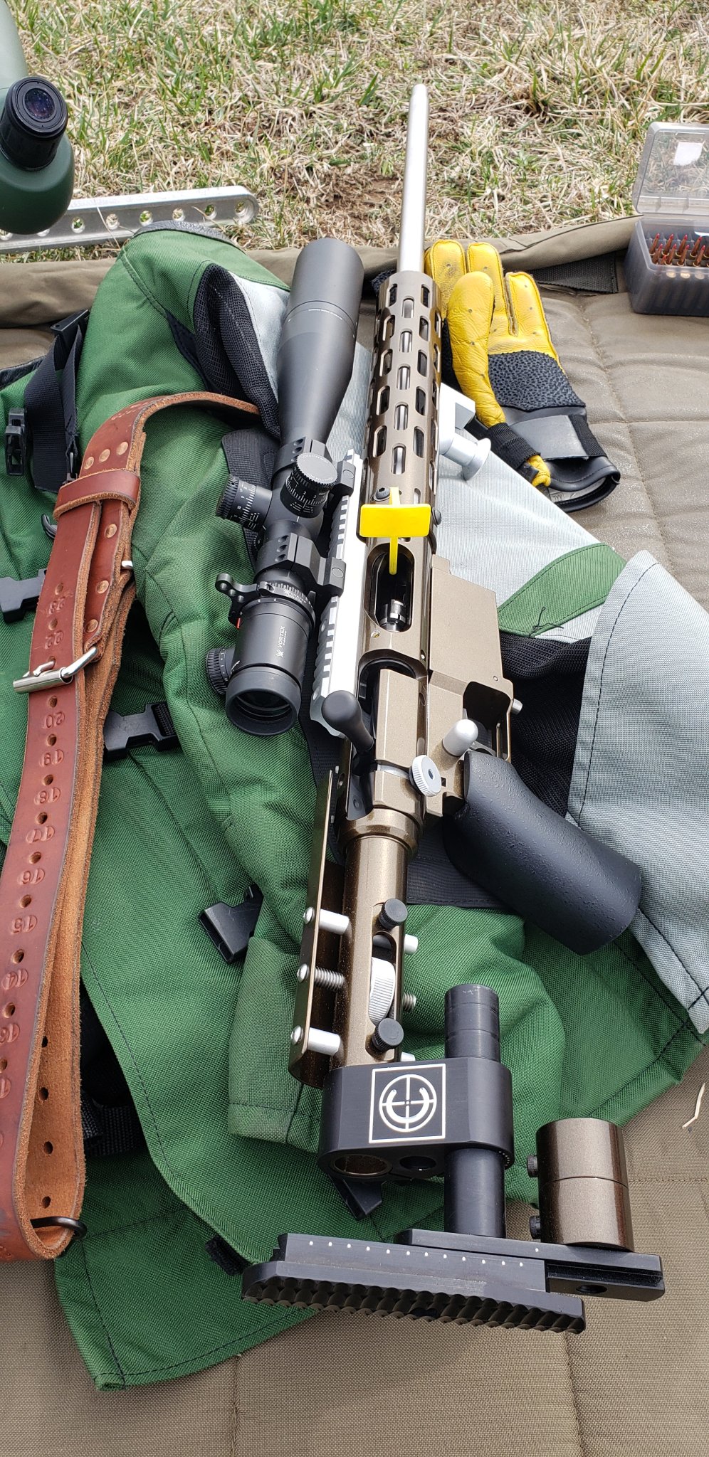

23.8 of N135 behind a Berger 90 or Hornady 80 or 88 eld all end up super accurate in my .223 Palma rifle. Usually single digit SD's at 1000 yards.
31" 1:7 twist Bartlein, Origin action, CG Xtreme trigger, Eliseo chassis, Eric Hollis match rifle sling. This was my clean string at 600 a couple of weekends ago.
It'll do the trick at 1000, but I'm struggling with it compared to my 600 yard scores. That, and iron sights at 1000 are hard.
One of these days I'll step up to a big boy caliber for 1000 yards, but its sure nice to load one caliber at $0.40/each for everything I shoot. One set of dies, one or two powders, etc. Its nice keeping it cheap and simple, and you aren't giving up a thing at 600 yards and in.

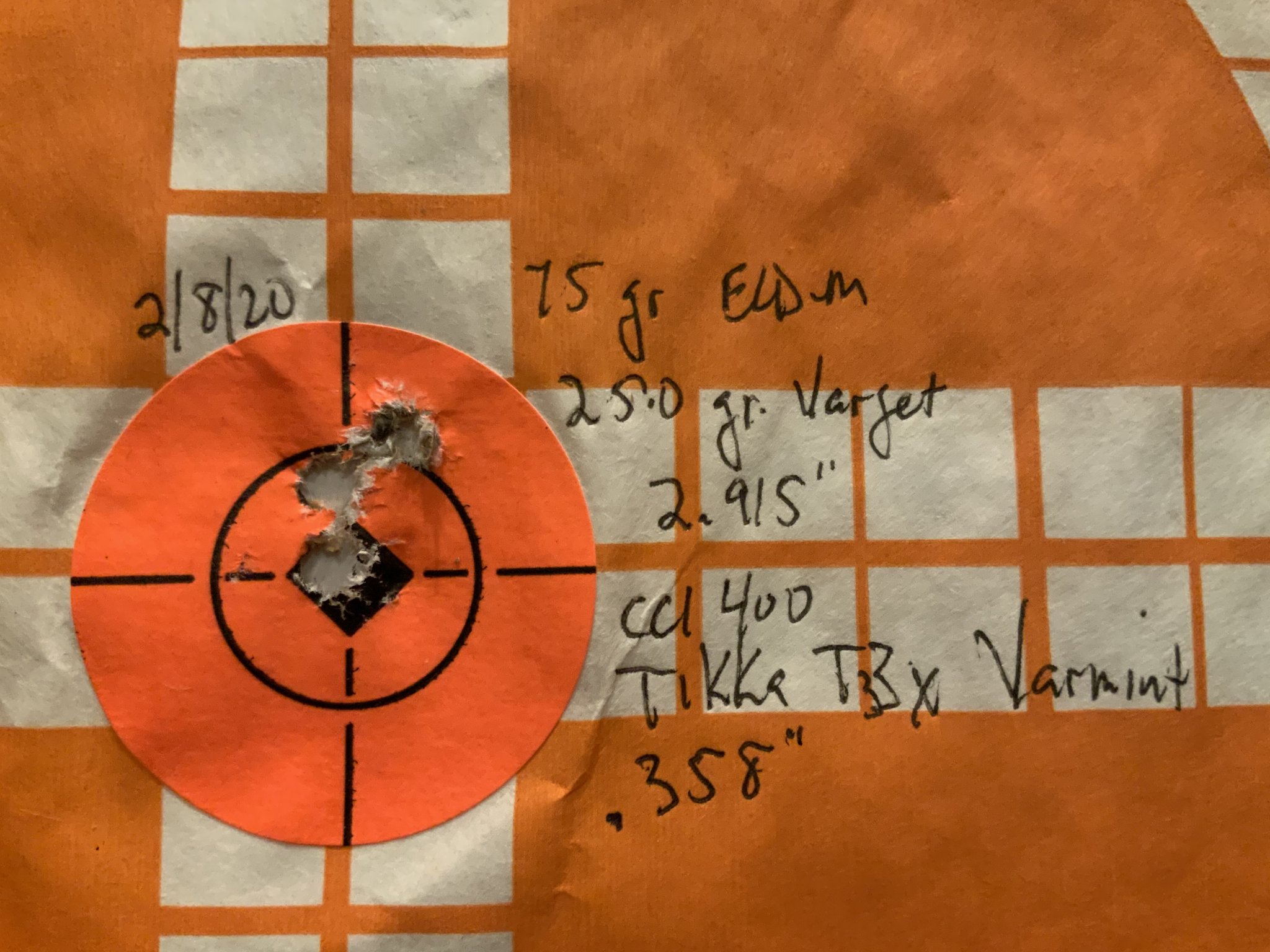

75 ELDM, Tikka T3x Varmint, 25.0 gr Varget, CCI400 primer, R-P brass, 2977 fps and really good accuracy. Five shot groups.

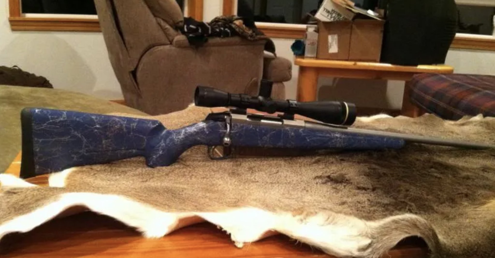

This is Blue Lightning
Stainless Tikka T3 1-10”
26.5 grains Benchmark with a 50 gr NBT Varmint. 3400 fps, crazy accuracy 400 yards and in.
My boy named the 50 gr load “Pest Control,” and for good reason.
