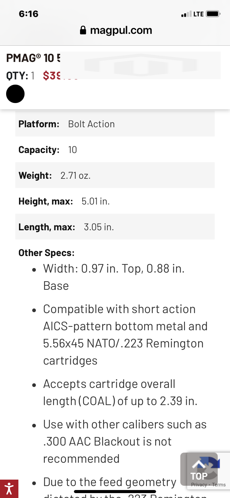

Just another 223 mag that will not accept cartridges loaded with 80 grain bullets for a Wylde or similar chamber.
That’s why I love my SAC desert tech magazine. I think I can load to 2.550. My longest load is 2.535” 80 ELDM ON SAC REM match chamber. Absolute pleasure to shoot.
I know I modified my 5 rnd Accurate Arms 223 AICS quite a bit for proper 300 blk heavy subsonic feeding - not sure what the max coal would be if you take the whole front plastic plate away.
It’s a decent mag once you’ve tuned it. Out of the box it’s quite mediocre.
Overall I’ve always felt like the current offerings were lacking - hope the new MDT DSSF resolves the issues of the earlier plastic AICS 223.
