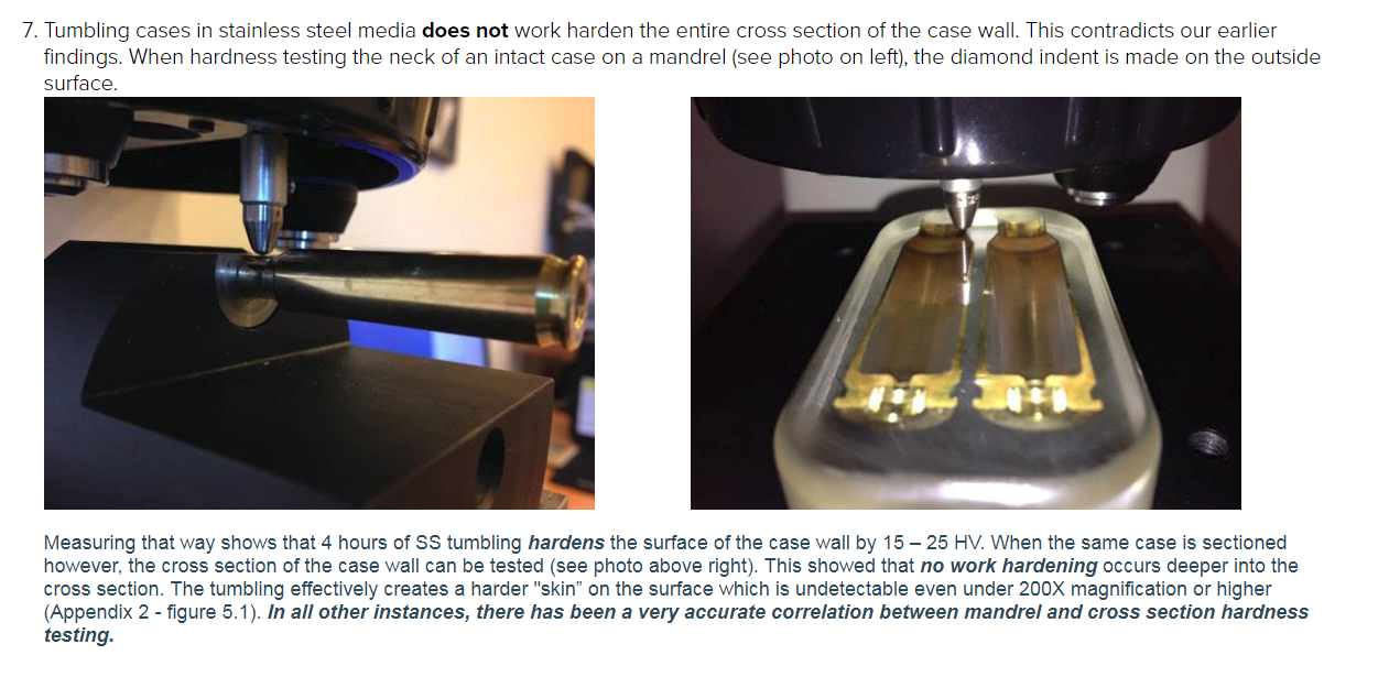

Not really mentioned yet but sort of corollary so I can see a bit of inklings maybe: stainless just peens the mouth up and gives a thin film of harder brass just on the surface but all of the interior brass remains unchanged in hardness. A quick chamfer and deburr will remove the peen.
https://www.ampannealing.com/articles/40/annealing-under-the-microscope/
