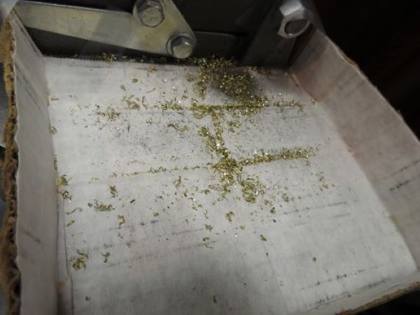

Yes you're correct that it's a very small swath of available primer seating depths with most components. However, remember that the anvil sticks up WAY less with federal primers than CCI... so that won't always be true. I think the article did well in pointing out that this was just an introduction to the principle, but the actual testing should be performed by each individual. He spent at least a paragraph explaining that it wasn't going to be the "end-all be-all" end of the discussion, but rather the beginning of it.
I can tell you from my own experience that a full primer seating depth test from anvil contact to just past complete crush, will most definitely reveal nodes much in the same way that bullet seating depth will. These results are shooter, equipment, and component driven... and therefor any hardened statements of actual "correct" primer seating depth will be misinterpreted as globally correct, rather than correct revealed as a result of testing. Much like the bullet seating depth of 10 thousandths off the lands, where everyone starts today... so too should full anvil contact and then proceed deeper be the beginning of the primer depth discussion.
The article shows just how small an adjustment can have a significant impact on results. Its a start, not an end. That should suffice for those just now being introduced to the idea. Conversely, for those looking to pursue it further, a full primer seating depth test on your own is the only way to proceed. ... and you can forget seating by "feel" to accomplish this... because the variance from hand primed by feel will typically result in +/- .003 or more, while you can achieve +/- .0005 quite easily with a CPS, with many reporting better. Whether people can shoot the difference is a very individual answer.
I totally agree with your comment that you can pretty much forget about seating primers accurately by feel. I started looking at this a couple of months ago. I had been using an RCBS hand primer for 20+ years and always thought I could feel the primer touch the bottom of the pocket. Clearly I was fooling myself - once I started measuring things, it turns out I was crushing the shit out of the large rifle primers in my .308 and .284 These were being seated around 0.012 - 0.014 when 0.004 would be enough to make contact with the bottom of the pocket. Not only were they seated too deep the actual depth could vary by 0.004 in the same batch. Small rifle primers were not so bad, but still deeper and more variable than I would want.
My CPS got delivered today..
