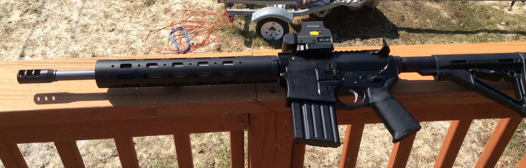

New G2 DPMS 308 SASS first day out. Serial #232

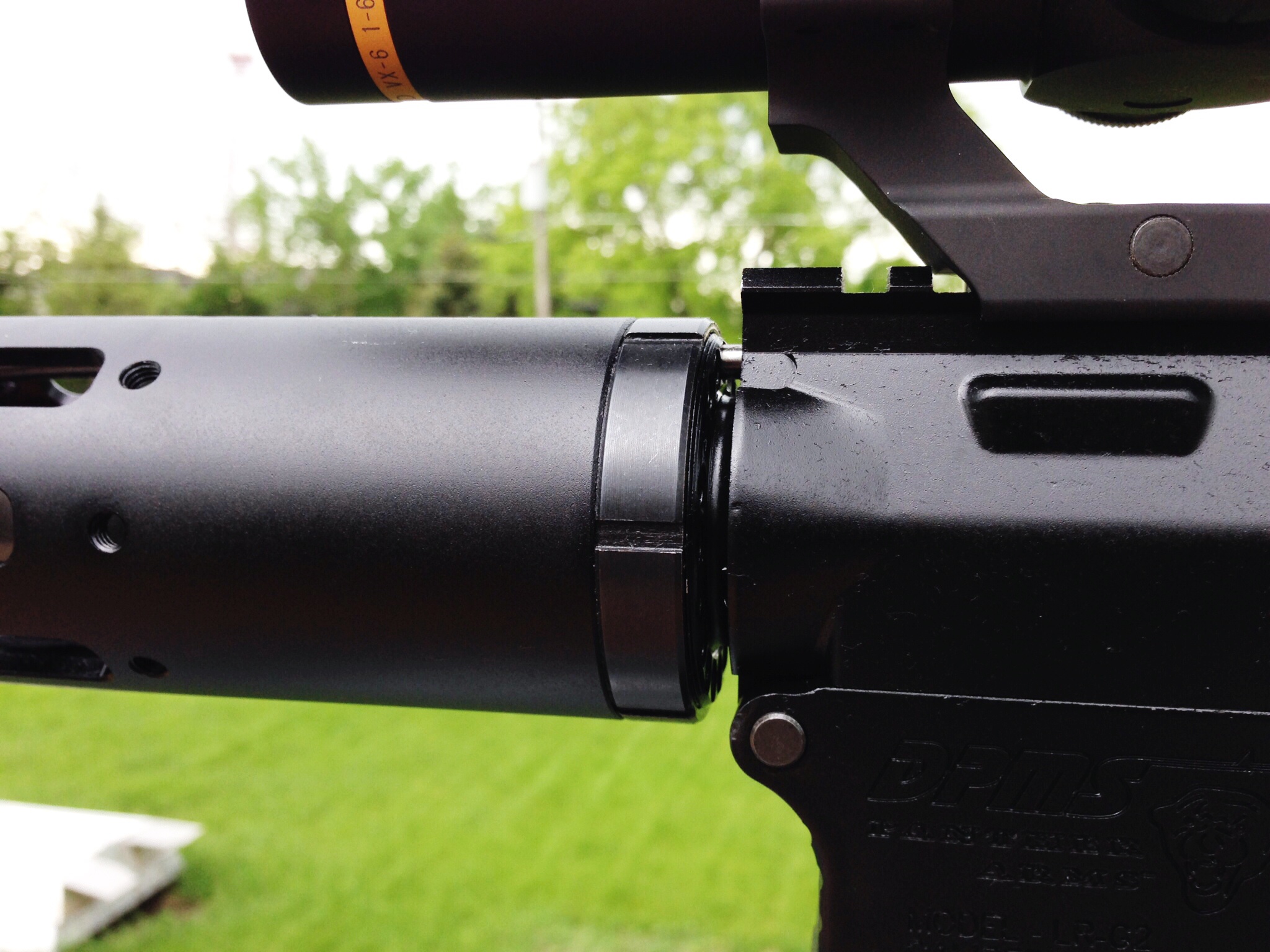

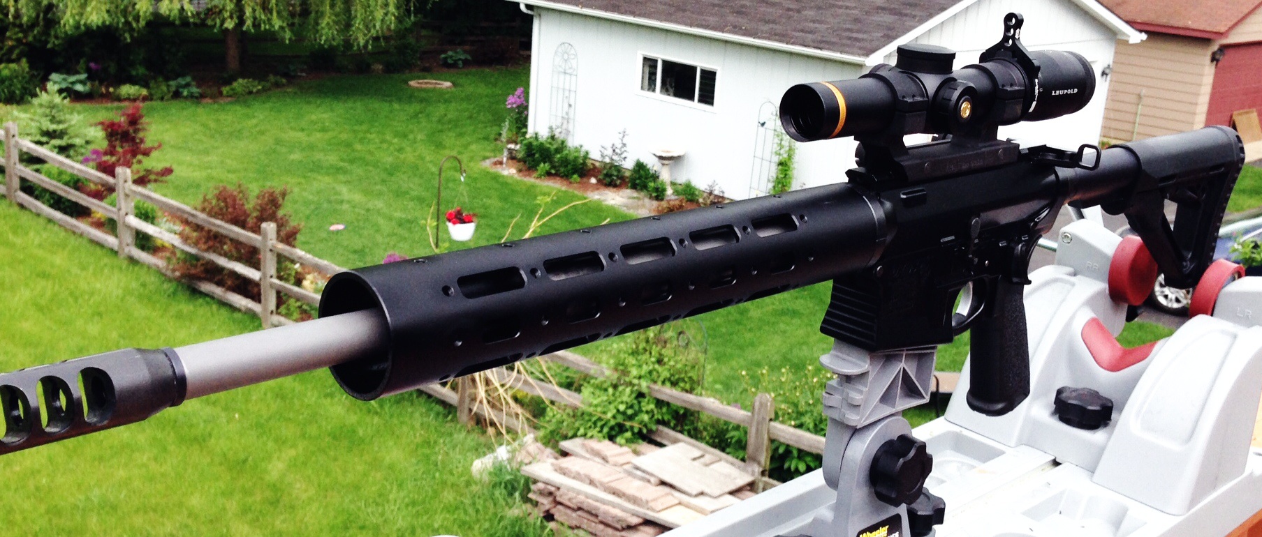

It is indeed very light for a .308 AR. I replaced the factory quad rail with a standard AR spec Nordic Components 13 inch free float tube and it fits just fine.

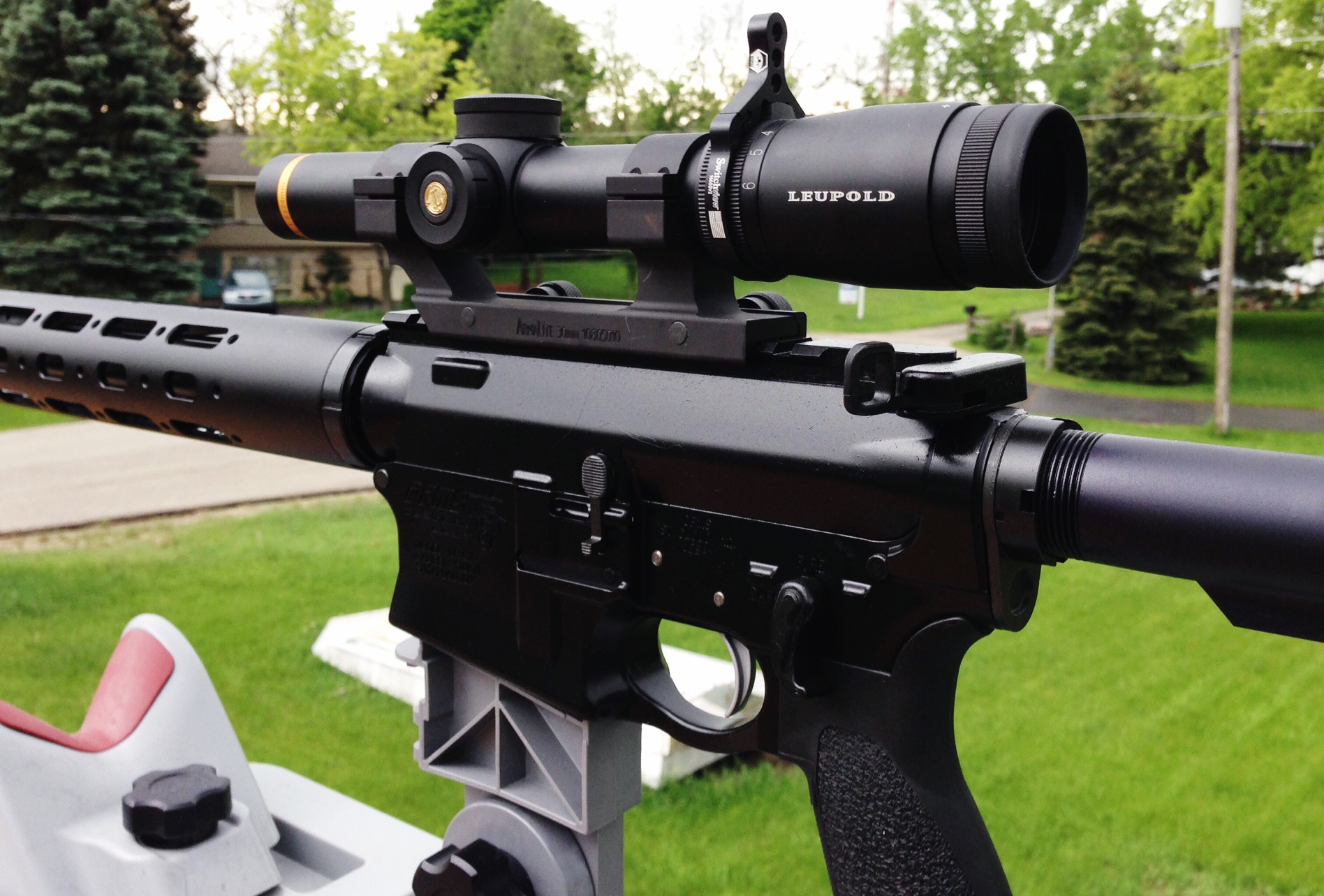

I mounted a Leupold fixed 10x on it for the time being, though it will get a Bushnell ERS soon enough. With the Leupold and ADM mount it is a svelt 9.6 lbs unloaded.

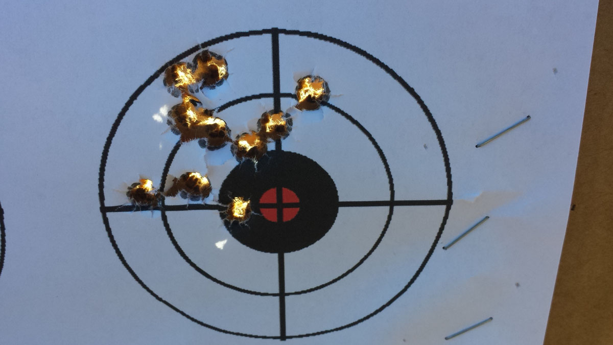

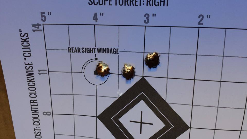

The very first 5 rounds after zero:
10 Shot group in the bottom left:

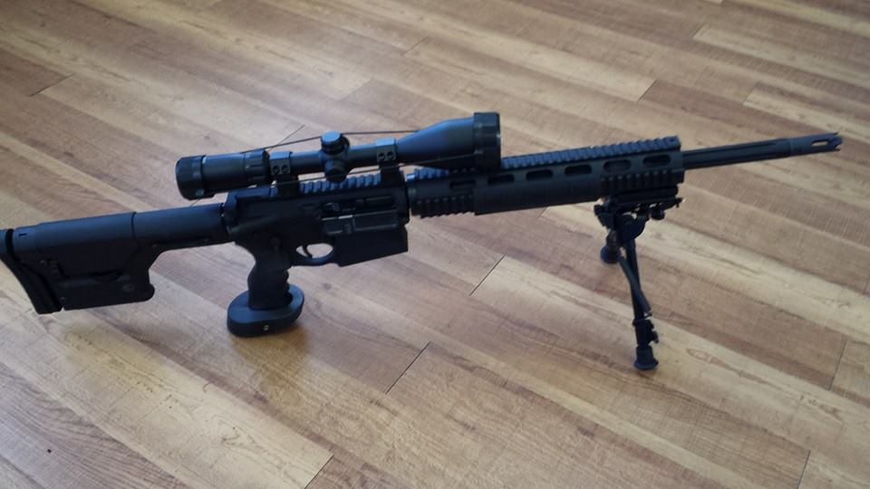

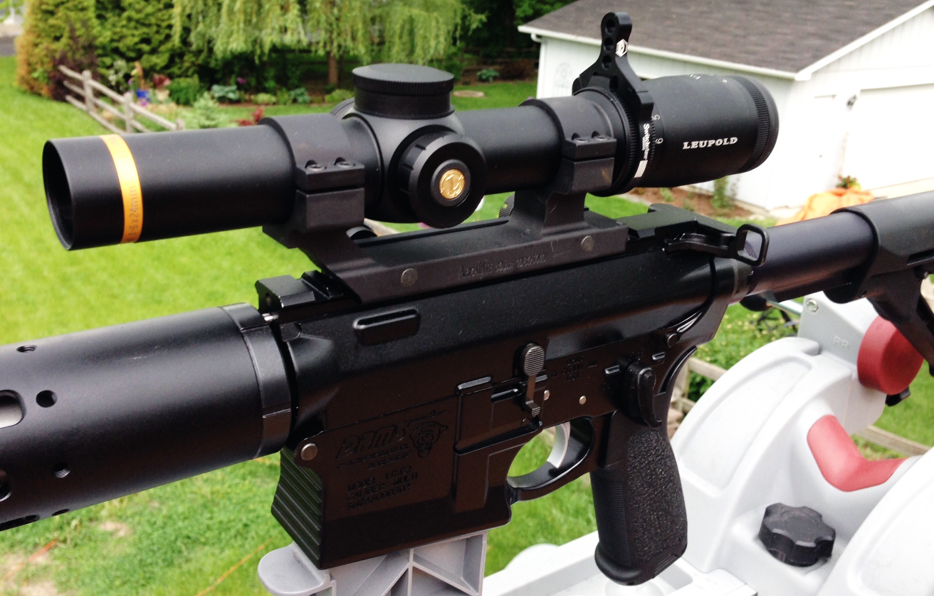

DPMS Gen 2 Recon .308 with extended free float tube ( Nordic Components), Badger Tactical Latch, ALG/ACT trigger w/ JP 3.5 pound spring kit, EoTech XPS-2, Miculek Muzzle Brake timed at 1 o'clock, Magpul CTR stock,

Just about anybody's AR-15 free float barrel will fit the DPMS Gen 2. The gas block and tube are very compact and low profile. I went with a 13" Nordic tube because I prefer the 3-gun style grip, but the stock quad rail looks like YHM to me. The receiver set is slightly longer than standard AR, but definitely shorter than the large frame .308's on the market. The fire control group, buttstock , and all furniture are standard AR. The BCG is a monolithic billet design - no separate gas key. The extractor spring is polymer and there are TWO ejector spring/pin assemblies. There are three gas rings. It will feed and extract all day long without an issue provided you stay away from the Magpul Gen 3 PMAGS. The SIG 716 and the Ruger 762 don't like those mags either.
Very compact receiver - standard AR fire control and furniture fore and aft of the receiverimage.jpg
I love this scope: Leupold VX-6 1-6x Firedot Illuminated Reticle. Helluva value for $900 and it's made in USA. At 1x I think I prefer it to my Eotech in fact.image.jpg
