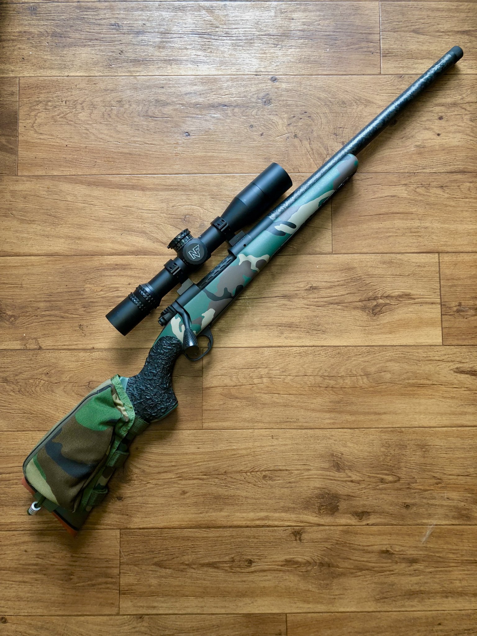

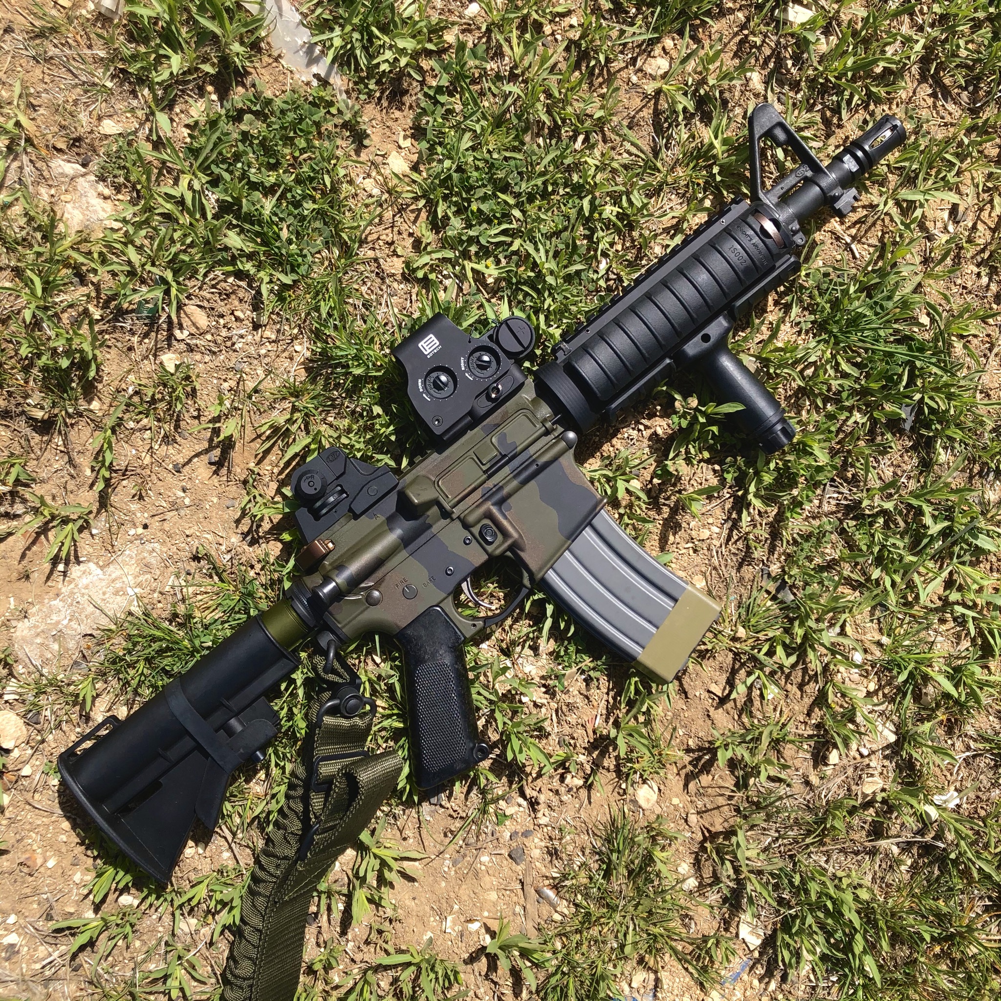

I like Cerakote on metal and Duracoat on fiberglass. I use the same equipment for applying both without issue. Acetone cleans them both up really well.
Duracoat on the bolt gun stock, Cerakote on the Mk18:

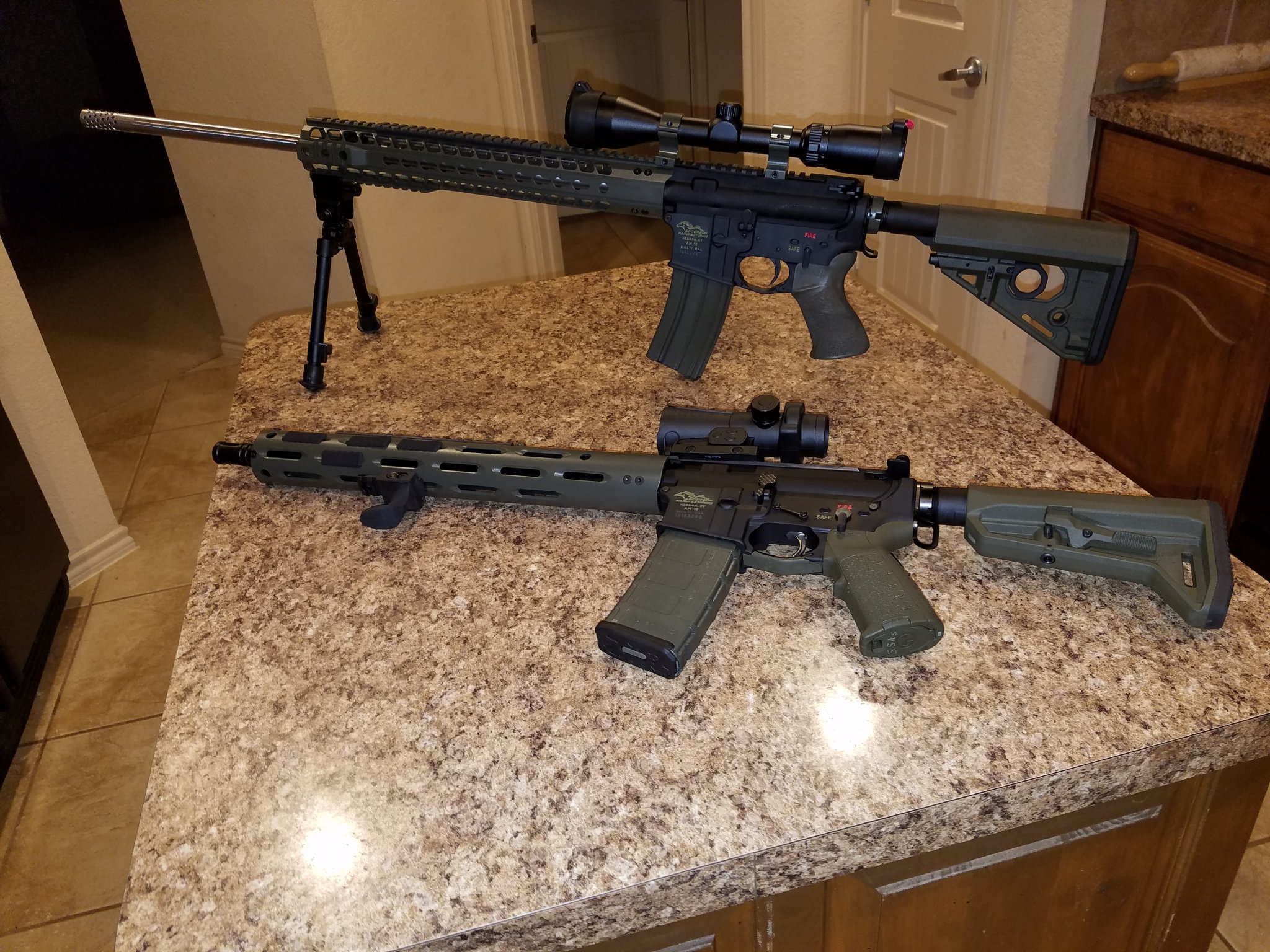

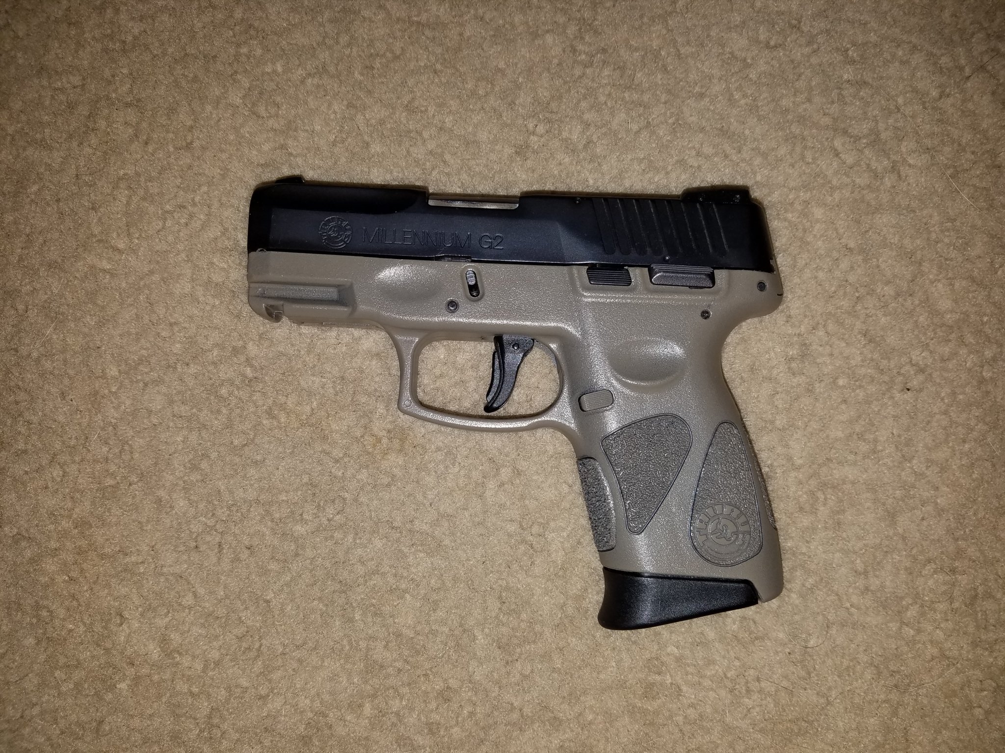

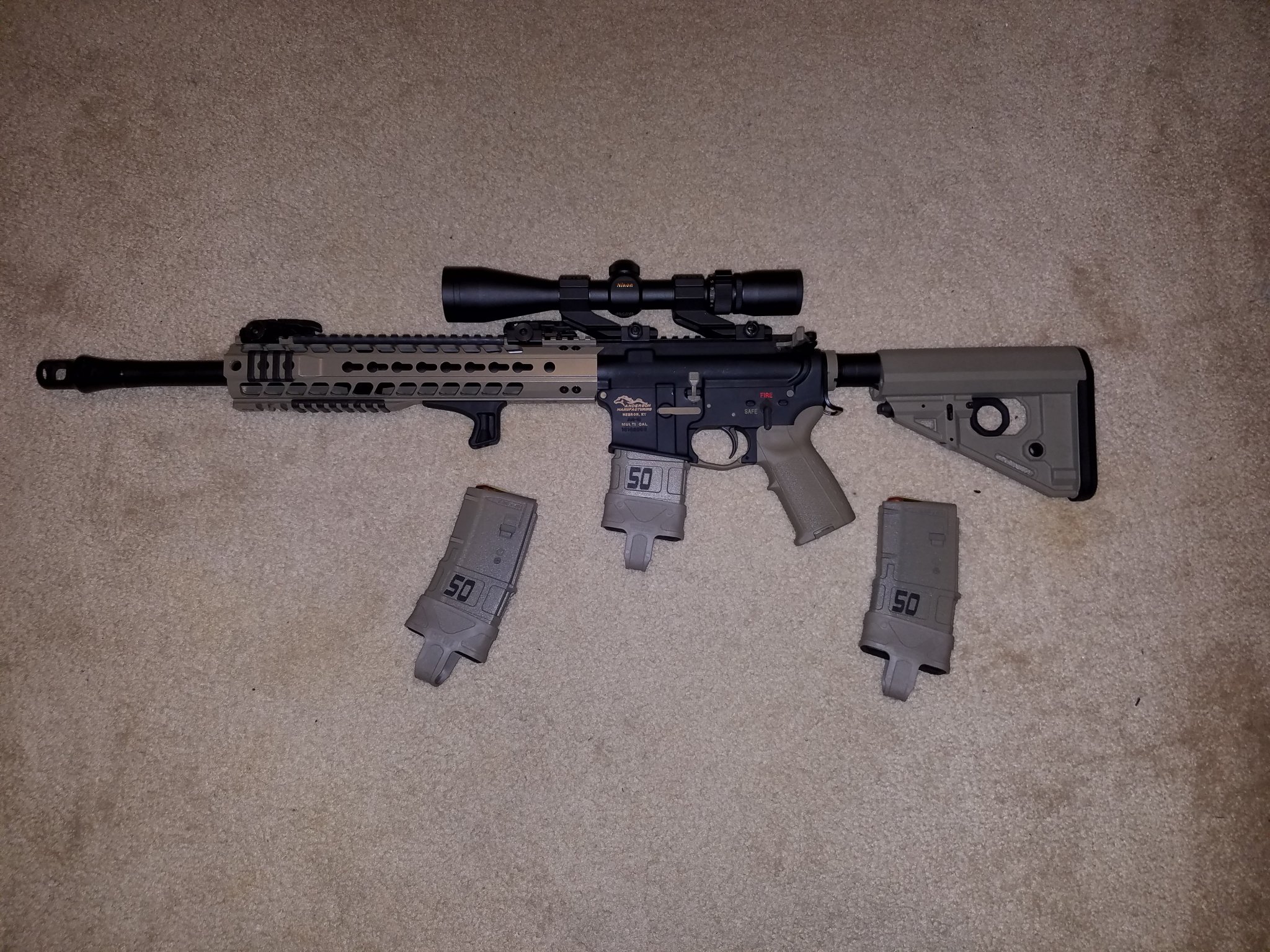

Duracoat sir.
