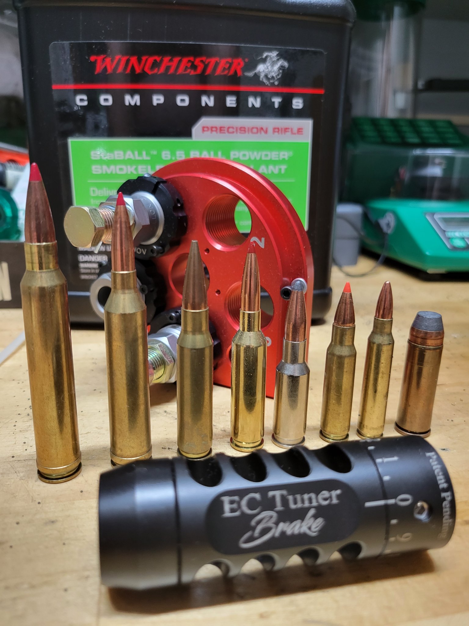

Thanks Erik the machining and finish is outstanding as always.

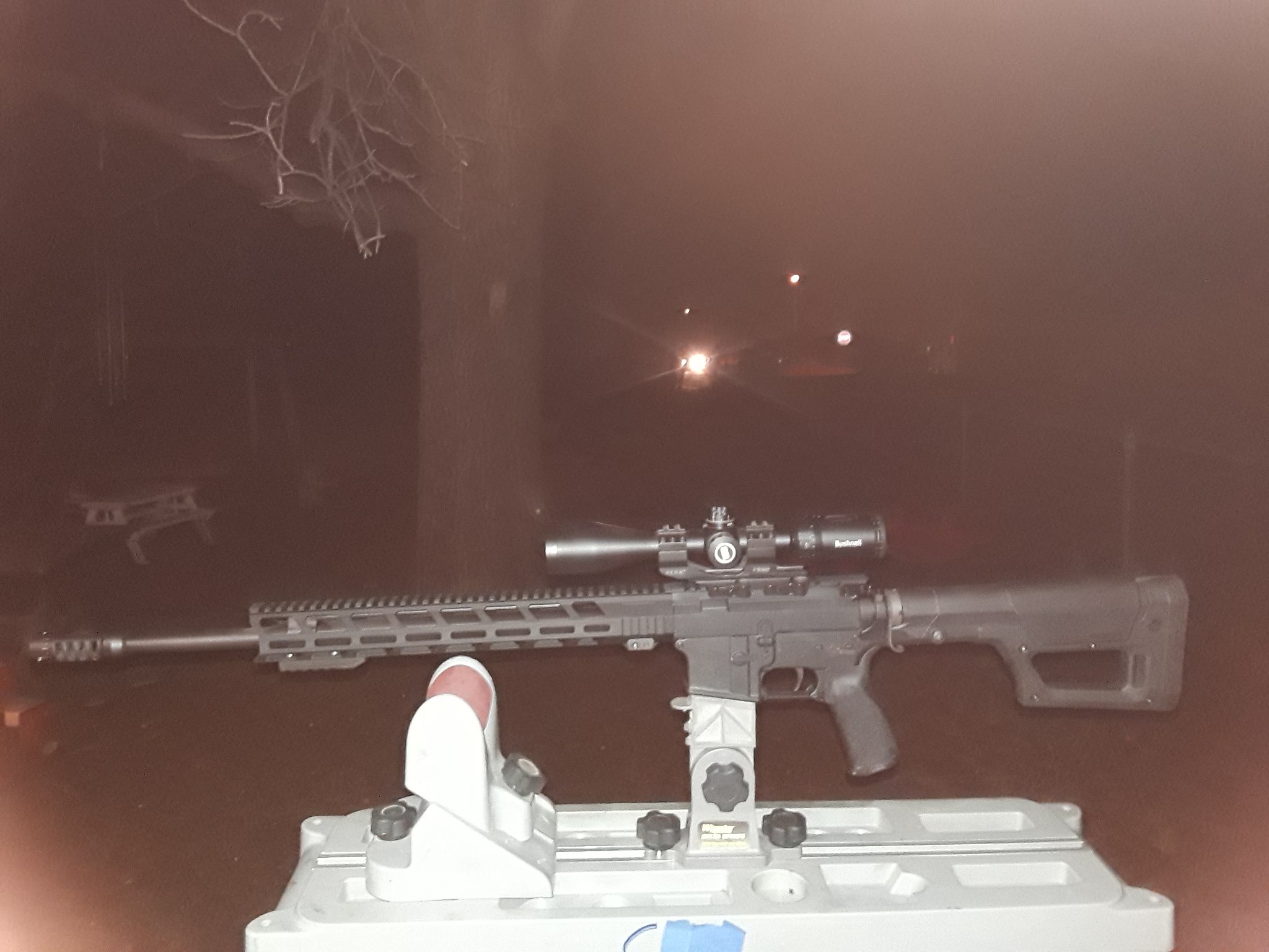

All this discussion of induced harmonics from the stock / shooter .
Maybe changing a scope and mount?
Yesterday upgraded my stock to a better bag rider than I had. It is now a prs lite. Oddly without any adjustments it matched my current desired lop (may be long for some folks wearing plate carriers).
It weighs twice what was on there.
It should be an improvement for me but as groups shrink improvement is harder to see.
I may be close to my performance capacity.
Will it knock me out of my tune?
How much adjustment will it take to re-tune?
Anyway looks better than the fde that was on there.
I have some physical issues that would effect group size so I have to wait some or med up till I can't feel it.
The things that can cause harmonics and your rifle build a very stiff dense stock. Not being low center of gravity otherwise action and Barrel up high in relation to stock. Hardware that raises your scope higher from center line of bore and the cheek rest to accommodate that. Bipod extensions. Hard rifle rear bag being too hard also causes vertical issues. Internal issues like for example too much pin fall . Off center throat. Lug timming issues. Chamber size issues . And the list goes on ....

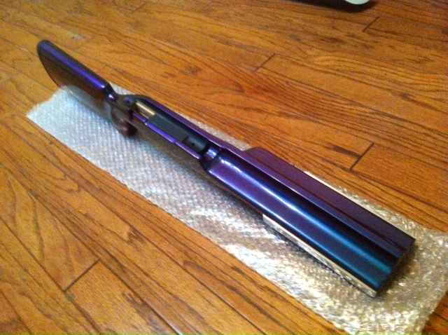

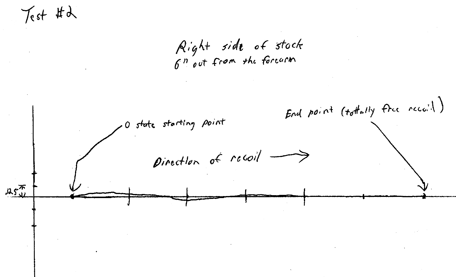

The main indications were every time I tested the two differing loads in the 100 yd test tunnel they hit straight up and down every single time . but this is in a benchrest format, but outside on a bipod they may hit to the side a bit if the wind is up a bit but torque is the main culprit usually if the wind is down. Just disregard your windage for the moment when you are testing with two loads. Torque is hard to control on some guns and not so much on others but because of this effect it can throw bullets out the side if not held in a consistent manner. Here is a test trace of a actual gun movement along with torque trace from static to 6 inches total travel with RH 1-11 twist. The rifle had arms that extended 6 inches out from the side that draw a trace on paper walls on each side of the gun. The rifle was fired free recoil. As you can see the torque starts the instant the gun starts to move rearward before the bullet leaves the barrel. The gun will move and average of .150 before the bullet exits at which point the rifle snaps back reversing direction and settling down to the non firing tracking line or datum line. In some cases the snap back was harder than the torque up.

Not sure I understand.
As you dialed in the tuner all shots went vertically?
Was that on all the same barrel?
I found mine switched vertical to horizontal with each number and the test gun / loads used.
52g / 223 / 20 inch 1/8 tw.
Or is this the 2 different powder loads same setting test that I am still trying to grasp.
It seems you are tuning the barrel in general but not to a specific load?
Are you trying to isolate top dead center of movement?
I am going to re-read your posts on that again when I'm not tired.
Sorry should have said it , yes two different powder charges and they would hit straight up and down in a no wind condition with numerous barrels. Use your normal load and 1 grain less for the two shot test. Not trying to have the exit time at the top of the peak but more if in the middle of the upswing, that is when to two loads hit level to each other. even if they are off to the side a bit watch your vertical more then anything. Make the two powder charges hit level. Then go back to the normal load and watch it shoot.

I have came to figure that the EC Tuner Brake will pay for itself very quickly in an ar platform.
If trying to save money you could tune any ammo that was acquired on sale to an acceptable level of performance.
Then there is the custom loads using expensive hard to acquire components that just won't work well with the powder you got hold of.
Stick a tune to it and shoot.
You got a point there. I never gave that position a thought. But in today's market where it's becoming a game of dice to locate your favorite powder or bullets (Varget, H4350) and you have to use what you can get on that particular day. A tuner may be a GOD sent.
I have a gallon of the H335 I could not get a load worked up with 52g or 55g bullets.
Better yet I have a bunch of shity hornady sp bullets, I wonder if you can tune those. Lol
