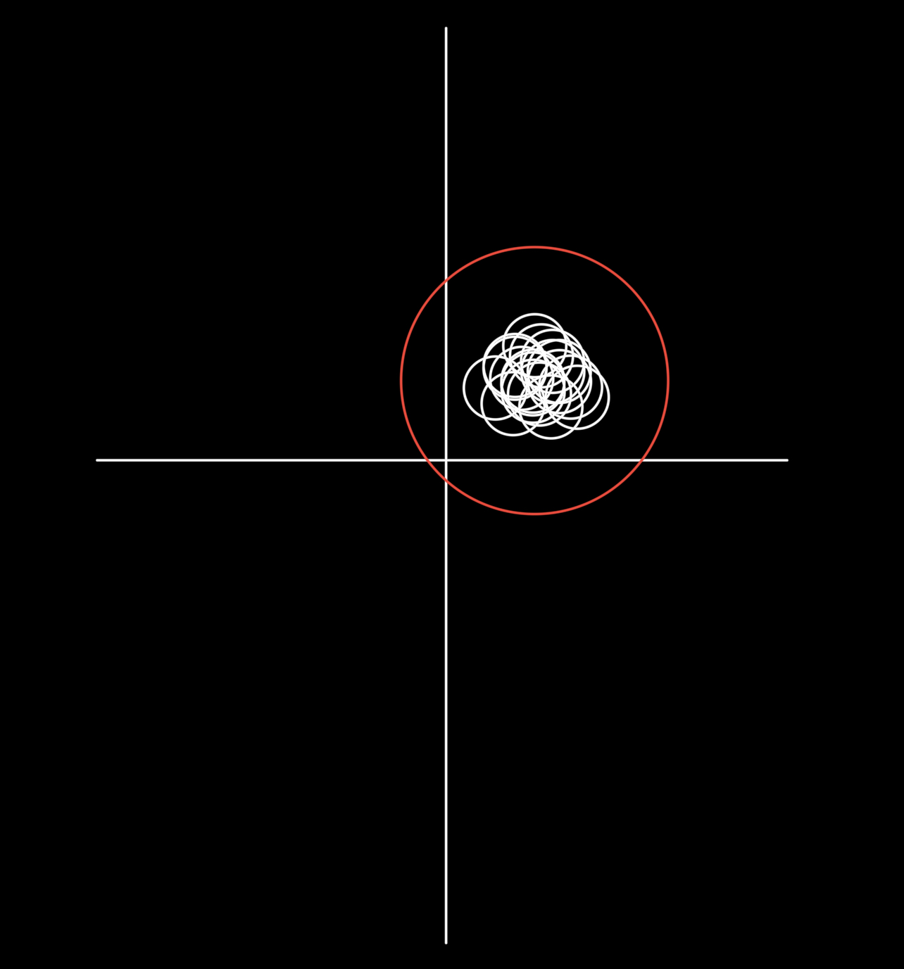

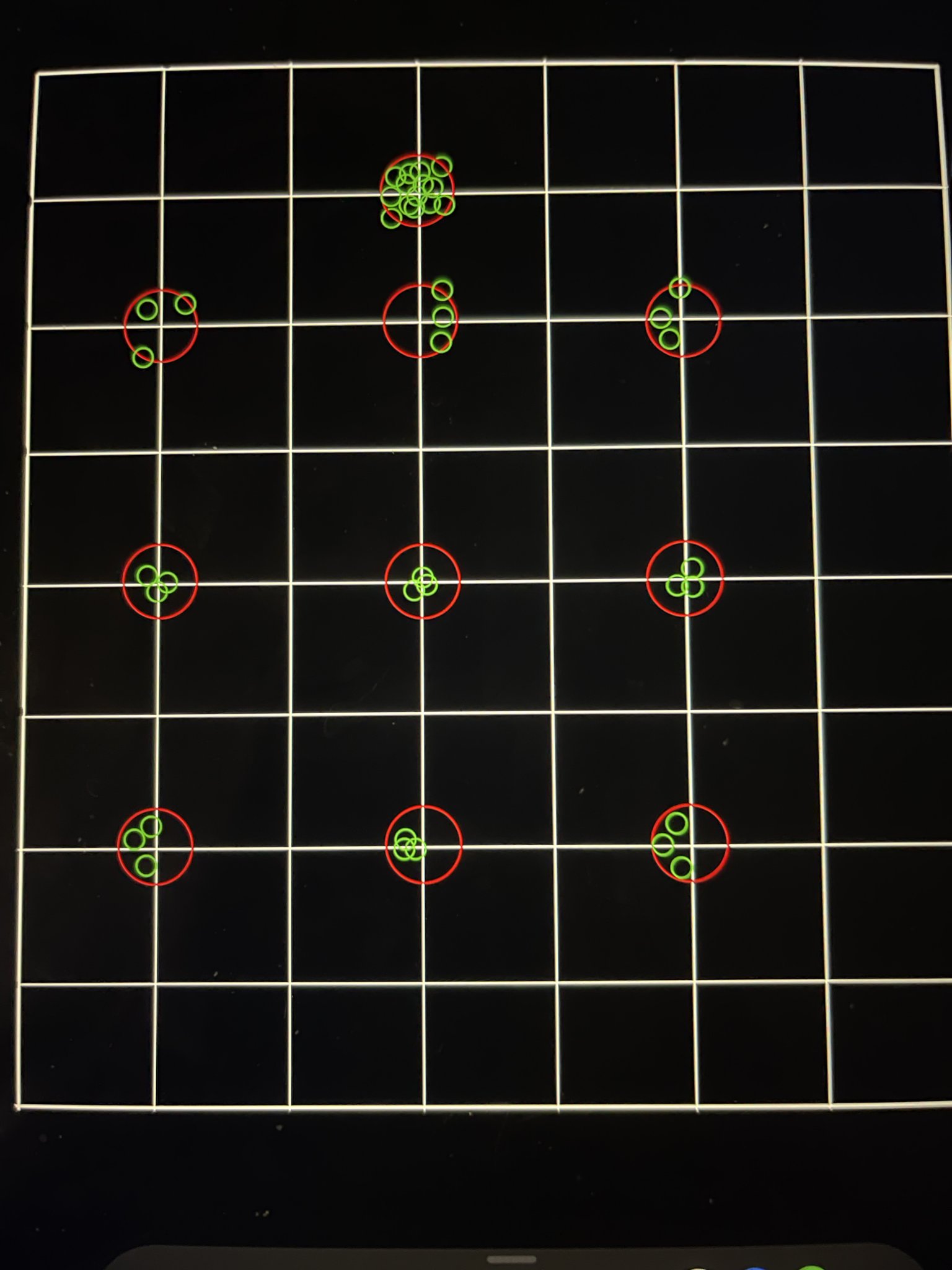

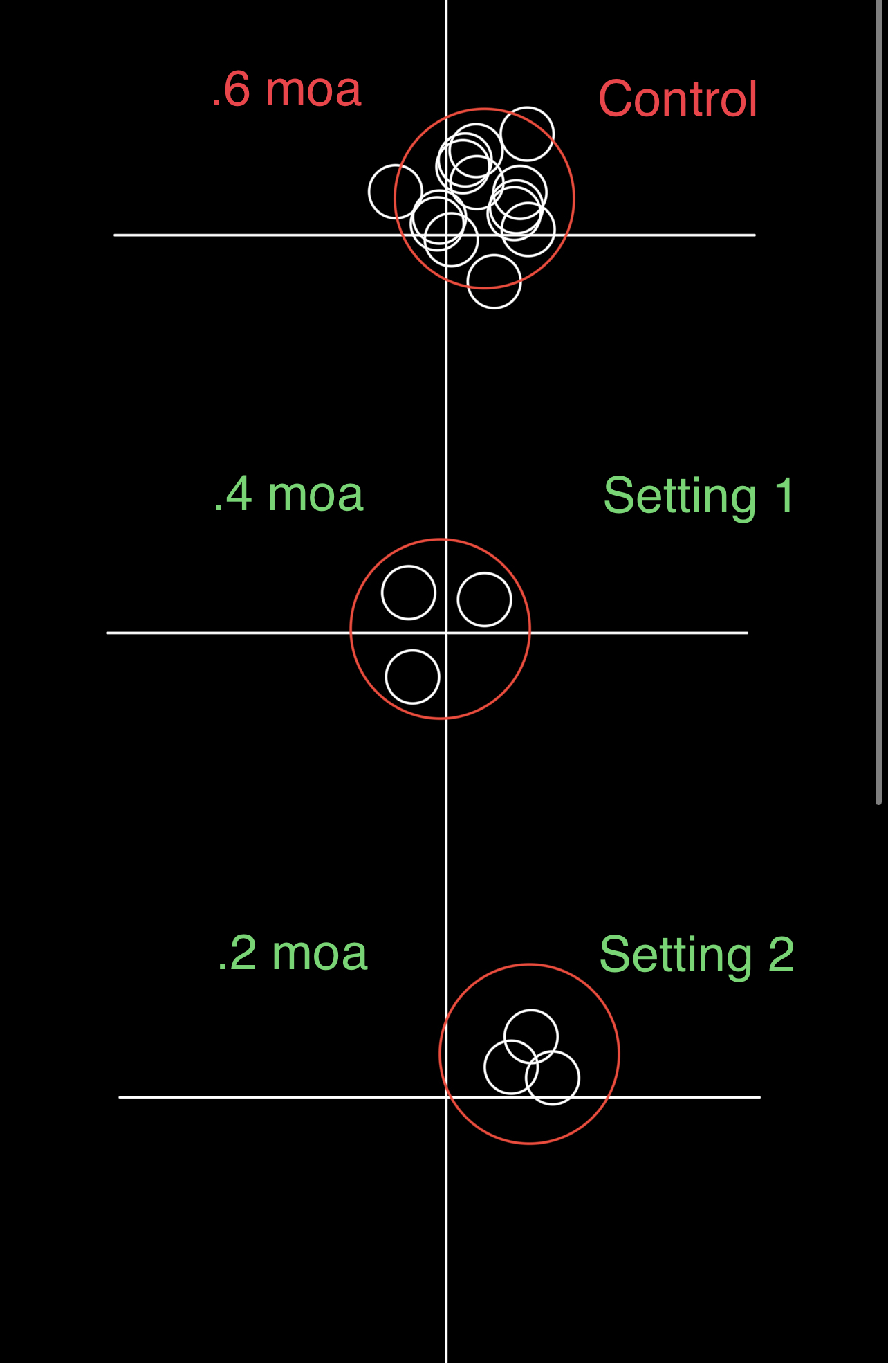

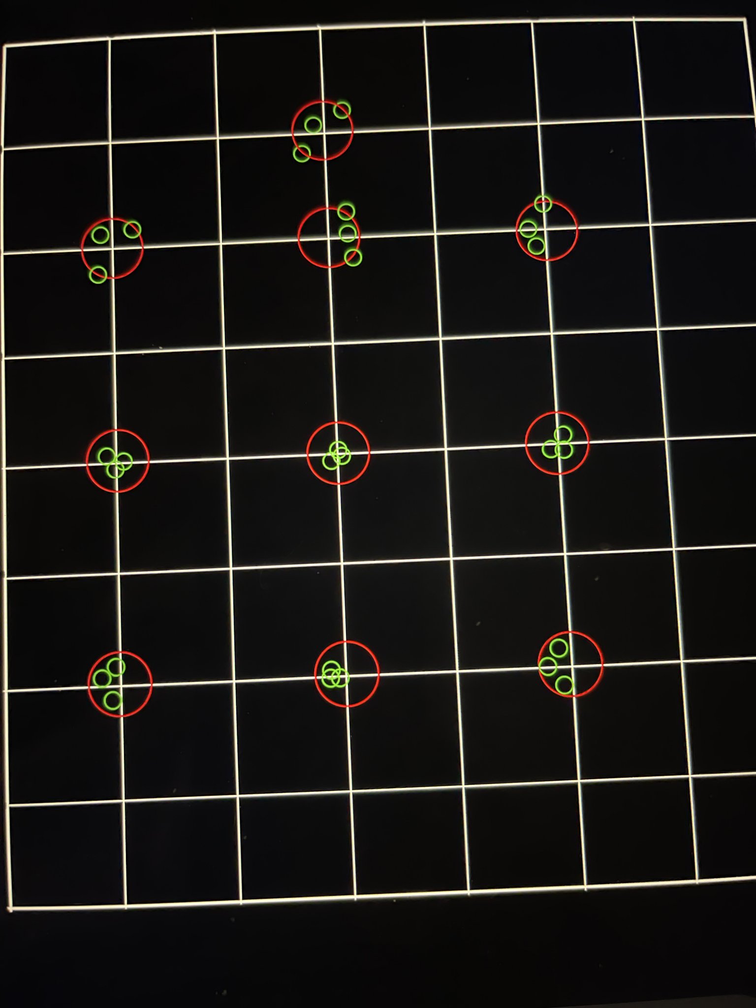

So, here is a basic example of what “random” means in this context.
Most rifle/shooter combos are *not* .2 or .3 “all day.” Once you take long term results, and get rid of abnormal “flyers” (something obviously screwed up like a bag moving or something), most really good shooters and rifles are around .6moa.
Obviously there are exceptions. The best in the world and very stable rests, etc etc.
So, let’s say you do enough testing to know a rifle/shooter is a .6 gun.
Then you take 3 shots on a tuner setting. Change the setting and take 3 more shots.
If those two groups are *anywhere* inside of .6, the data is questionable at the very best.
Is it the tuner? Possibly
Is it just a good or average group that fell inside of the .6? Possibly.
This is what people mean by “random” as small sample sizes don’t have the confidence needed in which to distinguish “random” from tuned.
Just like 3 coin flips don’t show anything confident when they land on heads three times.
Here is an illustration which shows “random dispersion. The control group was say 30 rounds.
The two tuner setting groups can be found inside that control group.
The last pic is what you would need to verify the tuner setting actually worked.

Here’s a very simple example how that just doesn’t work.
Take a look at this. The top group is your control or “zero” setting on the tuner. The rest are moving through settings and very typical of what you will see.
I’ll post another pic, in a while that will change the entire scenario. With basic quantitative data.

Now, take my above picture where you shot a 3 round control group.
Shoot 20 or 30. Your dispersion will now look more like this picture.
Now, tell me how you would choose your tuner setting?

The fact they may or may not shrink groups is an entirely different discussion. And it has a ton of things to consider.
But, for this conversation, we are going to assume they work perfectly fine.
But, if you use a 2 or 3 shot method for choosing your tuner setting……well, now you can see from the two examples I posted, it’s more of a crap shoot.
