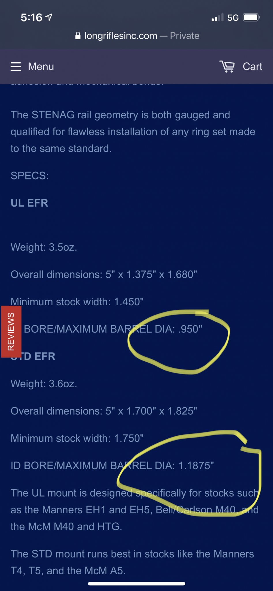

    Looking at the McMillan A1-3 or a Manners EH2. The EH2 is more available.
    The barrel on my rifle is is about 0.92” at the last few inches of the stock (18” long Barrel). Is that too wide of a barrel to fit inside the LRI UL which has a maximum barrel width of 0.950”
    The Manners EH2 is also only 1.5” wide, and the URL says the stock needs to be at least 1.45“ wide, is that cutting it too close to bed the LRI UL on the end?
