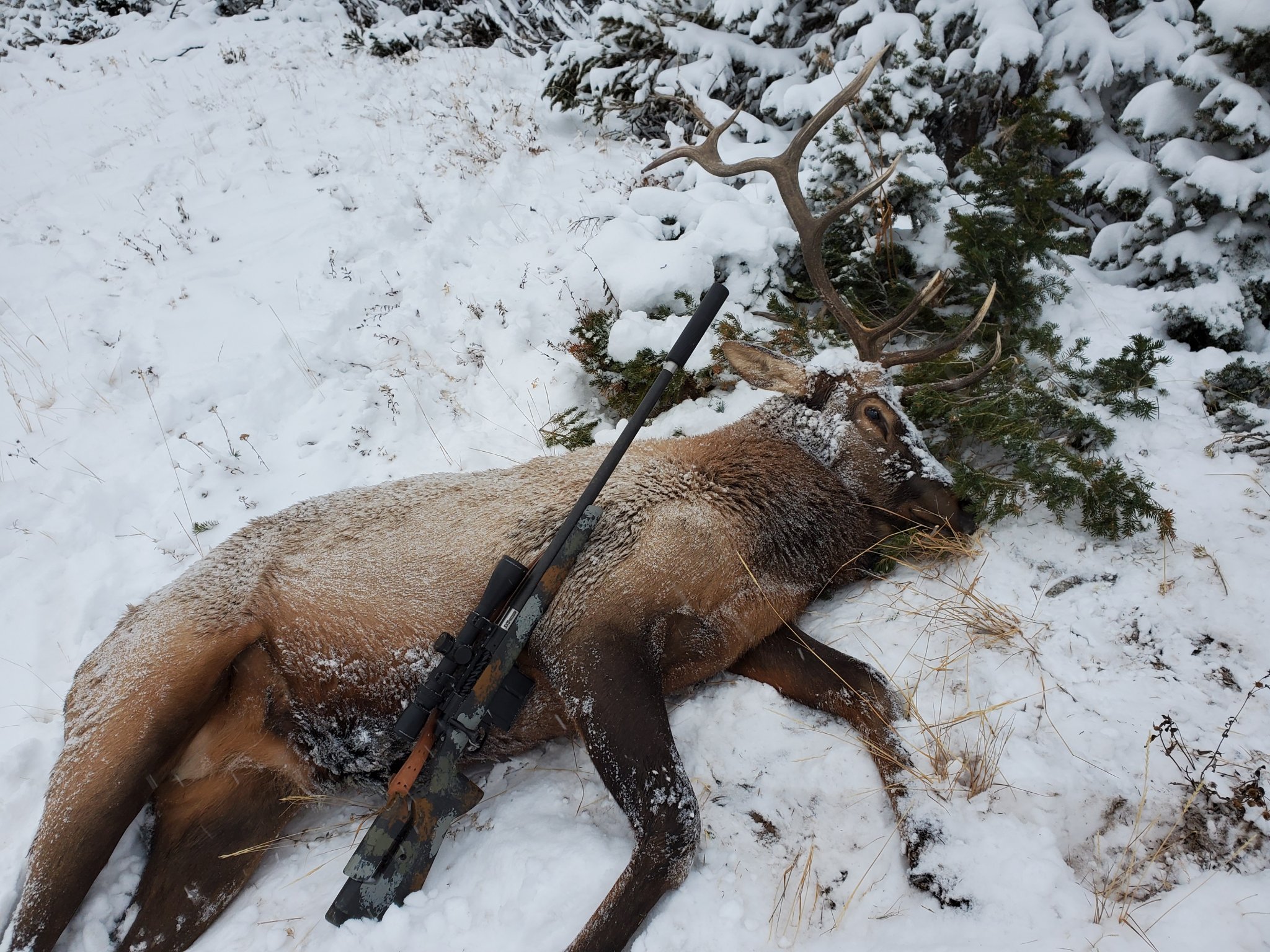

I anchored my bull last year and have no doubt it will continue to do so in the future.
To answer your questions... I would favor the 300 over the 6.5 CM. You'll get more behind the 300 WM. And yes you can comfortably build a rifle that is sub 10lbs in a chassis or with a traditional stock. I've got two going to buddies in MPA Ultralights and mine is in a manners. All sub 10lbs.
300 Norma Magnum with 245 Berger EOLs @2948 fps

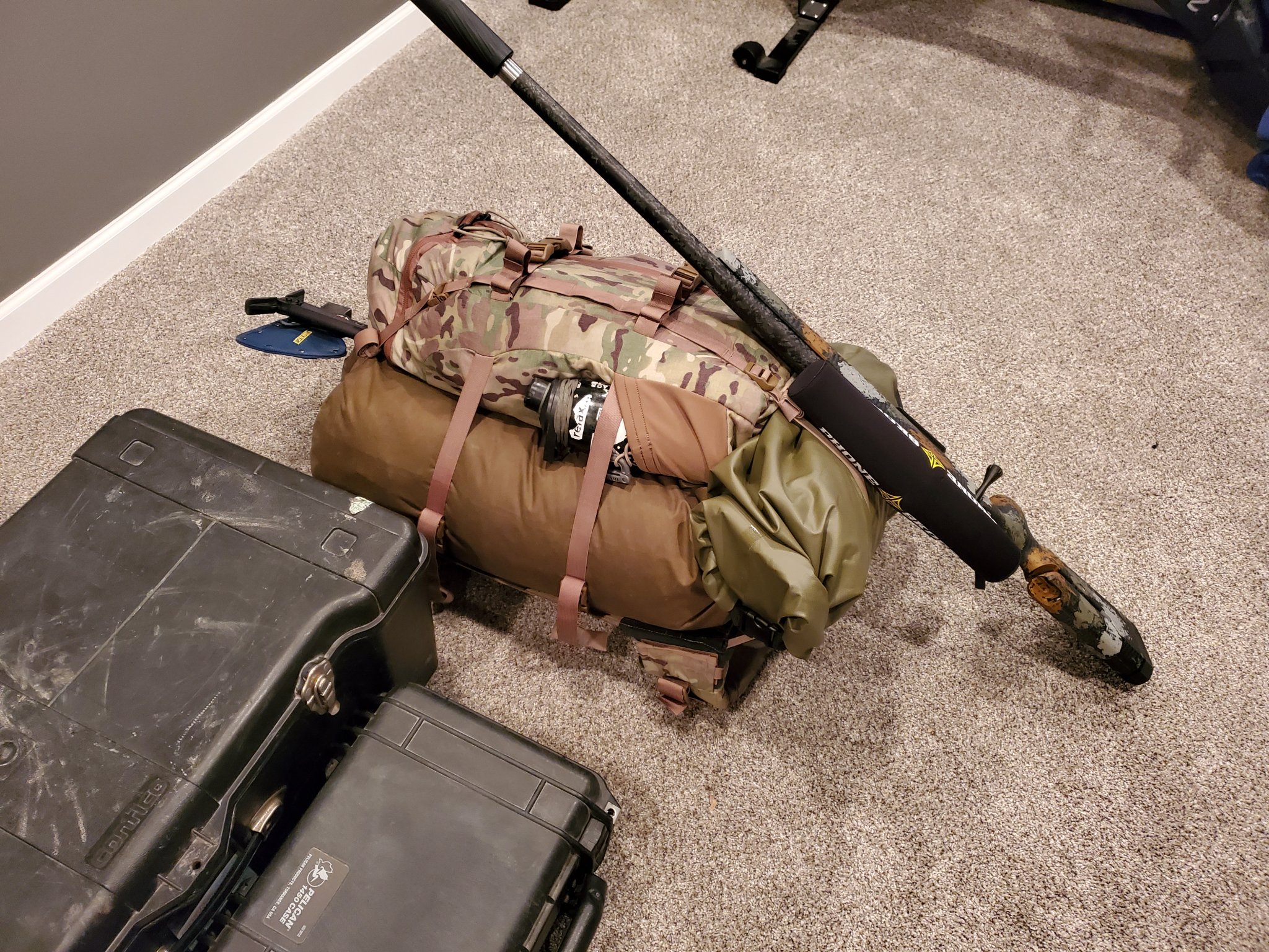

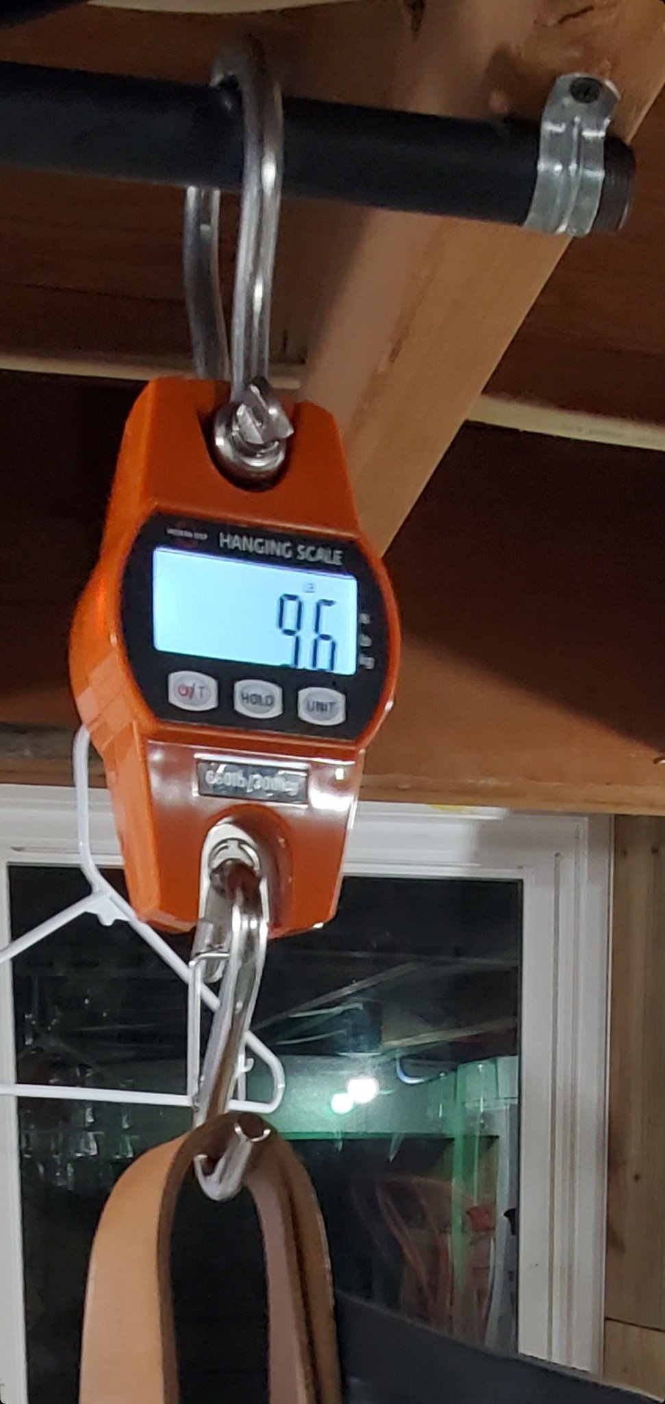

This will do the job, 9-3/4 lbs with scope.
