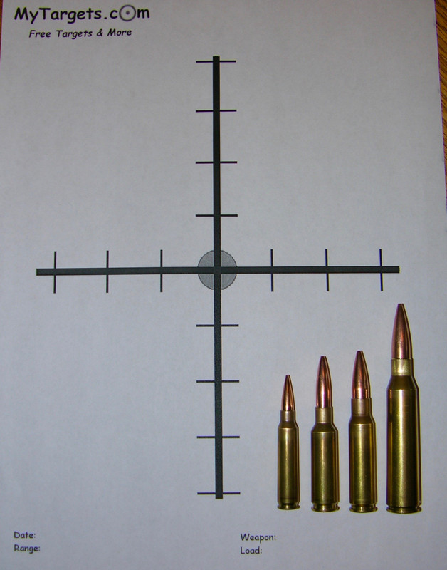

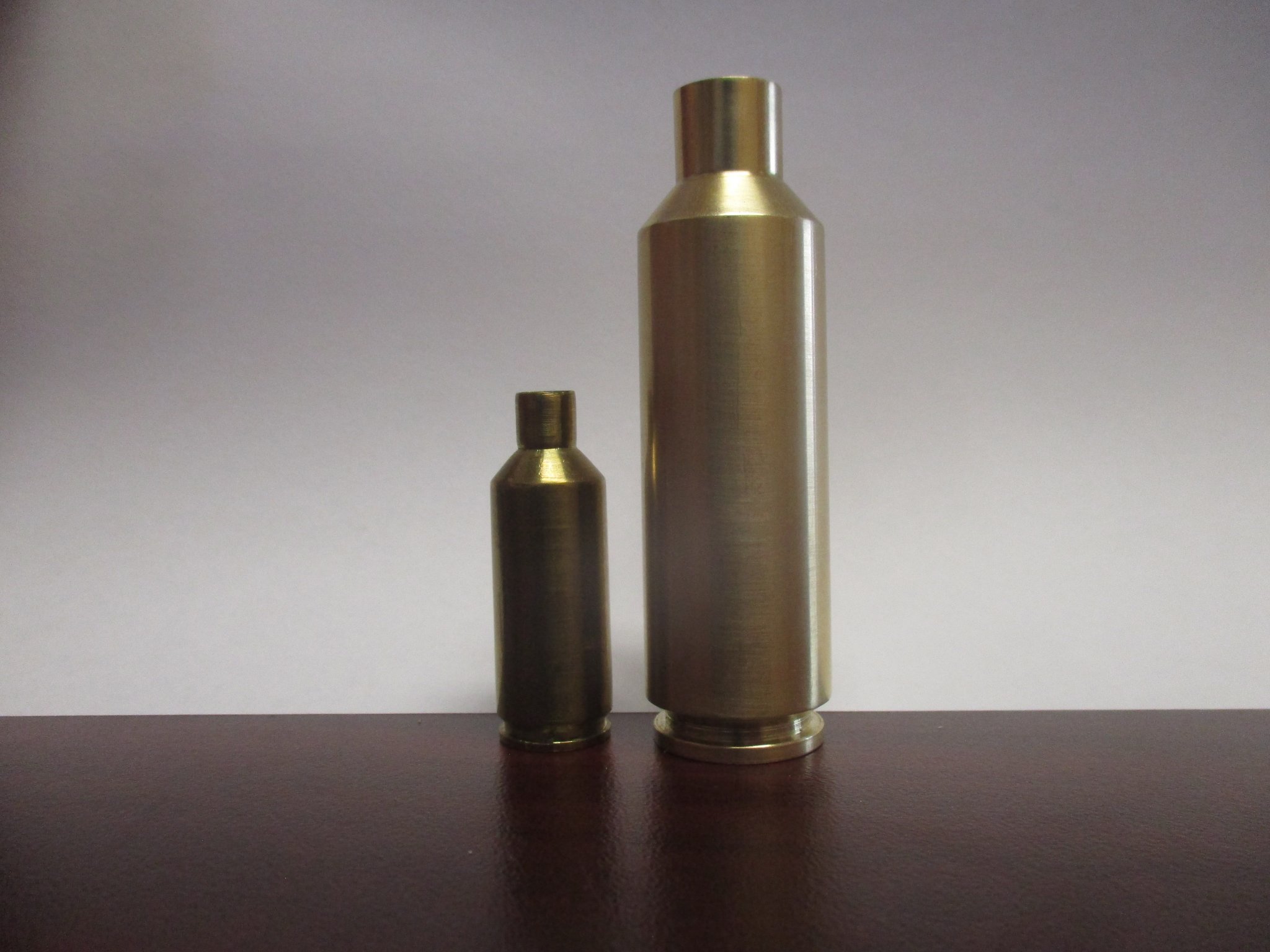

New elr monsters and one old one. cartridges listed from rt to lt 375 Mercenary , 420 Blitzkrieg, 416 colossus and the 458 Goliath the 2nd photo is the Goliath next to a 243 wssm improved. Care to take a guess where the design came from ???? lol. Here in a few weeks we will post all our new elr cartridges and the action that are needed to run them the colossus and Goliath are different in the case head internal design is a pressure and ignition management design that allows for higher pressure and the hotter you run the case the tighter the primer pocket gets. the ignition design allows you to run a standard magnum primer. with no delay in ignition

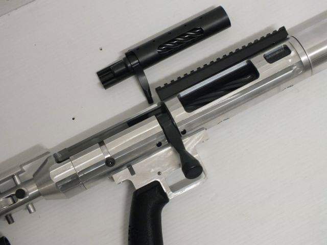

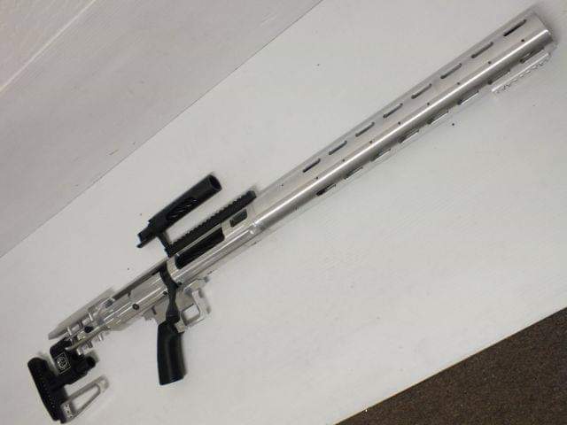

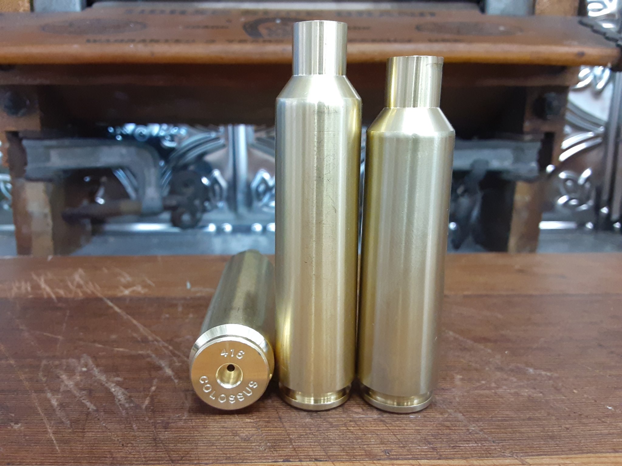

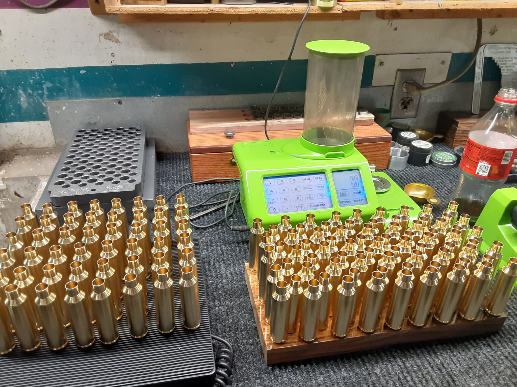

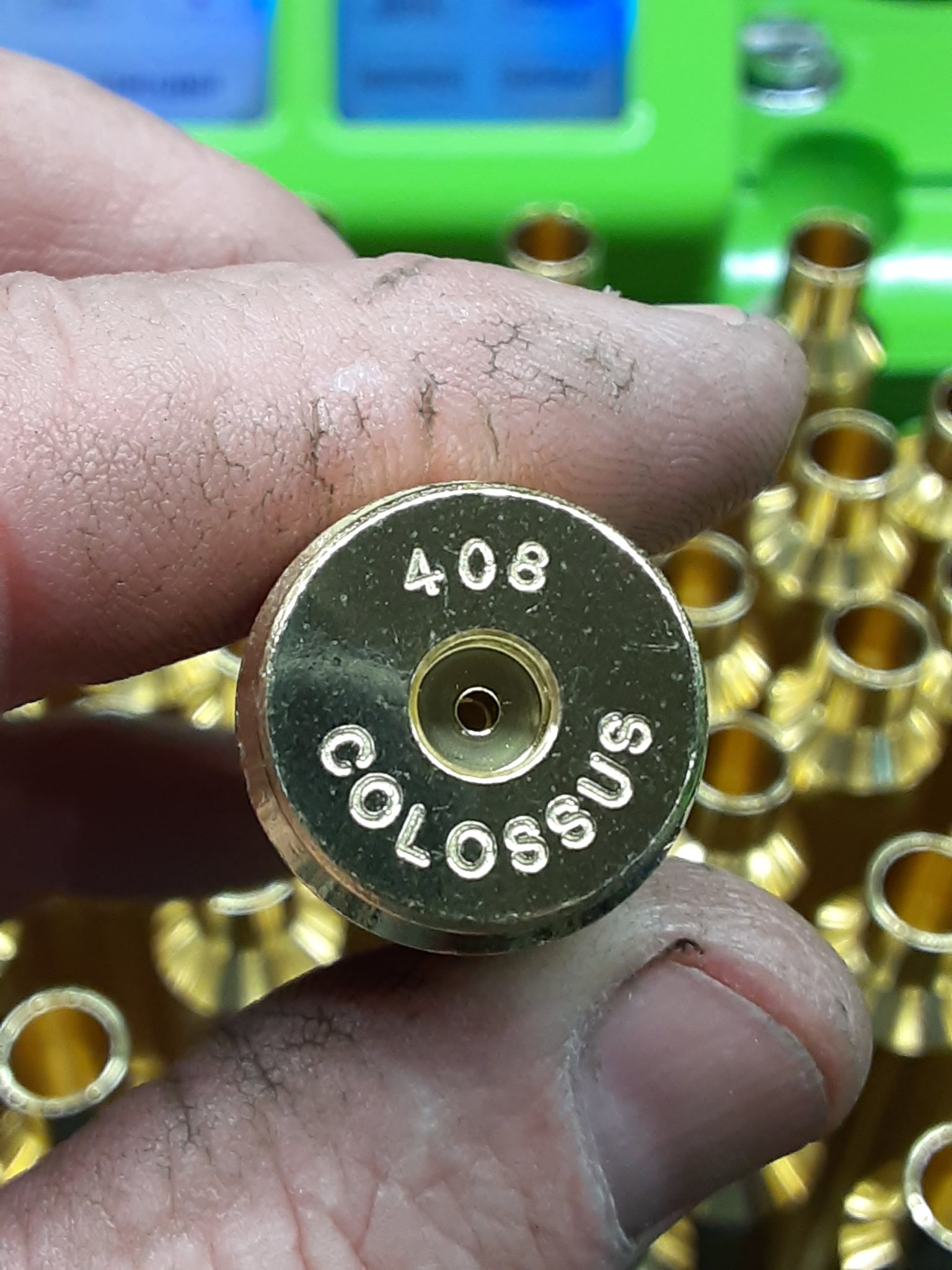

Finished up the manufactoring of the 408 and 416 colossus 3 builds in the works with pierce 20x actions soon they will be done for testing

The warlord is available in both 408 and 416 and yes it is designed as a single shot from a cheytac action yes its rebated a little about thr same percent as a 284 case. and yes badlands just has not updated his web sight yet the 450 grain bullets were designed for us but are available to the public. the 408 and 416 colossus is a different case it requires the use of the 2" pierce action 20x designed for us and the ex-nihilo case the 20x is also made for cheytac and bmg cases

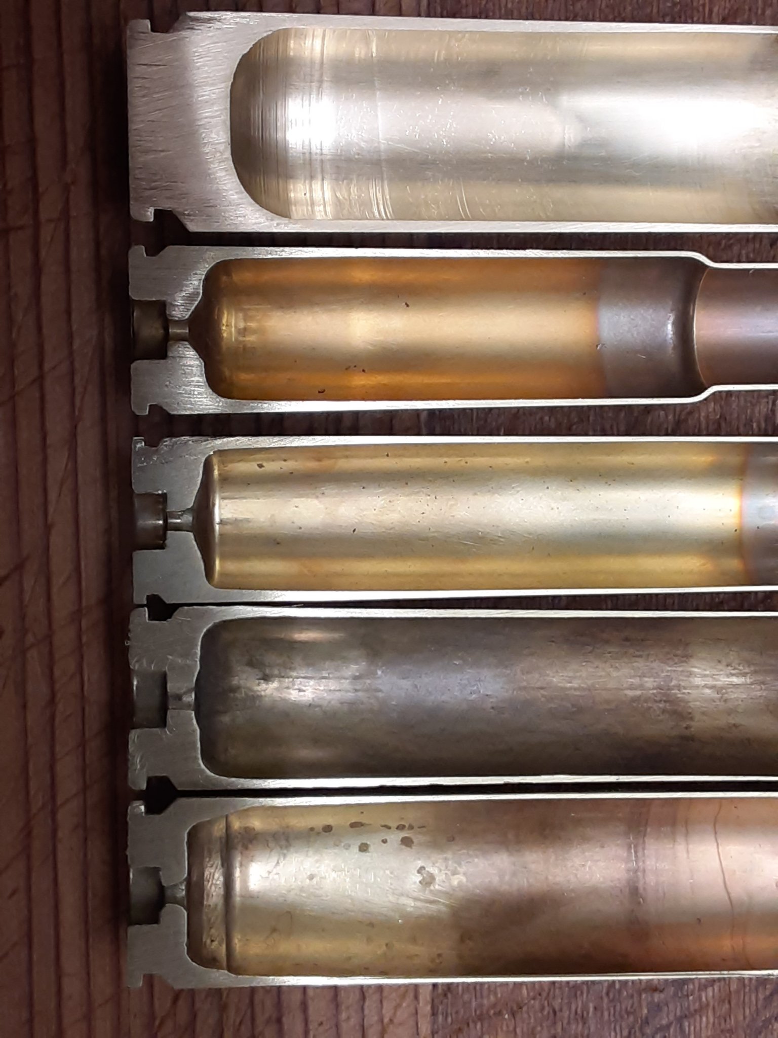

How heavy duty is the 408 colossus? Top cartridge is cross section of prelim manufactured h20 conformation of the colossus prior to final design case head thickness on finished cartridge stays the same but internal shape is changed and of corse the flash while or primer pocket the 2nd cartridge is a 423 dakota from lapua, 3rd is the 33xc from Peterson, 4th 375 cheytac Peterson ,5th is the 585 nyati express from bertram. as you can clearly see the colossus is a whole lot stronger designed to be run way hotter and have longer life then the typical elr cartridge

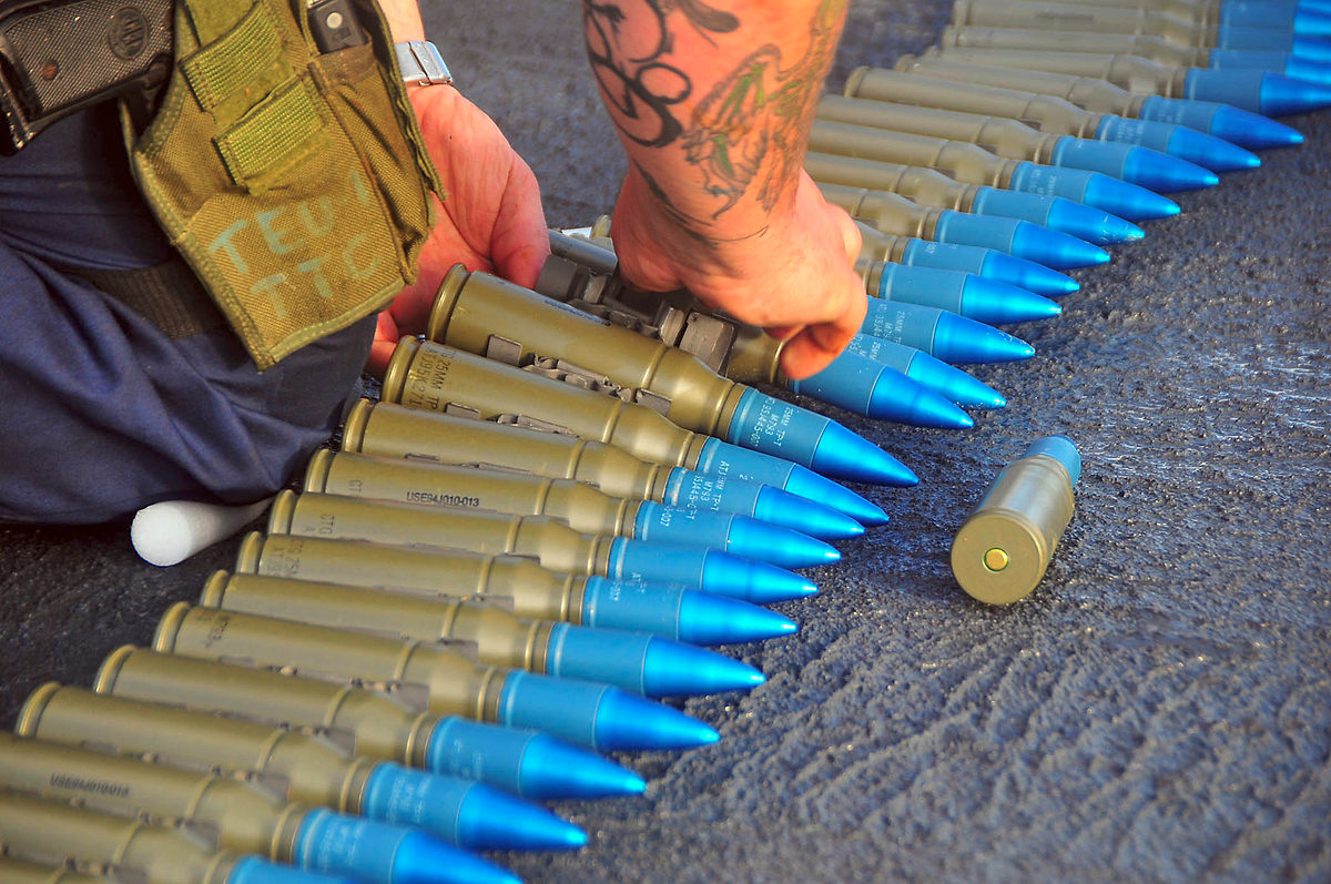

have to wonder if all these rounds are based of an old .50 cal when they are going to stop playing in the kidy pond and move to the 25mm or larger
cause if a .50 is fun to shoot these have to be a hoot and a holler .
now that's a reach out and touch something round lol . And at 35 dollars per round It's a bargain if you get them before the curve catches up lol .
cause if a .50 is fun to shoot these have to be a hoot and a holler .View attachment 7361235
No. None of our cartridges are based off the 50 caliber case. None of out cartridges have parents they are new manufactured designs way higher pressure limits then the 50 caliber.
