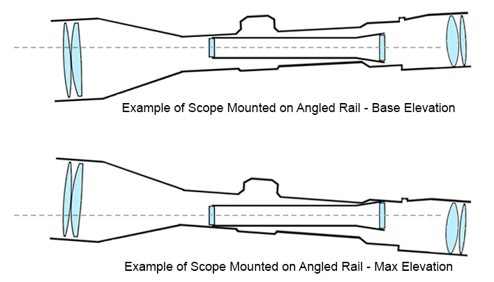

@steve123 explained it pretty well. Below is a diagram of what happens when you mount a scope on an angled rail. When you're set for close in (e.g. at 100 yards), the erector is elevated within the scope body and is pointing out the upper side of the objective. When you dial for max distance, you're elevating the scope and rifle and looking out the bottom of the glass.
The optimal clarity is when the erector is aligned with the center of the glass.

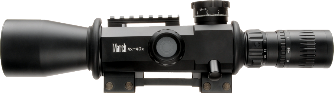

With the March Genesis (see below), the scope body is mounted within an external case. Every click of elevation rotates the entire body within the external case. This means that you're always looking through the middle of the glass.
The other main advantage is that you're able to dial A LOT more elevation. This particular scope has 86 MILs of total elevation available to it. As I mentioned earlier, the main negative of this configuration is that the height of the eyepiece changes as you dial. Additionally, you have only two mount height options, and the lower of the two is still pretty tall to ensure at max dial with high angled rail and a long barrel, you're not looking at said barrel.
That's why I mentioned above that this is really a scope meant for ELR. At medium ranges (like a mile and in), the clarity doesn't buy you much because, well, you don't need it, and you certainly don't need the elevation. But at longer ranges, the clarity really comes into play, and the elevation capabilities mean you don't need an external device to get the dial you need.
