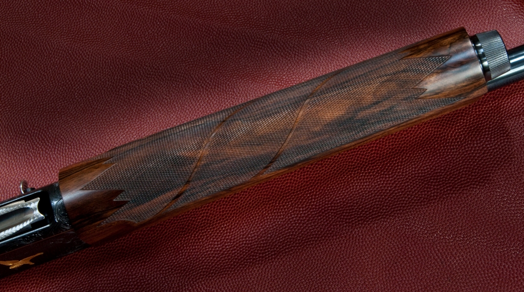

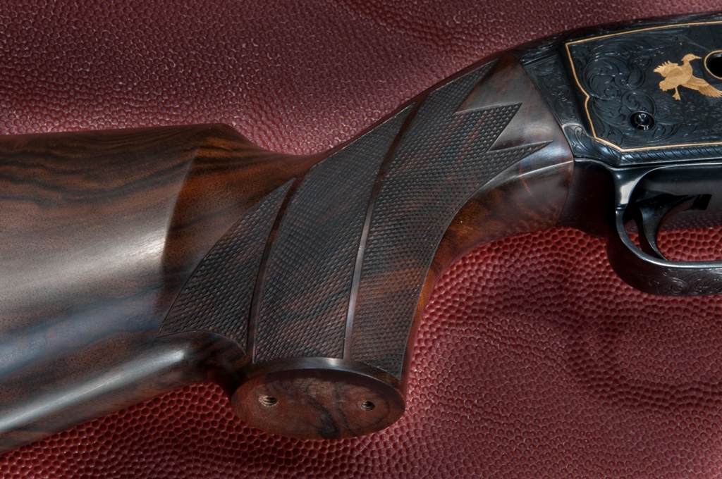

    Checkering - John Reese of Custom Diamonds Engraving (checkering and wood carving) out of Montana - note the fine line borderless checkering without a single overrun. He is OUTSTANDING. Can't recommend him highly enough for checkering and carving.

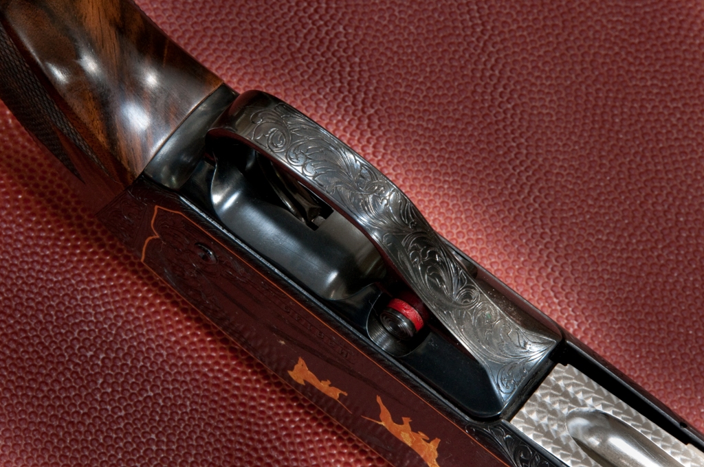

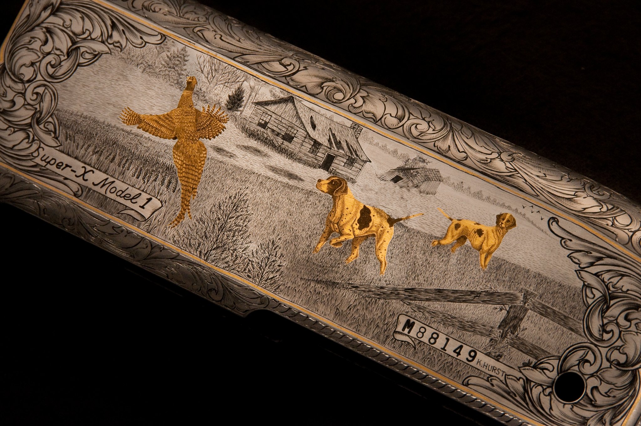

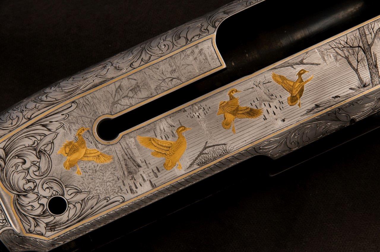

    In the white where Mr. Hurst's art can truly be seen:

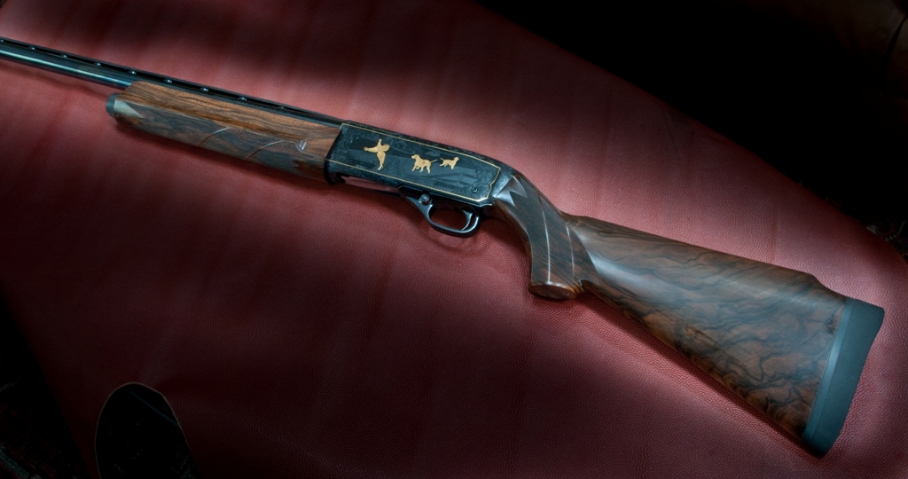

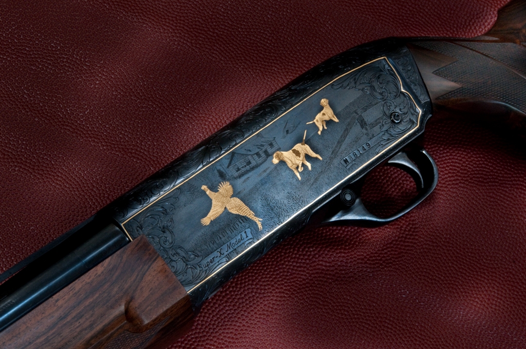

    Finished gun
    Note the checkering, grip cap not yet installed

    Holy crap thats pretty
    Edit: now we just need a picture of that pretty gun that you bought the the range that one time... Beautiful blonde wood with 28 inch barrels I think?

    Question for you: how do they get the gold in there? Is it actually inlaid?
    Yes, Ken cuts out the animal (or line for the border) with a bit of a back cut to hold it in, stipple the bottom of the cut (for the animals...for the border its just pounded it) to give it a bit to grab, pounds it in, then works the engraving. I was lucky that he had just bought a load of gold right before the price went thru the roof and Ken, being the great human that he was, only charged me what he paid and not what the gold was going for on the market.
    And Ernest Marlette did the most fanastic job removing any and ALL light scratches and over run and then hot salts blued it to perfection. I have heard that he no longer does hot salts...maybe bad for his health or too much of a PIA with the environmental authorities....maybe...dunno, really.
