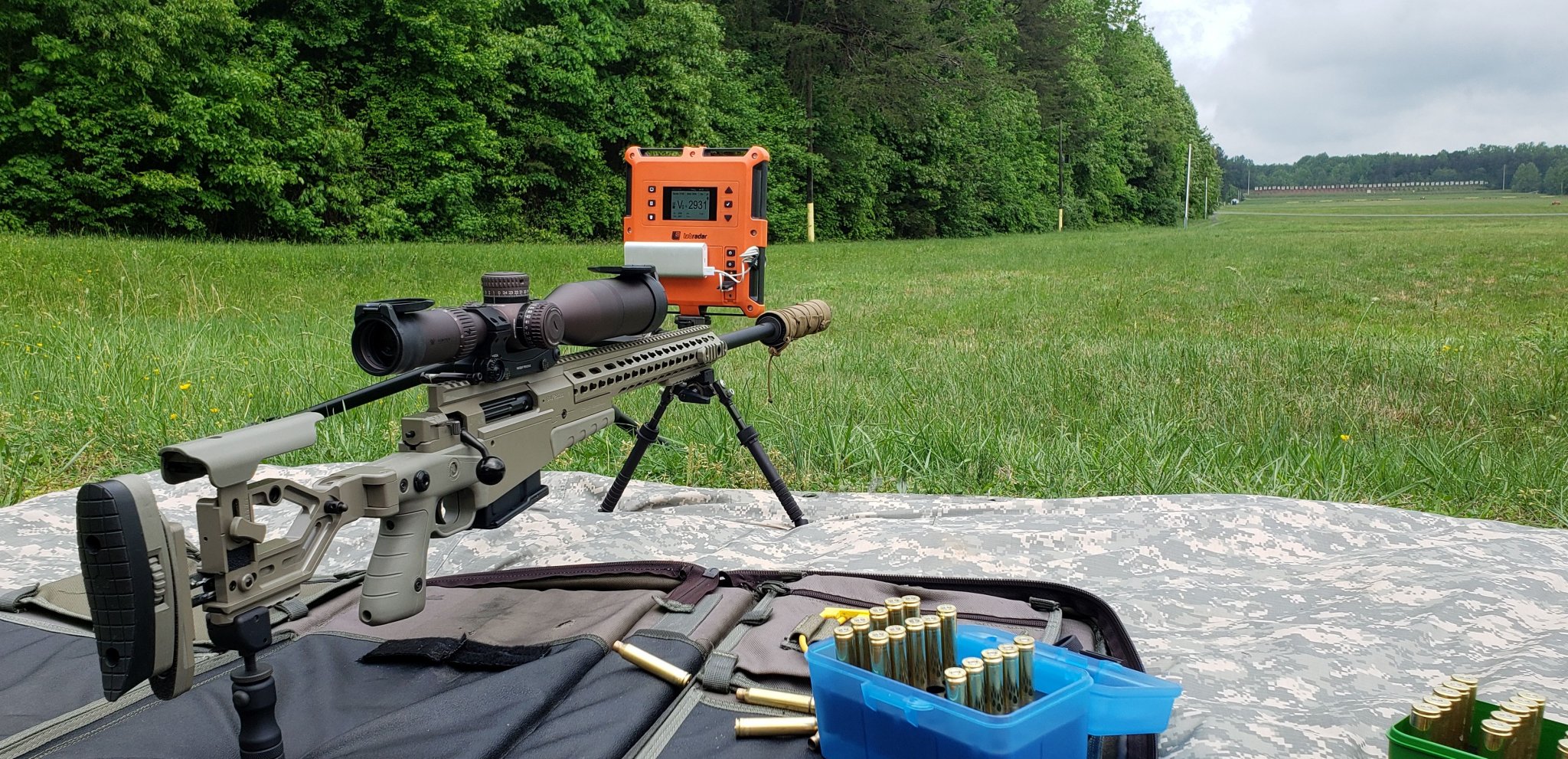

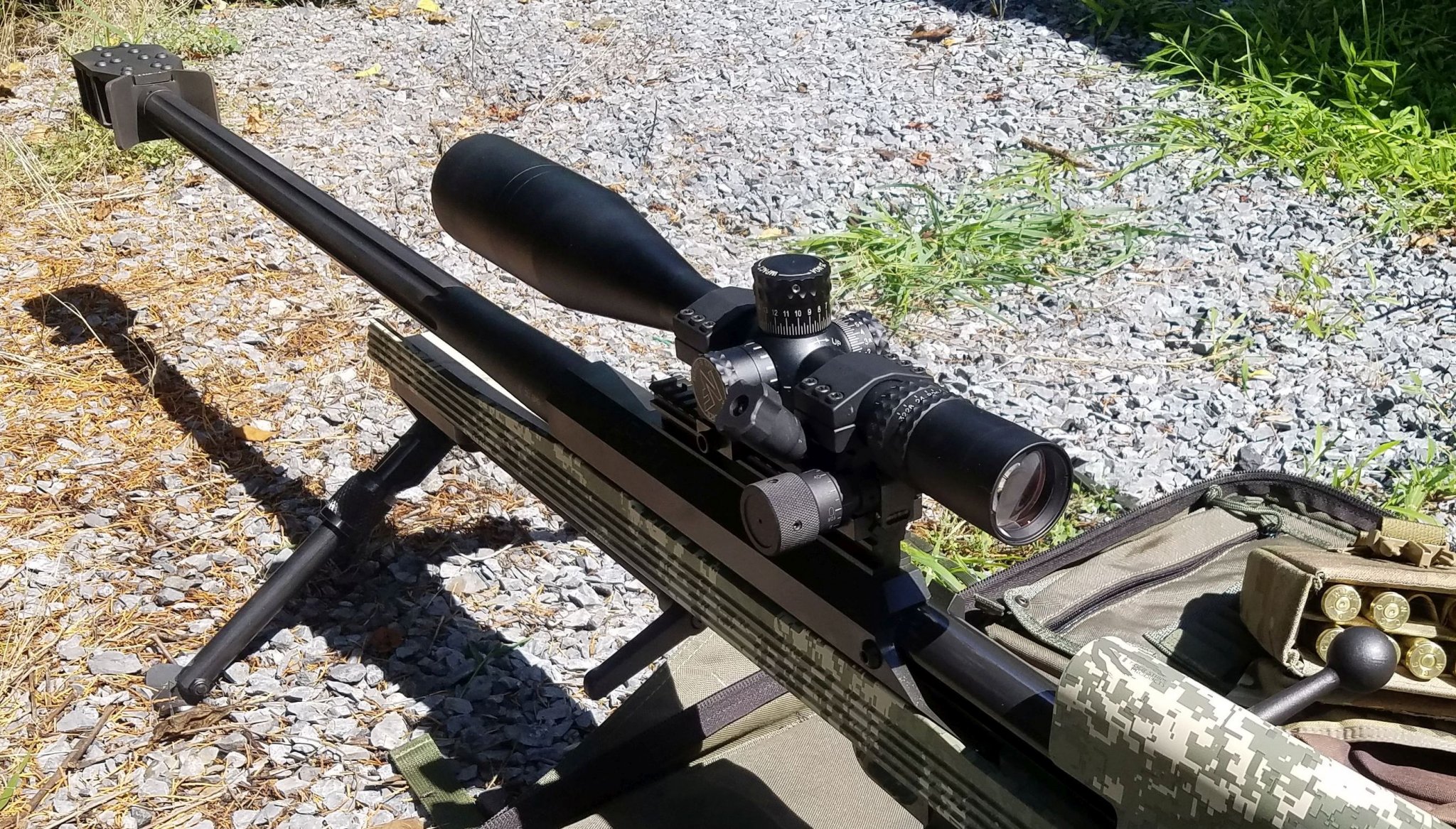

Finally got everything and able to mount the scope on to start some shooting.
Excellent quality, haven't had chance to test each elevation adjustment yet, currently set on 20MOA.
The CAI is Mil spec.

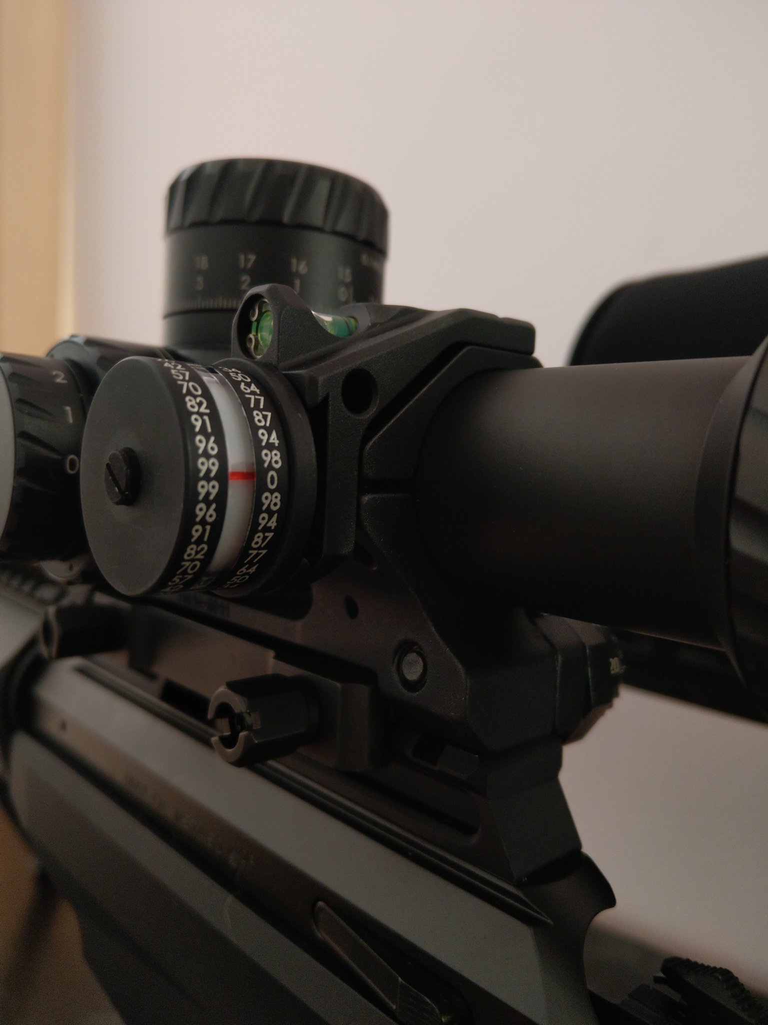

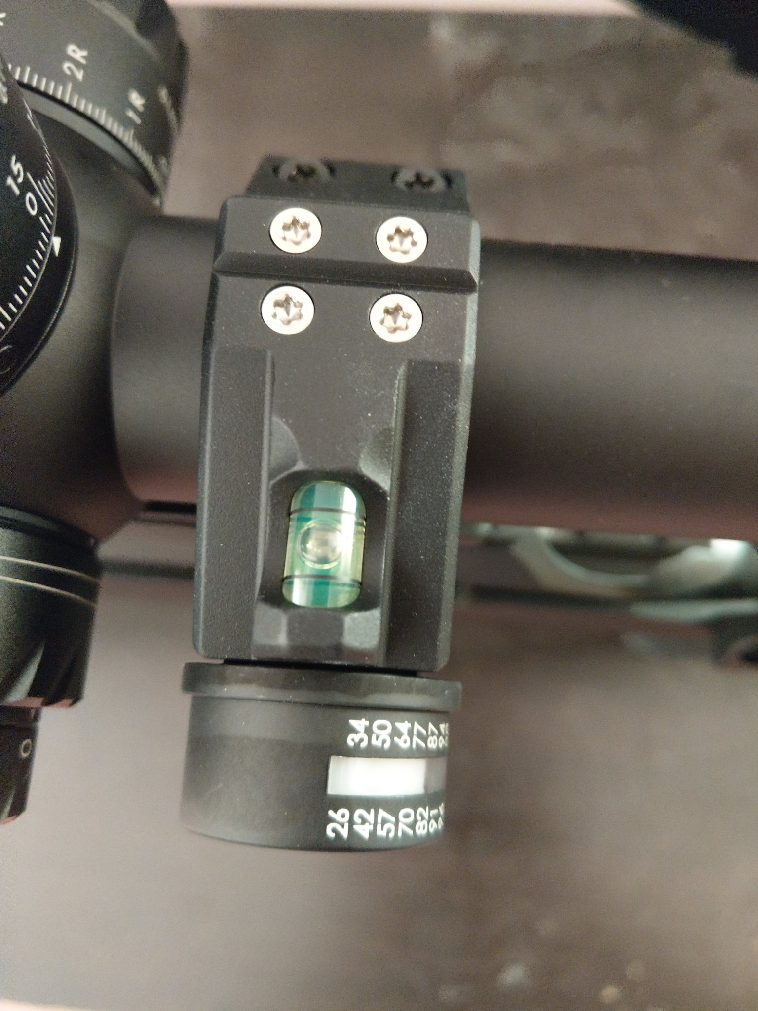

I got mine in today and mounted up as well. I wish they thought of a way to have the tool fit on the mount somewhere. So it would always be with it.
