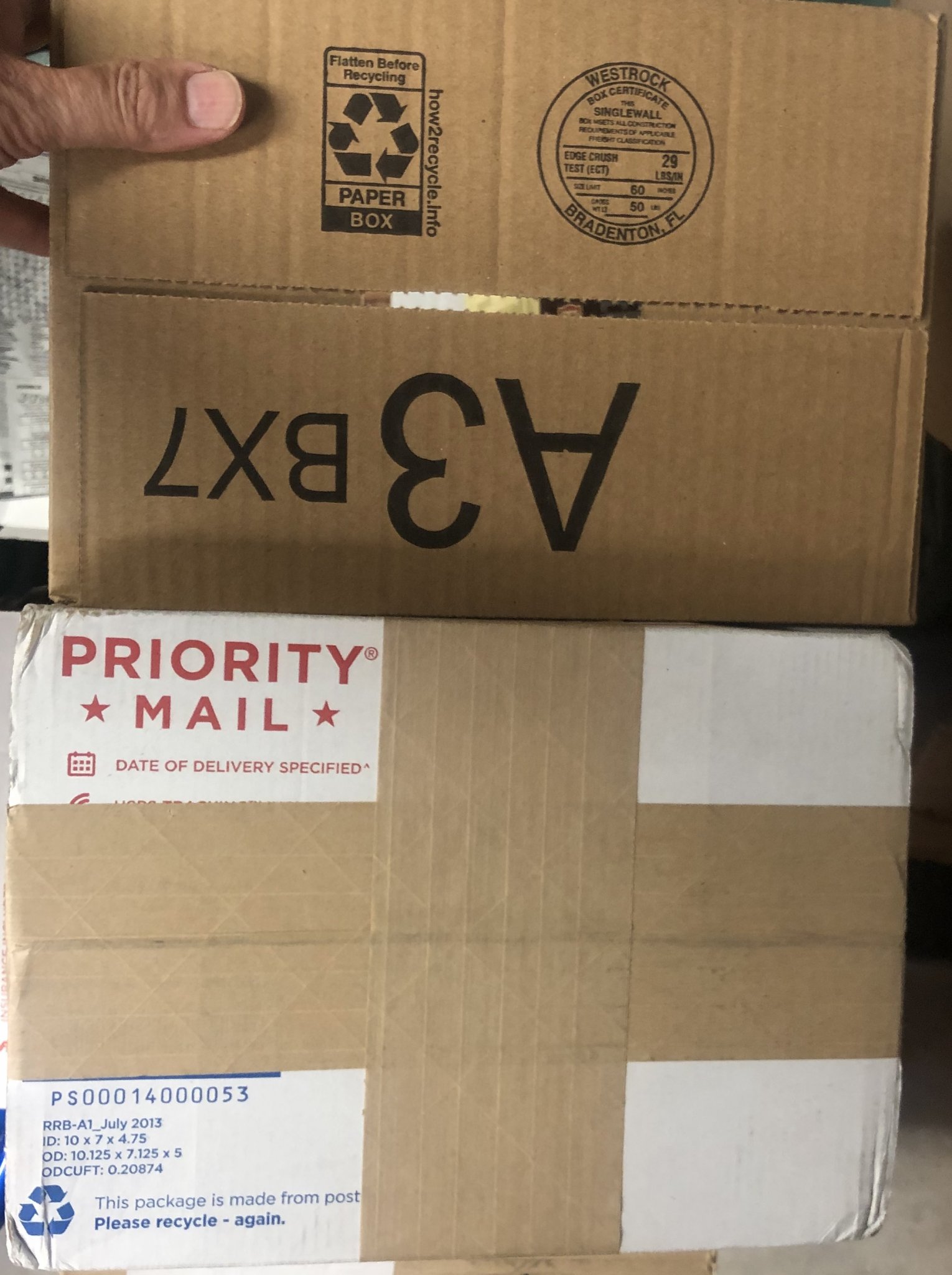

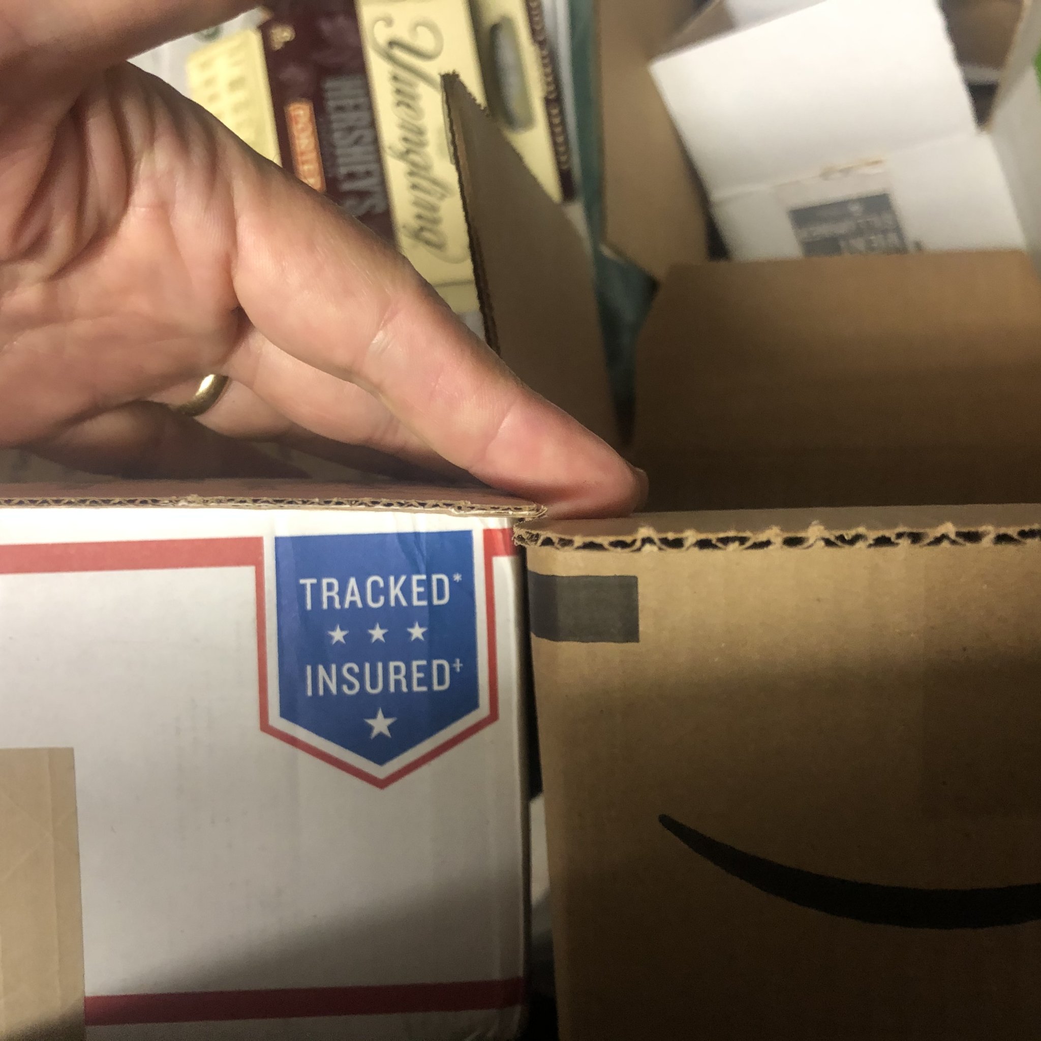

Here are a couple of pictures that I just took of both a USPS flat rate box and an Amazon box, next to each other. I received both of them with product in them. Note especially the big difference in wall thickness between them. In single wall construction, wall thickness and paper weight equals structural strength.
Then notice that USPS does not even meet industry standard and neglects to put the industry ratings on their box. Read the ratings on the Amazon box. 60 lb rating. Do you think that the thinner cheaper cardboard in the USPS box is somehow stronger than that of the Amazon box? Do you think that USPS maybe isn’t meeting the “spirit” of their promise to ship up to 70 lbs in these boxes by purposefully supplying boxes not capable nor rated to do so? I do.
Finally, note that the FRB was shipped to me with outside reinforcement, including both fiber reinforced shipping tape and even strapping tape. How come I was not required to pay additional postage on that package that had bullets in it? Do you think that it could be due to arbitrary made by the OP’s postmaster? I do.

we go though A ALOT of corrugated shippers at my company
the strength of a corrugated shippers is listed in the "circle" print with in the second picture posted above
its called the ECT Edge Crush Test, which you can find on the internet as well its not rocket science
if you search youll find the ECT rating as it pertains to capacity
the particular brown shipper above is 29 ECT
these are some of the variables when manufacturing a shipper
the base paper used, recycled or new
thickness of inner out layers
thickness of paper used for the corrugation also called the flute
Spacing of corrugation
shape of corrugation
multiple layers
glue used
and a few more
all of those in combination determine the ECT rating
also let if be known that shipper material/paper is bought price per pound, ton etc before processing the sheets in lay flat form like a printing press. once they are die cut to the proper shape the are sent to the gluing station where the box is glued together etc
utilizing the correct box for the correct item is at times more important than the actual strength
for instance , shipping vitamins think bottles of tylenol
if i have a perfectly fit shipper to the bottle height (1/8" or less), boxes have tolerances as well, i can get away with a 29 ECT as shown above
if i have a product that has a larger gap 3/8" or more i have to use virgin not recycled 32 ECT, if not the pallet will have crushed /distorted shippers and usually product inside after the first bump a truck hits
i also sell ship product capsules/vitamins in bulk form, that is done when the customer want to package it them selves
those boxes are approx cubes, 11" x 11" x 11" depending on the supplier dims change a inch here or there
those are double wall serious shippers, if you need a stool and your carful you can stand on the corners and it might hold you for a bit
with in those shippers we will not put more that 15-16 kilos 35 lbs more or less
the box can physically hold more volume depending on the product but if they are stacked 4 high (regular pallet height when shipping bulk) and a higher weight there will be customer complaints.
nothing to do with the OP's issue just some industry information about shippers
